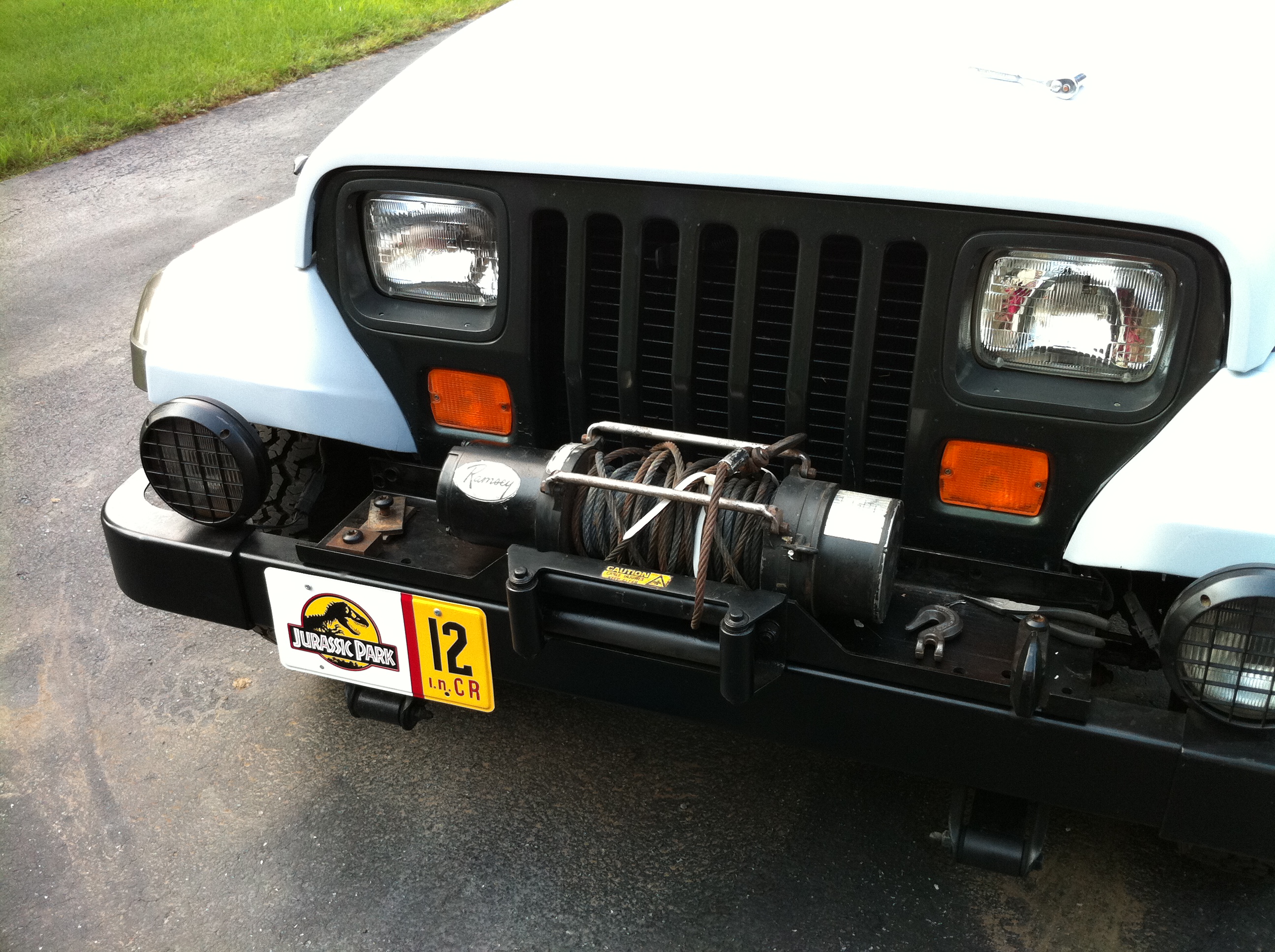

another update and then i think I am done till after winter...
Got my lightbar sanded and painted and found another light , just need 2 more... next i remounted it
also found a Ramsey winch on e-bay with the old sticker...

Still have to decide if i want a working winch or just a prop...

what winch plate did you use? i didnt know you could still use the tow hooks with a winch plate?

it came with the winch i got from e-bayMaverick20 wrote:what winch plate did you use? i didnt know you could still use the tow hooks with a winch plate?
The lister said it was a 36" Promark Universal Mounting Channel
It worked out well, it bolts right to the tow hook spots and the driver side has the channel cut out to put your old hook back on.I even used the factory tow hook bolts to mount it. The passenger side is not cut out and needs shorter bolts which i picked up at a hardware store. No drilling required to mount the plate.
It came with a roller fairlead which i removed and now just need to replace it with the screen correct flat one.
