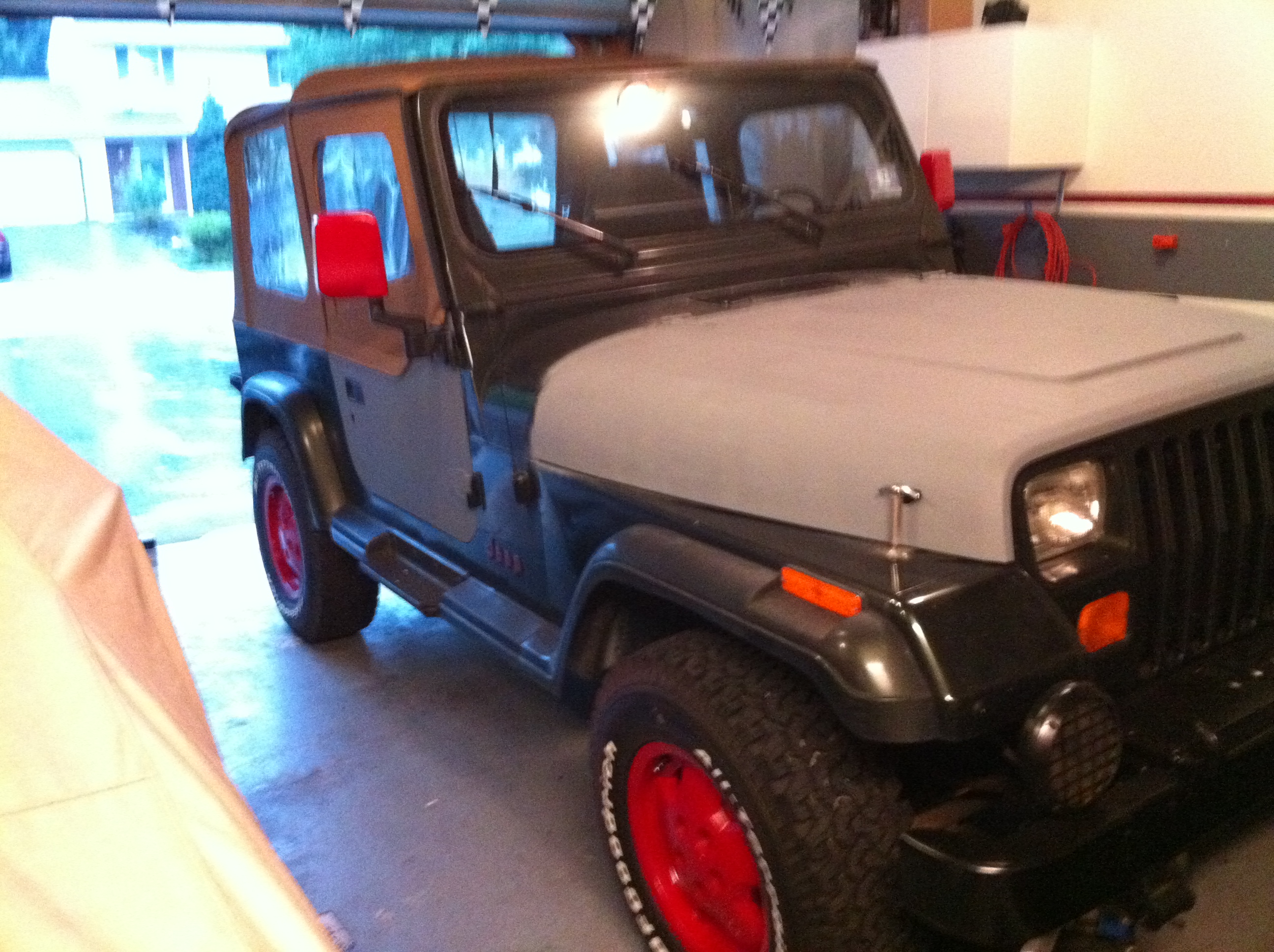

a little more progress, got a complete top with all the hardware including upper doors off craigslist . sorry for the crappy picture it finally started to rain so the jeep is in the garage.
Also painted the front wheels.

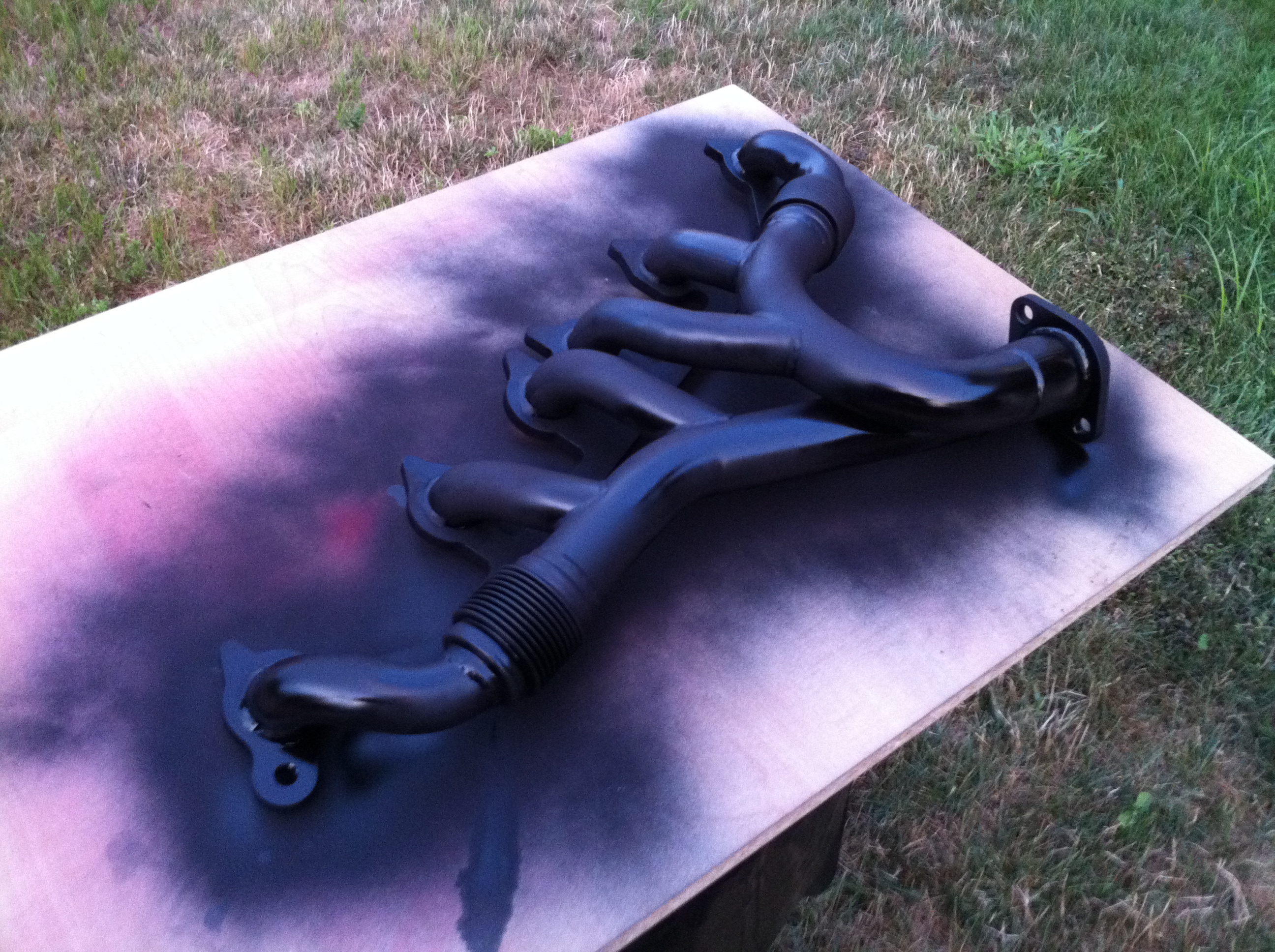

This weekend we will be replacing the cracked exhast manifold....joy joy...
all painted and ready to install

Put one of those on mine, it works well. Watch that back stud, I ended up snapping mine off when I was torquing it down. That was fun welding on a nut to pull the old stud. Don't do that

Did you just spray that with black spray paint or is it something a little more durable?

the mainfold is stainless so i really didn't need to coat it at all but i wanted it black so i hit it with 1600 degree high heat header paint.

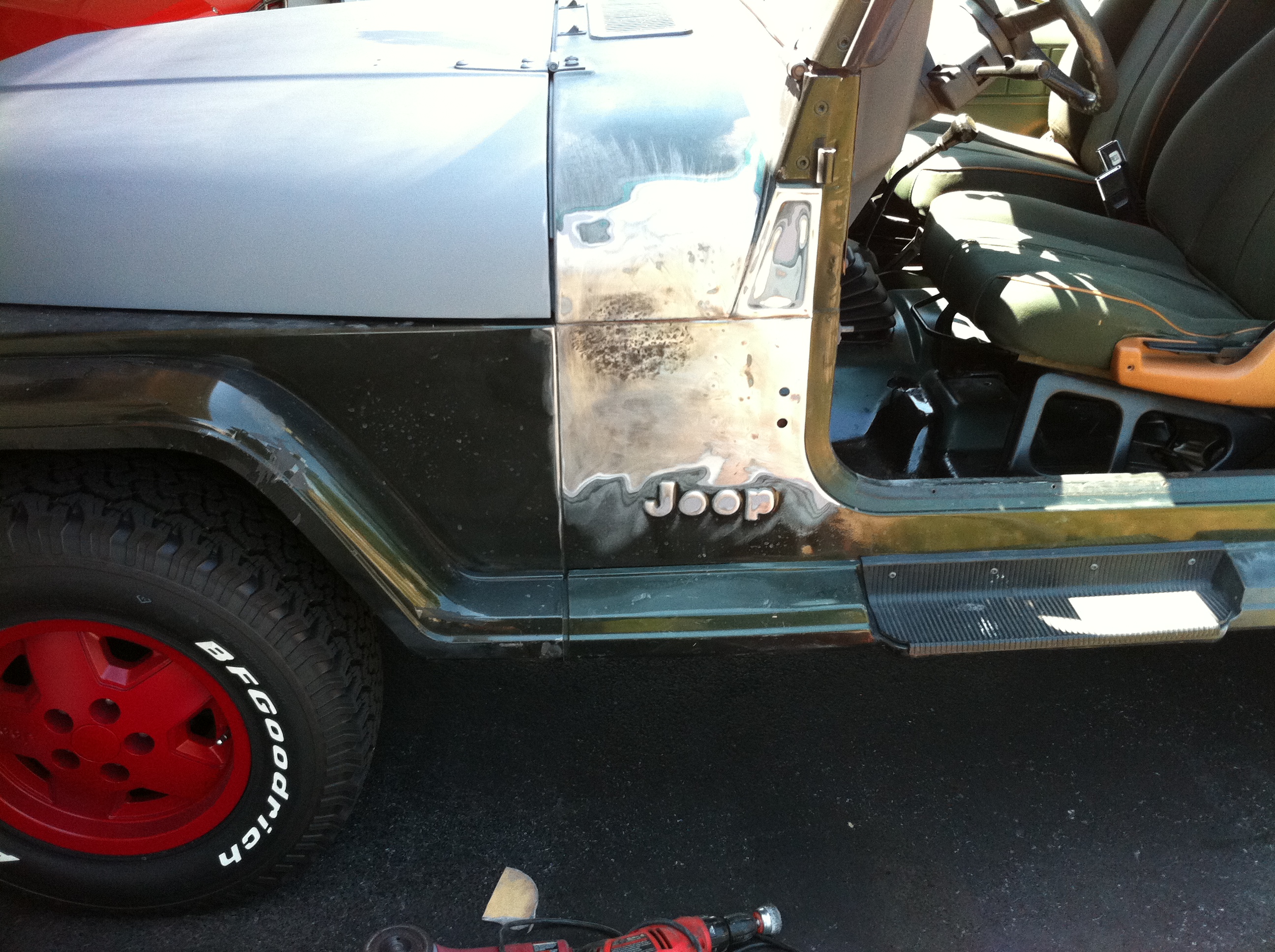

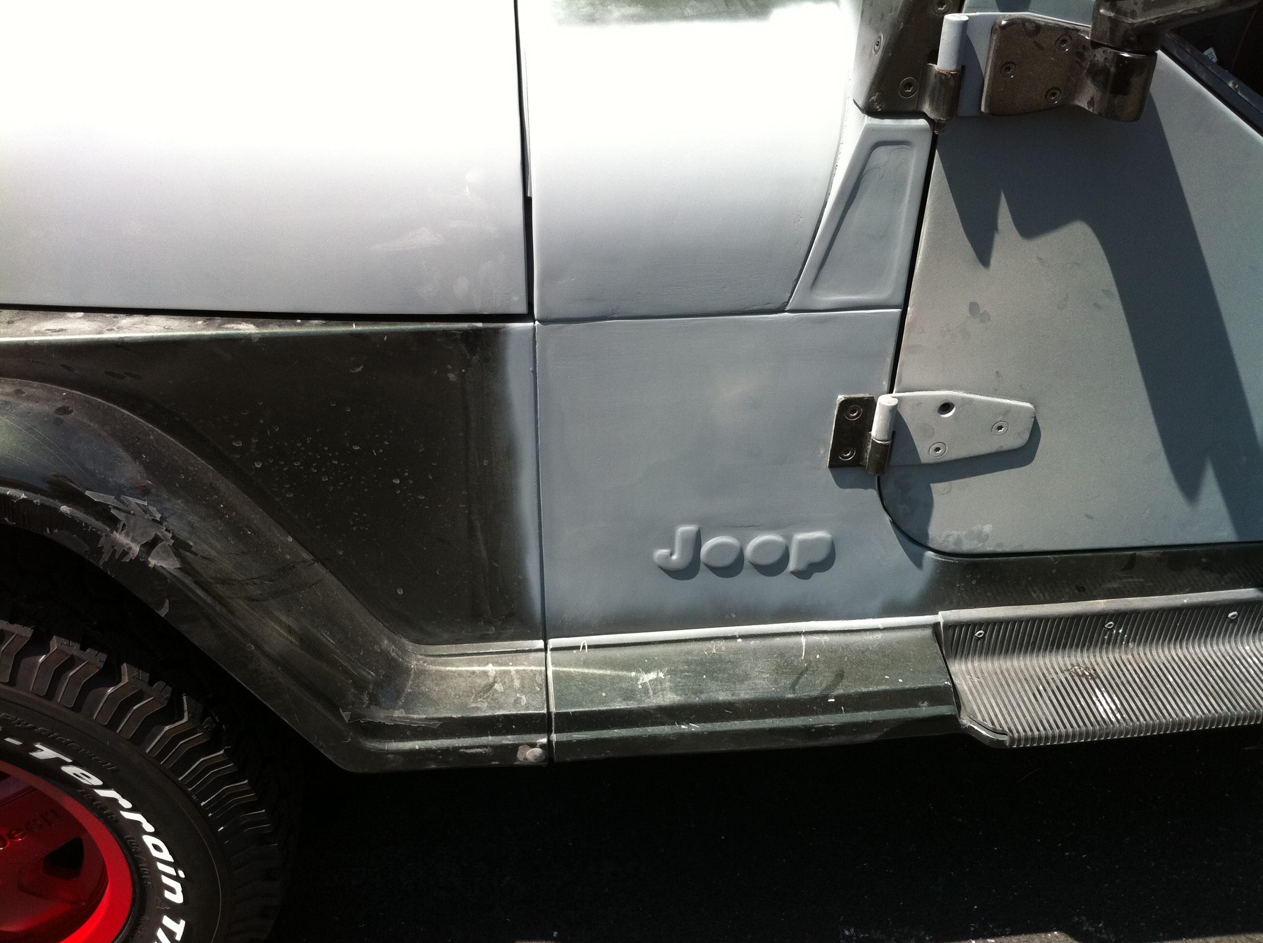

last night i worked on the only rust on old #12. Looks like it was in a fender bender a few years back and was not properly repaired. i ground out all the old body work and took it all down to bare metal, then got rid of all the surface rust and metal prepped the area. Then i pounded out the dent and hit it with some bondo and light sanding. it is all straight again and no rust.
here are the before and after shots
this is how i bought it.... during the repair..... and after...... now it just needs finish sanding and primer sealer.

Beautiful! Muchh better. Looking back now with my jeep I wish I had paid more attention to all the little dings and details that I just kind of blew over... So kudos to you for taking your time!
