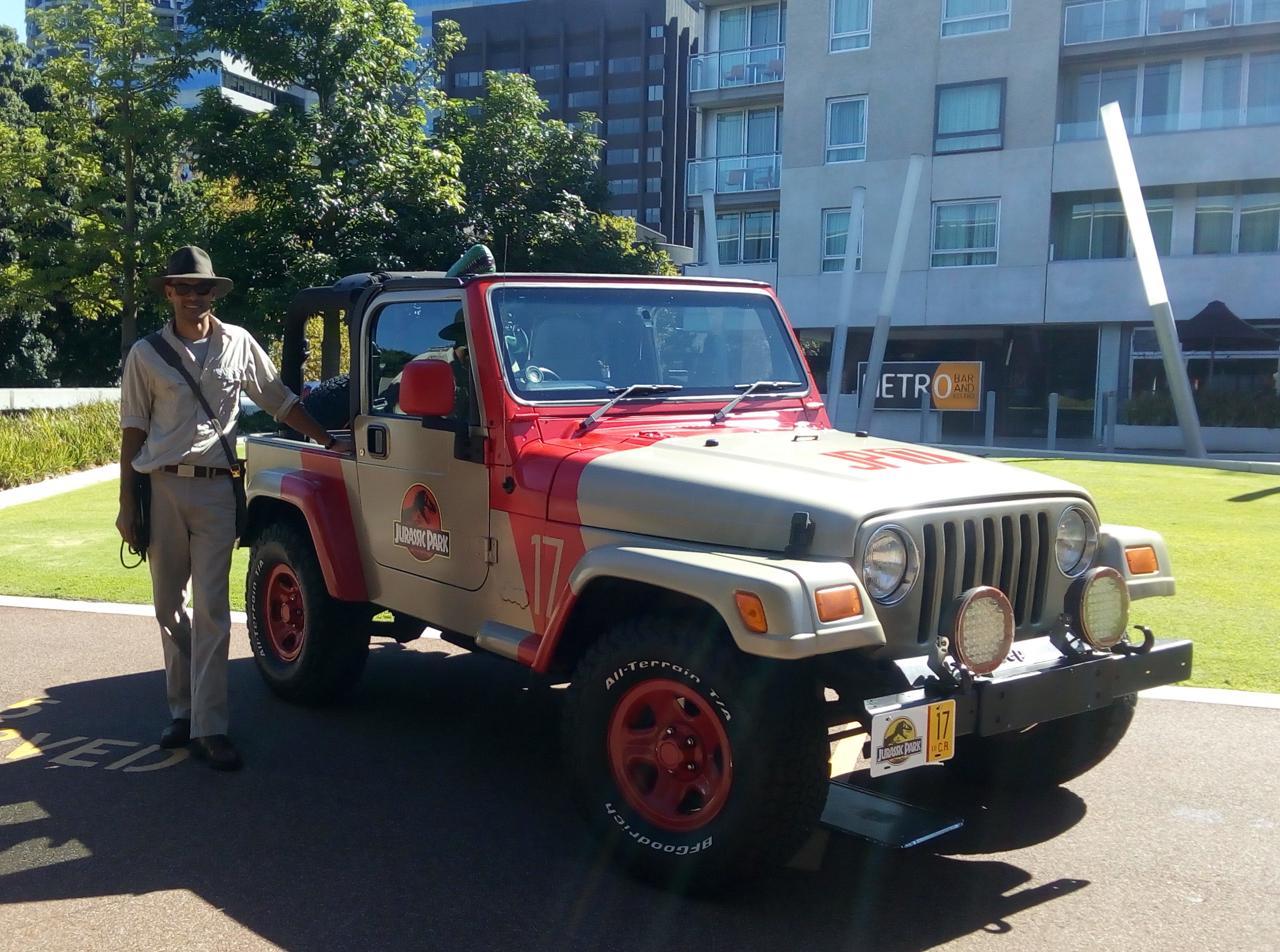

I love the tread pattern on the BF Goodrich tyres, the certainly improve the look over the standard tyres, I noticed you are in New York. I will be visiting the Big Apple from Australia from the 10th-21st of April, since we both have number 17, I was wondering if we could meet up? I will be staying in Brooklyn, are you very far?
Took my Jeep to the Perth Comic Con, it was a big hit, I was going as a Storm Trooper (I know, shouldn't mix the franchises), but my costume didn't arrive in time, so I went as Indiana Jones

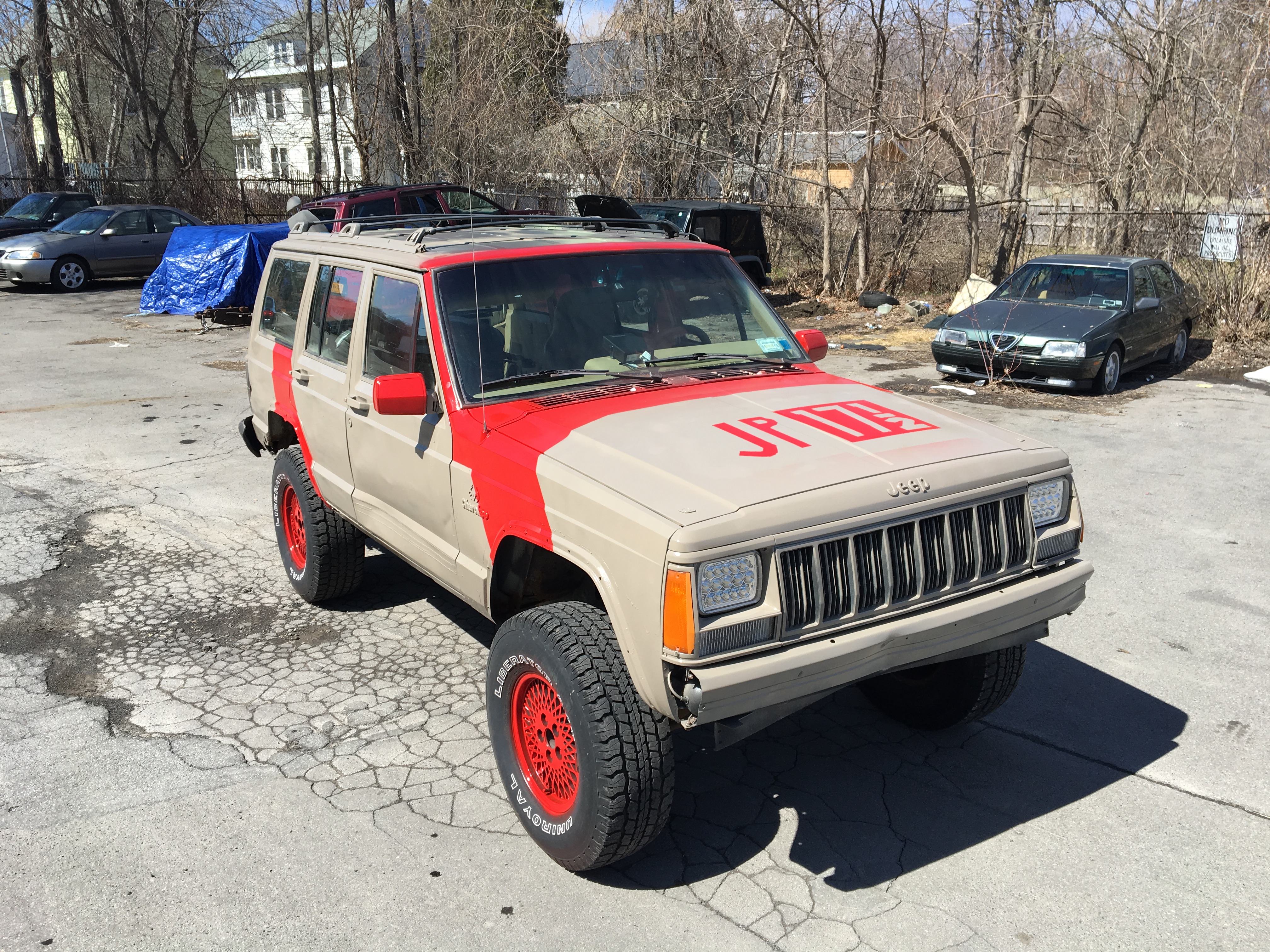

Your TJ looks great by the way. It looks like you use Rustoleum fossil, did you? Is it rattlecan or HVLP?
NY is actually a pretty large mostly rural place. Sure, it's looks tiny up against Australia, but from where I am smack-dab in the middle of the state, it takes me 5-6 hours to get to Brooklyn (make that 6-7 hours in a Jeep).

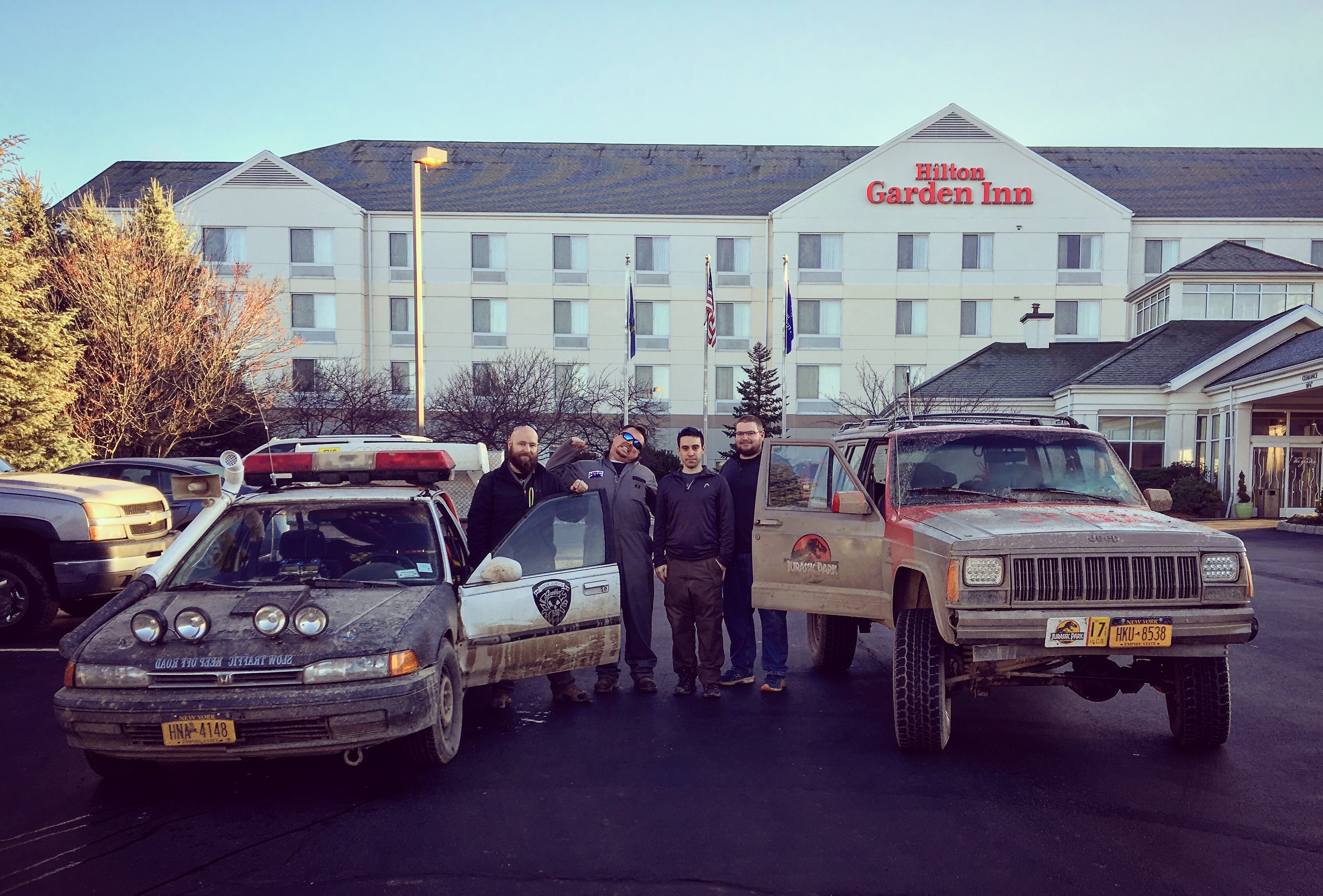

Next weekend I'm in a Gambler 500 rally race, and my team's vehicle is a Cherokee XJ. We decided to rattlecan it JP 17 1/2.
Spared all expense.
Spared all expense.

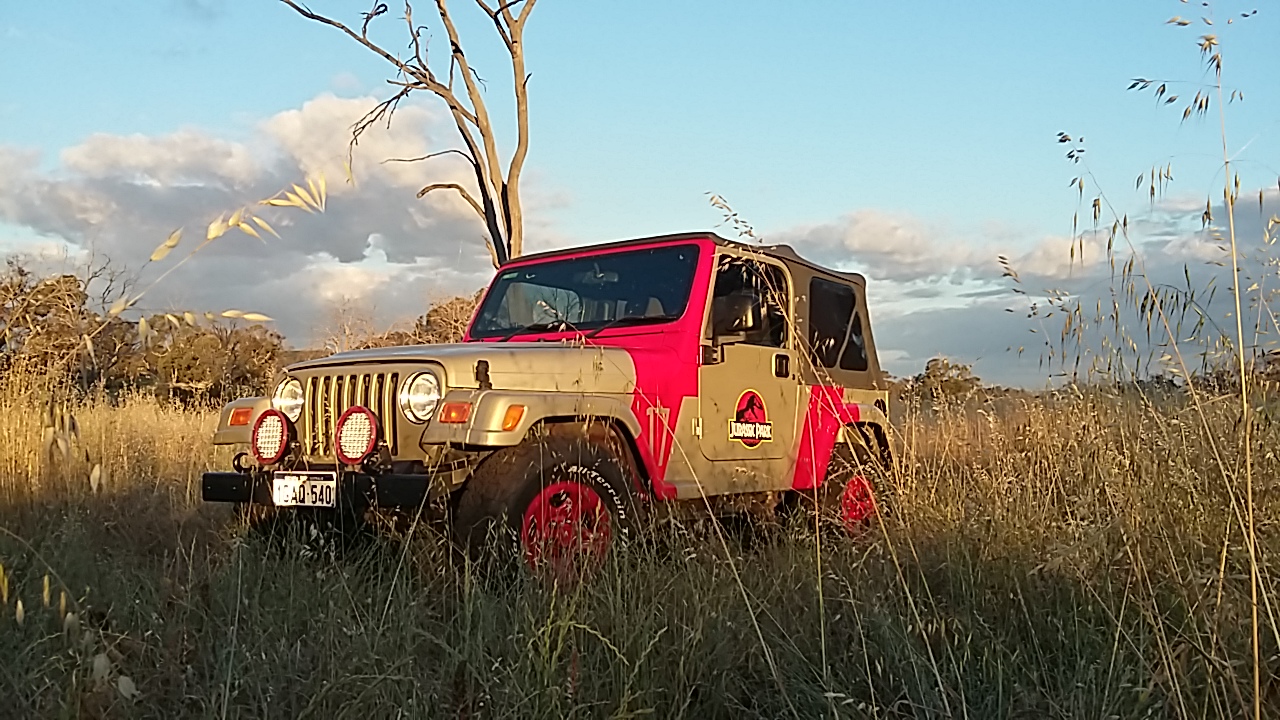

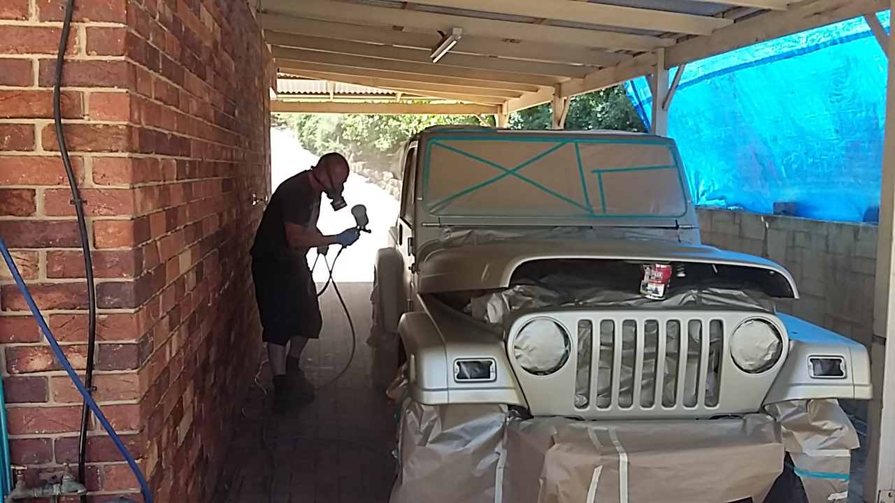

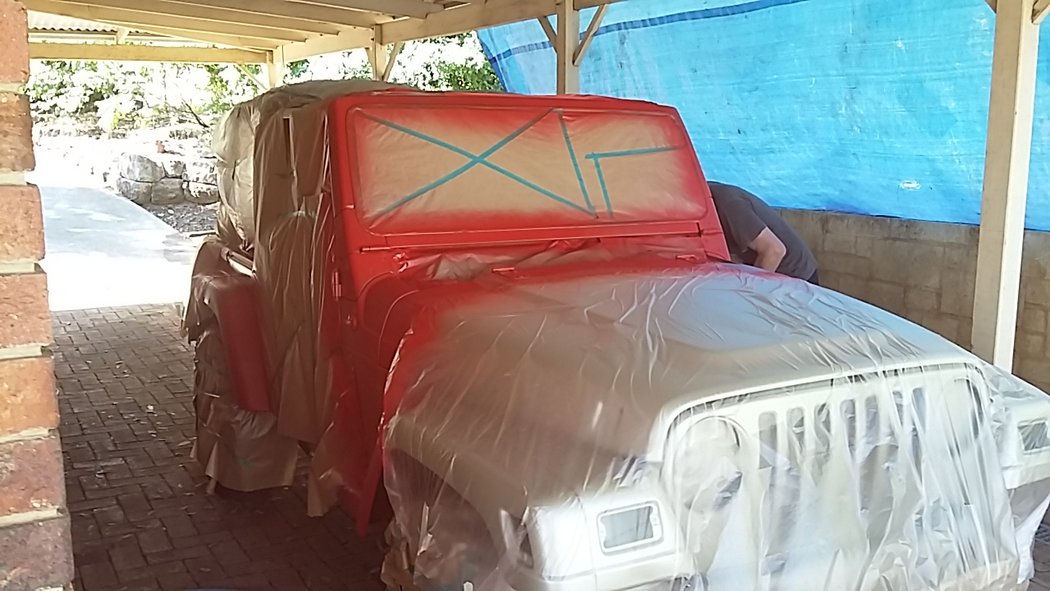

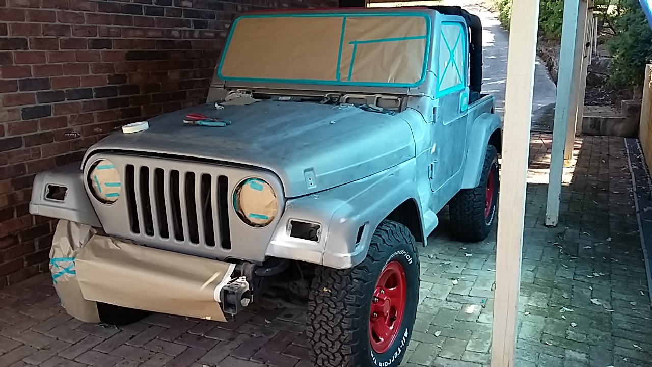

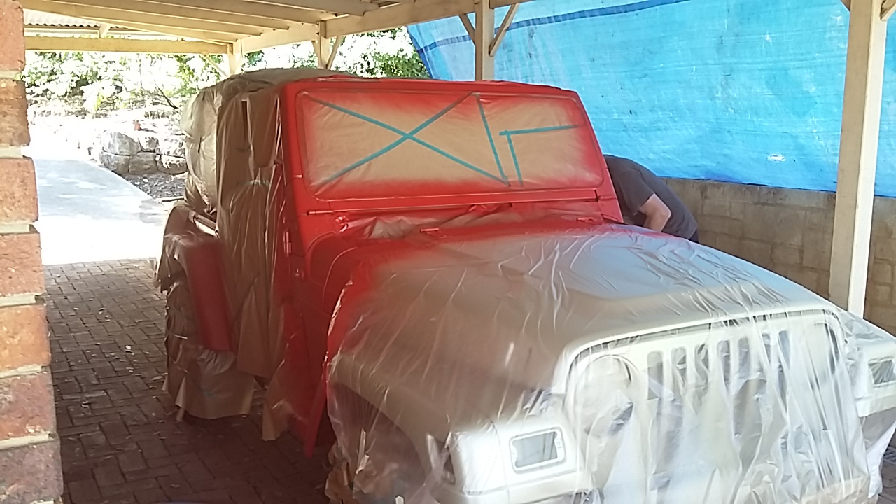

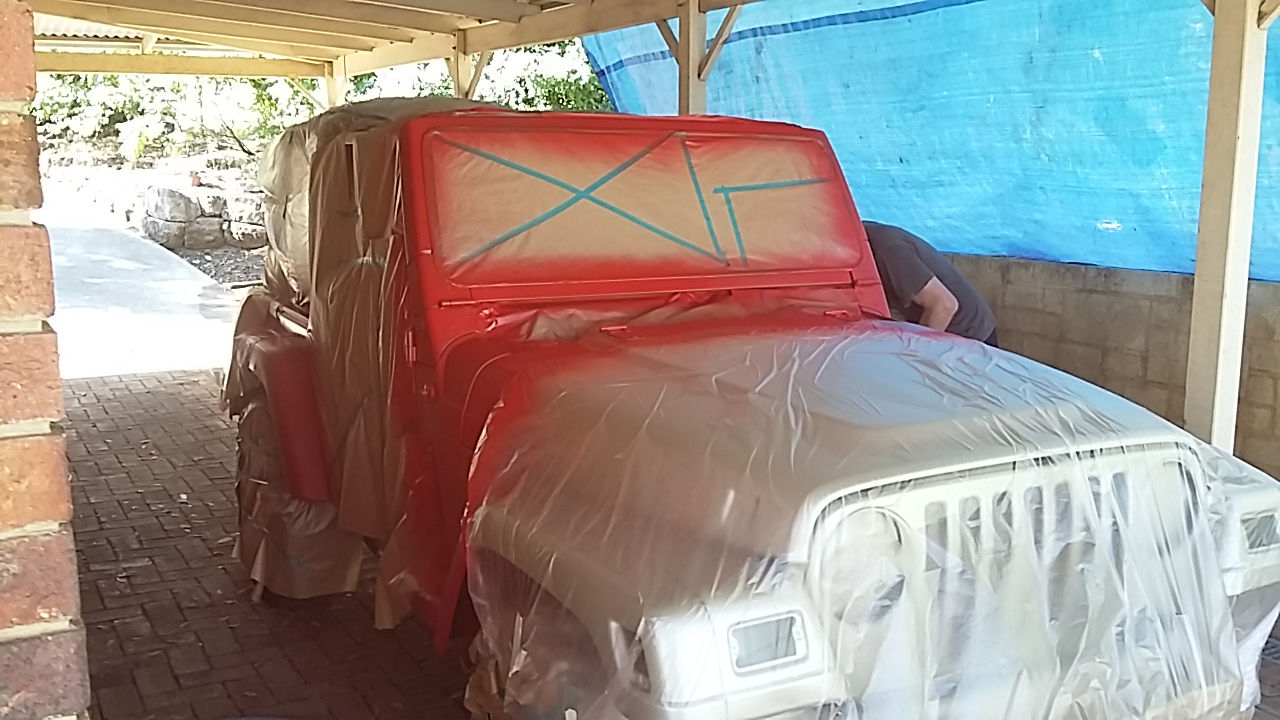

Thanks for the compliment, my TJ was a quick spray job, my friend is handy with Two Pack, we used the correct Sand Beige, but satin not the matte finish and the red is Dulux Flame Red to match the powder coating on the wheels. There is a guy here in Perth, who bought a YJ grille, bonnet, front guards and flares and modified a TJ, it looks fantatstic, I certainly didn't put as much effort as him or others on this forum, but I'm happy with the results and so are many people that see it, I'm always getting compliments, it is my everyday driver. The correct alloy wheels are impossible to get here, so I opted for the original steel wheels as I found a pre-production photo on the internet showing a JP Jeep sporting the steel wheels. I'm still adding items, I fitted Rugged Ridge bumperettes recently and I'm waiting for a 102" whip antenna to arrive, I was thinking of buying a spare TJ grille and trying to modify it to accept rectangular headlights, but I'm in no rush. I'm looking forward to seeing photos of yours once it is finished.

I figured you would be a fair distance, but I thought I would ask. I get the same here, often friends/family from the UK will say do you know so and so, they live in WA and I have to explain that Great Britain would fit into WA just over 10 times! WA is bigger than Texas, California, Montana, New Mexico, Arizona and Nevada all added together, so I understand the distance thing.

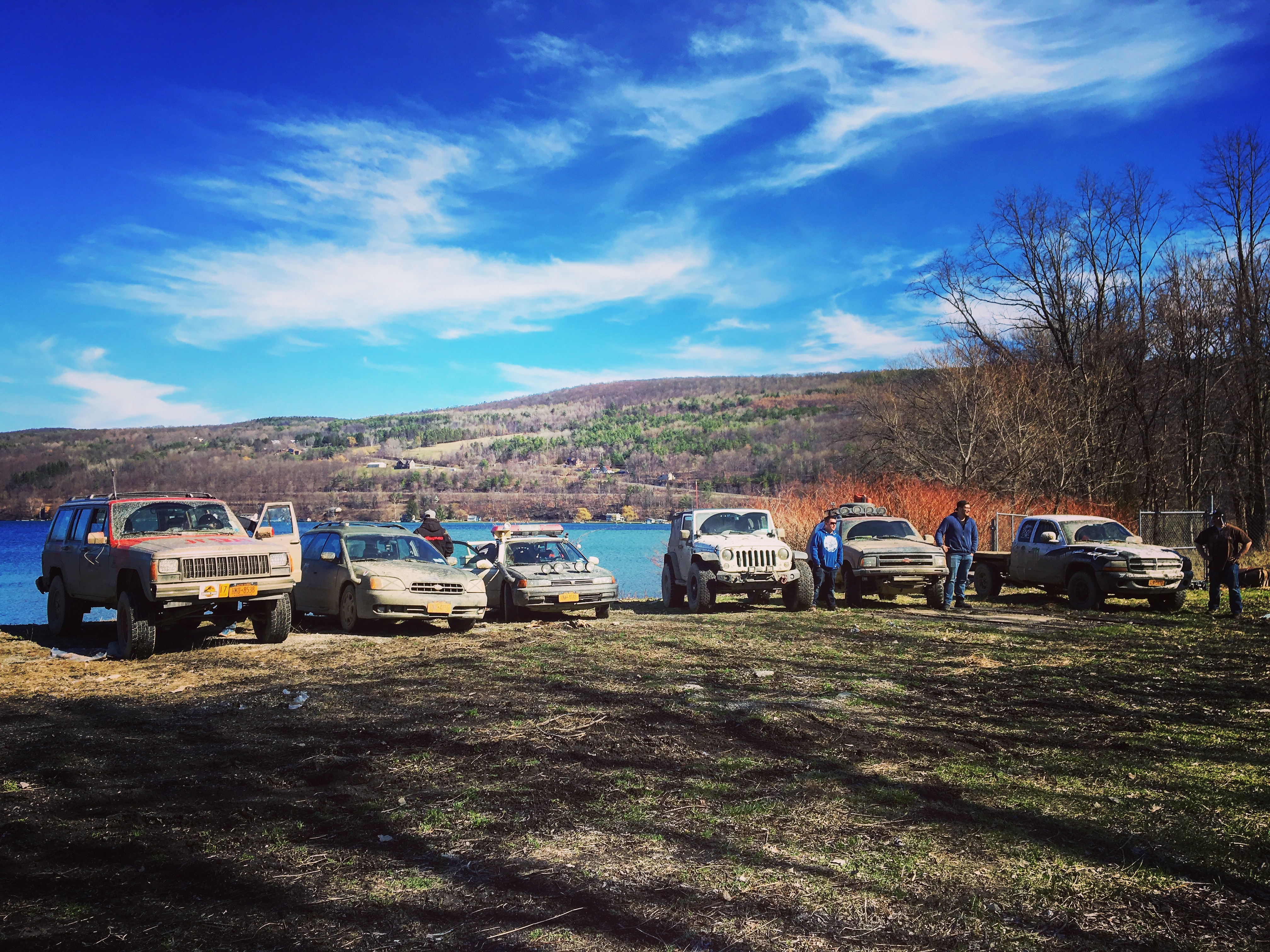

The first ever Gamber 500 NY was a huge success. Met a lot of great people and had a blast riding around. Unfortunately the Honda traveling with us snapped a timing belt about 410 miles in.

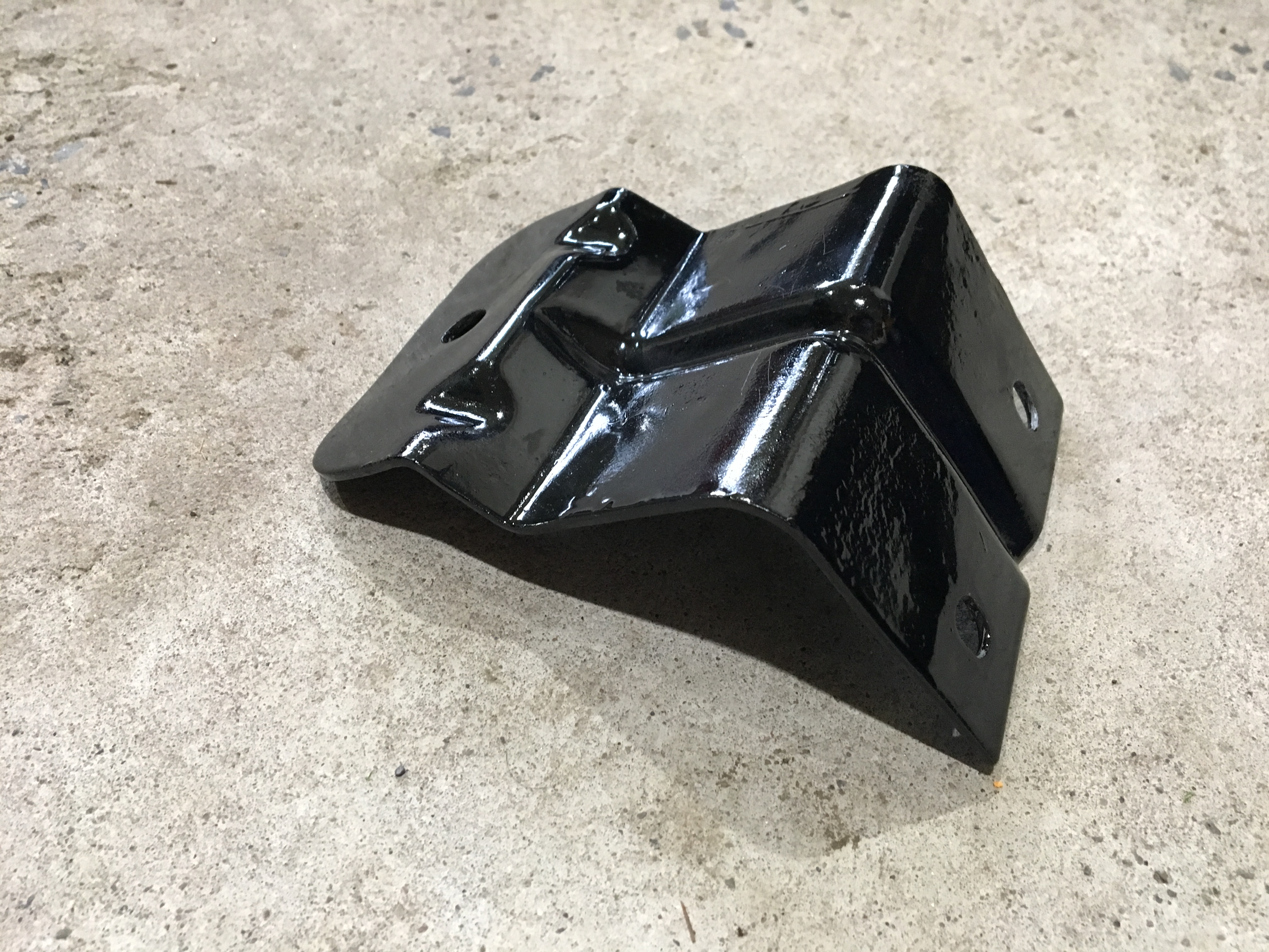

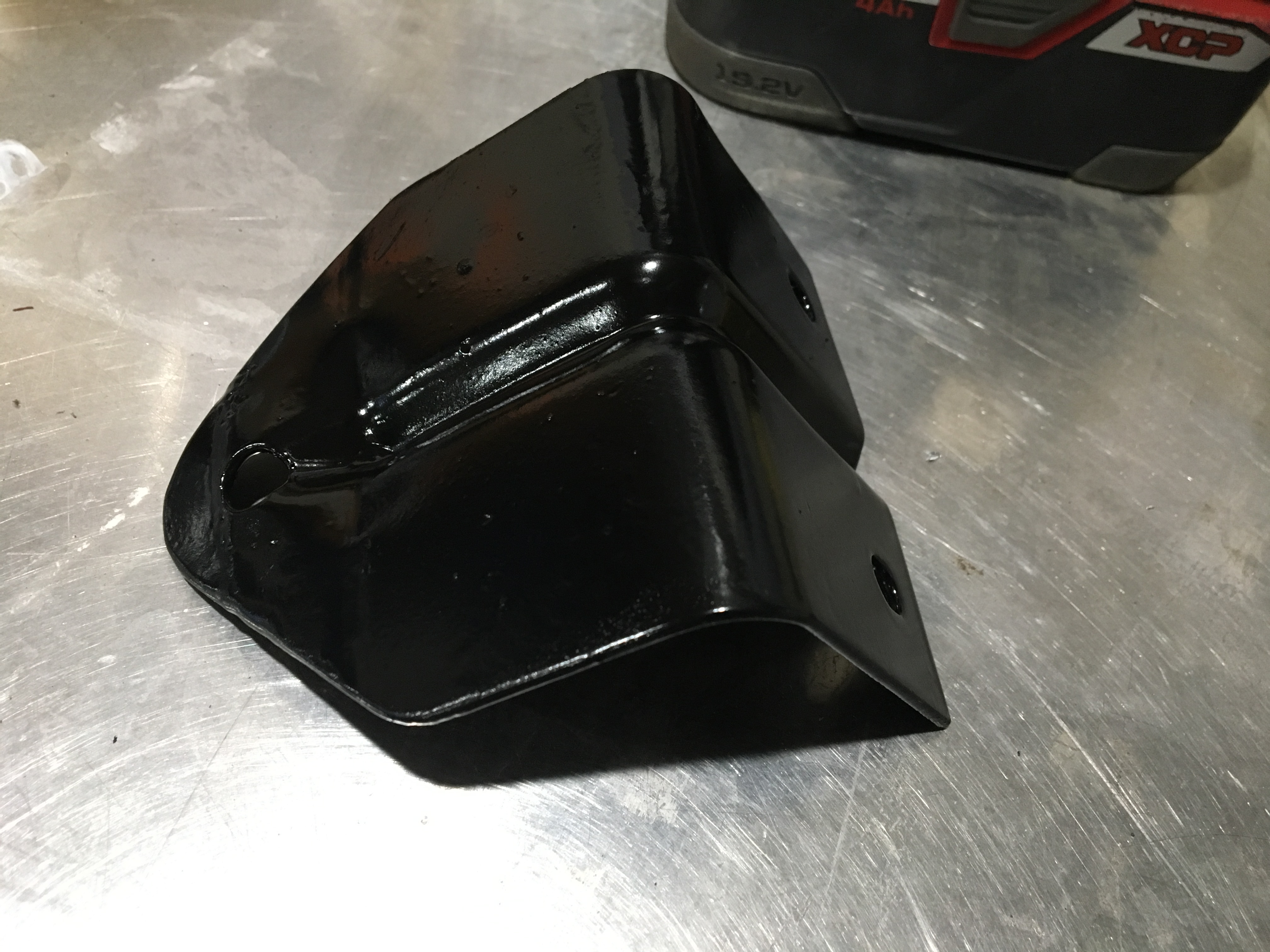

I have been having trouble locating another Mopar 56002290 fog lamp bracket, but I did find a Mopar 56002830 which is very similar but intended for the older rectangular fog lamps. So I took an angle grinder, vice and hammer to it and turned it into a less than perfect 56002290. No one but me will ever know the difference.

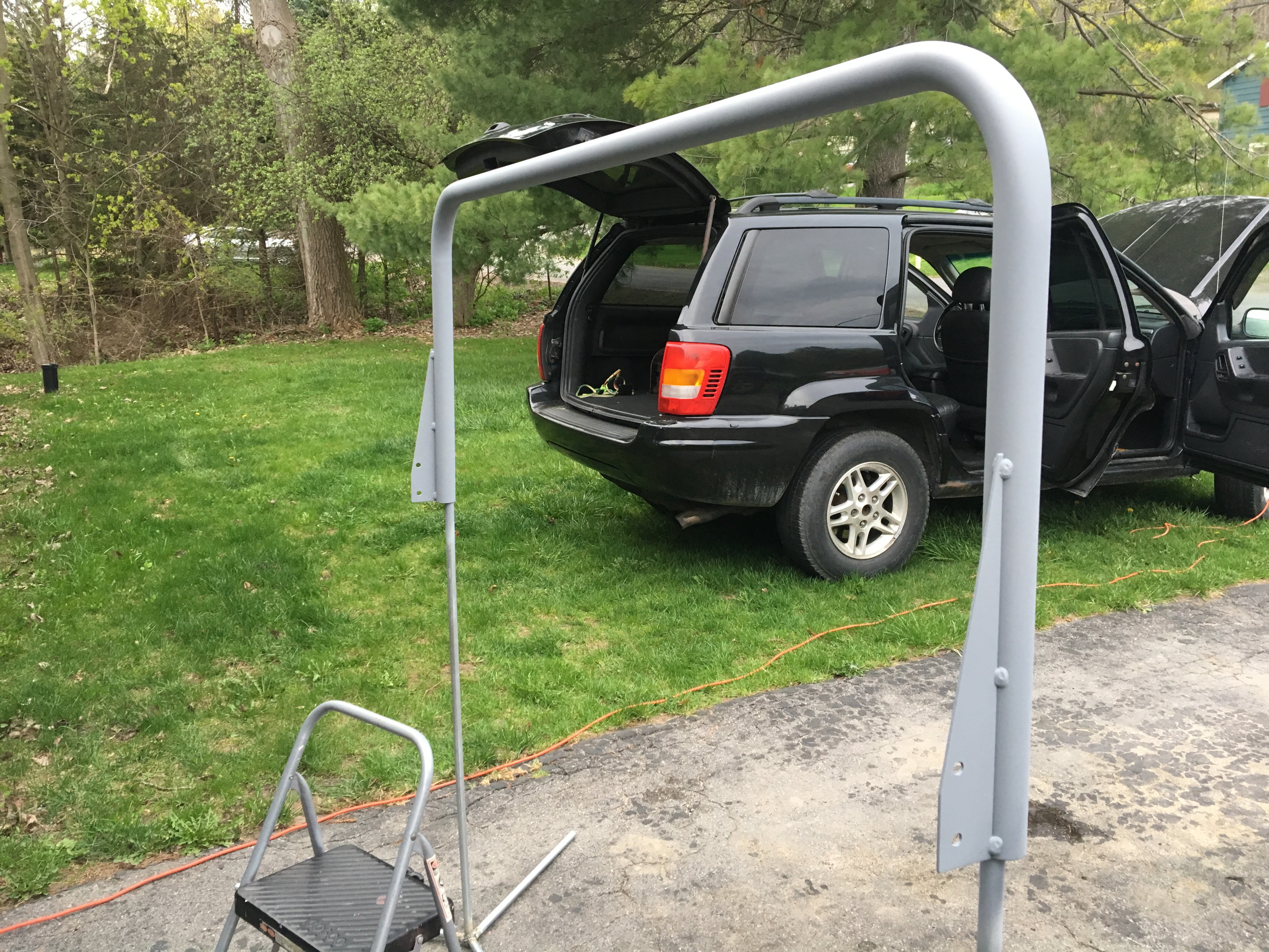

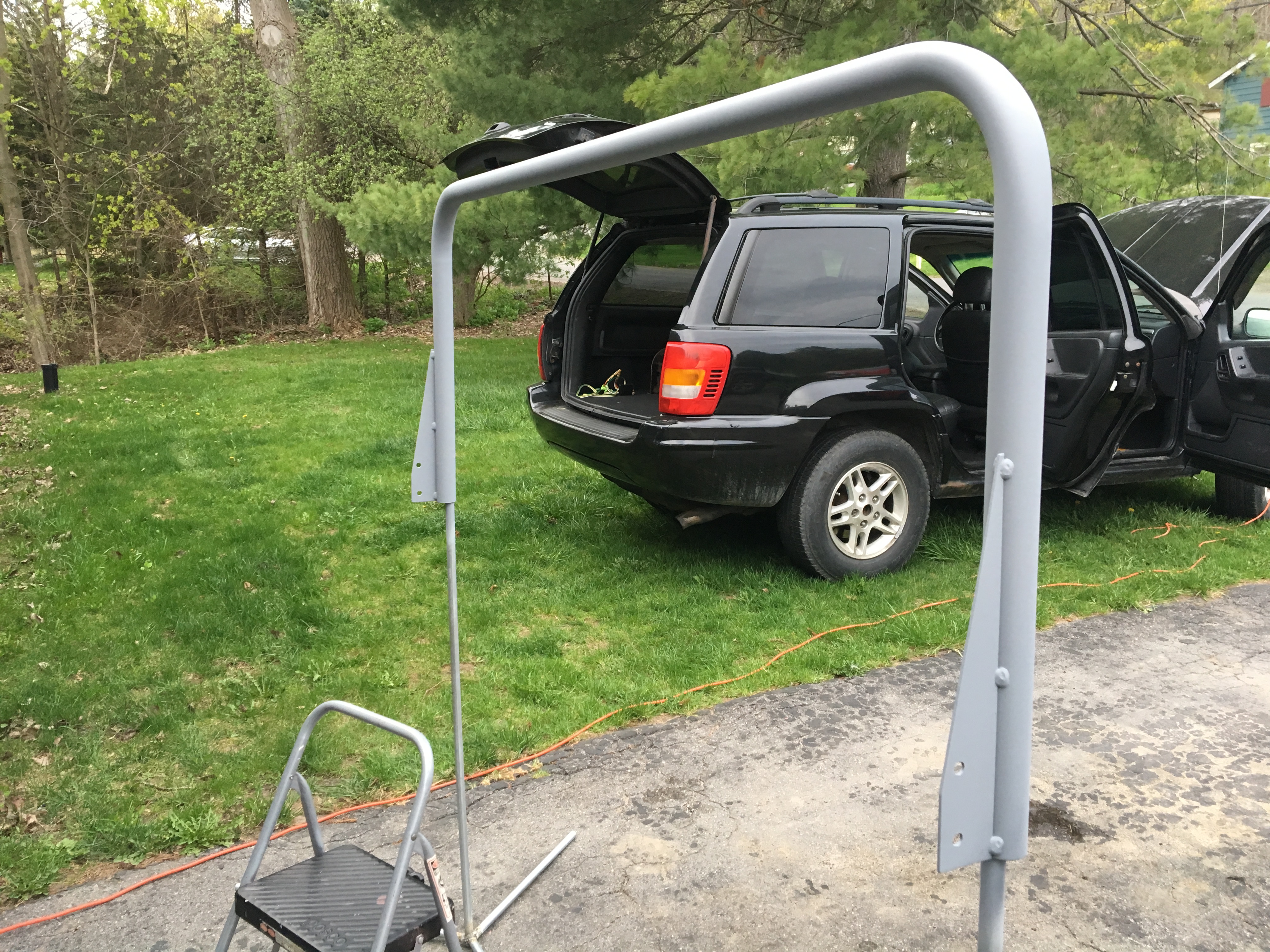

I'm also painting the light bar. I couldn't figure out a good way to mount it for paint, so I welded together some conduit tube to make a paint stand.
