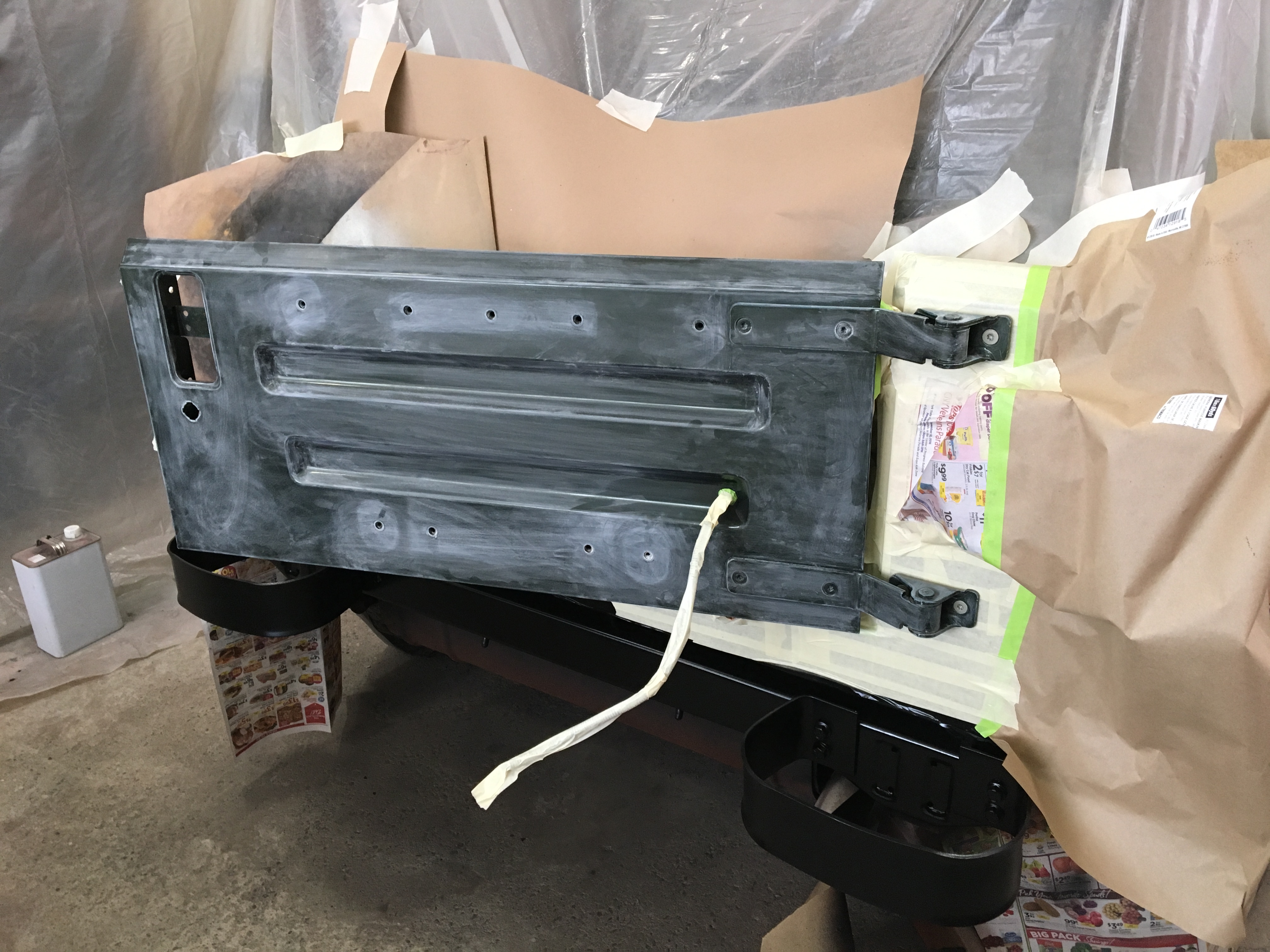

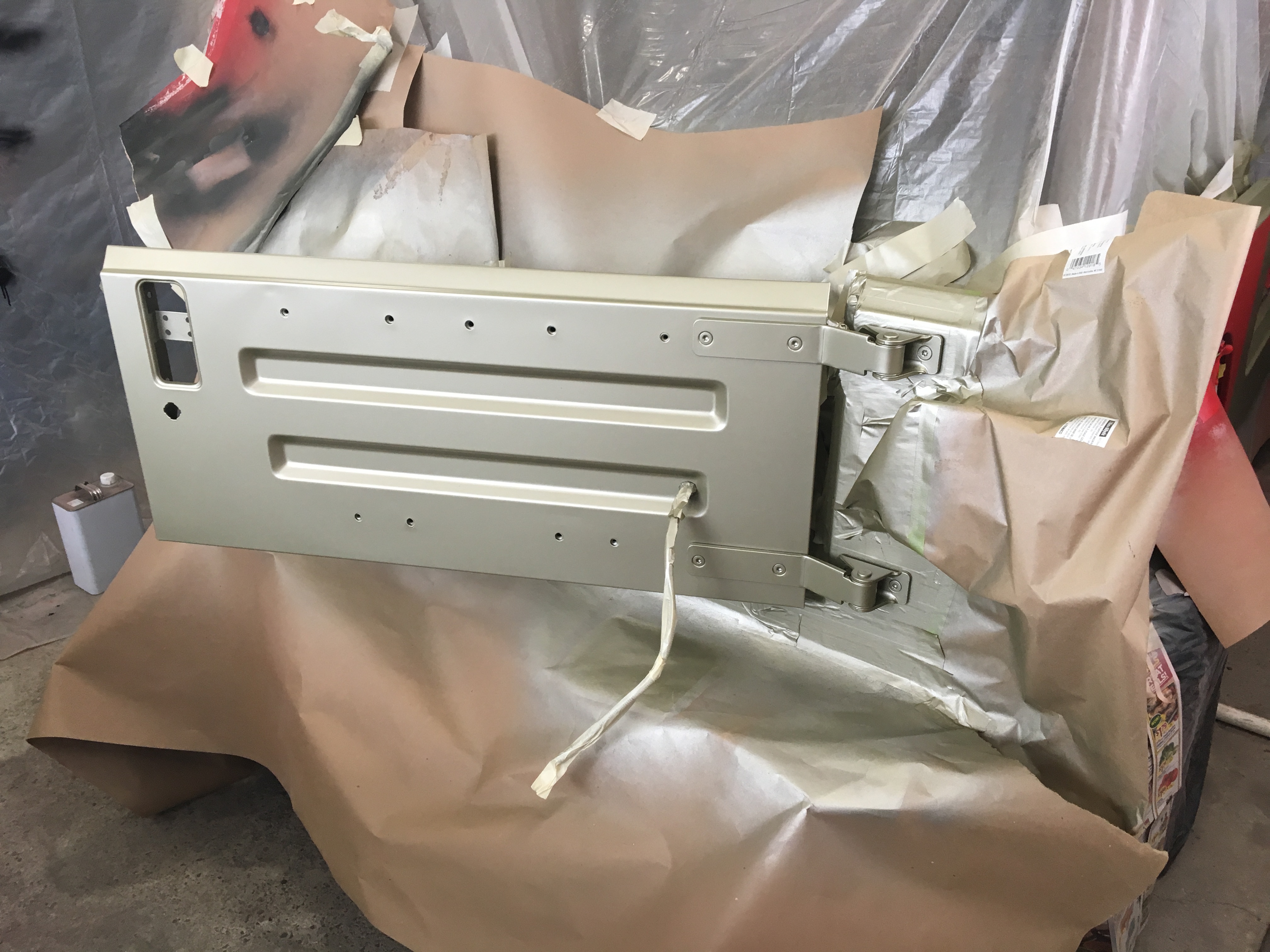

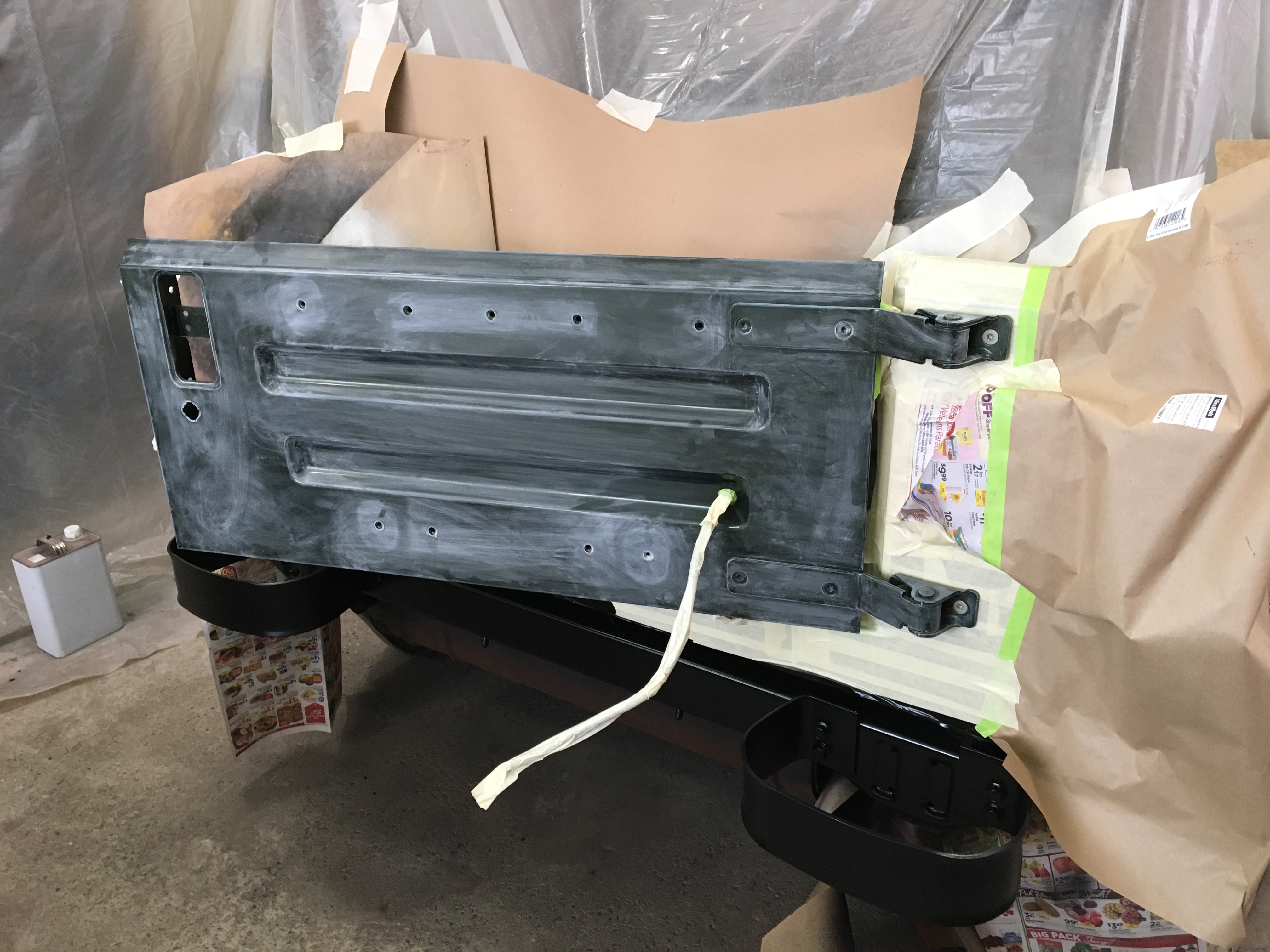

Rear frame and bumperettes restoration, and tailgate spray. I clipped the third brake light cable, I'm going to install a waterproof connector plug: Plus some finer details:

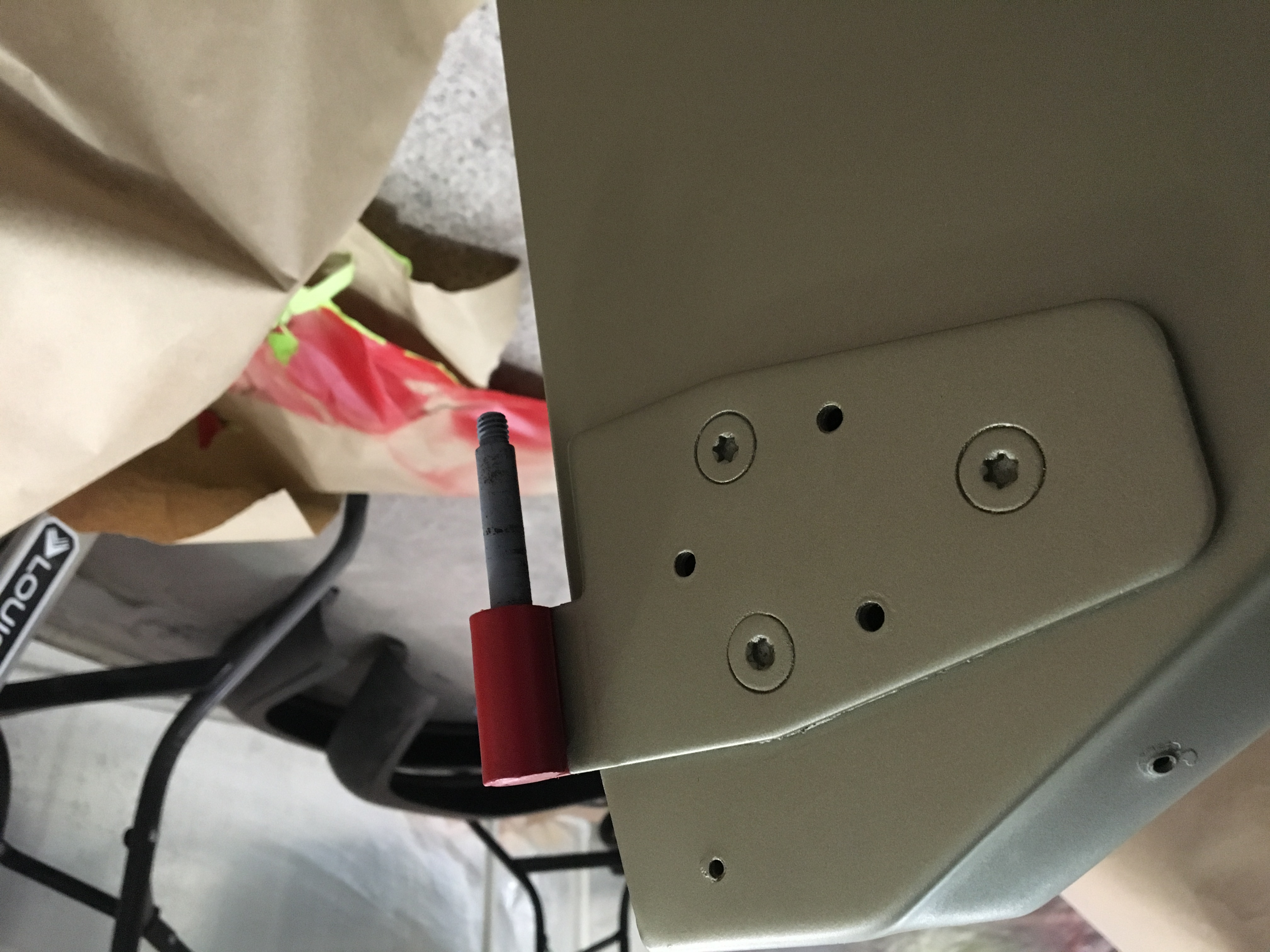

In the meantime I worked on the small pieces and parts. I'm a details person, every single nut and bolt matters. I ordered new high quality nylon door straps, rubber caps that prevent door straps from coming off, I restored the door strap hooks, retapped the holes I wasn't happy with, and replaced the door strap hook hardware with tapered head stainless steel bolts. I also restored door handles, new hood tie downs, and a bunch of misc stainless steel hardware.

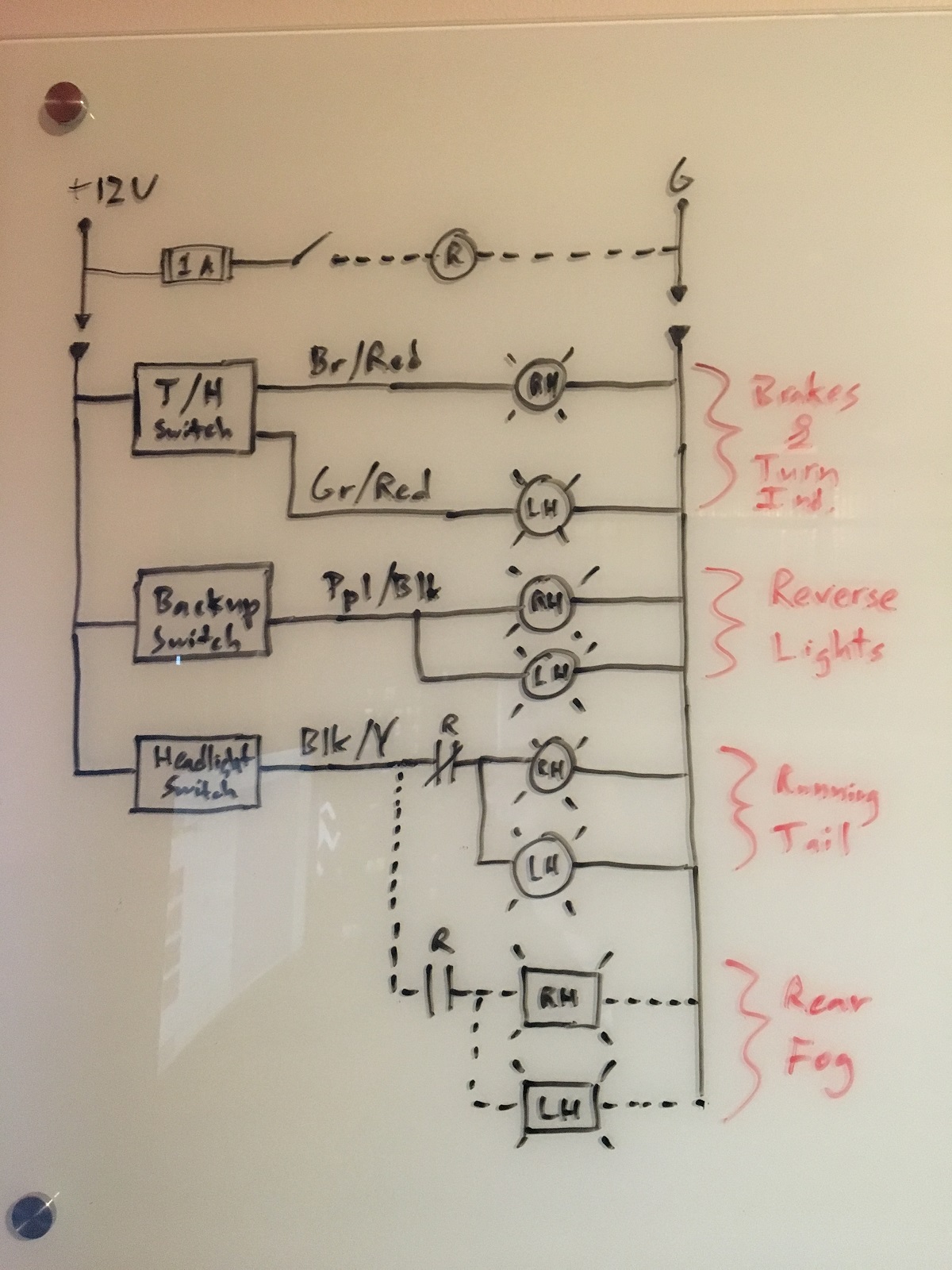

I also sorted out my tie in points for the rear fog switchover relay. I used the factory wiring diagrams as a reference. I can honestly say, after working with ladder schematics for so long, I've come to hate point-to-point wiring diagrams with a burning passion. Also... the Jeep engineers need to get their proper color consistency/conventions together, one page says "Purple/Black" wire the next says "Violet/Black". Well guys, which is it? Someone go back to the early 90's and teach them modern manufacturing quality control methods.

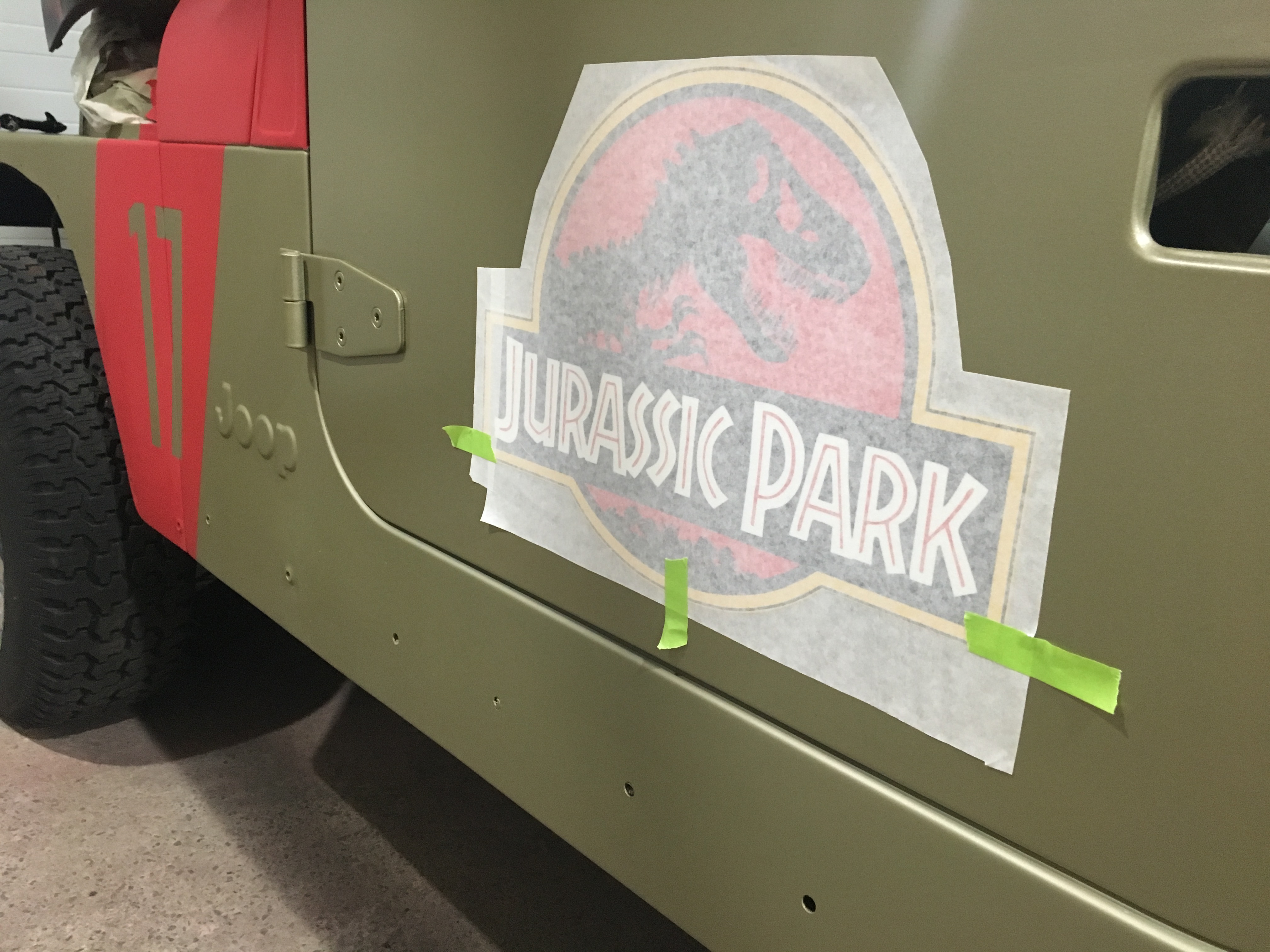

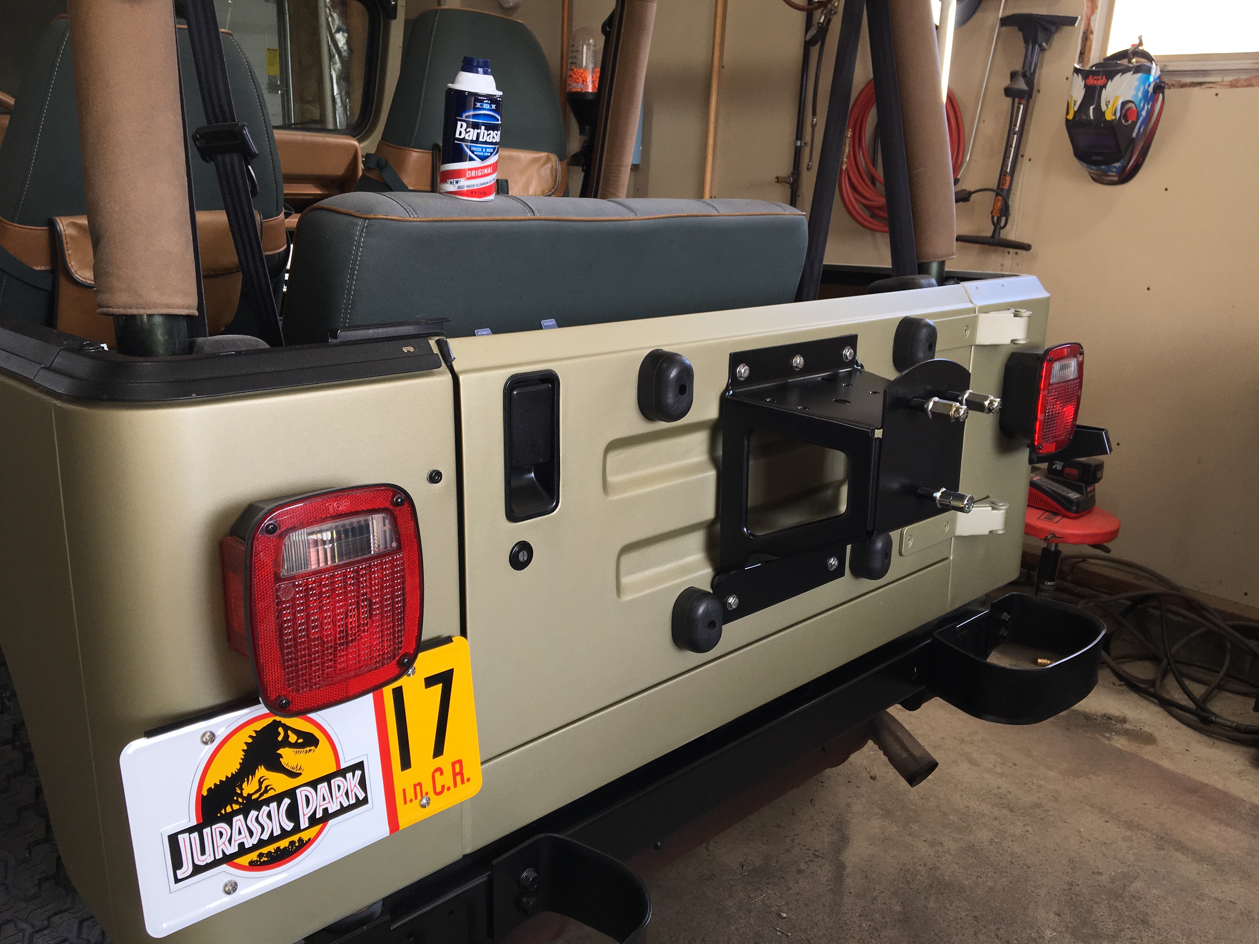

I've had a few setbacks, but I'm pushing forward again. Paintbooth is ripped down, I'm done with everything except that requires BC/CC except the windshield front, mirrors, and hood. I've been traveling for work the past two weeks so any progress has been sporadic and slow.
Although not really necessary, I painted the inside of the windshield Sand Beige Poly to match the movie. (Not Pictured). I also replaced the wiper motor that was making some noise, and restored the VIN plate.

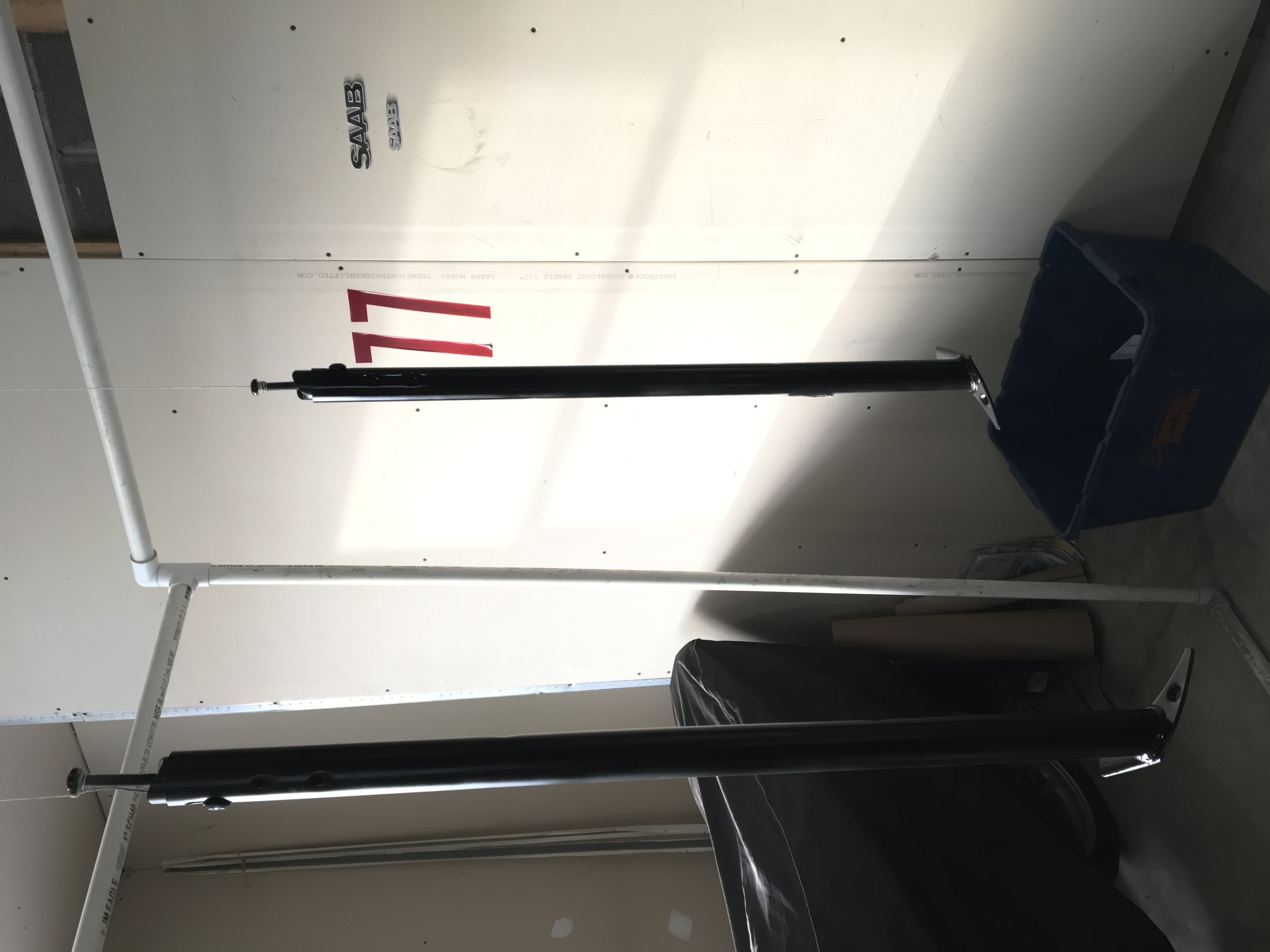

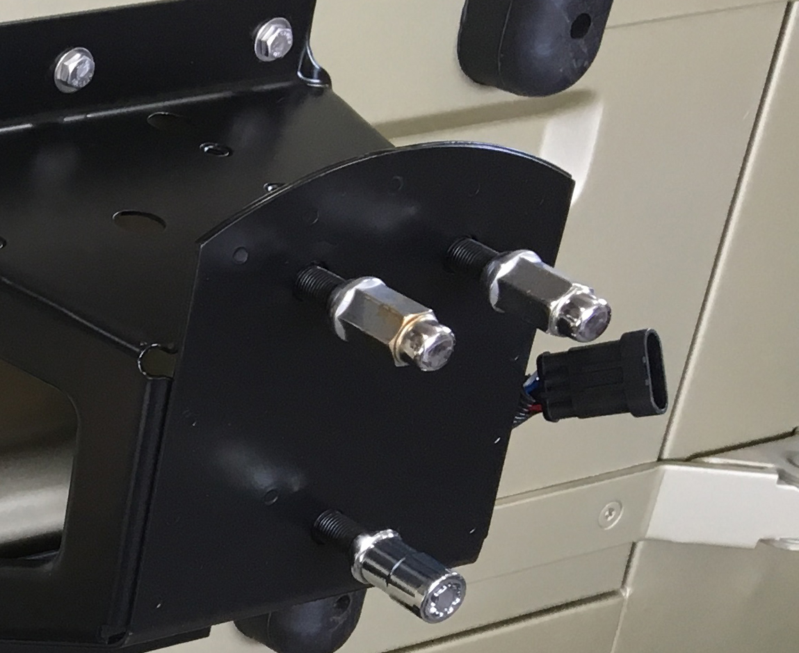

Doors are back on, brand new weather seals, labels applied, door handles have been re-painted, springs have been oiled. Good as new. The rear area is done. I haven't mounted the rear fog lights yet, but I did restore the fuel neck cover, the license plate frame, the tail lights, repainted all mild steel hardware semi-gloss black, restored the spare wheel bracket, replaced the spare wheel bracket hardware with stainless steel, painted the tailgate latch, replaced one of the spare lug nuts with a unique key anti-theft nut, bumper was previously restored at a prior step. You can't see it here but I also chopped the third light wire and installed a waterproof 4-pin plug. If the state inspection gives me any grief about not having a third light I can easily pop it on and plug it in in a few seconds. Earlier on when removing the door sport bars, I found out the driver's side bar's rear bolt was completely sheared. Great. It took some work with left hand drill bits, but after slowly stepping up from pilot to 1/4" it finally broke free. Removed the passenger side and noticed the threads were all buggered up. I'm going to retap both of these roll bars and replace the hardware with new. In the meantime, the bars are getting repainted semi-gloss black which I feel looks best with a spice cover over it.

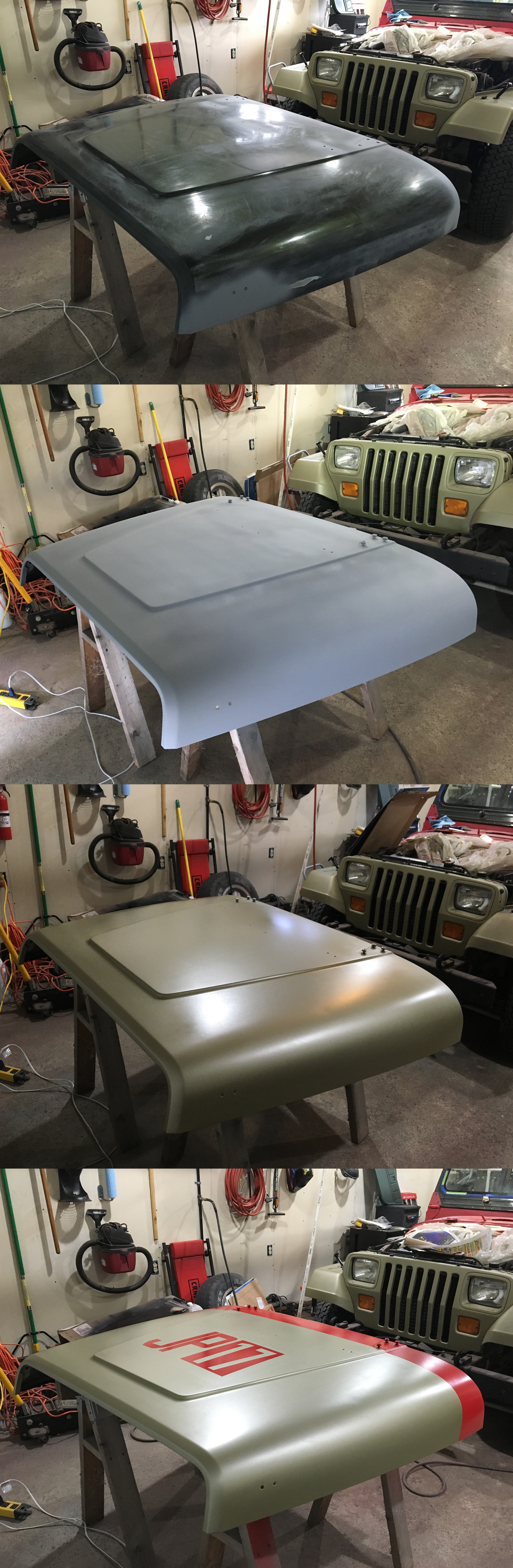

I'm completely exhausted but the hood is done. The angle sweeping from the sides of the hood to the front of the hinge is a bit tricky, however having the laser line made it very easy to put down straight.
