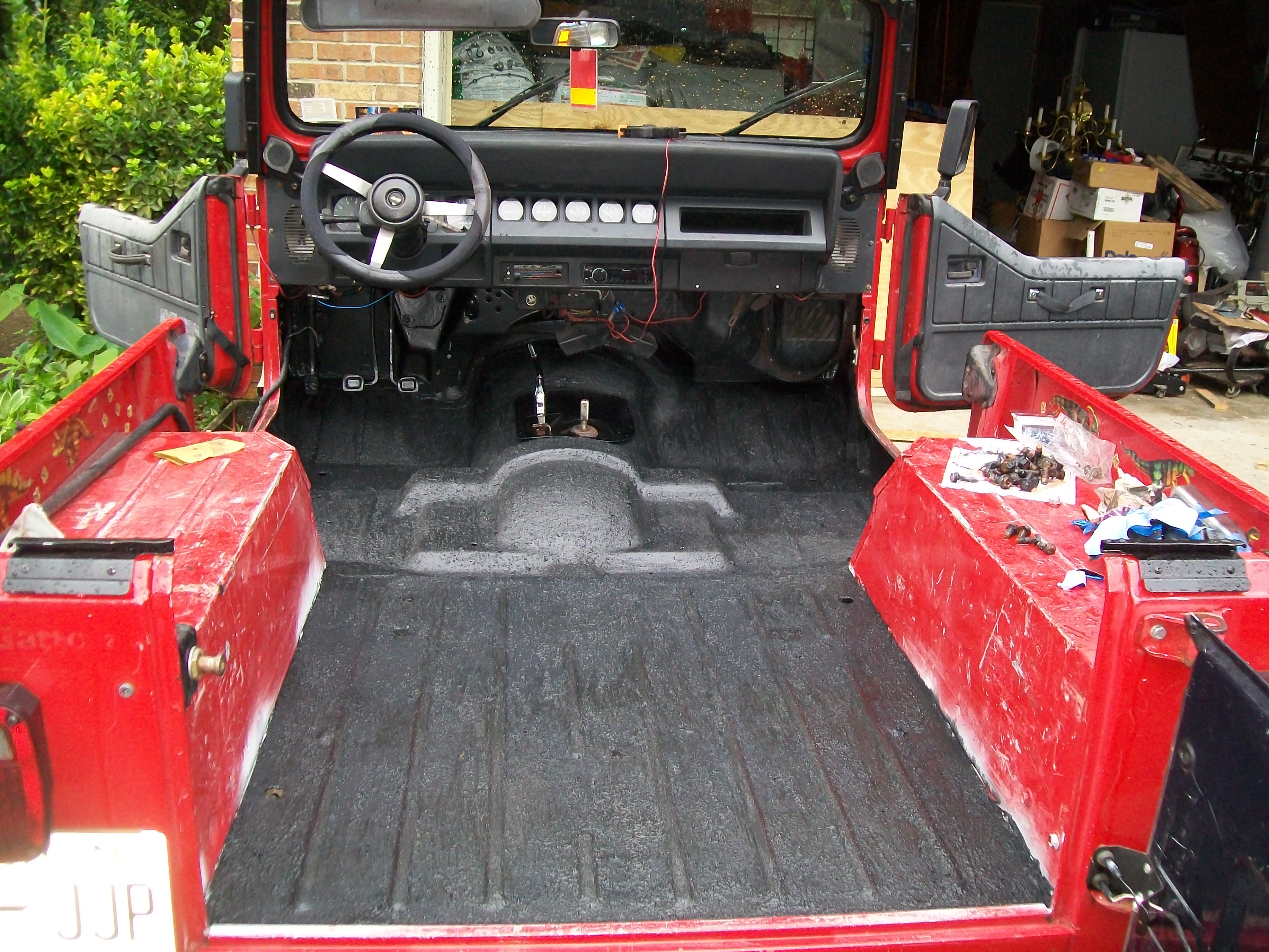

Post by dan85 » June 15th, 2010, 5:21 am
I Have Finally Got the Rino Lining done, after stripping a ton of bolts and having to drill them out
I Completely Removed all Paint down to bare metal, to completly get rid of all rust
I'm Going to be painting the wheel wells the sand beige color, when i get the money to buy the paint

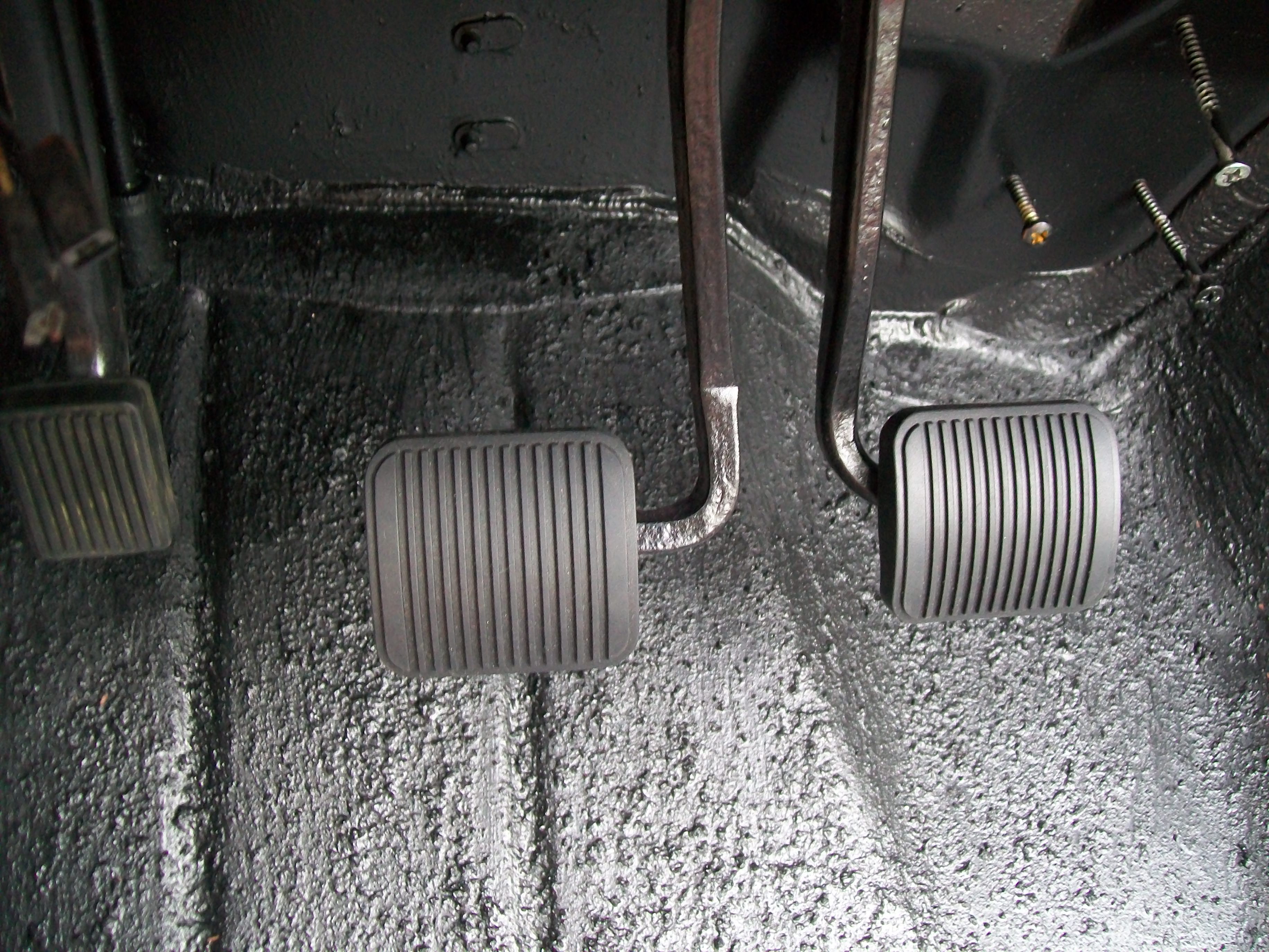

I Have Also Replaced the Pedals

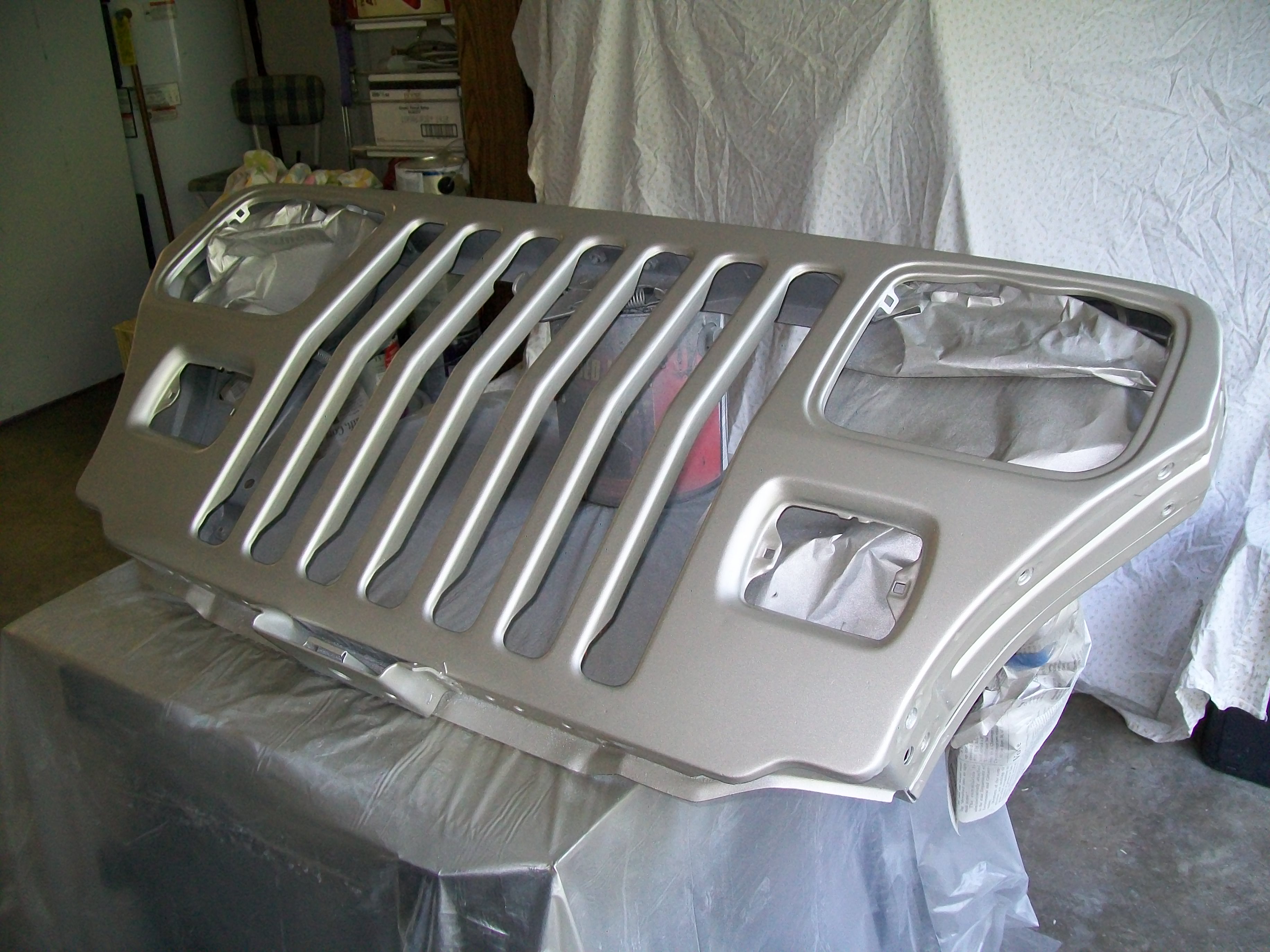

The Painting has started
Painting the Grill
Grill Before
Priming the Grill
Grill Finished

Post by AJ Quick » July 4th, 2010, 3:52 pm
Please tell us your methods. How you did it. What you used.. what color that is!
I would love to know, it looks great!
dan85
Posts: 106
Re: Dan's JP Jeep Project
Post by dan85 » July 4th, 2010, 4:04 pm
I used sand beige Metallic that I purchased at Sherwin-Williams car Paint Store, I sanded the paint and grinded off the rust spots. I sprayed self etching primer on the spots with bare metal and then sprayed normal car primer, sanded then sprayed the sand beige paint, put about 6 coats then sprayed the clear coats, still working on those says I have to wait 8 hours between coats, i'll probly put 4 coats.
