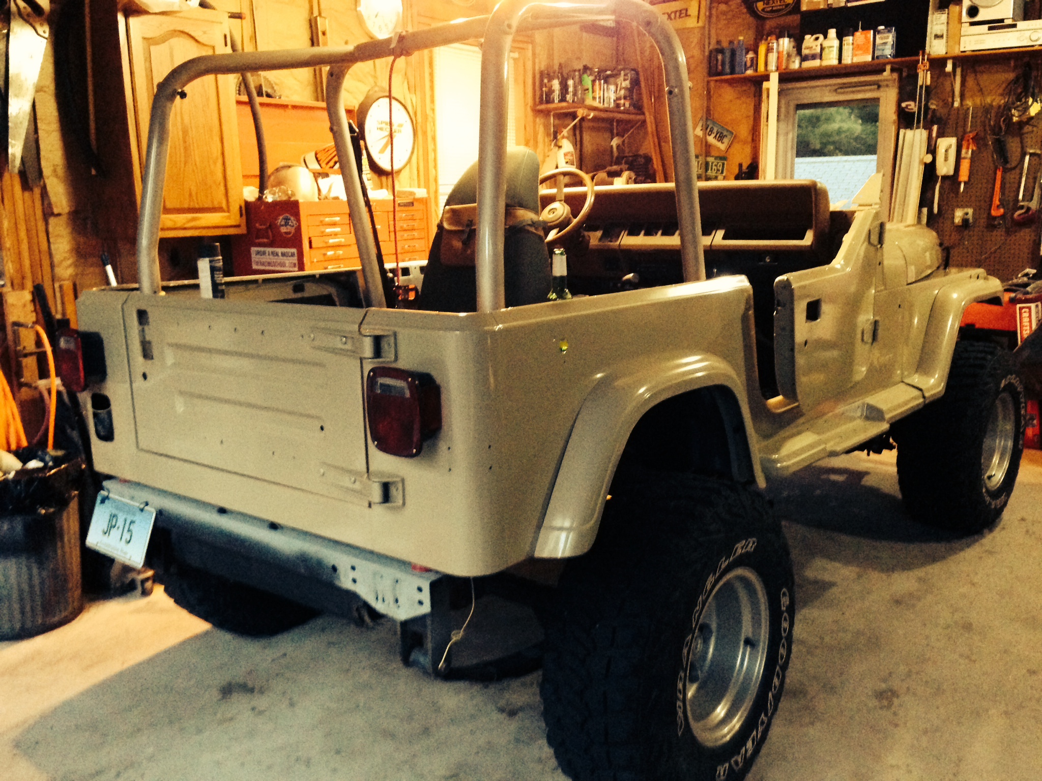

The tan has been sprayed! Father in law sprayed the doors, windshield, and tailgate while I was there. While he was working on that, I gave the rest of the Jeep a final sanding and masked everything off.

Got the tan sprayed on! When I first saw it I was somewhat shocked about the color. I'm not sure I've ever actually seen it in person. I mean I like it, I just don't know what I was expecting. It's a very military desert tan especially with the flattish sheen.

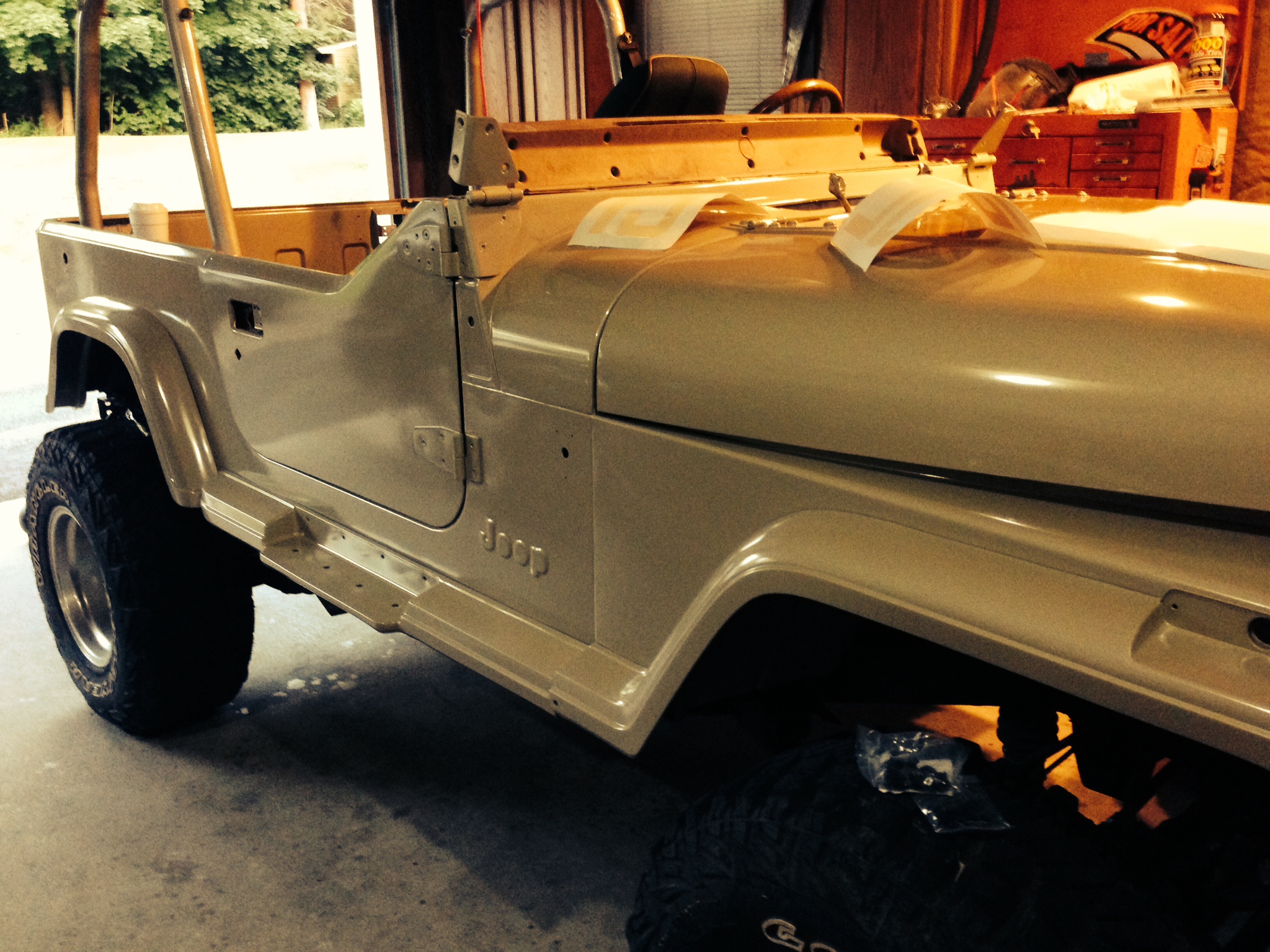

Unfortunately the paint requires at least 48 hours before recoating so we couldn't do the red stripes this weekend. It's probably for the best because now I can take my time with the measurements. Plus putting the fenders on and off is kind of a PITA and it's nice not being rushed doing that. Should be getting the red painted this weekend.
Here's the Jeep with the fenders loosely fitted. I just want to get them placed so I can mask the stripes, then it's all coming back off to be painted.

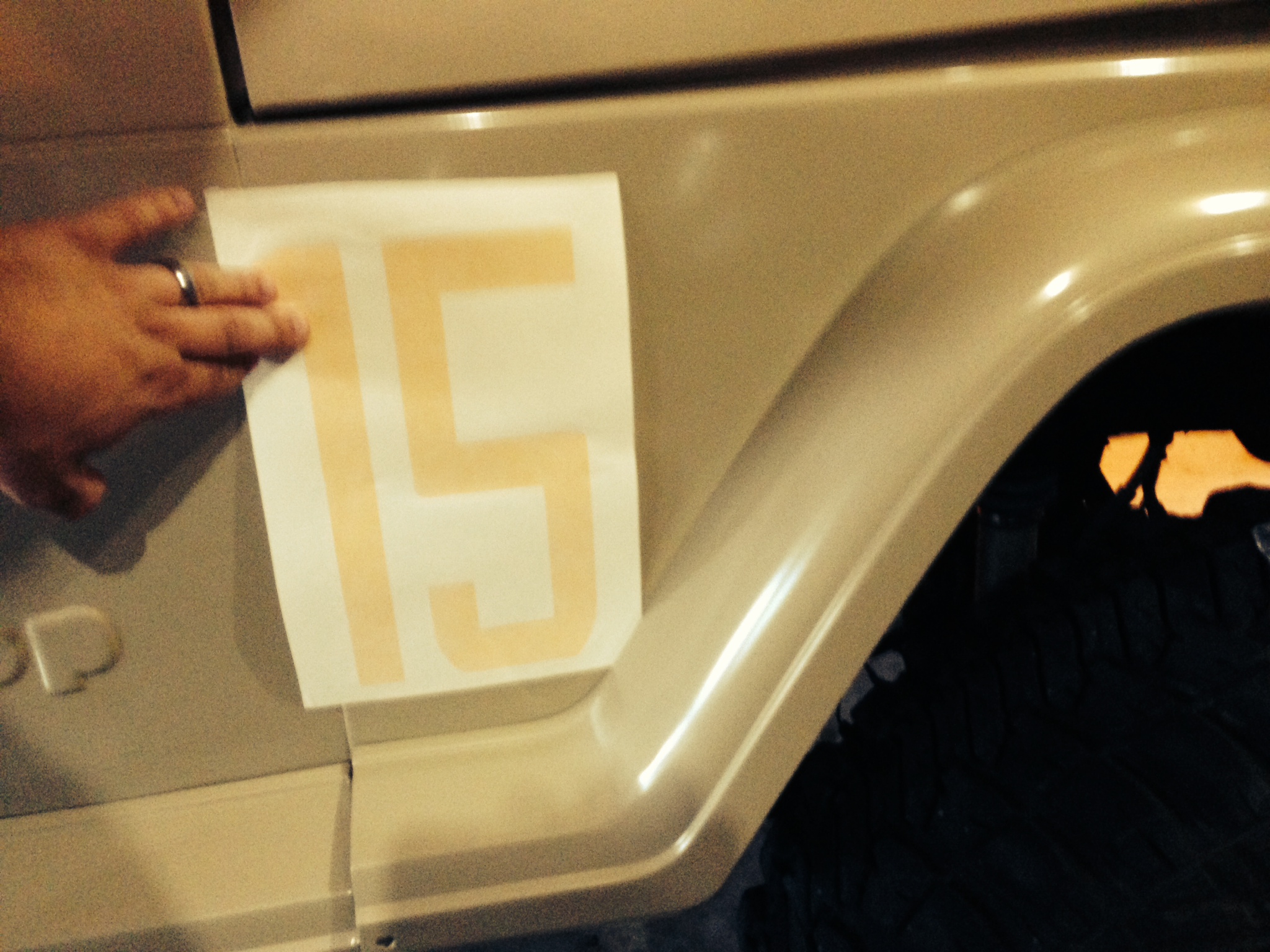

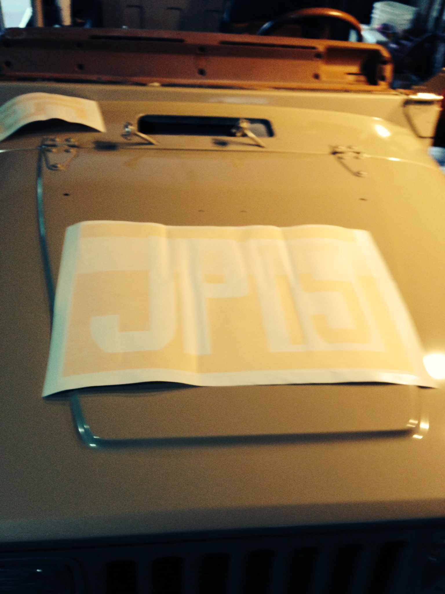

Dry fitting the hood and side number stencils. This is the first time I actually looked at them and measured them. I went about an inch larger than what was recommended for the hood and am happy with the size. The side numbers are 10" tall.
