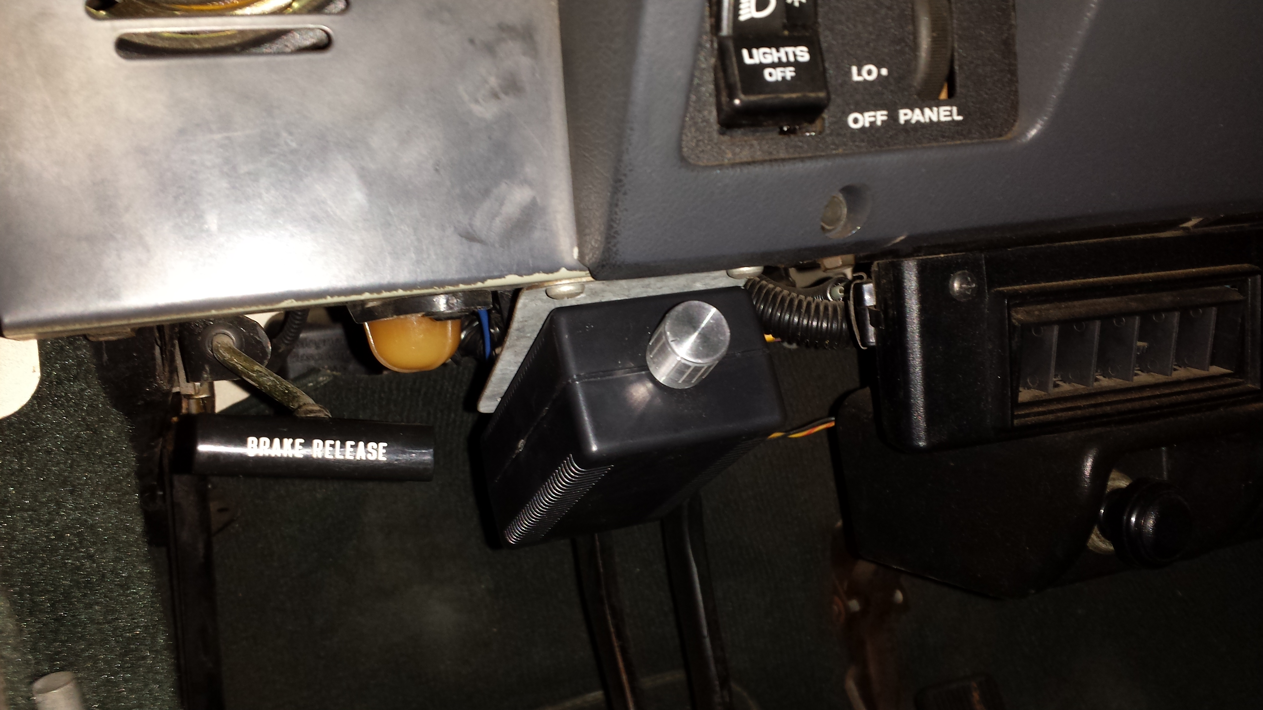

One thing I didn't talk about in the last post is how I have made it possible to run the amber KC lights when I have my parking and head lights on.

So now that is out of the way, let's continue. The way I wired my KC lights up is using a relay and a dimmer switch. I wired up the relay and connected it to the parking light wire coming from the headlight switch. So when I turn on my lights it activates the relay which sends full powers to my dimmer switch. Just a personal recommendation, but you should always use a relay.
Now for the dimmer. I bought the dimmer I am using off of eBay and it was shipped here from China. I purchased it because it came in it's own black housing and was rated at 40 amps, and could handle 480 watts at 12 volts. Which was more than enough. If you are going this route you have to make sure your dimmer can handle 110 watts at 14 volts. Why 14 volts? Because your alternator produces any where from 13.7 to 14.2 volts. So don't make the calculation based on 12 volts because it will be wrong and you don't want to burn up a dimmer and consequently your Jeep. To calculate your amps it is "watts = amps × volts."
I wired the main power wire from the relay, to the dimmer, and then to the lamps. It worked great and I am able to dim them down to where they are illuminated to where they are no brighter than the tail lights. I have included pictures to show how it looks. As you can see the dimmer switch is mounted to the plate that also holds your wiper control module. I had to bend my plate a little for it to work, but I think someone had bent it down prior to me owning the Jeep. Blends in well and is hardly noticeable.
Dimmer switch mounted under dashboard on left side.

Also I am still running the stock 55 bulb in the KC lights with the dimmer.
