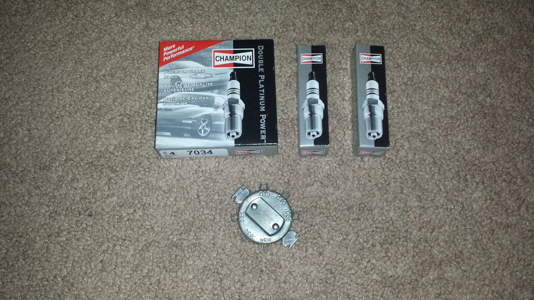

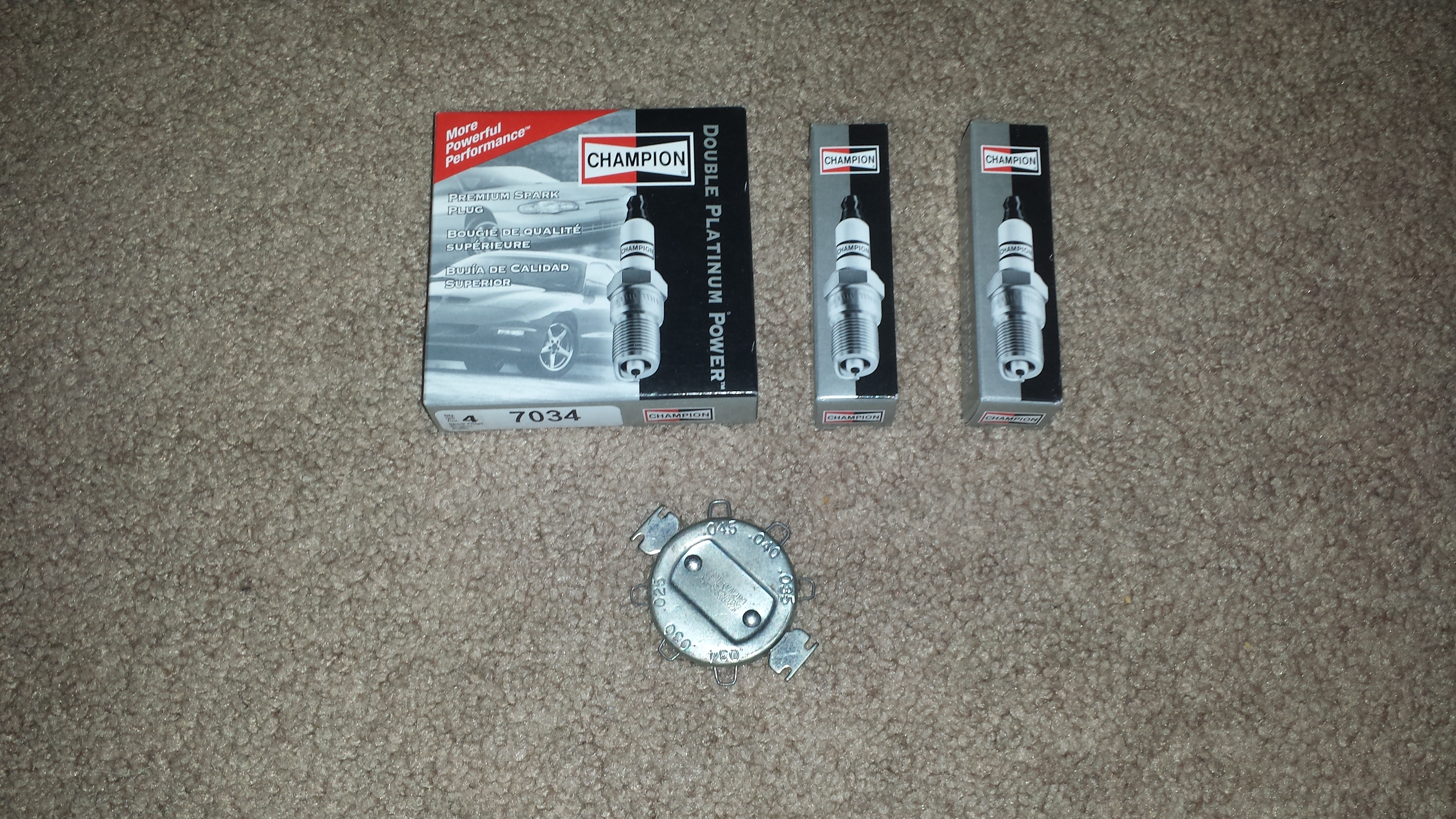

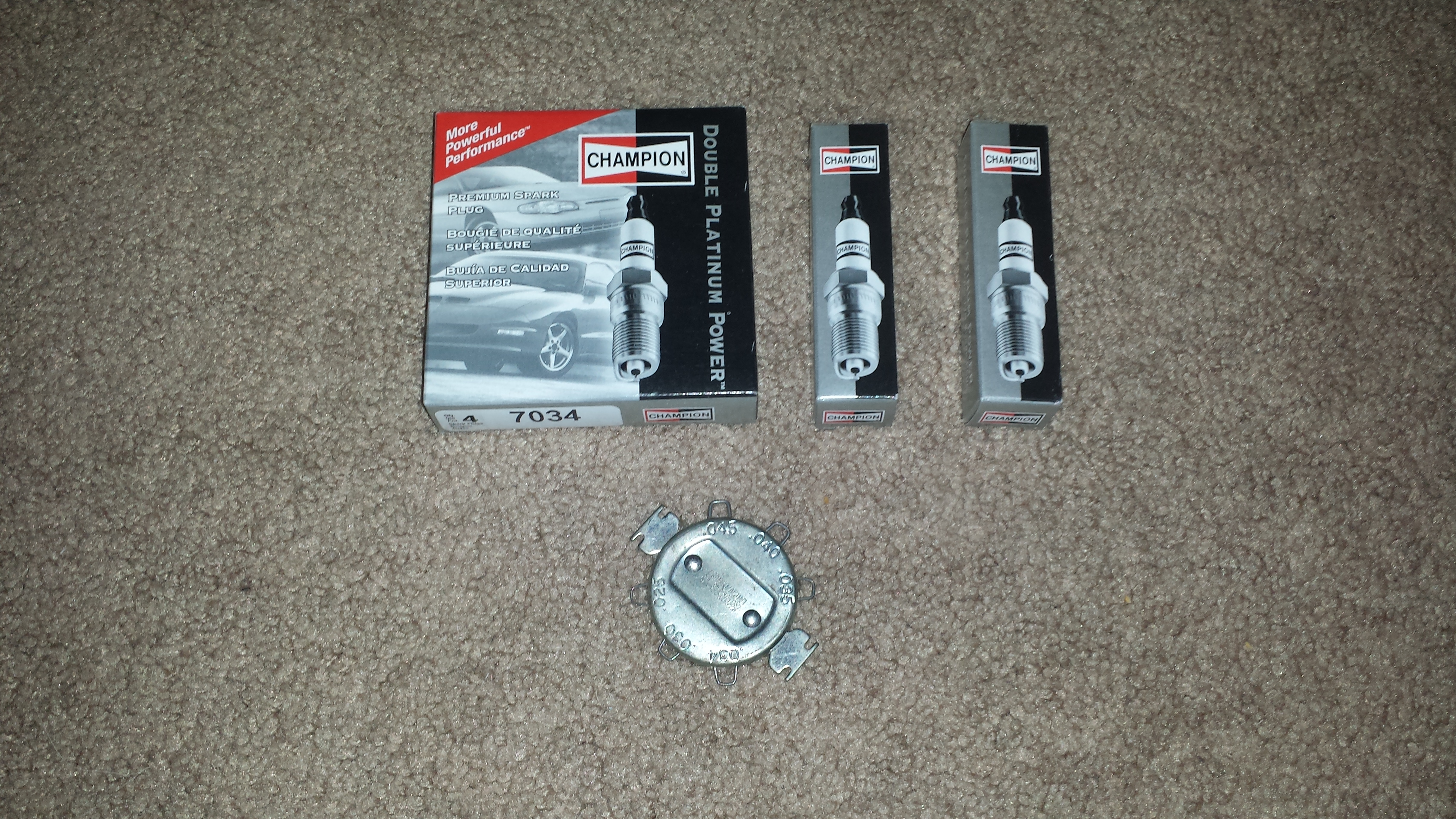

Okay so as you can see from the list I posted I have a lot to do and I have already gotten started on some of the repairs. The first thing I did after getting it home was to change out the motor oil and put in a full synthetic. Then I fixed the tailgate and driver's door locks. Next I replaced the spark plugs. If you didn't at least pull yours and check their gap when you bought you Jeep, it is a good idea. The old champions I pulled out of mine had a gap range from .50 to .60. Not the .35 that they should have been. I replaced mine with champion double platinum plugs. There is no sense in buying anything fancy like the e3, double spark, or whatever other thing they can come up with to take your money. The Jeep 4.0s run just fine on standard plugs.

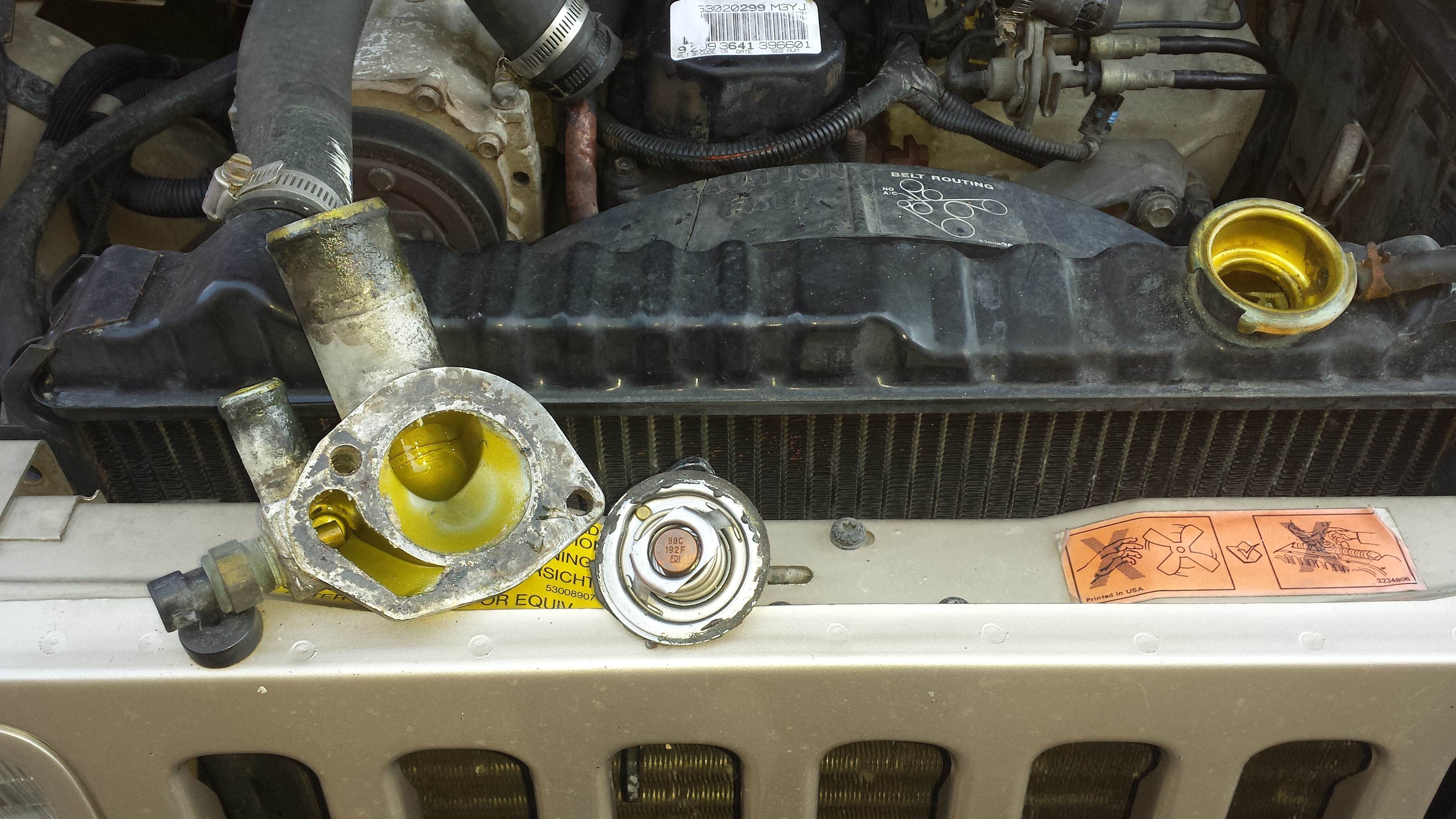

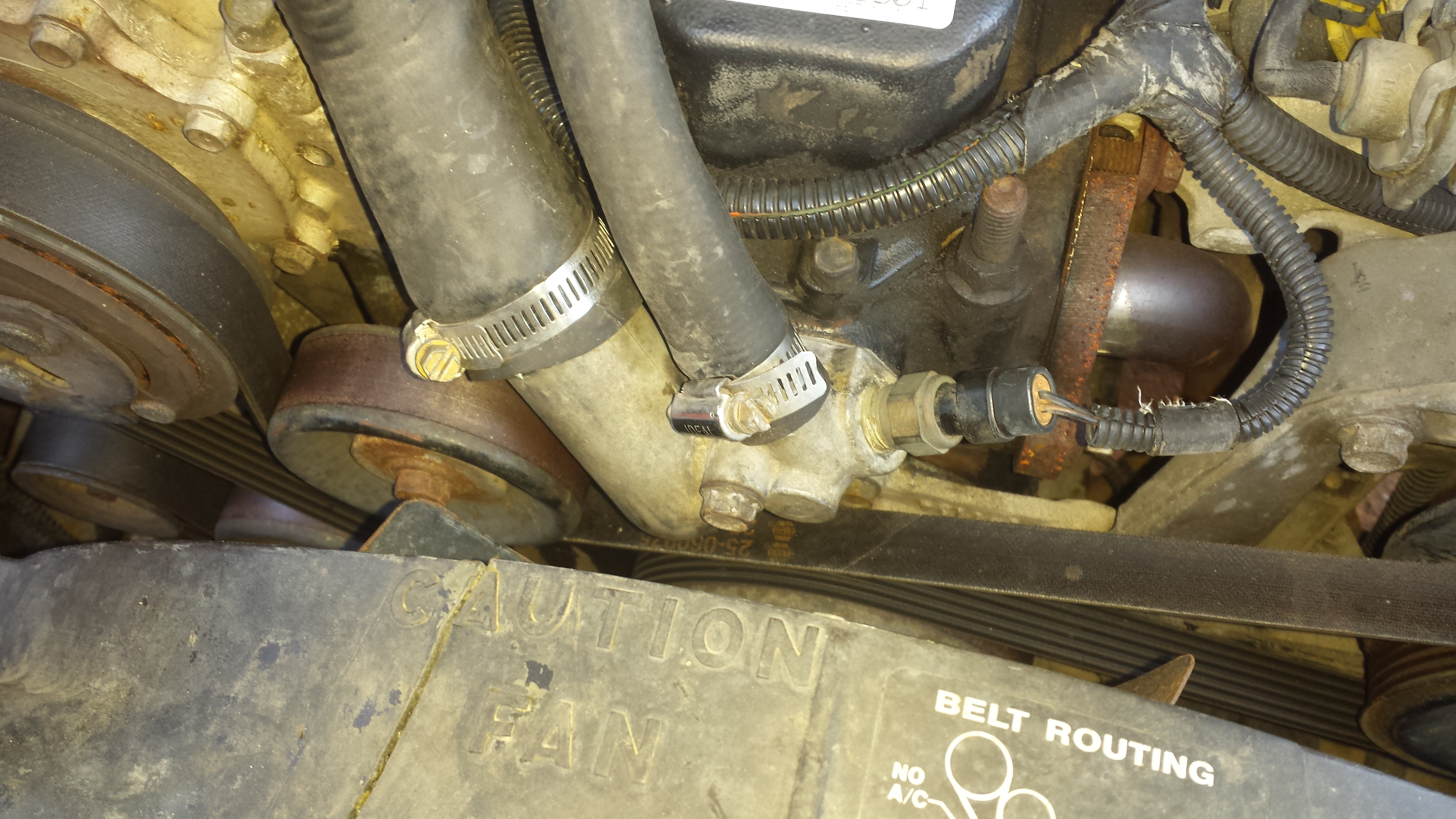

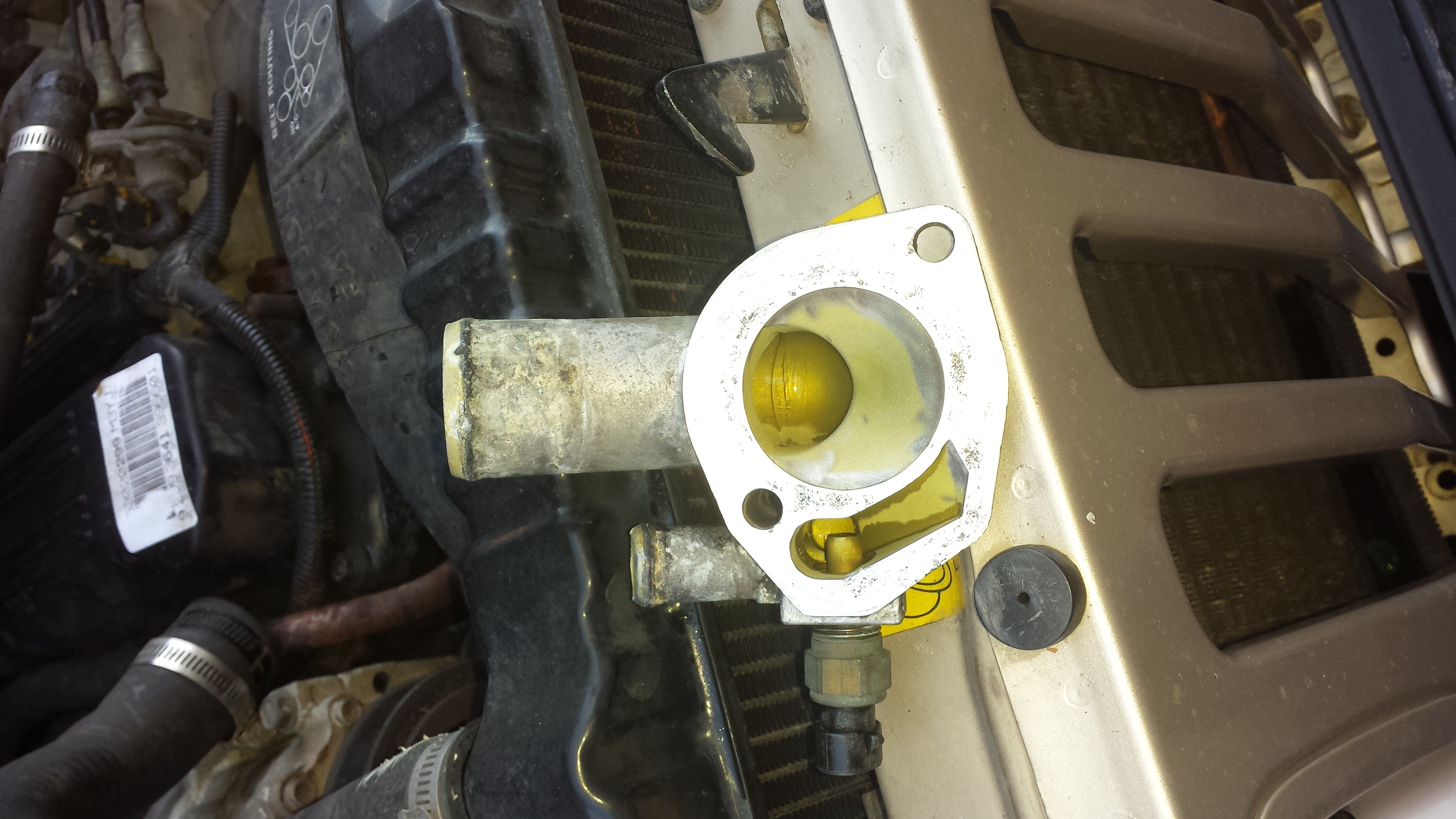

Okay so I listed the thermostat on my list of repairs. This is a common part failure on the 4.0 motors. But most people don't realize when it has gone bad. For those who don't know what the thermostat is and does, I am going to explain this hoping to help someone out. The thermostat on a vehicle is actually a valve that opens and closes depending on its temperature. When the temperature of the motor reaches a certain point, like 195° for the Jeep 4.0, then the valve opens letting coolant circulate through the radiator and engine block. Most of the time when the thermostat fails it remains open, not allowing thr motor to reach an optimal operating temperature. This is not something that is going to cause any critical problems, but is not good if left alone for a long period of time. The 4.0 is an engine that actually likes to run a little hot. If it is not allowed to reach its optimal operating temperature then it will run rich, which can cause multiple problems. Some of which, but not limited to, are bad fuel economy, fouled plugs, excessive carbon build up, catalytic converter failure, and so on. Your first clue that your thermostat is bad is that your temperature gauge doesn't ever get over 180° on a cool or cold day. Mine wouldn't get over 160°. You should then check to see if your motor is the same temperature as your gauge, If it is then its the thermostat. If the engine is up to temperature and your gauge is not then it is either your temperature sensor or your gauge. The thermostat is easy to change and I used original mopar parts for this job because it was not that expensive and it came with the required gaskets.
Hope this helps somebody out. Thanks

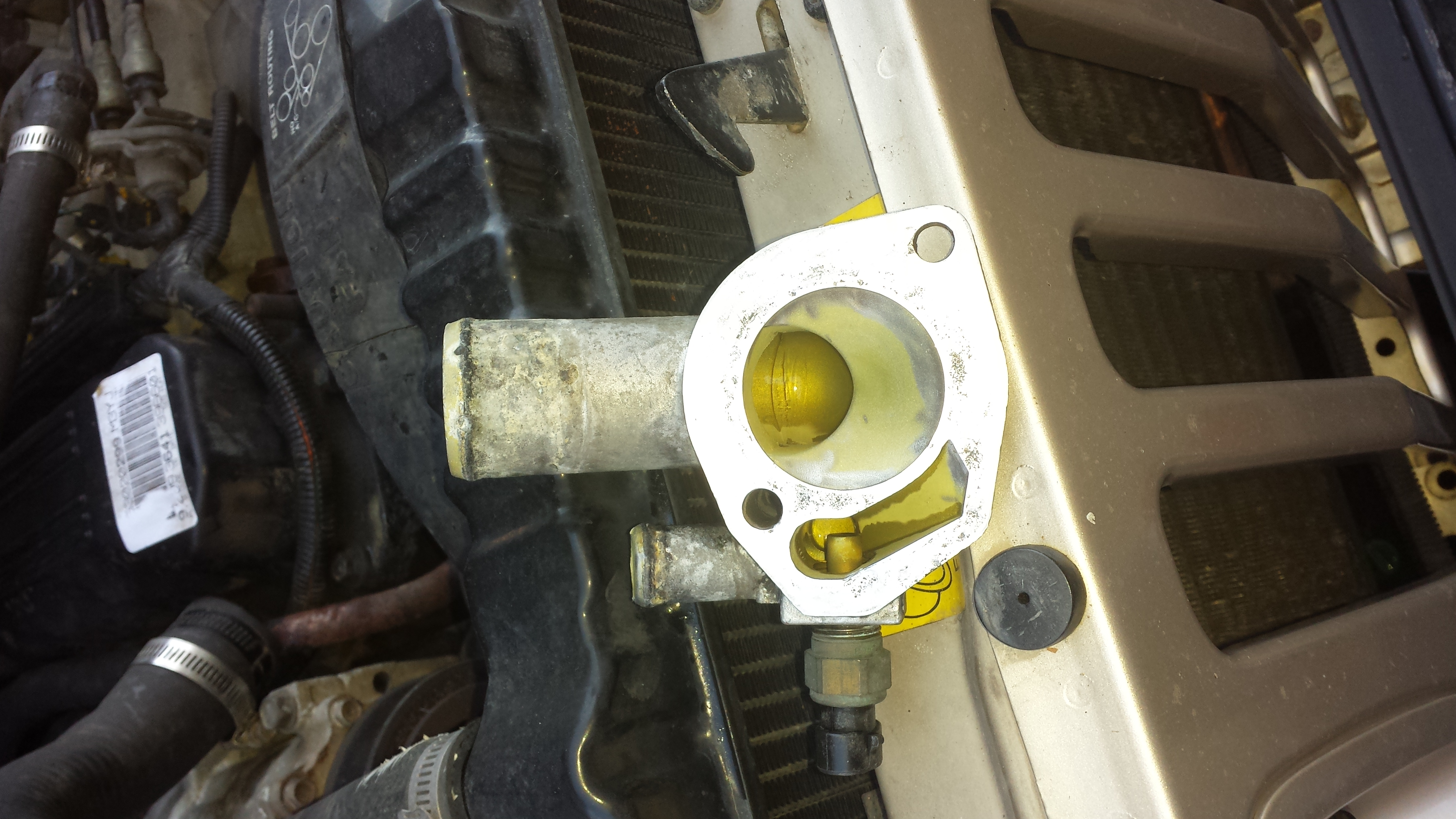

This is the thermostat housing attached to the block. The big hose goes to the radiator,  the small hose goes to your heater core, and the temp sensor is on the right.

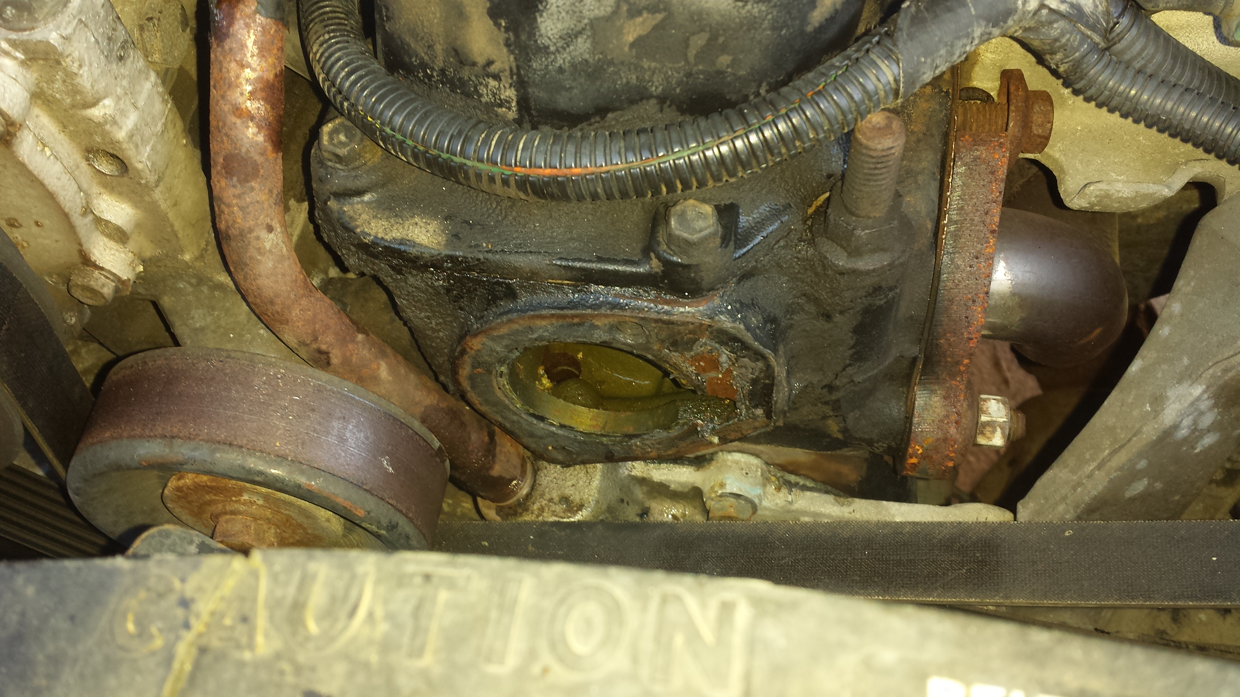

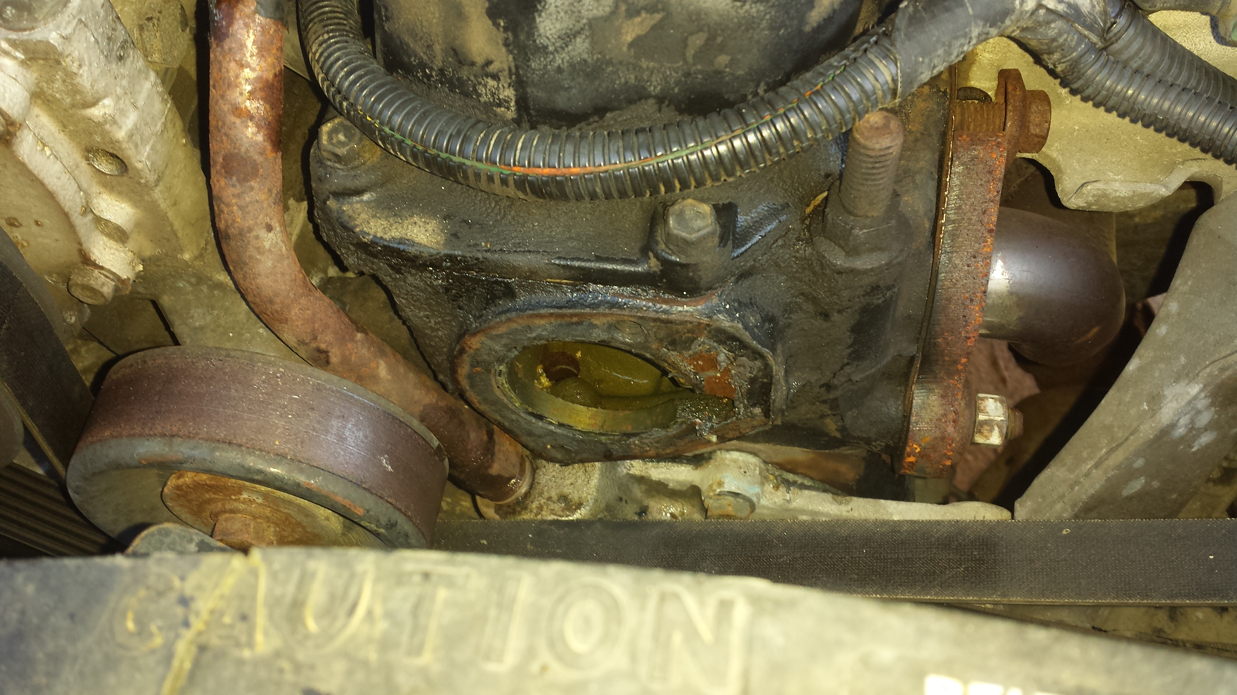

The front of the block where the thermostat and housing go. You will have to clean off all of the old gasket before reinstalling.
The thermostat housing and the old thermostat.
This is the thermostat housing, cleaned and ready to install with the new thermostat.

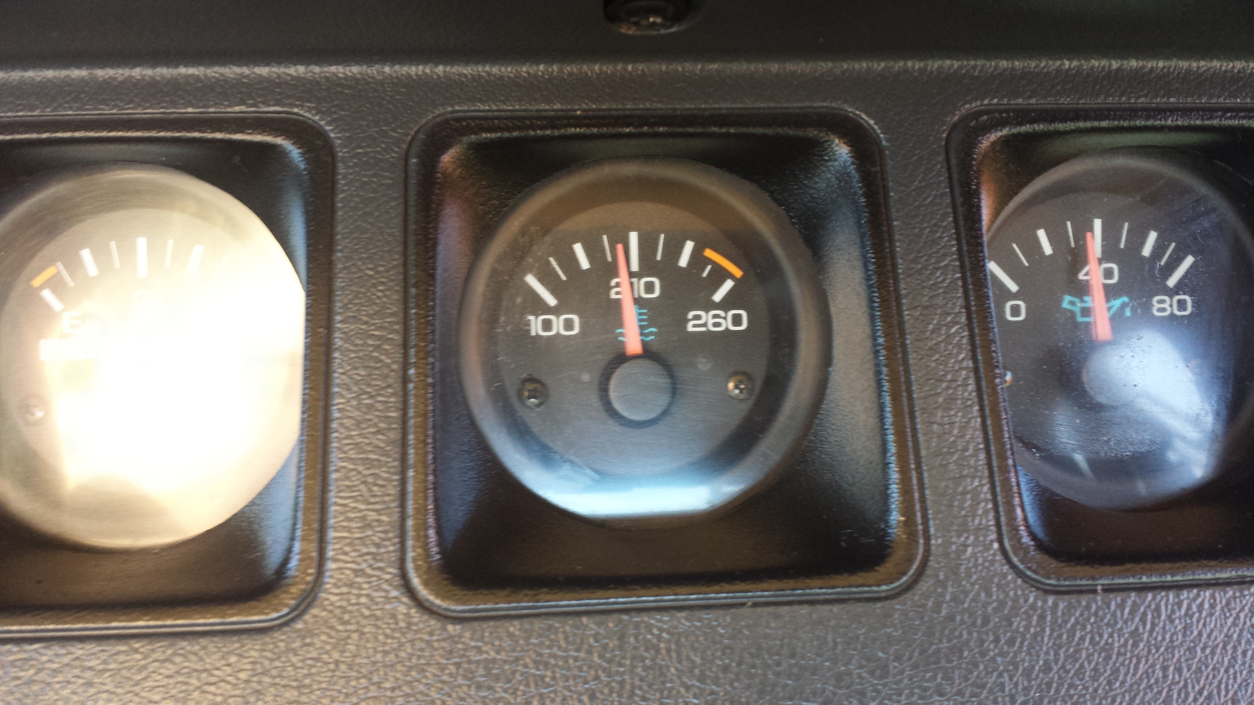

This is what your temp gauge should look like when your thermostat is working properly. In cold weather is should fluctuate between 190° and 210°. Before the repair it wouldn't get over 160°

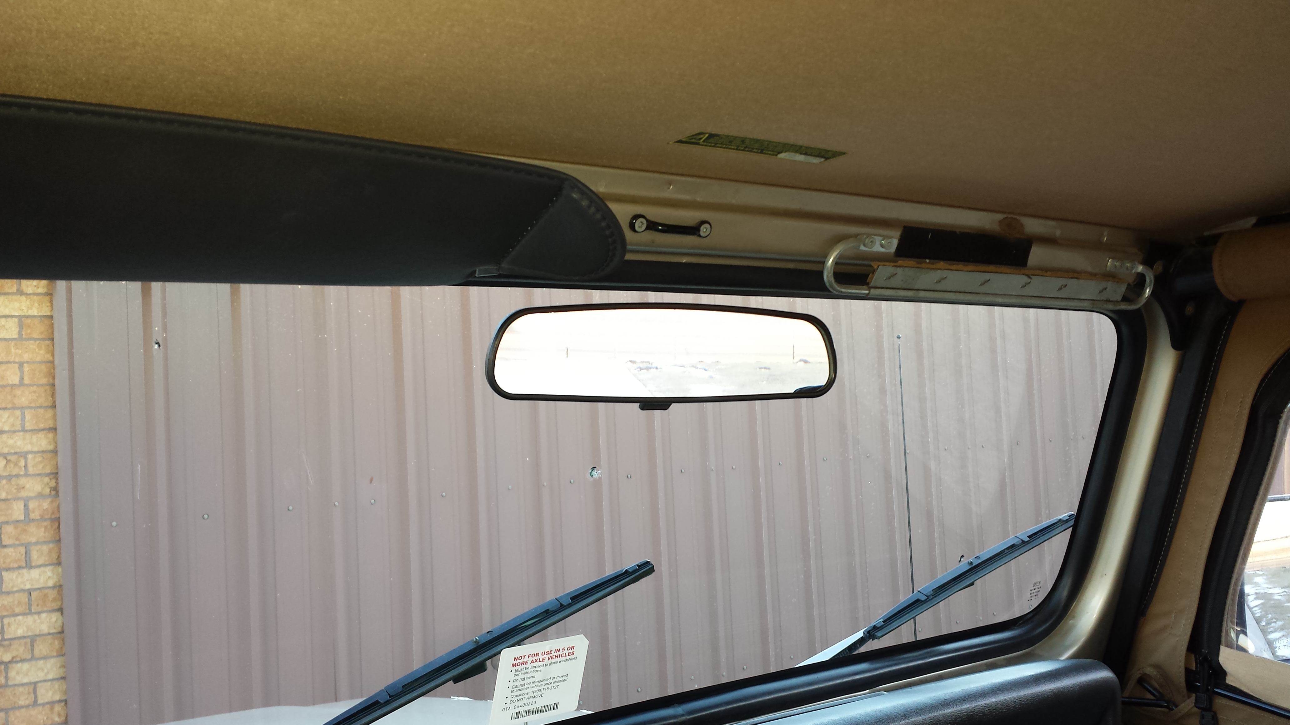

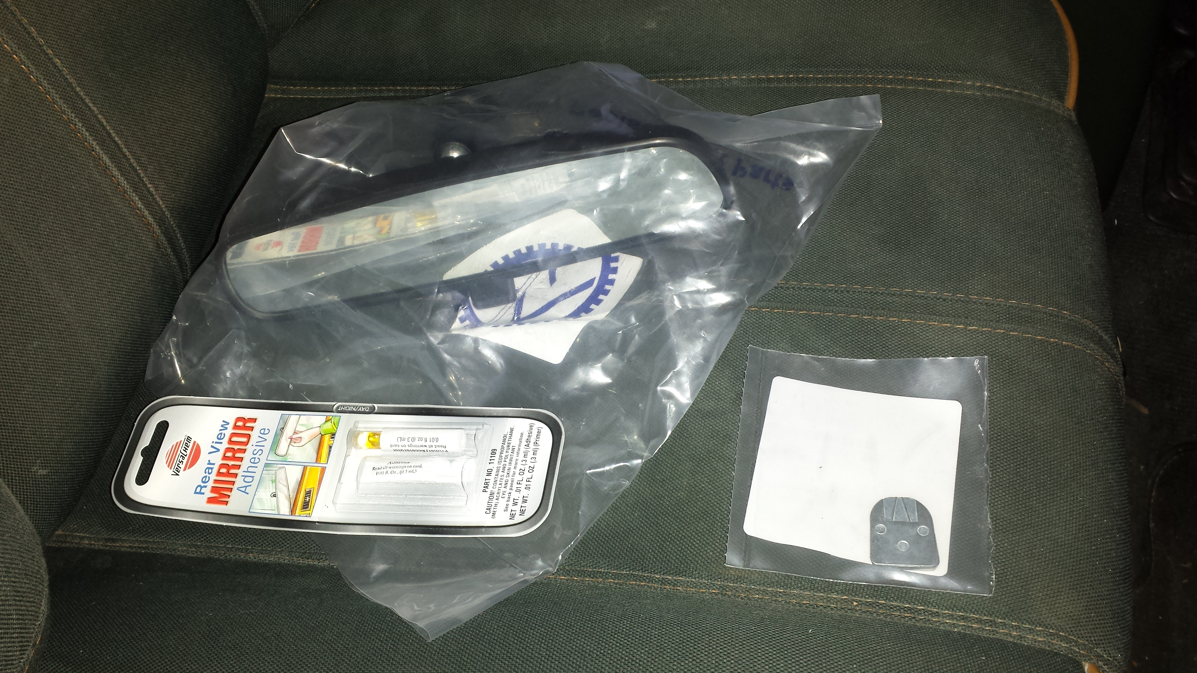

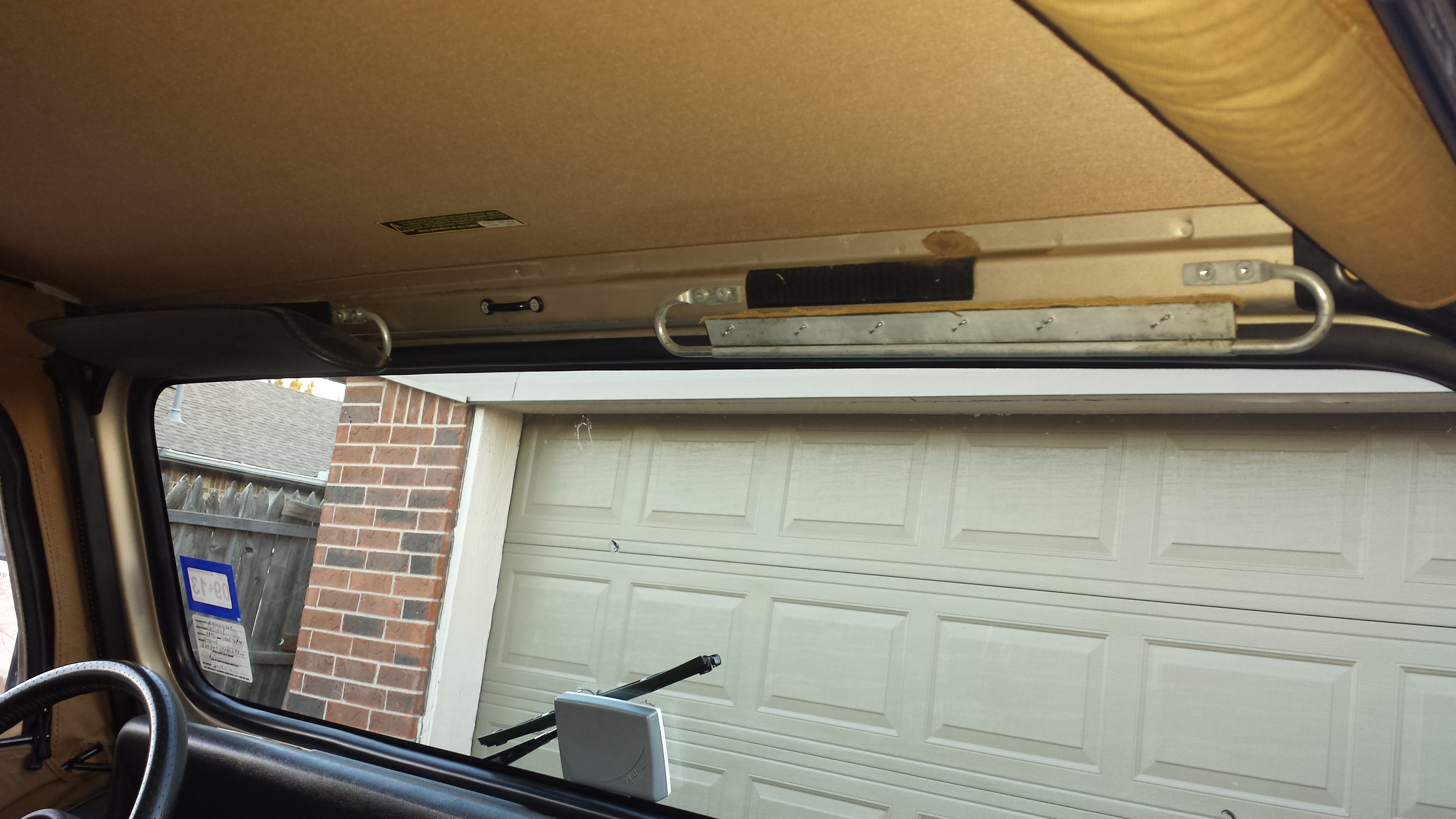

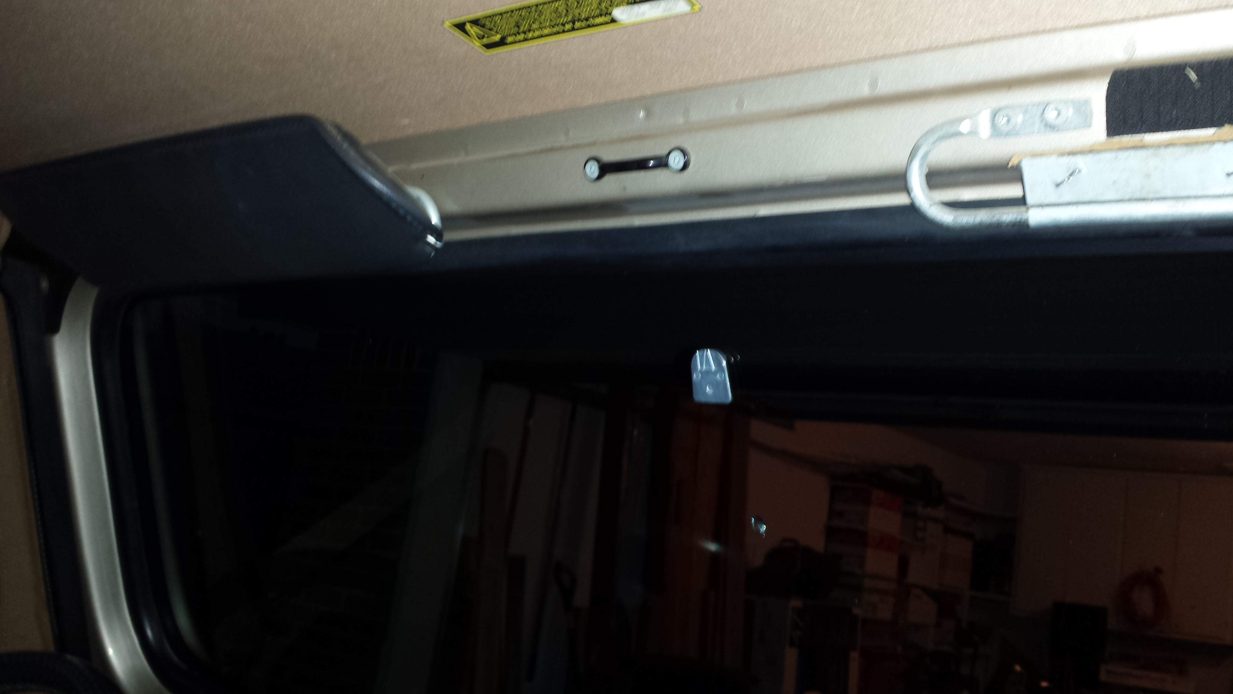

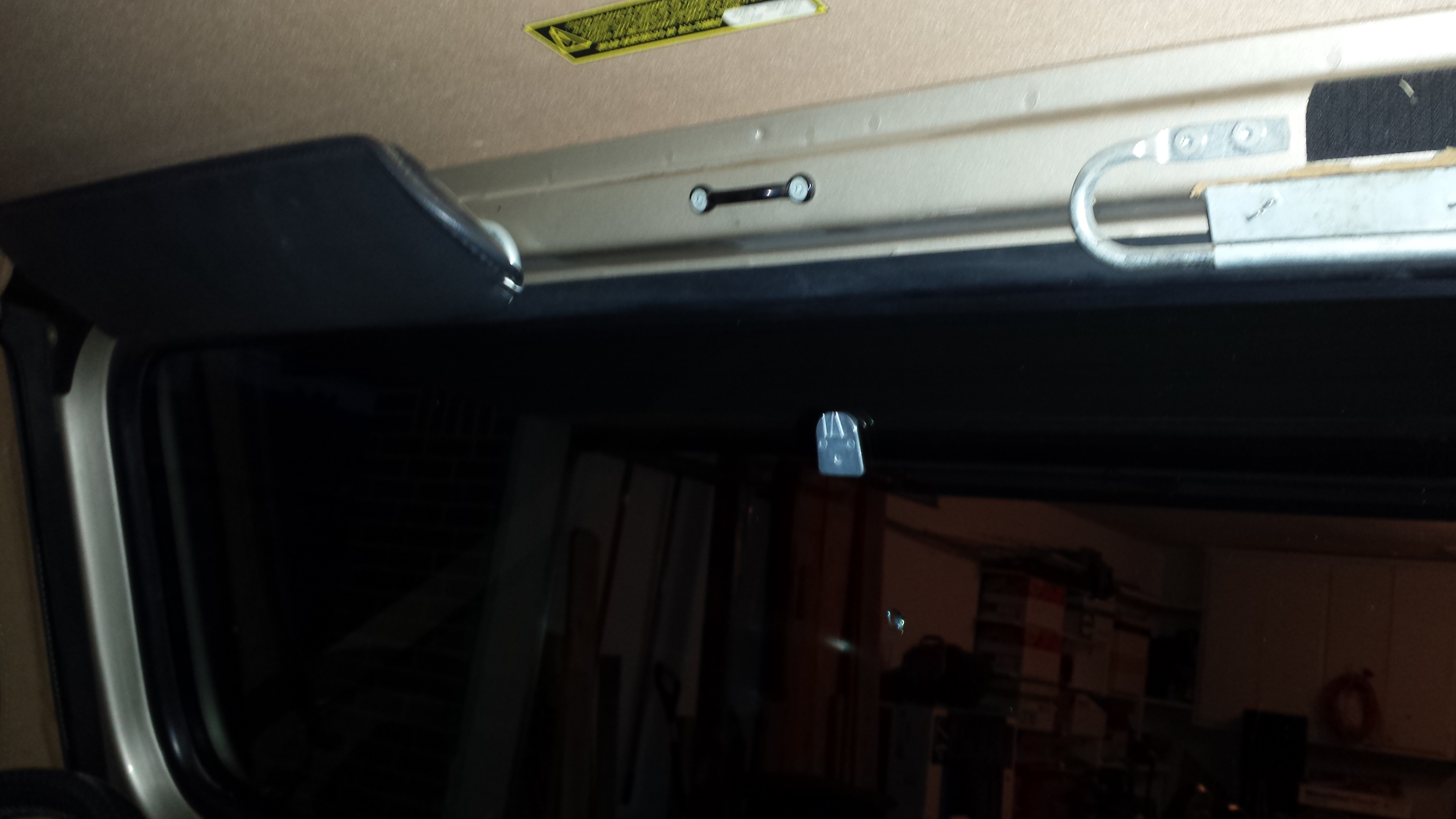

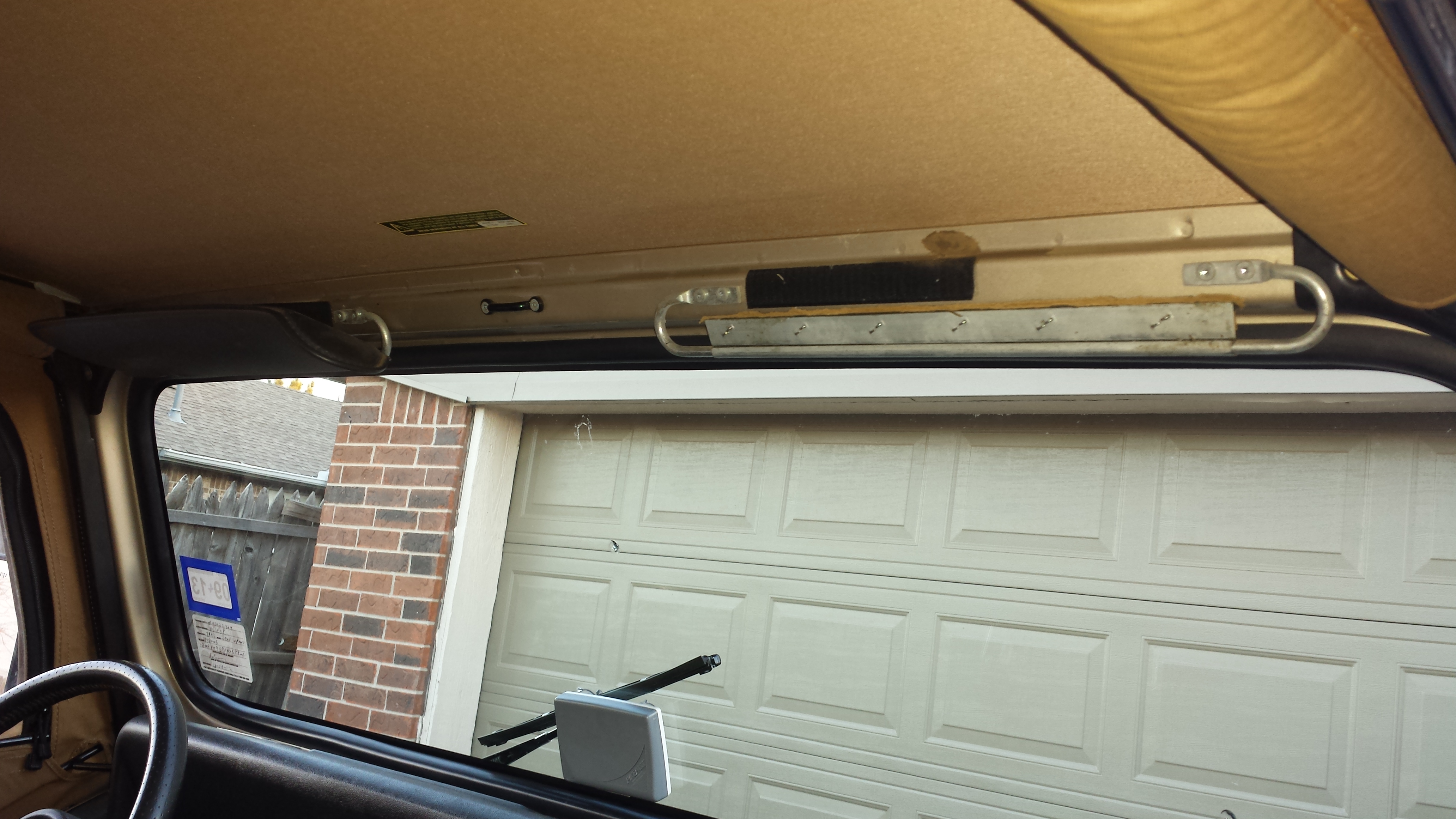

Okay so a couple of nights ago I installed my new rear view mirror. I bought the kit off of eBay from CSEOffRoad. The kit comes from rugged ridge and was pretty good. It came with a new oem style mirror, the tab, and the glue. It worked out well. We will see what happens through the summer.
While I was working on cleaning the windshield I also cleaned off the Texas registration stickers and put my pikepass on the windshield.
Hmm... Anyone notice a couple of things missing?
The kit from CSEOffRoad

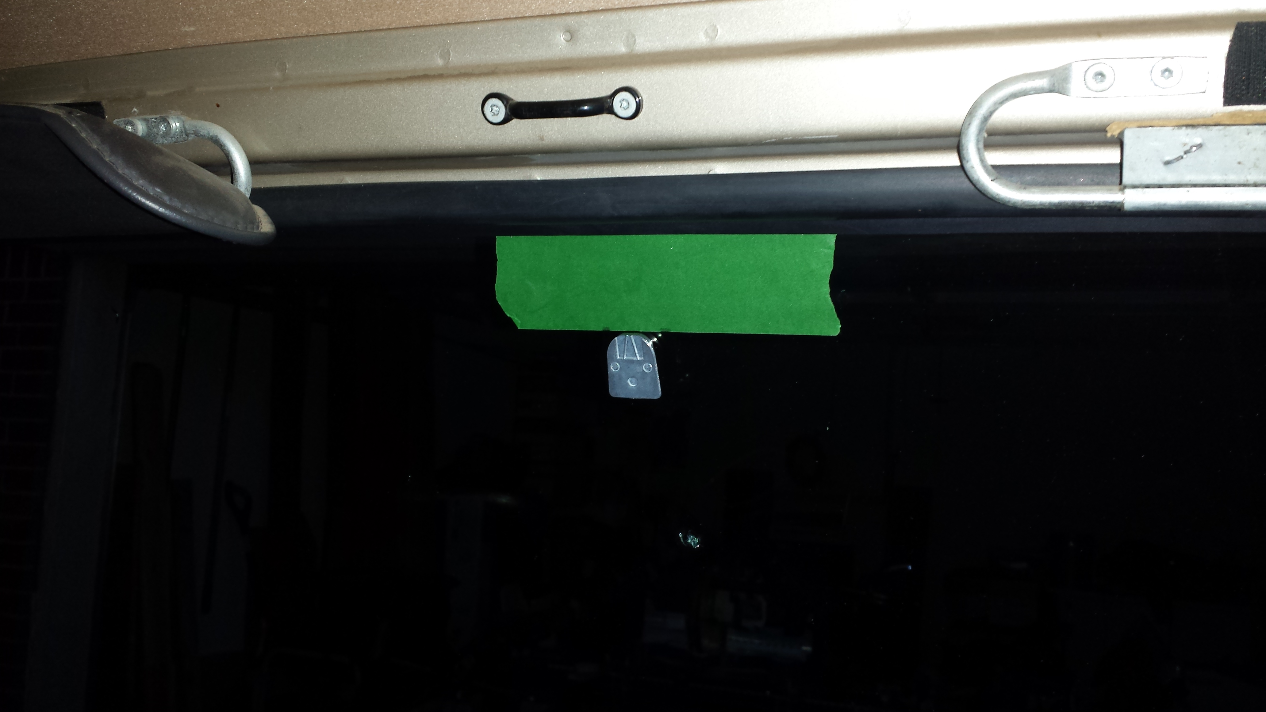

I marked the height with masking tape and then the center of the windshield with a dry erase marker all on the outside of the window before I got started.
I left the tab alone through the night to make sure the glue set.
Mirror installed
Mirror installed

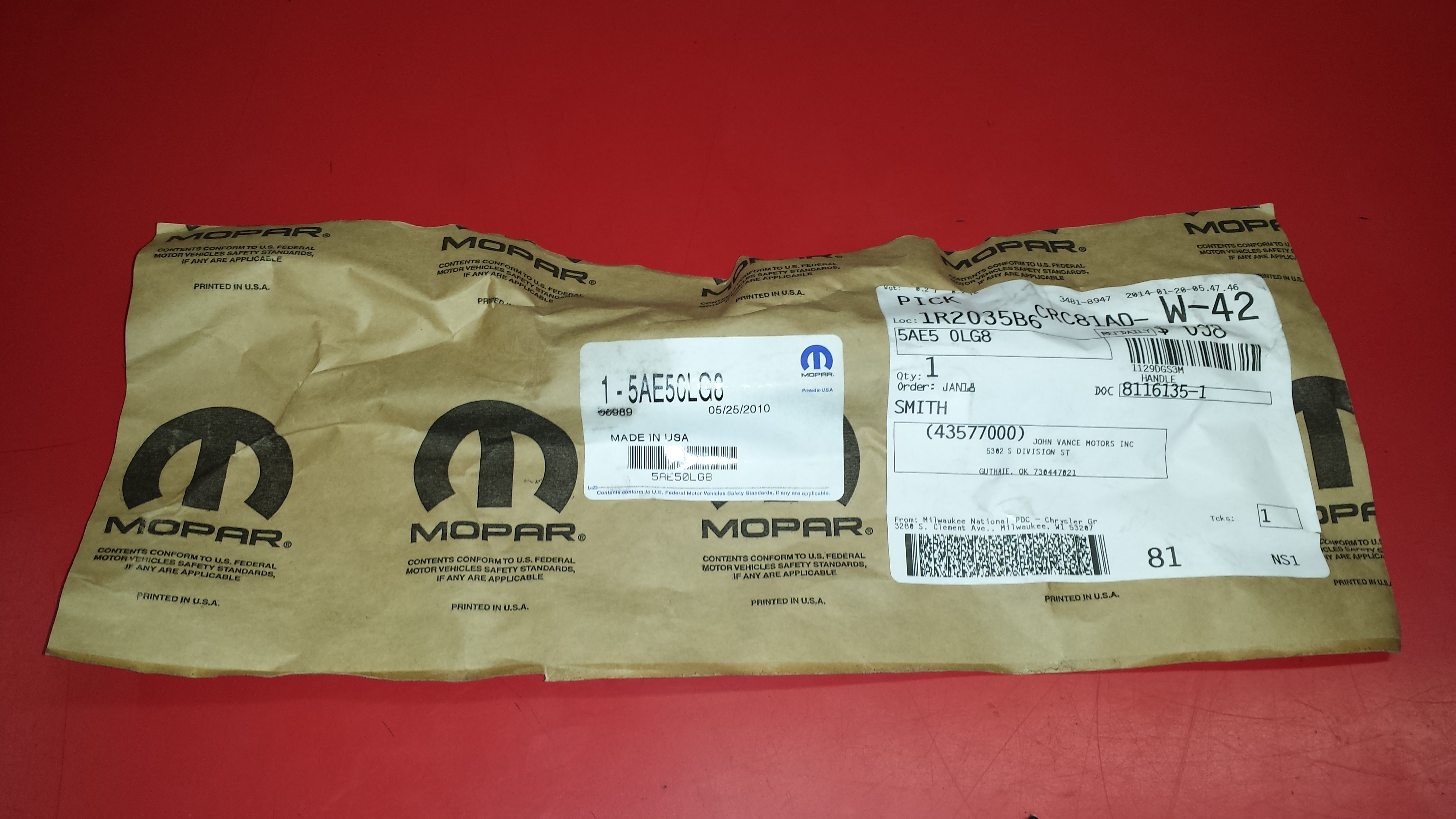

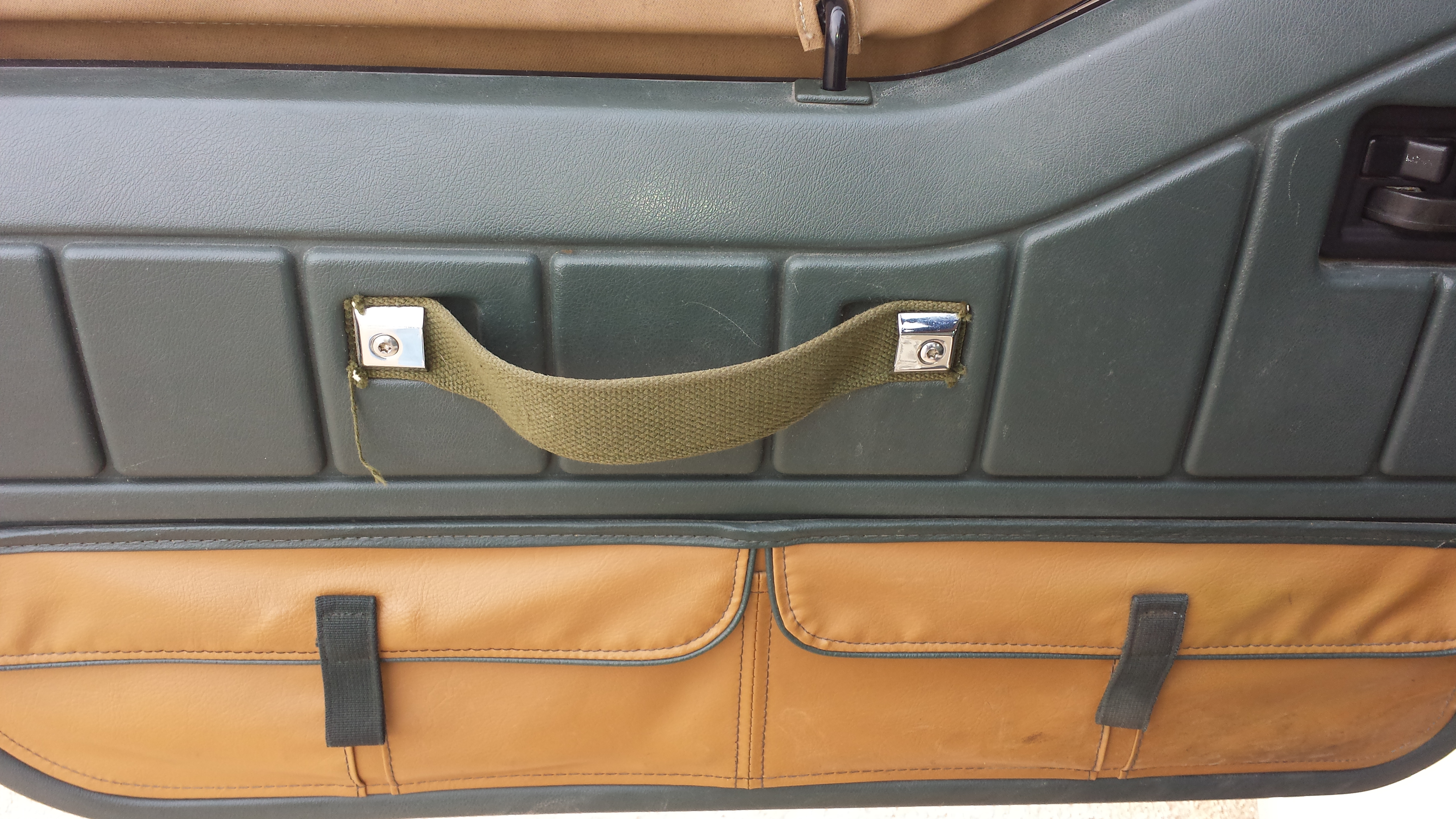

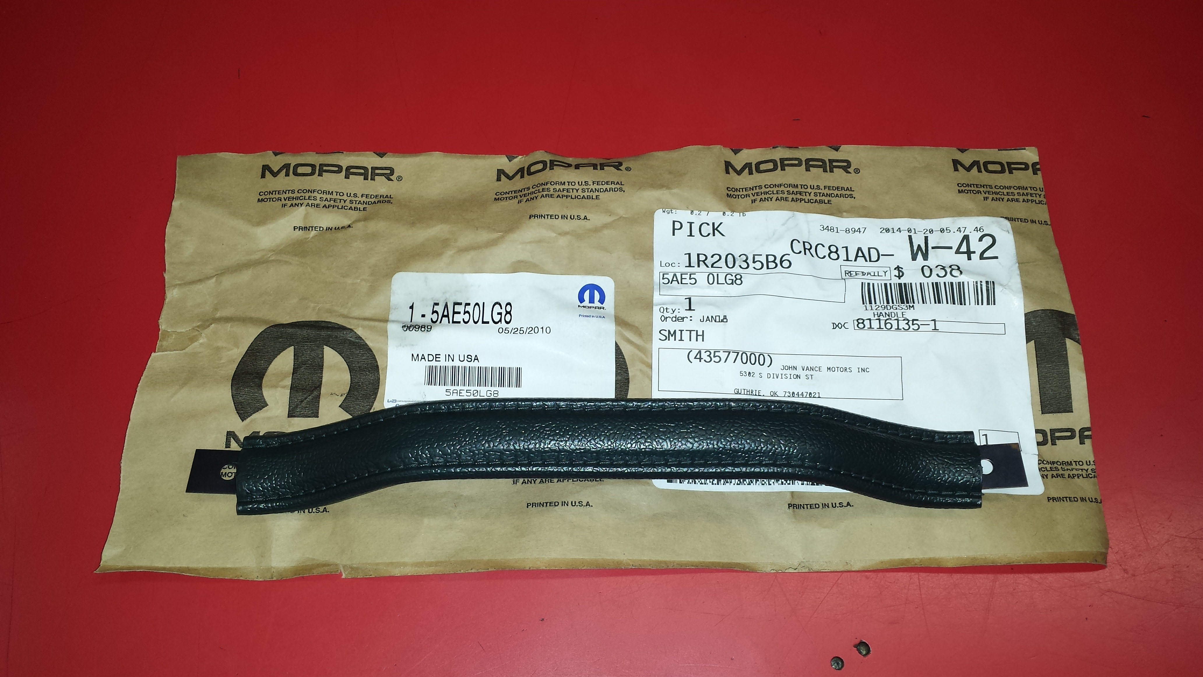

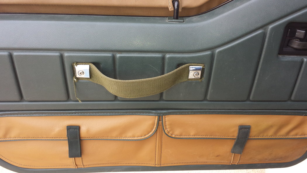

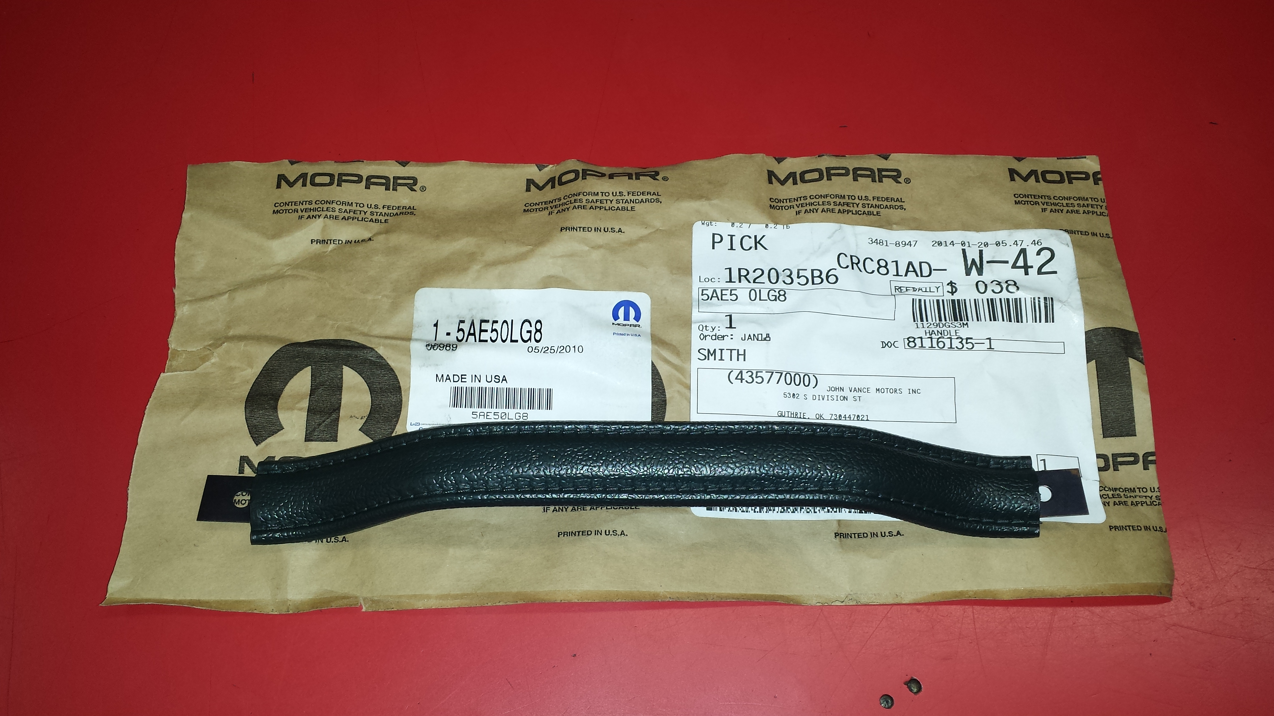

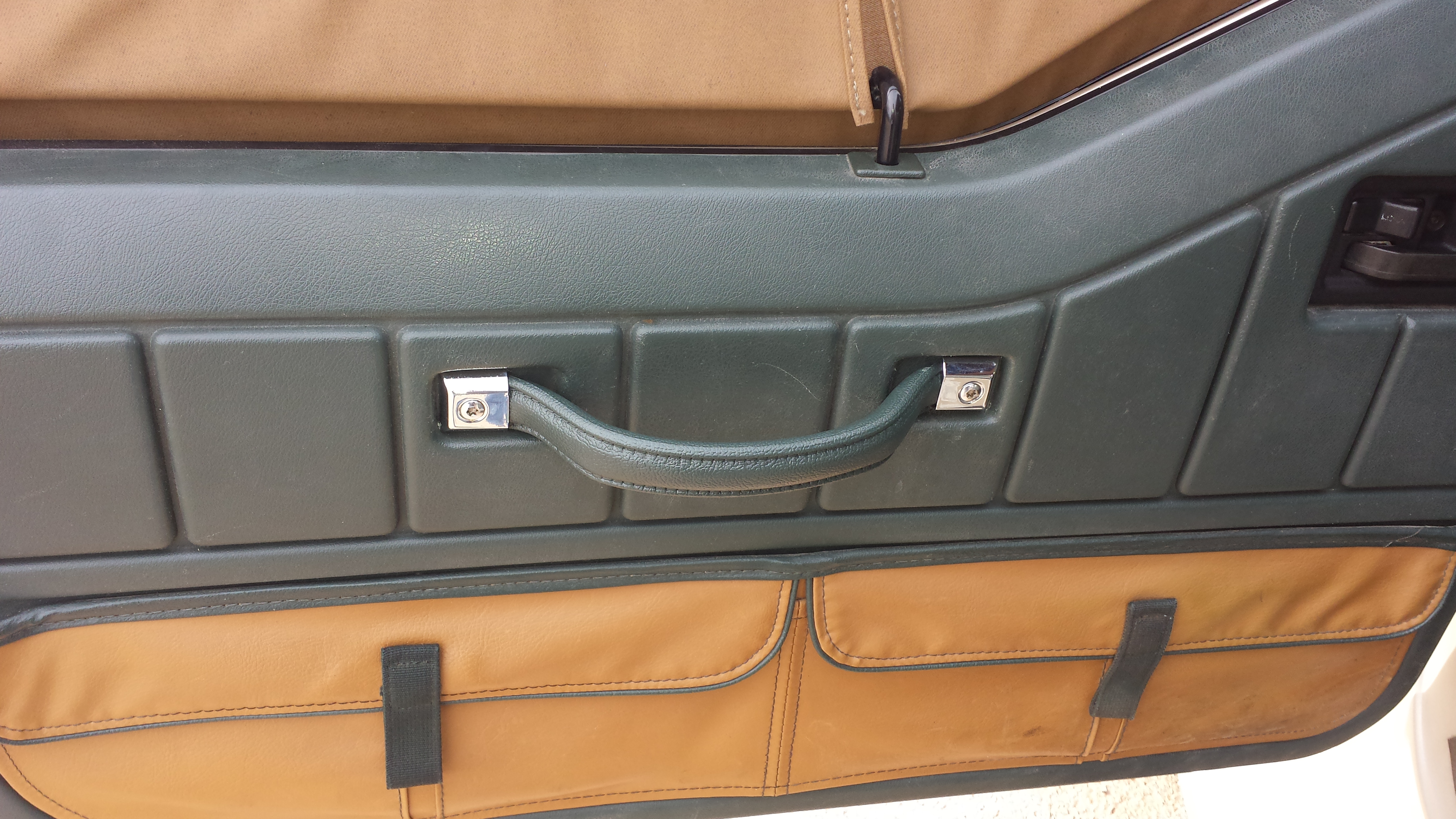

So I picked up the replacement door handle and changed it out. The previous owner had taken some green webbing and put it in place of the broken handle, but I wanted it to be factory original. As you can see from the pictures it was a Mopar original part and the color matches perfectly.
If anyone needs one of these for there Jeep they are $30. Send me a PM and I can tell you how to get one.
This was the temporary handle the previous owner made.
Part number 5AE50LG8
Oooooo new part smell.

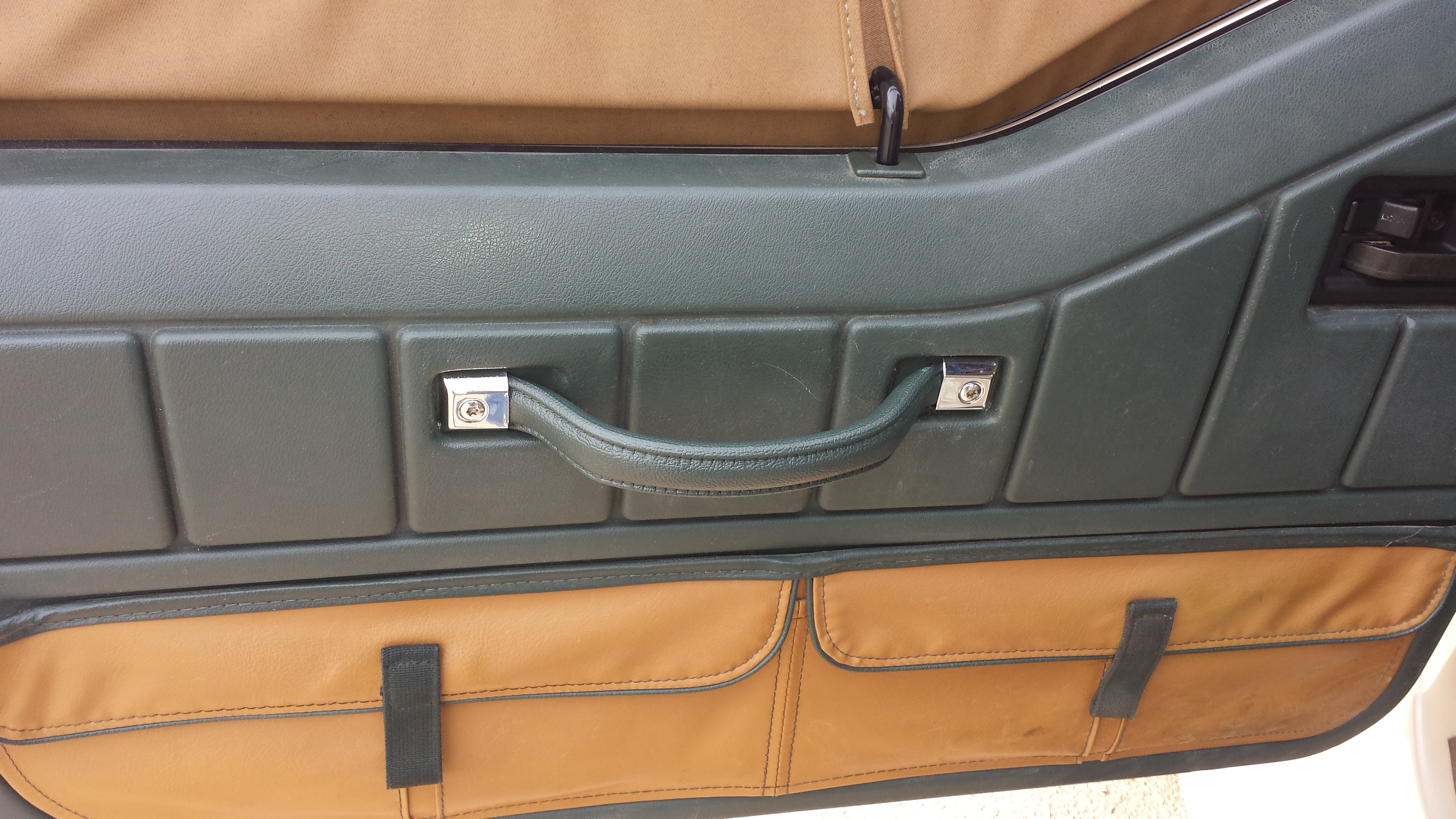

Driver's door handle replaced. Looking good.
