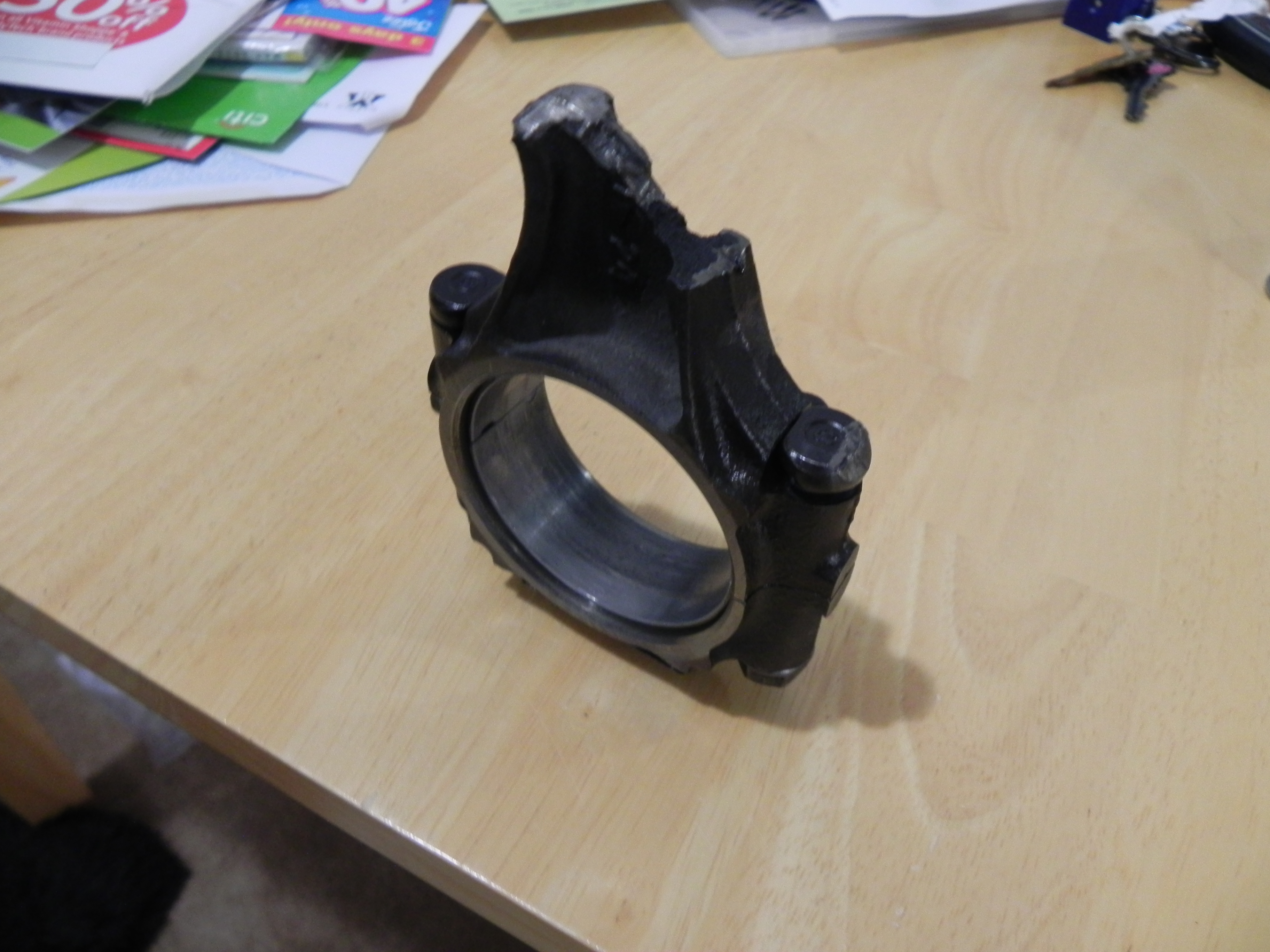

So the jeep is at pep boys geting the old engen out and the new one in didnt have the tools or the know how to do it my self but at lest it will be done i got a new 4.0L that pep boys ordered when its in ill have pics going today to take pics of old one it should be pulled to day

Ya a piston shot throw the engine wall and nesed up the crank shaft as well so there wasnt much to save

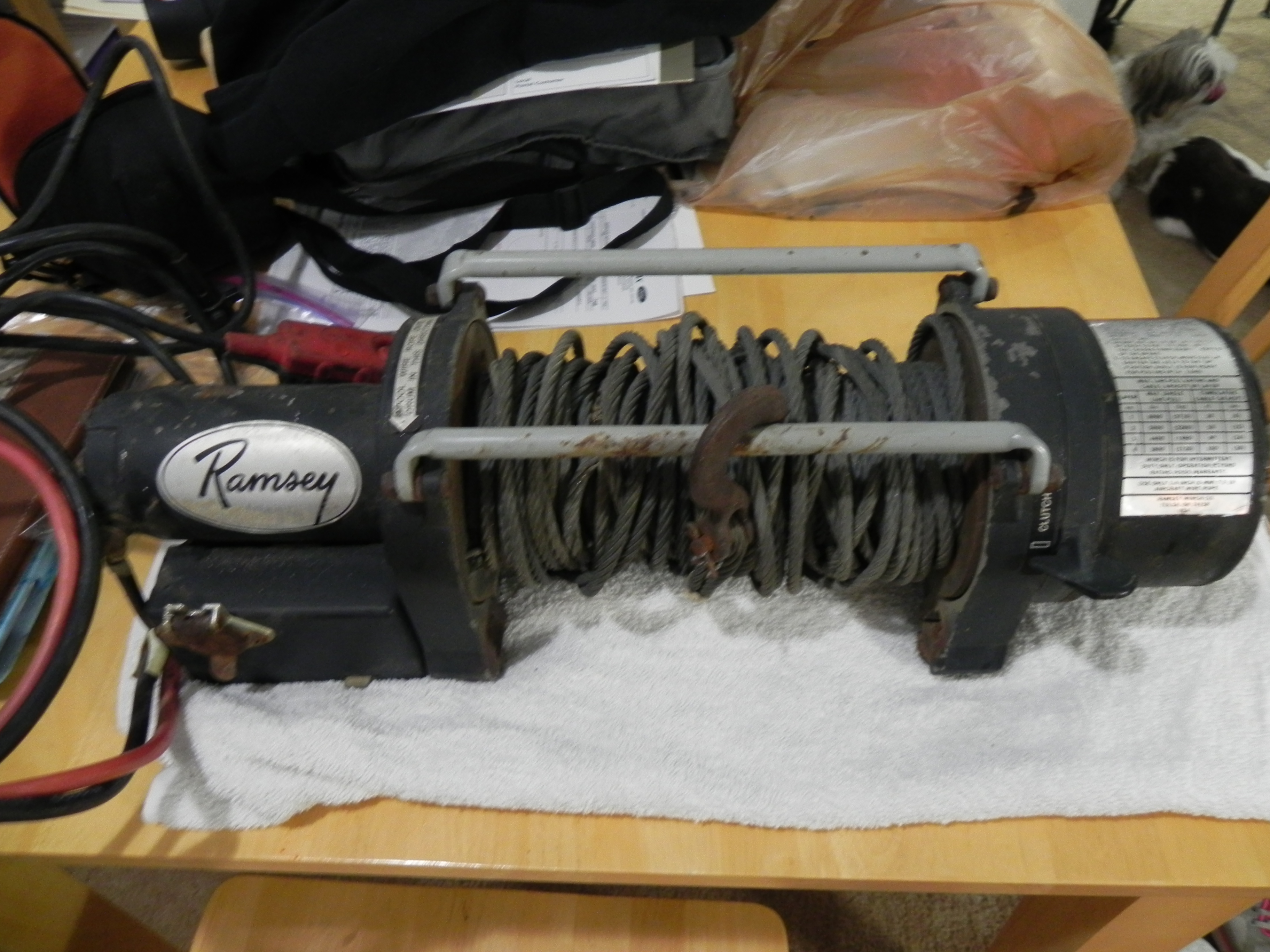

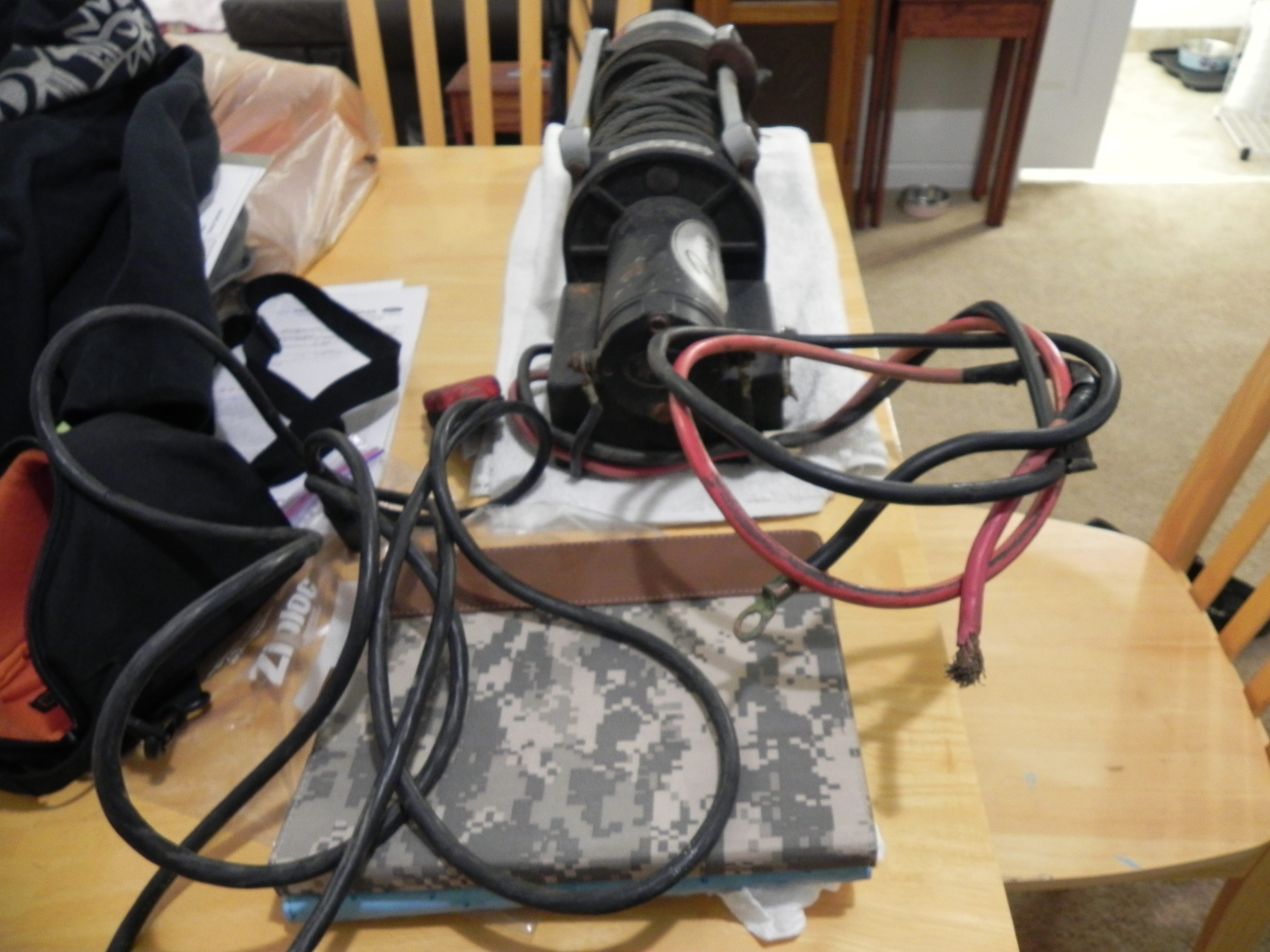

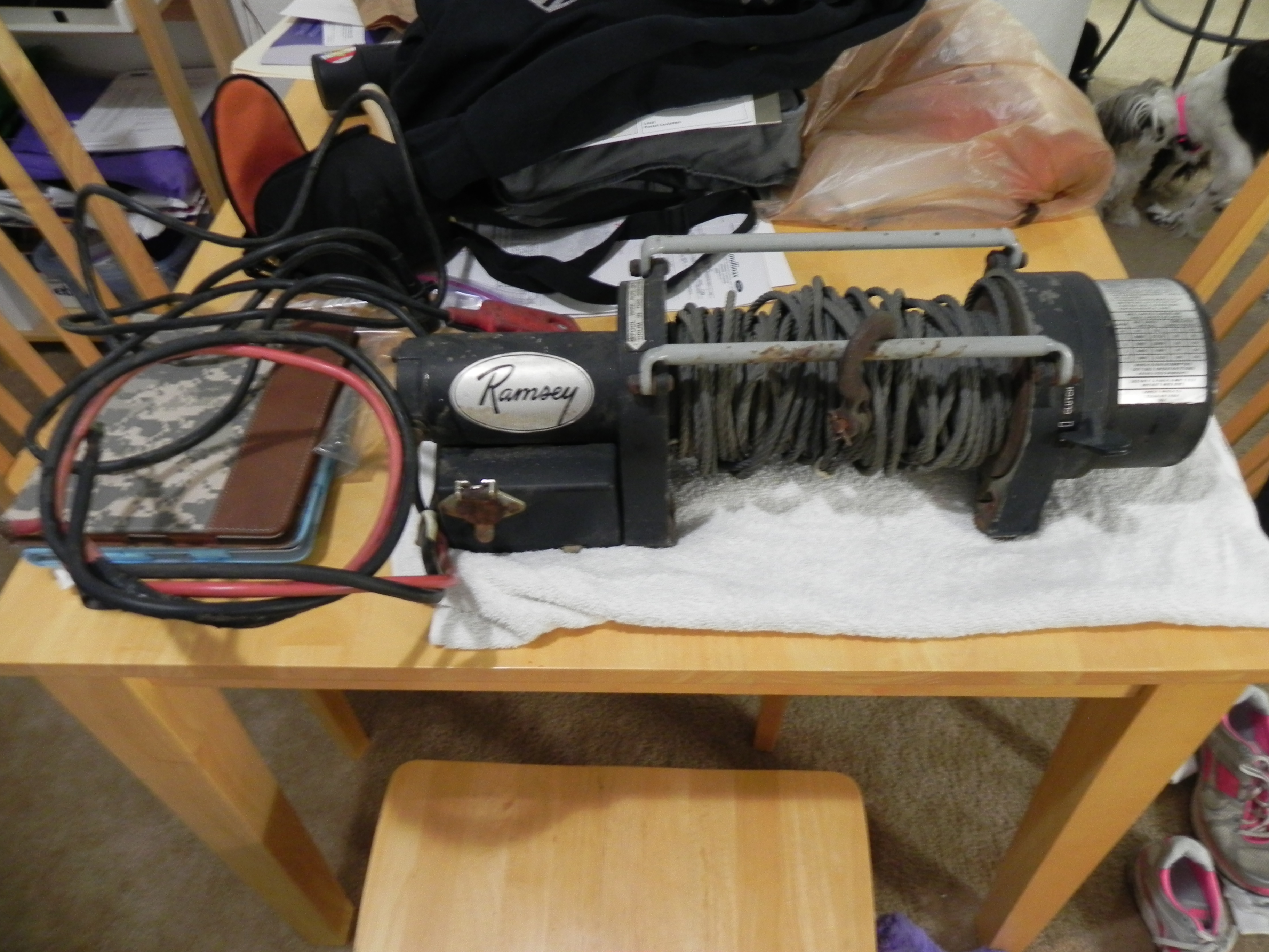

Hooray on the winch! It has great decals and with some new paint and some chrome it will look new.

4-5 days but i get to go in the shop and learn how to do it all i just dont have the tools and such to try and do it so ill just learn from it and thx im very happy with the winch might need new cables and so TLC and she will look brand new!

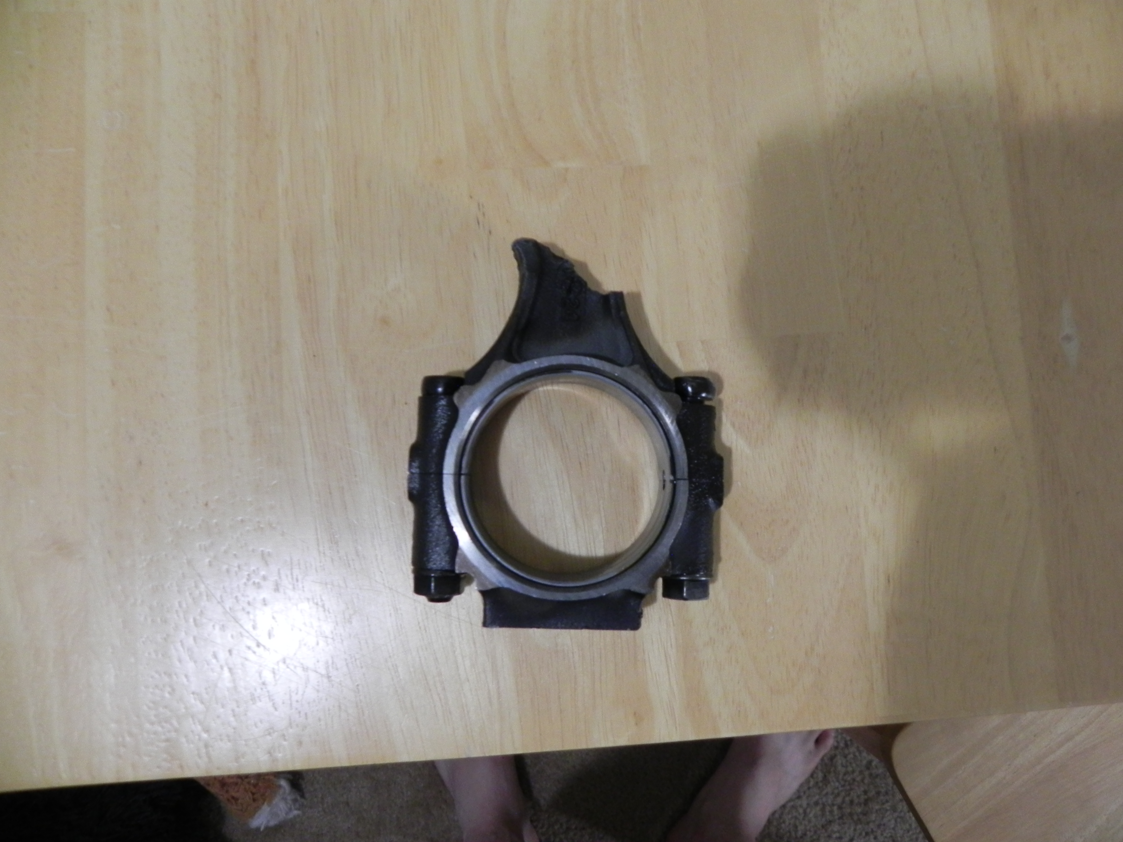

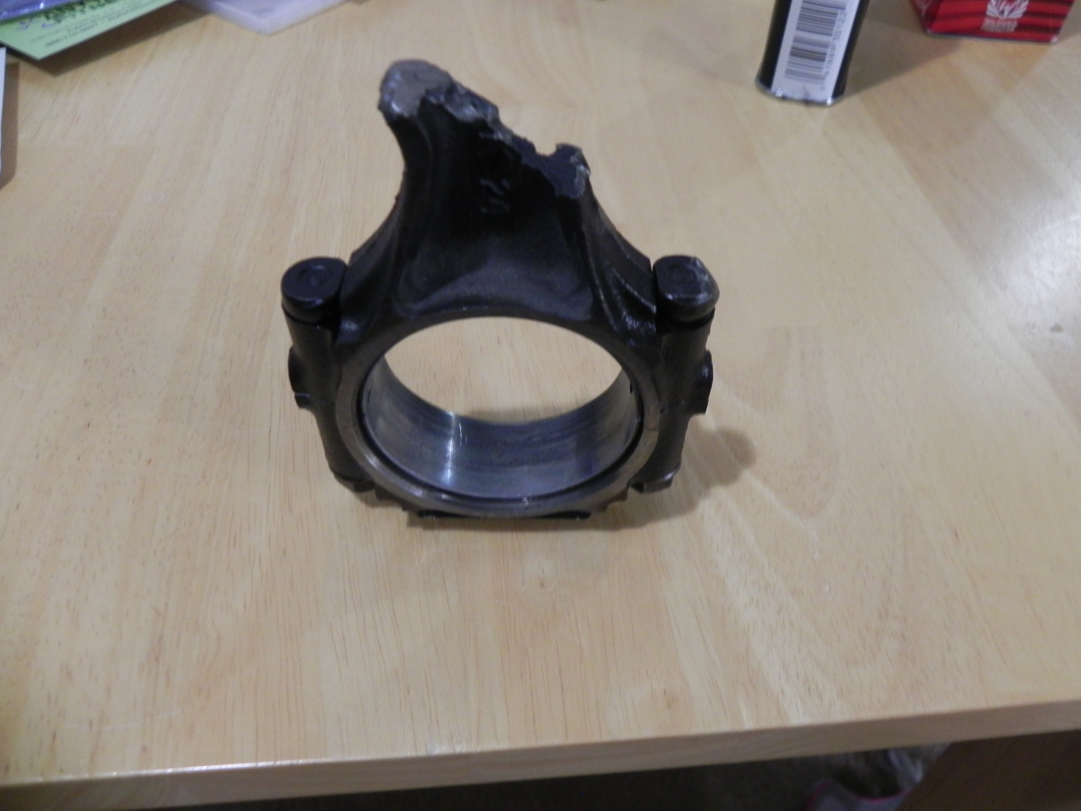

been to the shop every day after school and befor work and its almost done but we know what happened to the engine. when we took it out we found another hole in the oil pan and then a part of my piston it looks like it cracked and was just waiting to blow. along with that the oil pums was only held in with one screw :shock: and on top of it all the exhaust manifold was cracked in like 2 places so had to get a new one of thos...
