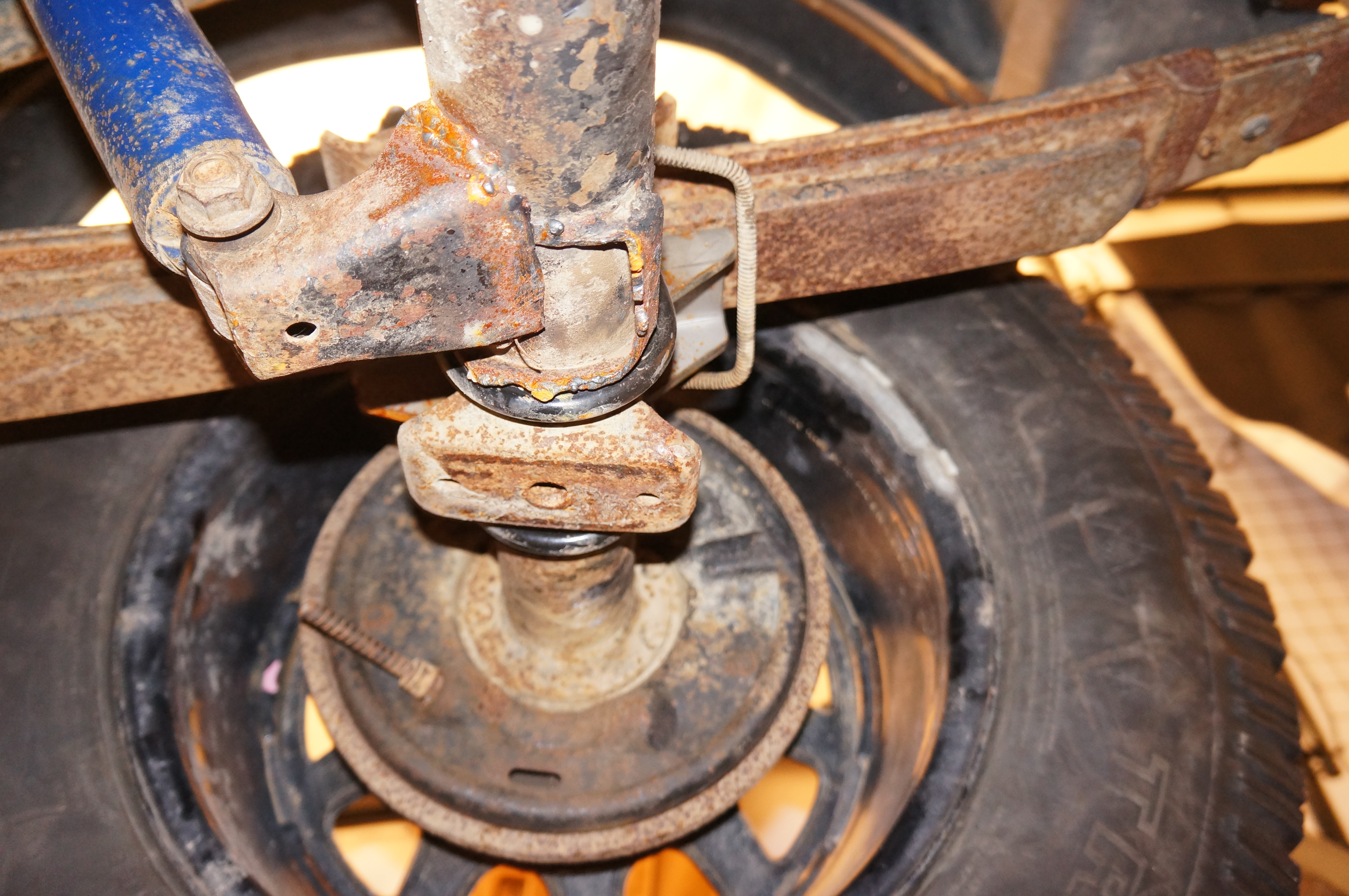

Ok so I need some opinions. This is my first big vehicle project and I dont know a whole helluva lot about suspensions, but on mine the guy had put the suspension over the axle so I shouldn't have to replace any of the leaf springs, but he did torch off the lower shock brackets and he moved them up a bit so that he would have clearance with the lift. My question is that If I get shocks to take me back down to stock height, could I still use the mounts where he has them or would I have to get a new set of lower shock mounts and put them back where they originally were? ( I know what the CORRECT answer is, my question is would I really hurt the jeep by letting them where they are)

your probably better off replacing the shock mounts. and you might want to replace the leaf's, they are 17 years old

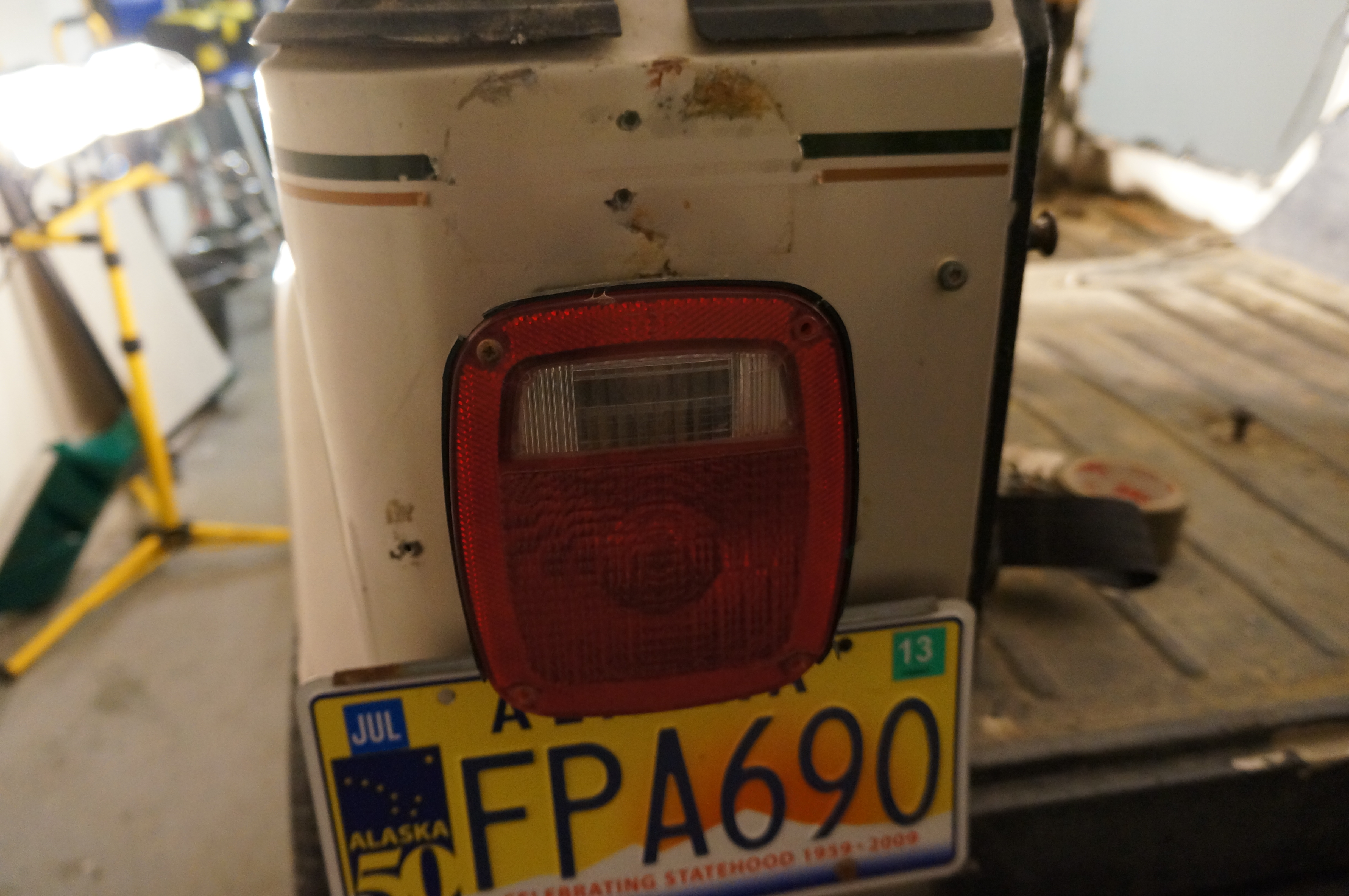

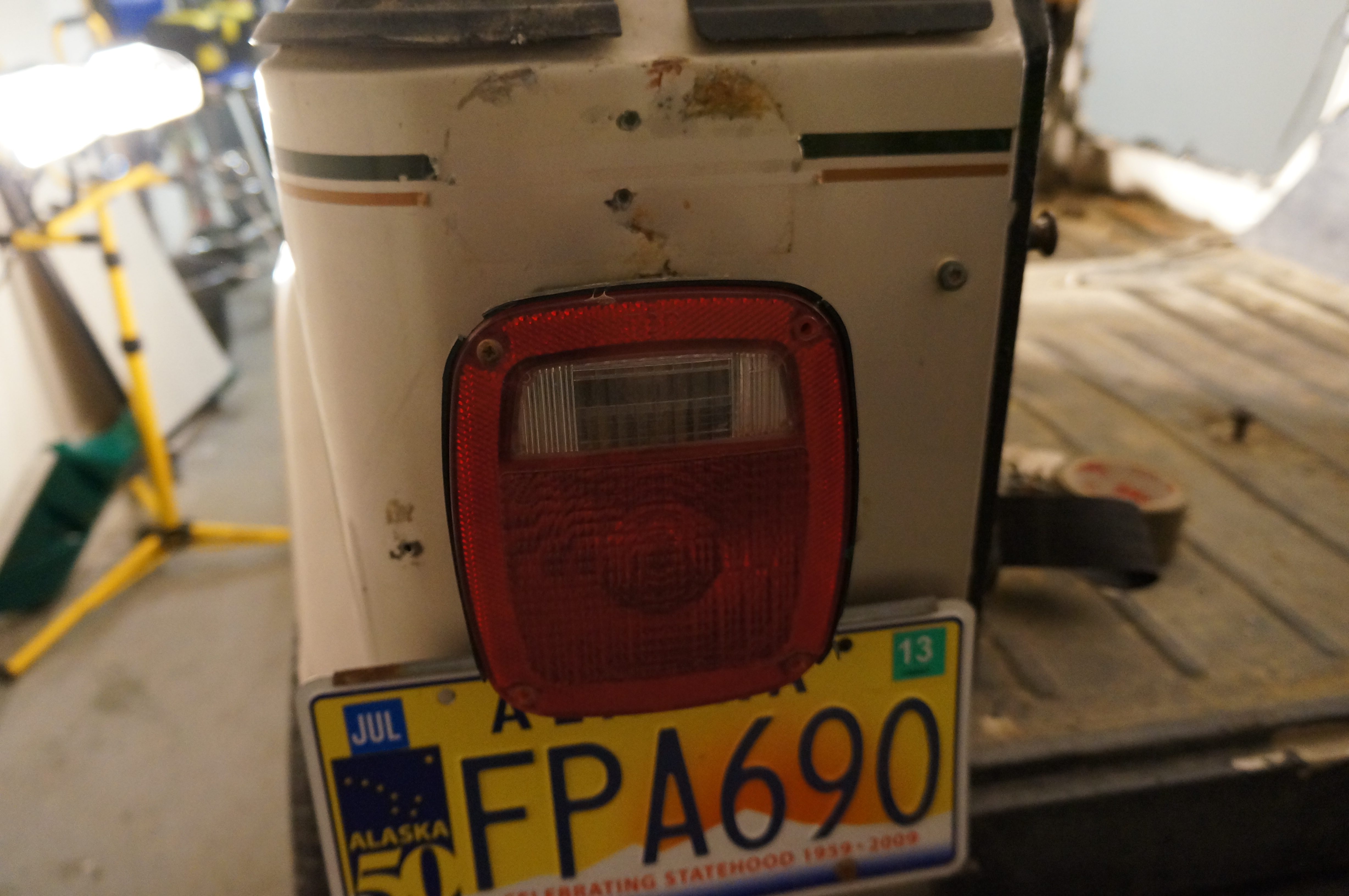

Hey all, sorry but duty called so I was gone for a few weeks. Back to ripping the jeep apart. Ive got a lot done so im gonna separate the posts so that they follow the individual days I worked on the jeep.
got those awful tail light guards off too. Just gonna try and fill in the holes the same way that Im going to where the ammo cans were. Any other thought of how to fill in the wholes?<br /><br />For now thats all. Ill have more pics up this afternoon of what I did on the 3rd day

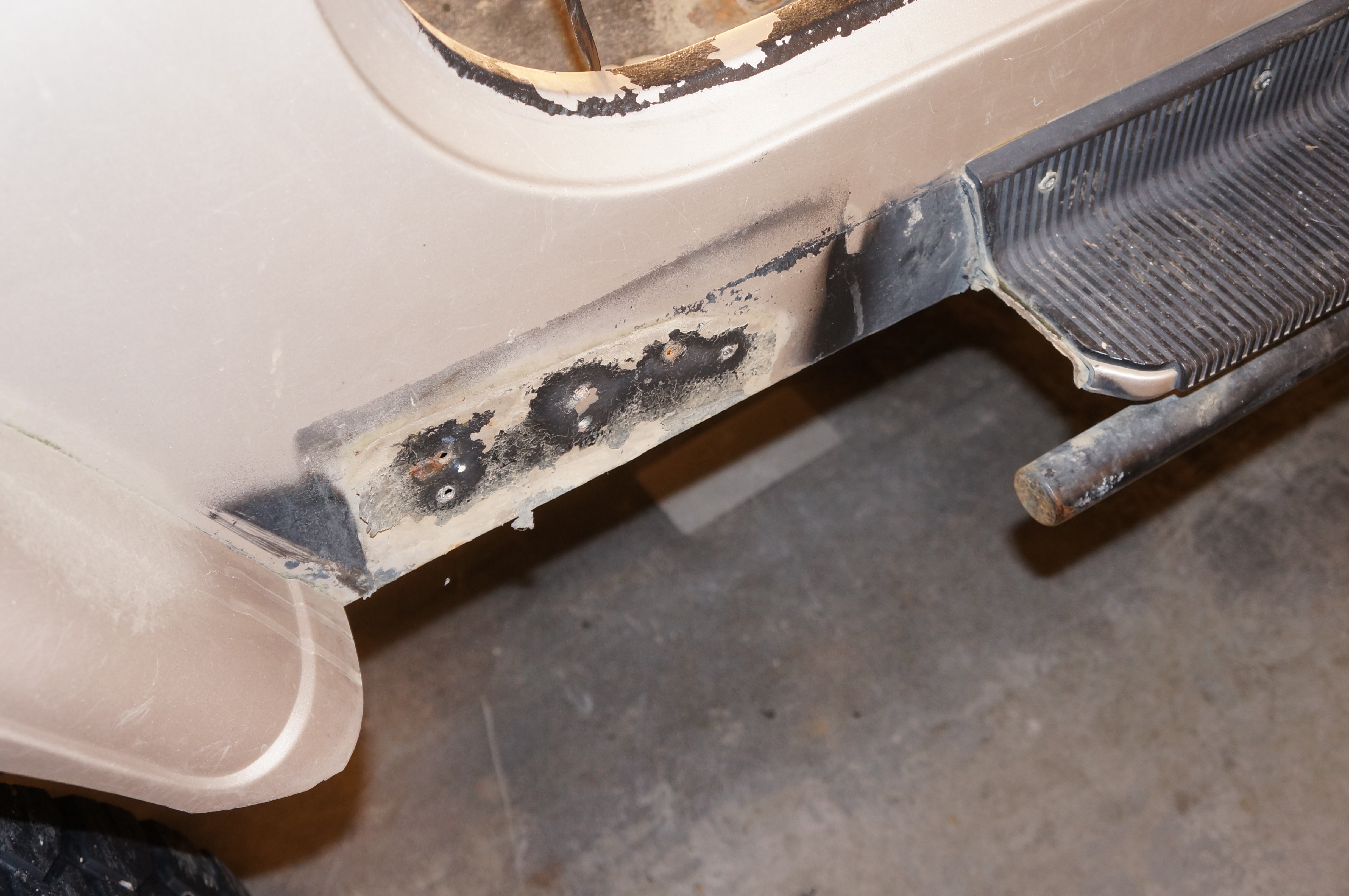

Took off those horrid ammo cans he had mounted to the side. Ive got a lot of little wholes now though, but what I think Im gonna do is spot weld the holes to fill them in and then just grind them down

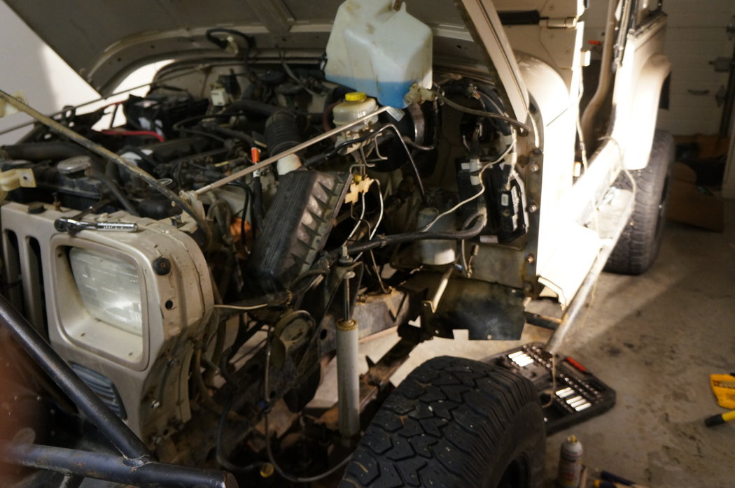

ended up ripping off the whole fender. It bends inward on the lower part where it meets the fender flare. Got an appointment this monday to see how much it will cost to bend it back to where it needs to be

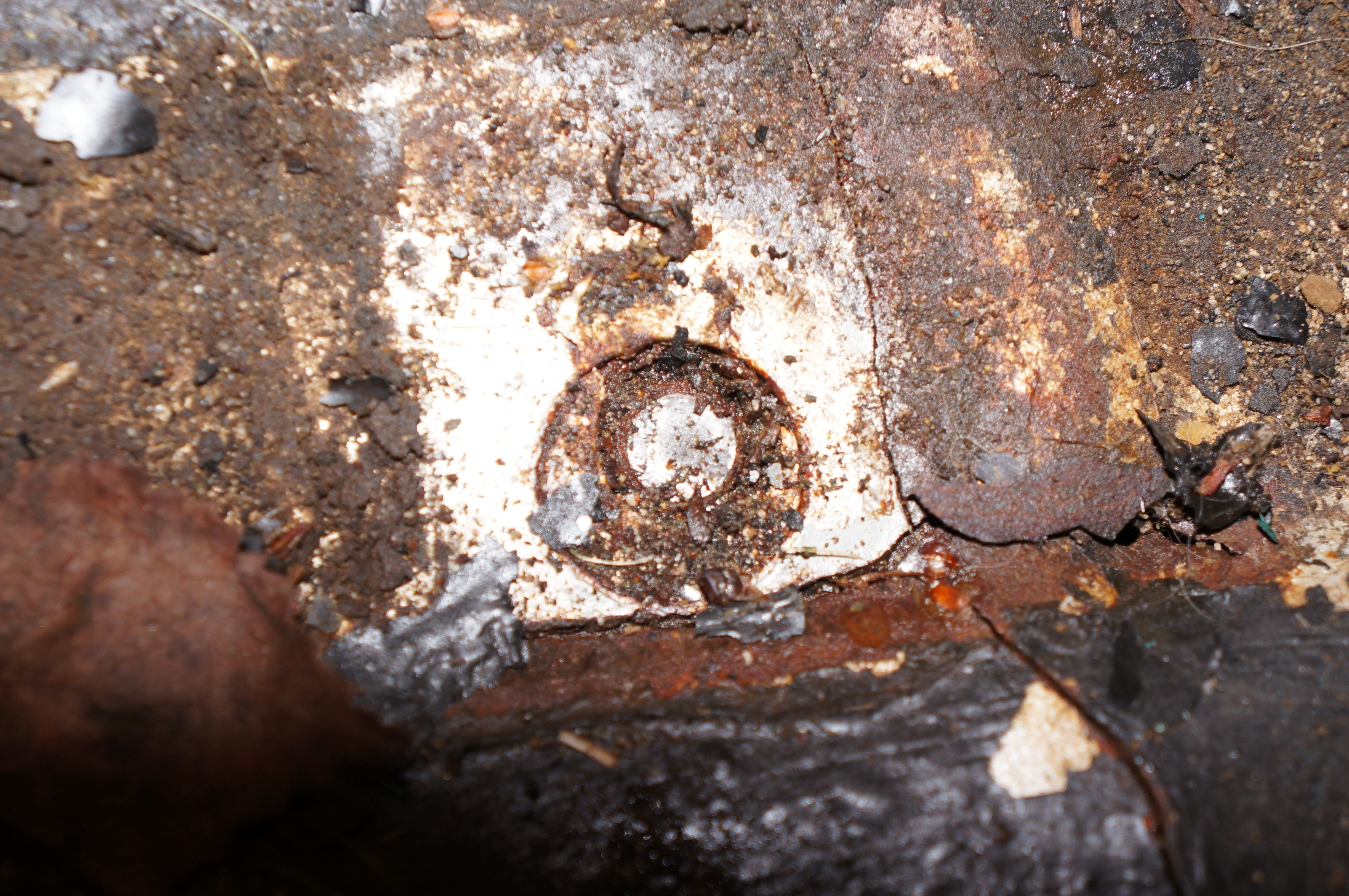

Broken bolts have been the bain of my existence on this jeep. Most of the bolts came right out with some pb blaster and a quick hit from the torch. others were not so forgiving. Had to drill alot fo them and use the bolt extractor things, and then the ones really in there i had to completely drill out. Just gonna have to put a bolt on the bottom of some of them now since the OEM bolt welded to the body is now to big due to drilling.

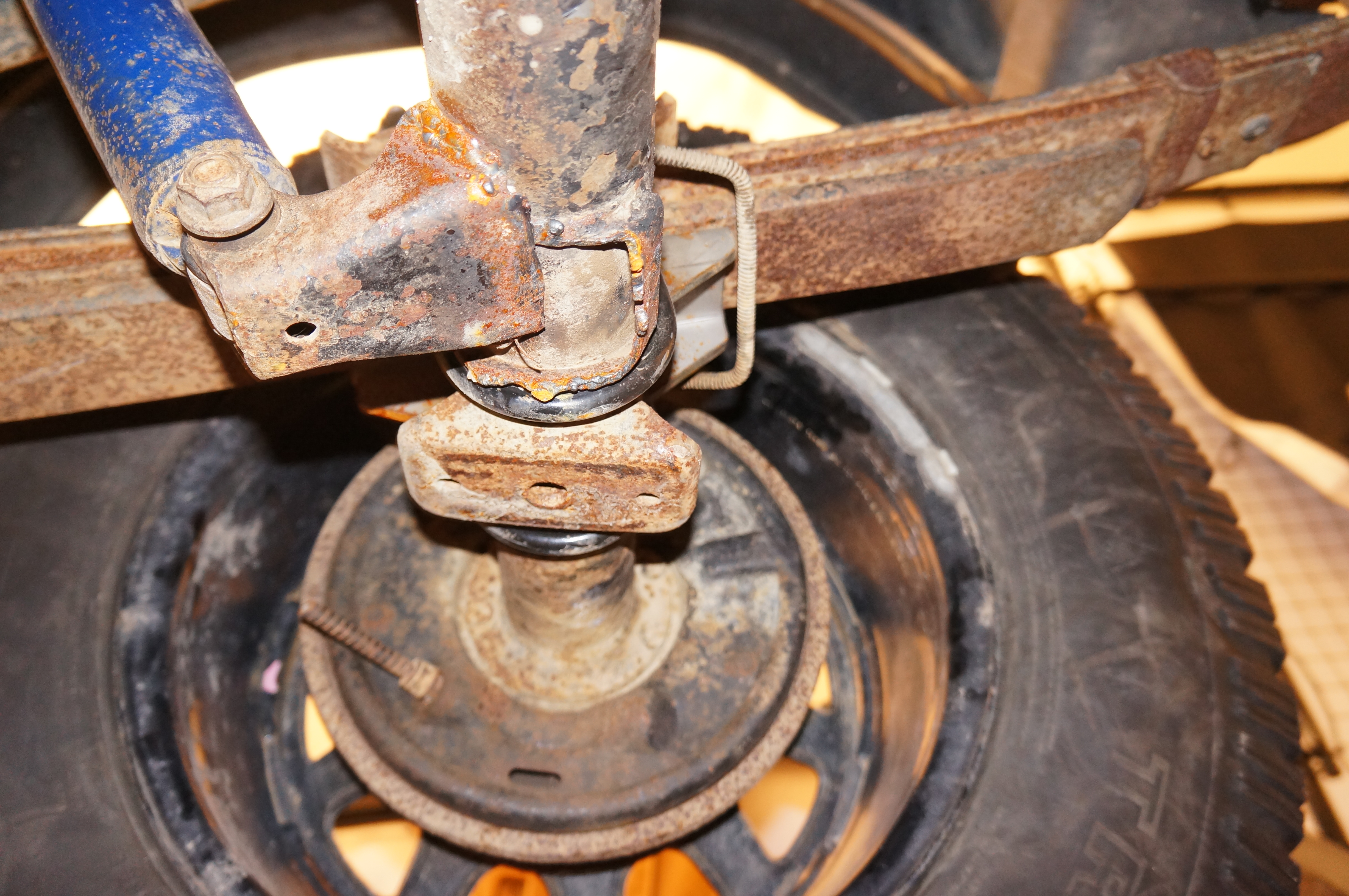

Here is that rear shock mount I told everyone about. Cant believe this, and his weld was awful. What Im gonna try is swap out the front ubolt plates with the rear ones. The front ubolt plates had rods attached that are meant for a shock mount. I measured it out and when I put the leaf springs back under the axle, they will extend out exactly where the old mounts would align, its just they will be about 1&quot; higher. Dont think it will be a large ordeal since I wont be doing any serious off roading with her. If it doesnt work then I will break down and buy shock mounts and weld them on.
Here is that rear shock mount I told everyone about. Cant believe this, and his weld was awful. What Im gonna try is swap out the front ubolt plates with the rear ones. The front ubolt plates had rods attached that are meant for a shock mount. I measured it out and when I put the leaf springs back under the axle, they will extend out exactly where the old mounts would align, its just they will be about 1" higher. Dont think it will be a large ordeal since I wont be doing any serious off roading with her. If it doesnt work then I will break down and buy shock mounts and weld them on.

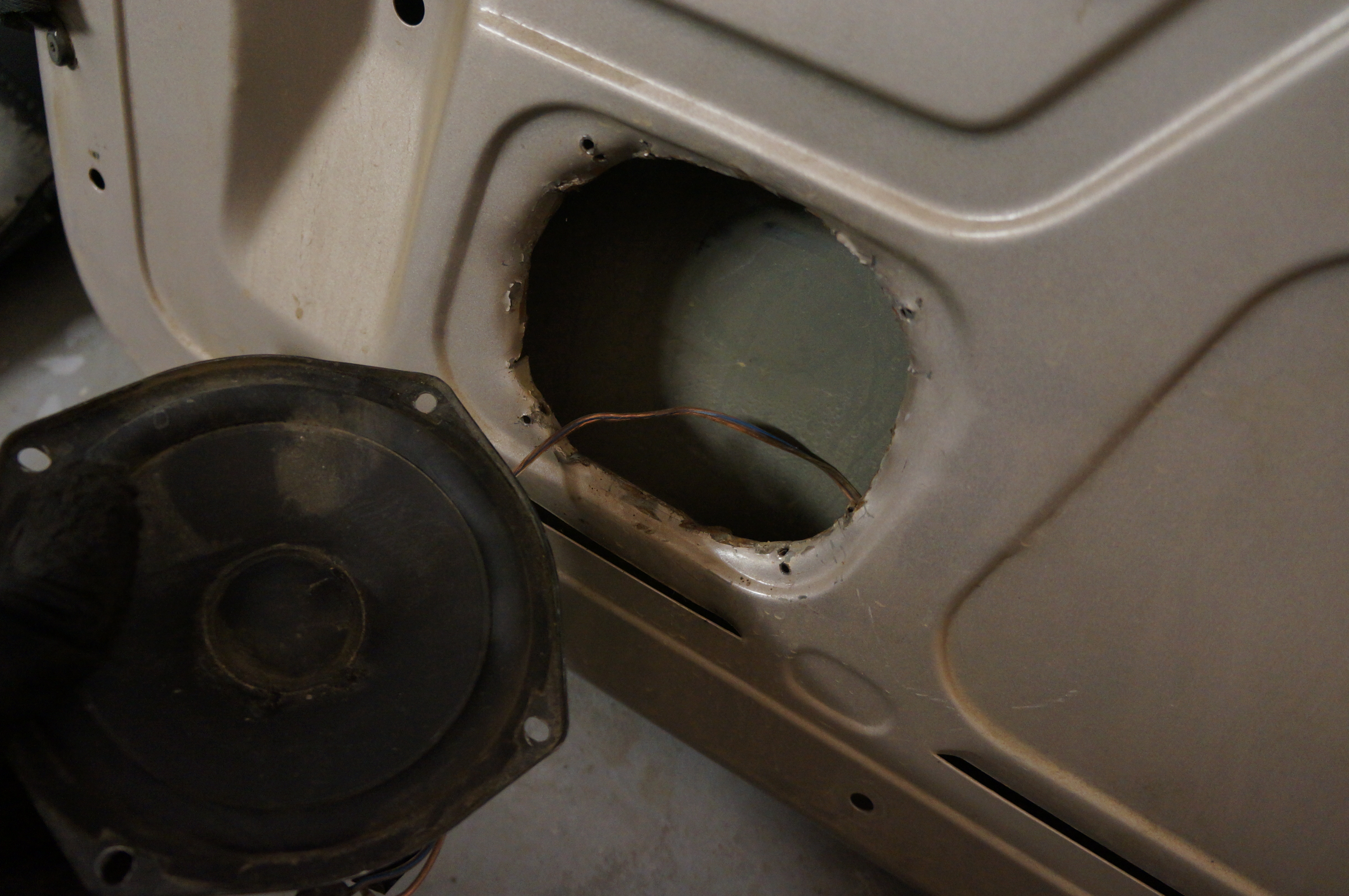

Cant belive the guy cut holes in the door for speakers

some of those holes where the ammo cans were for the back part of the side steps, looks like you need a new set since they were cut.
