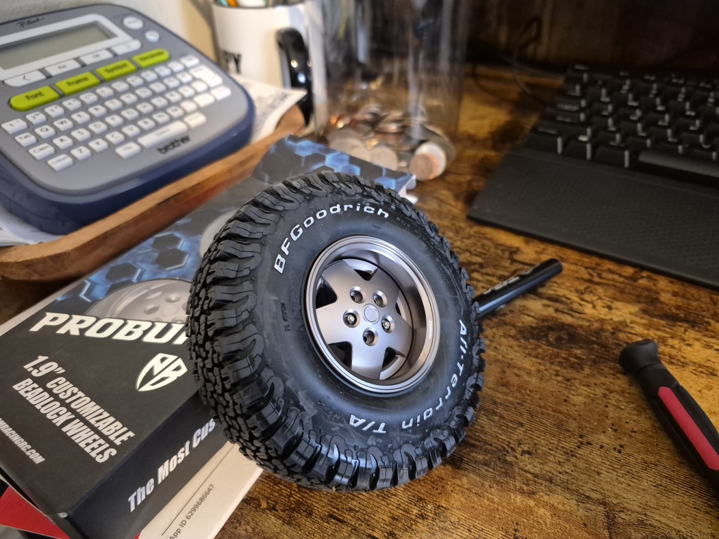

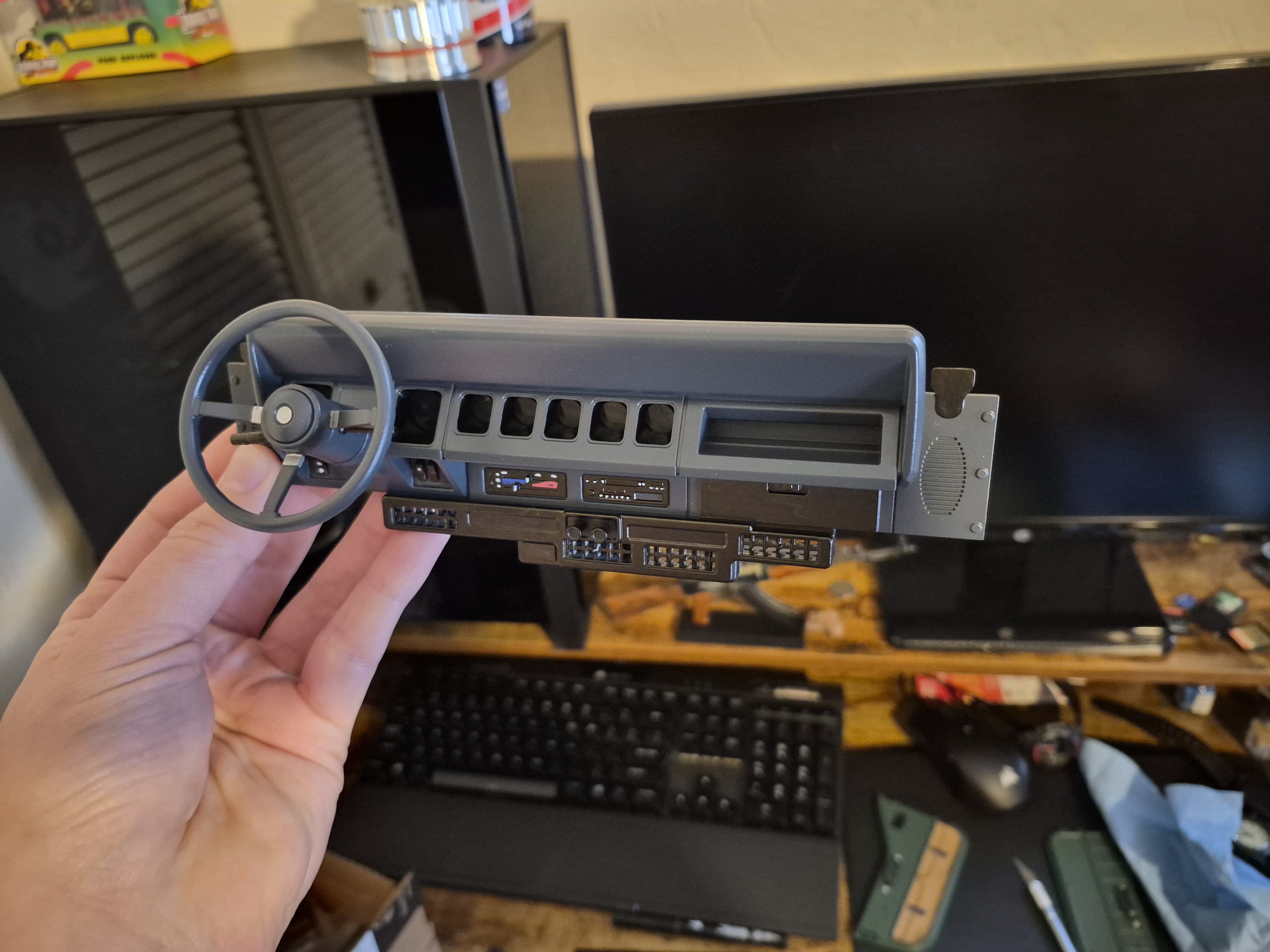

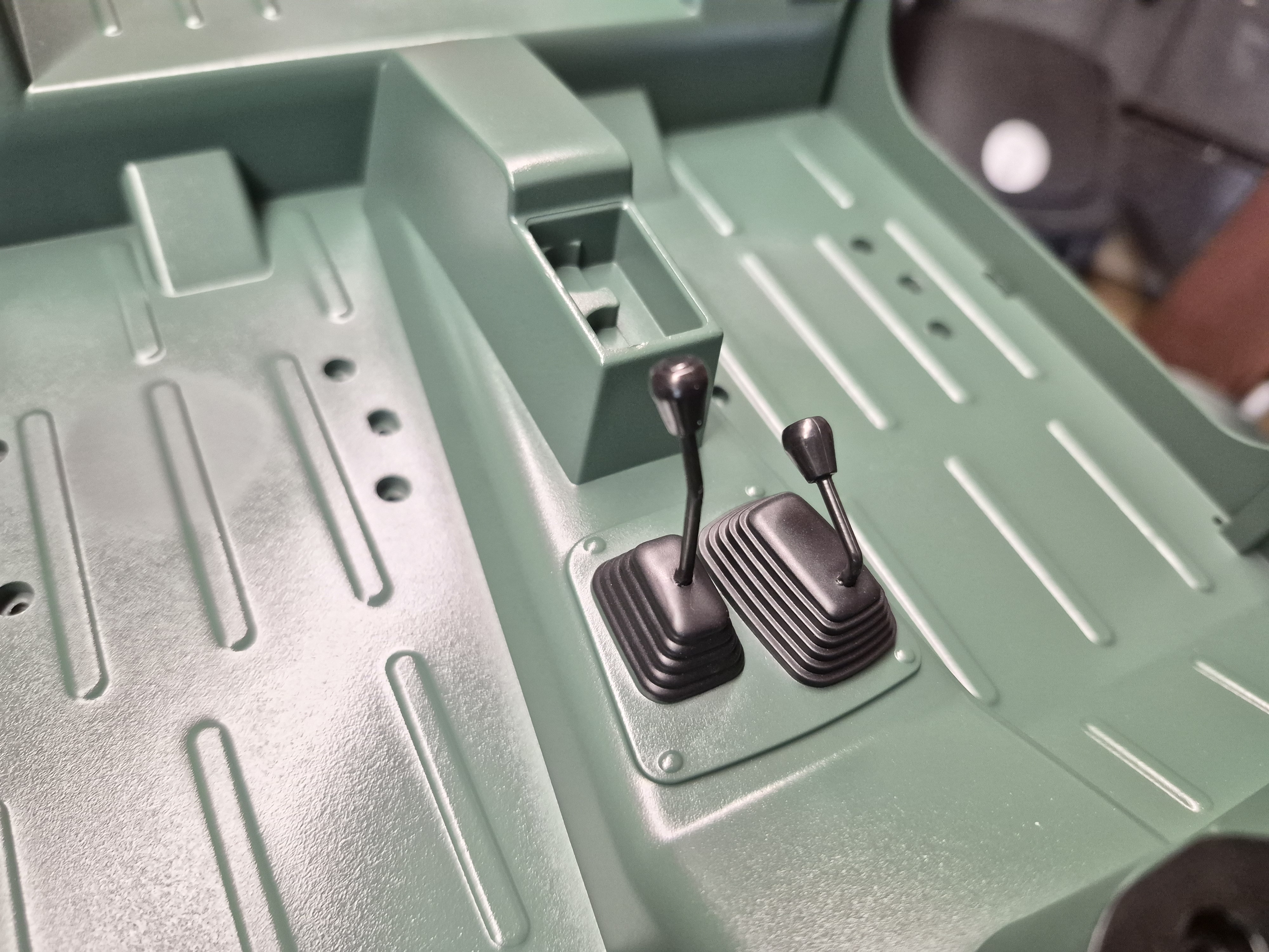

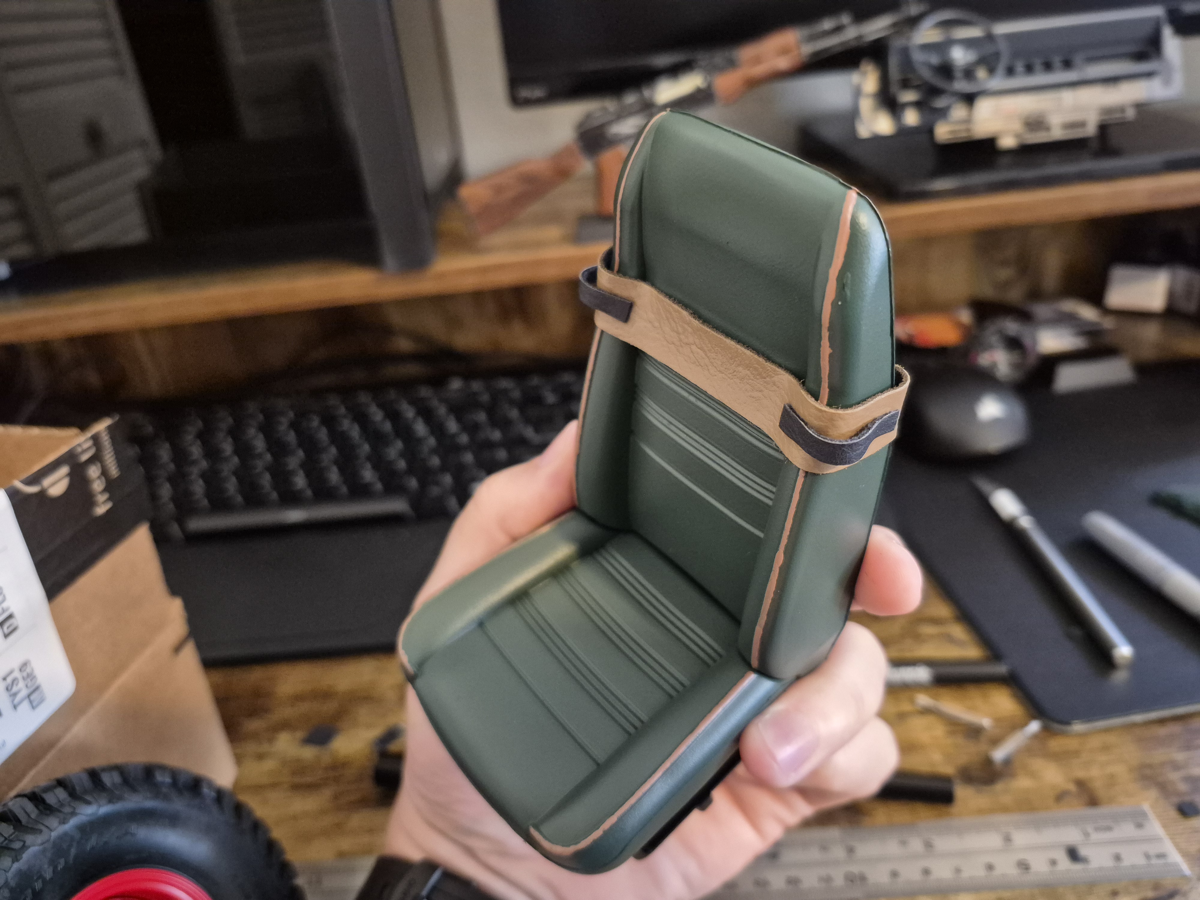

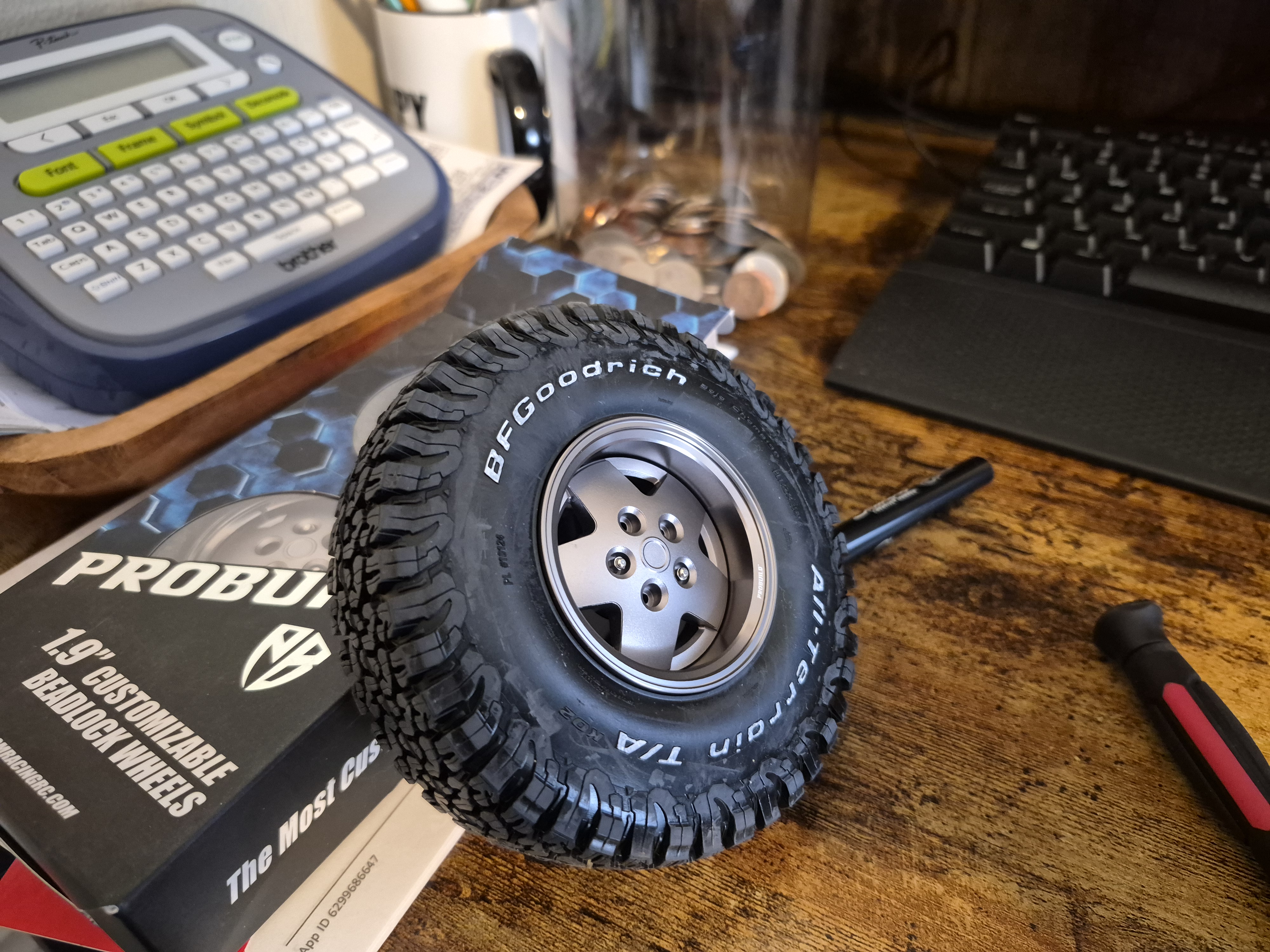

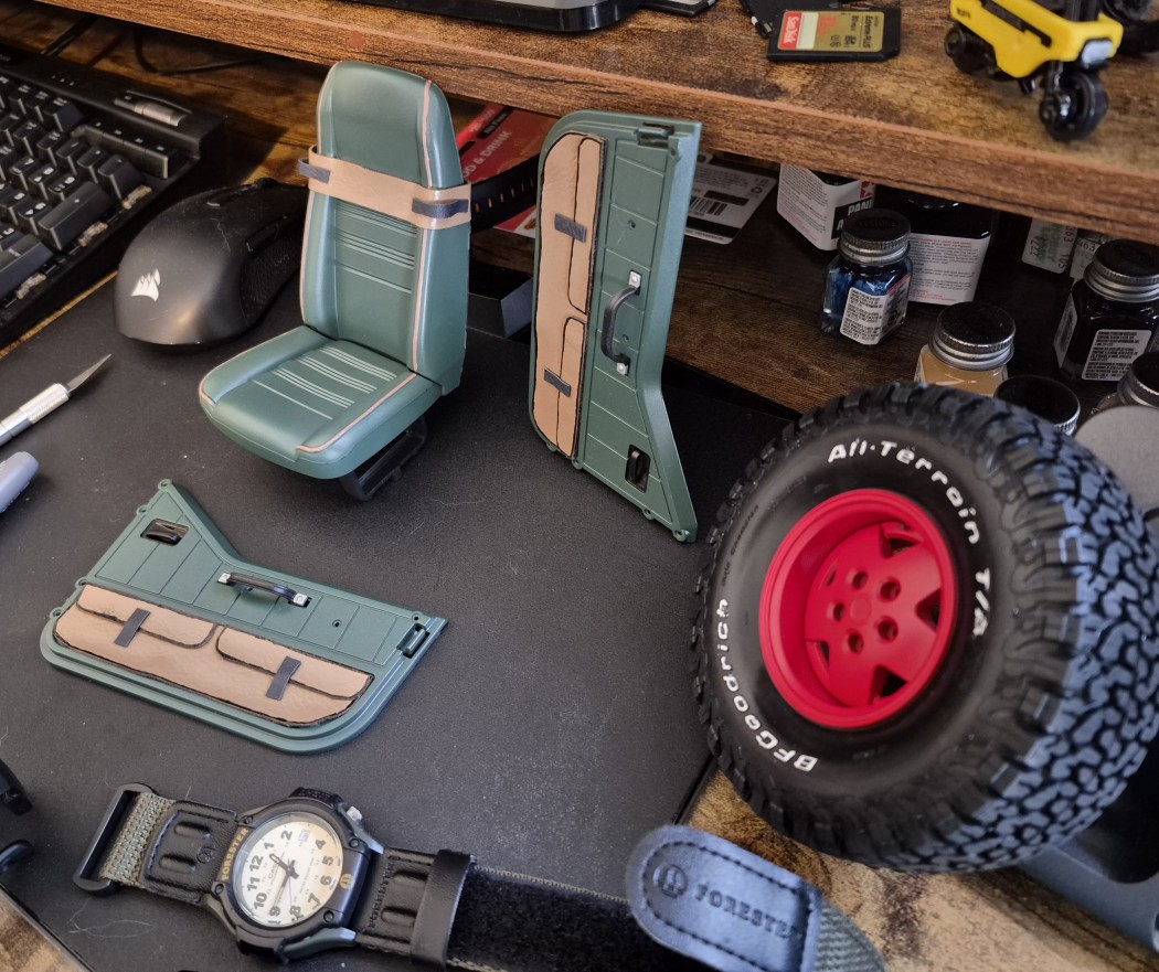

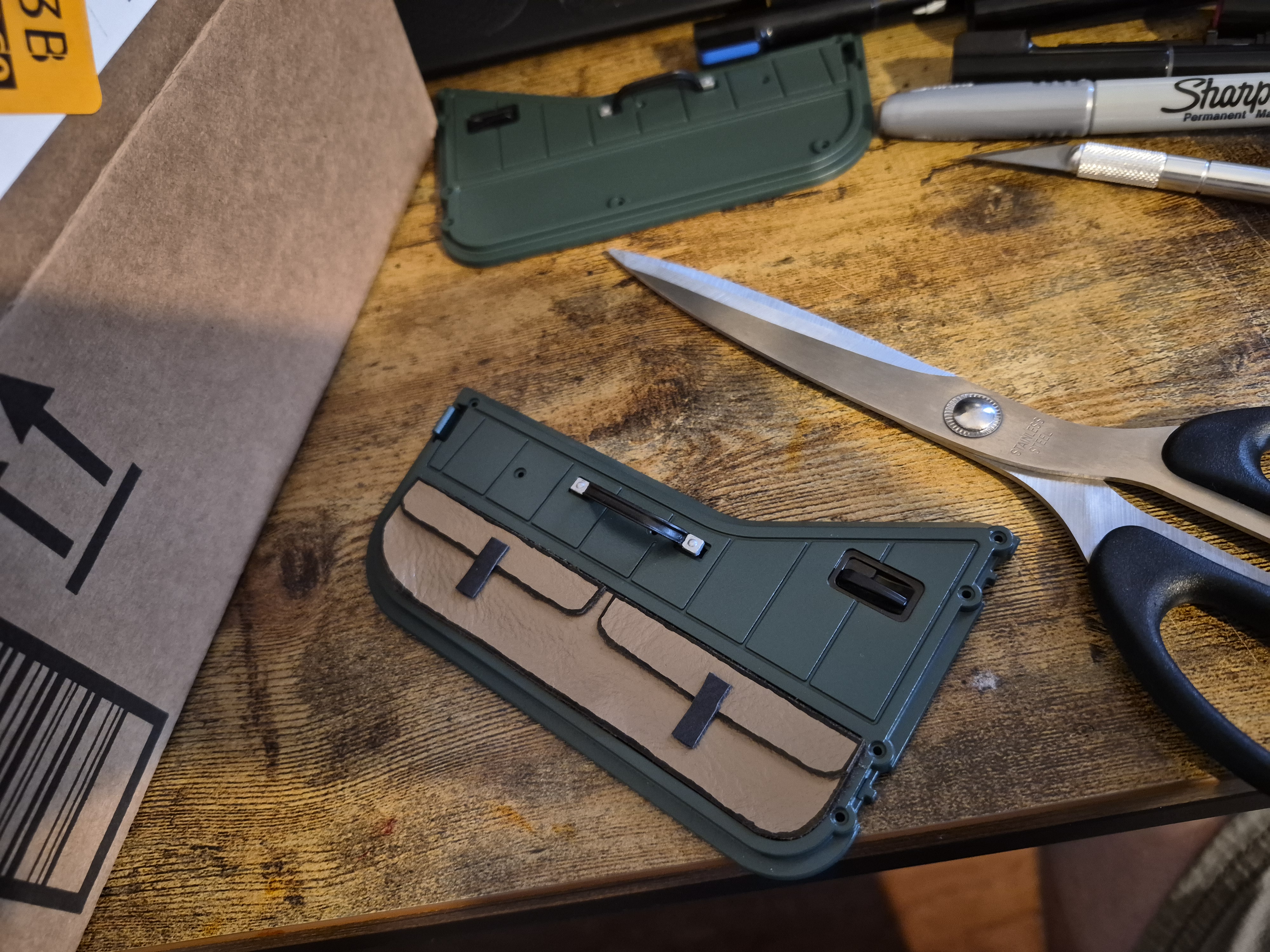

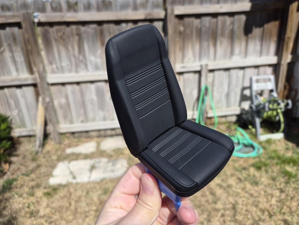

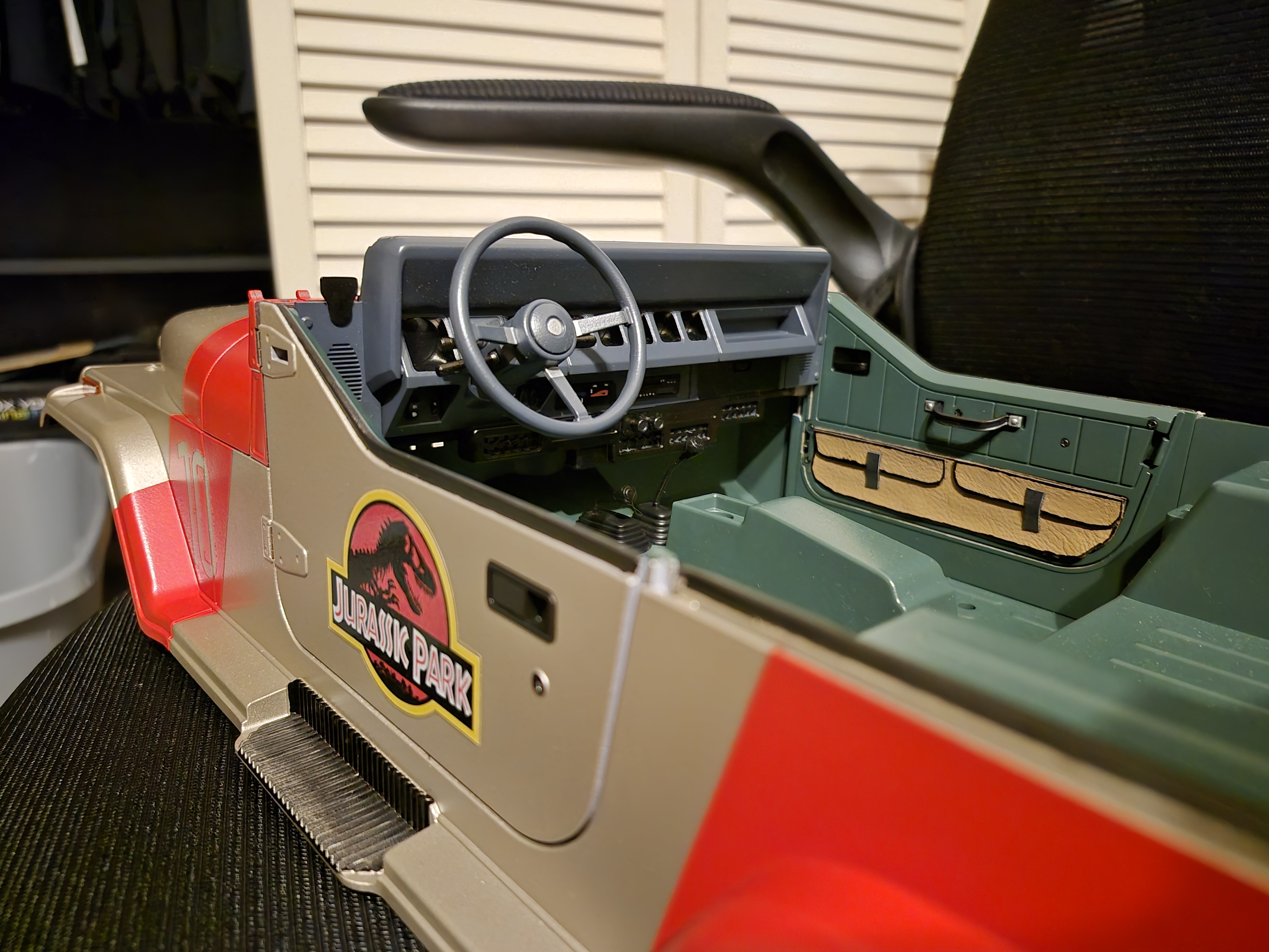

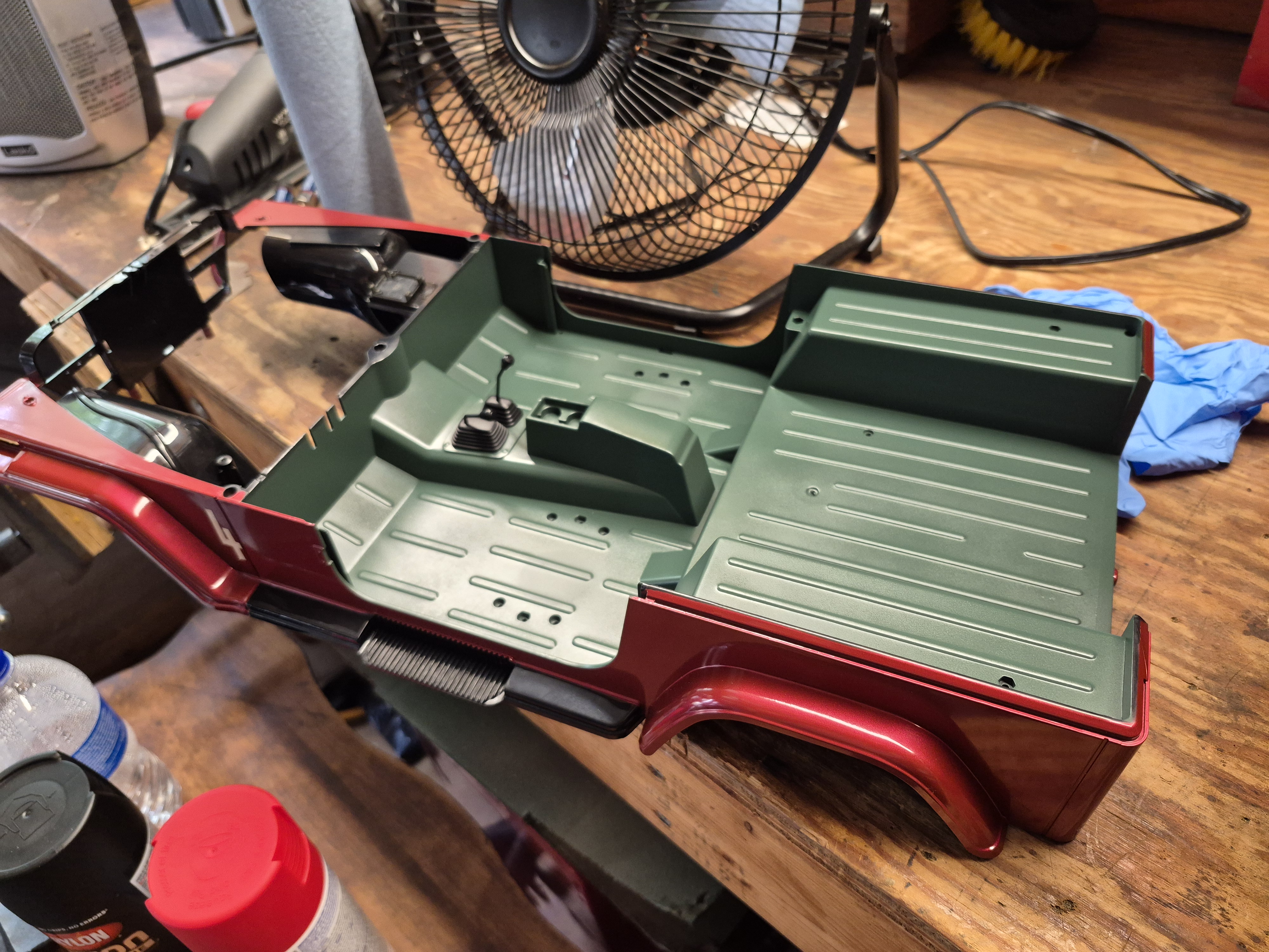

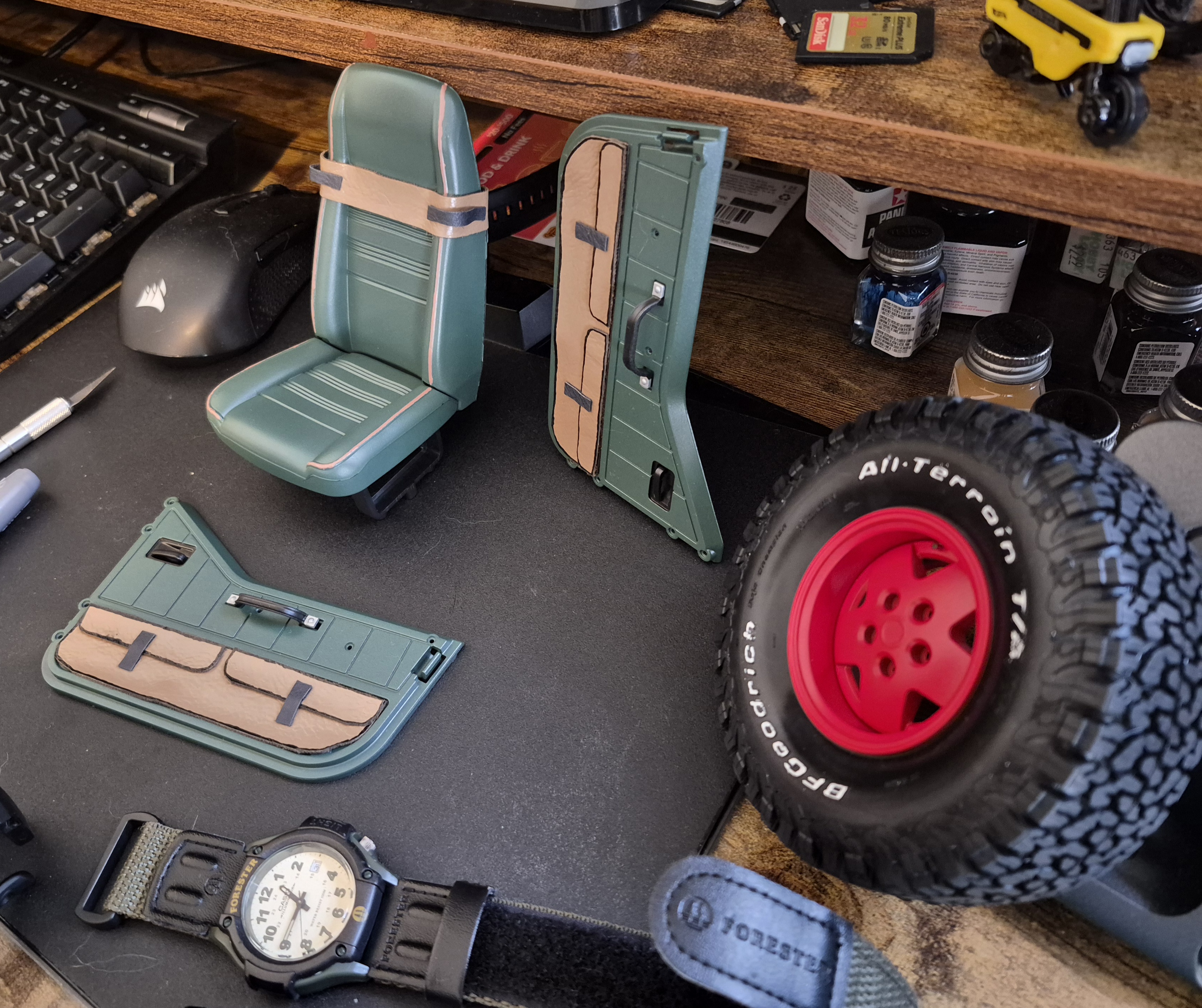

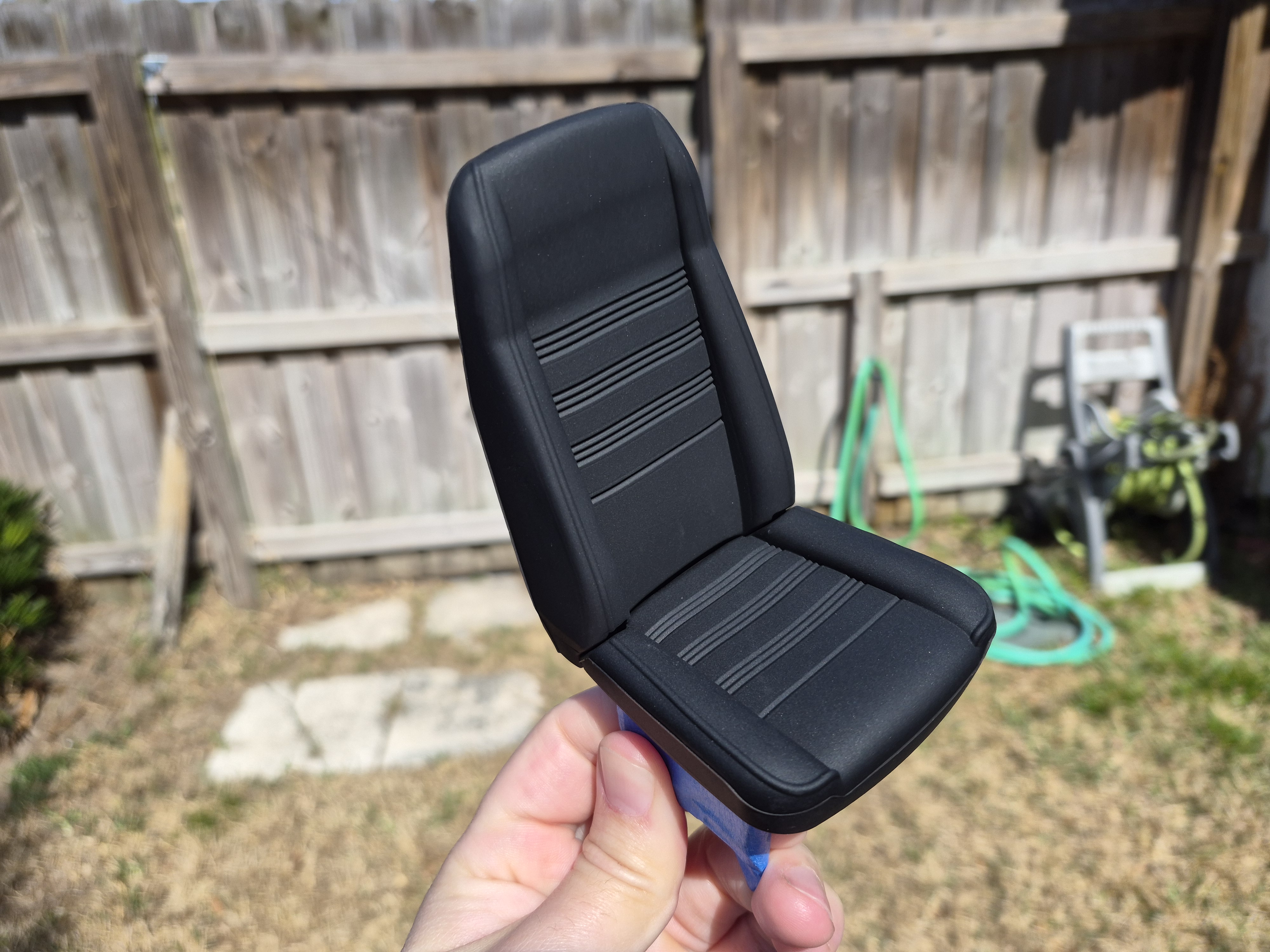

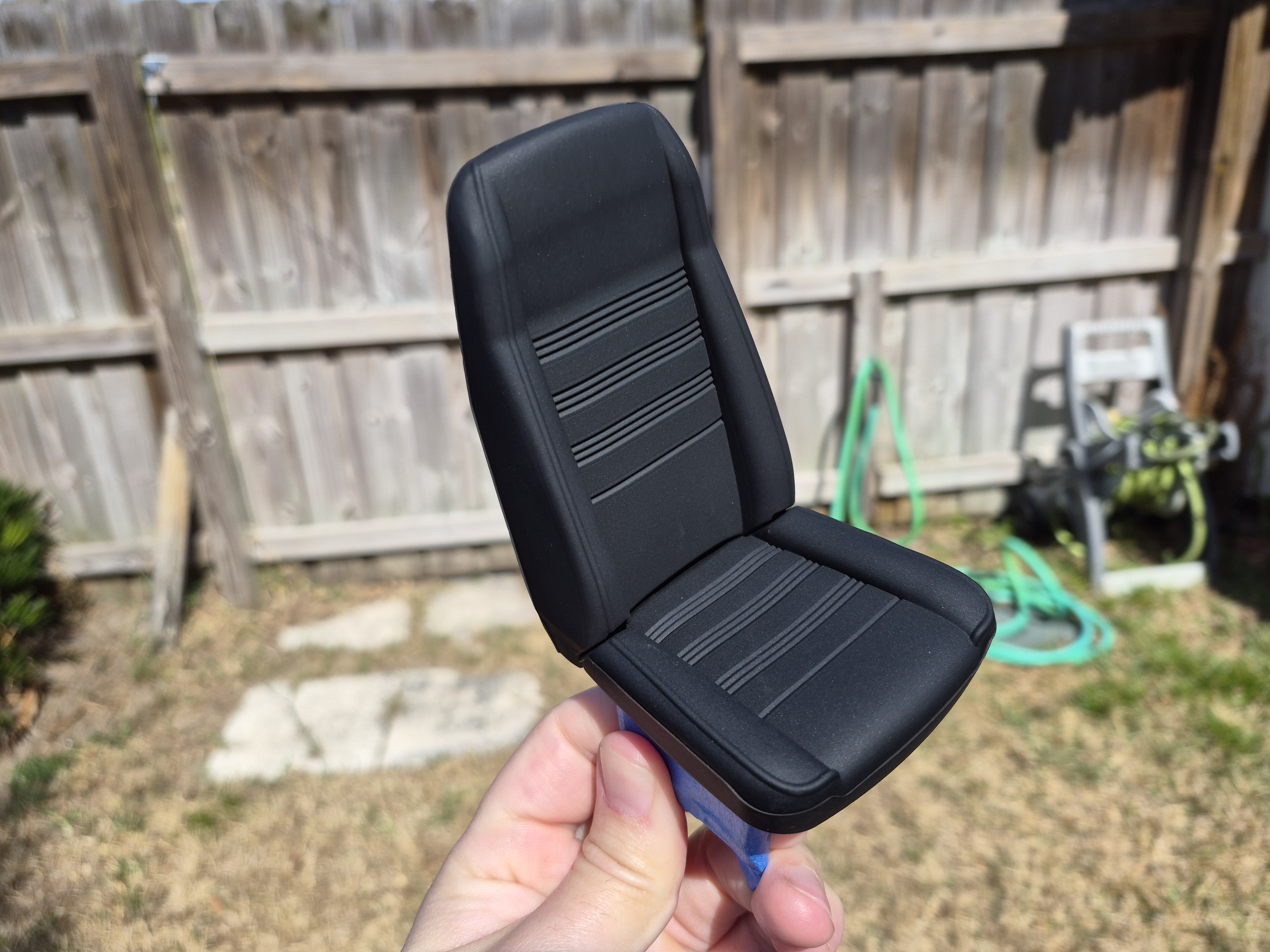

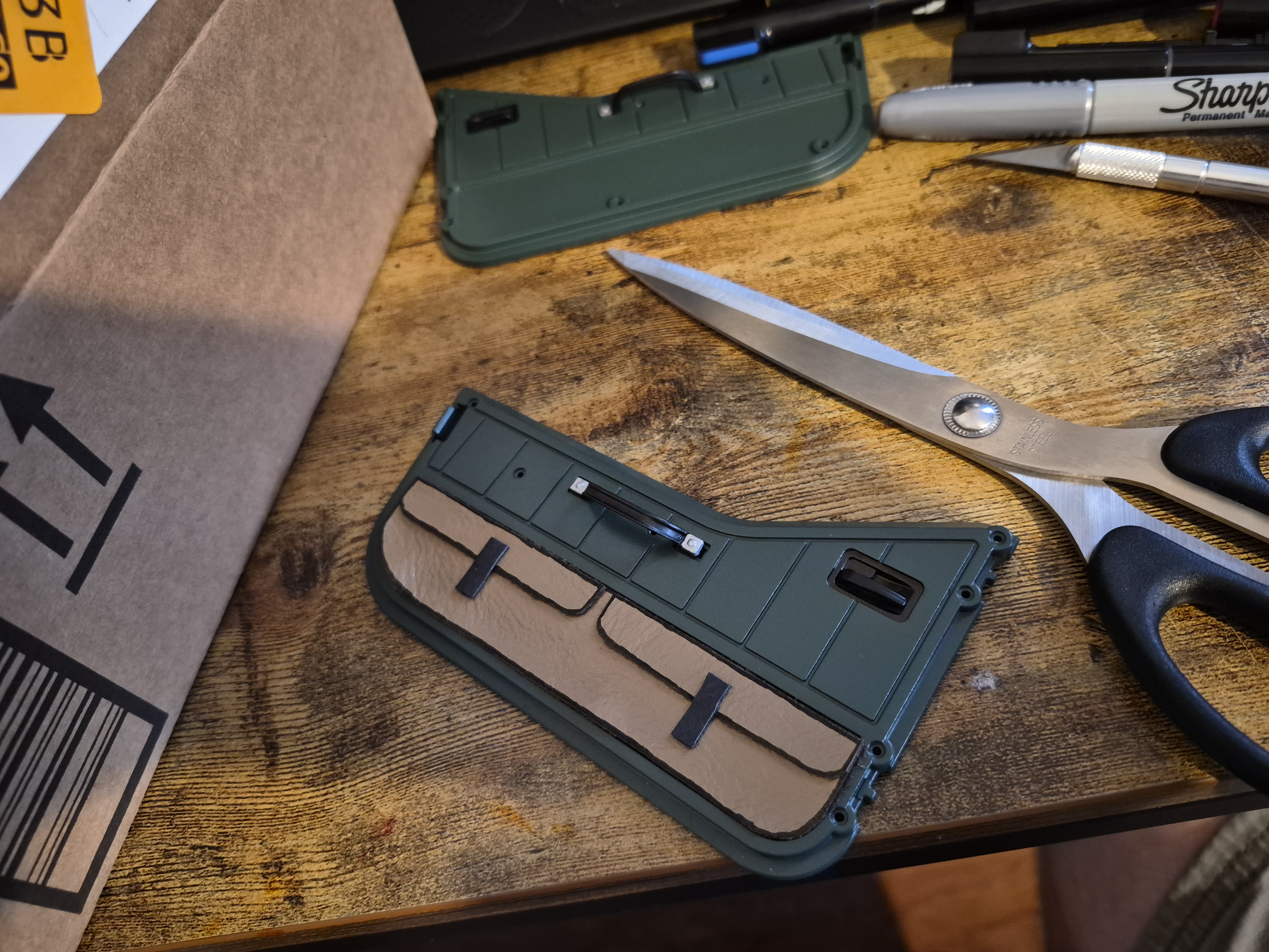

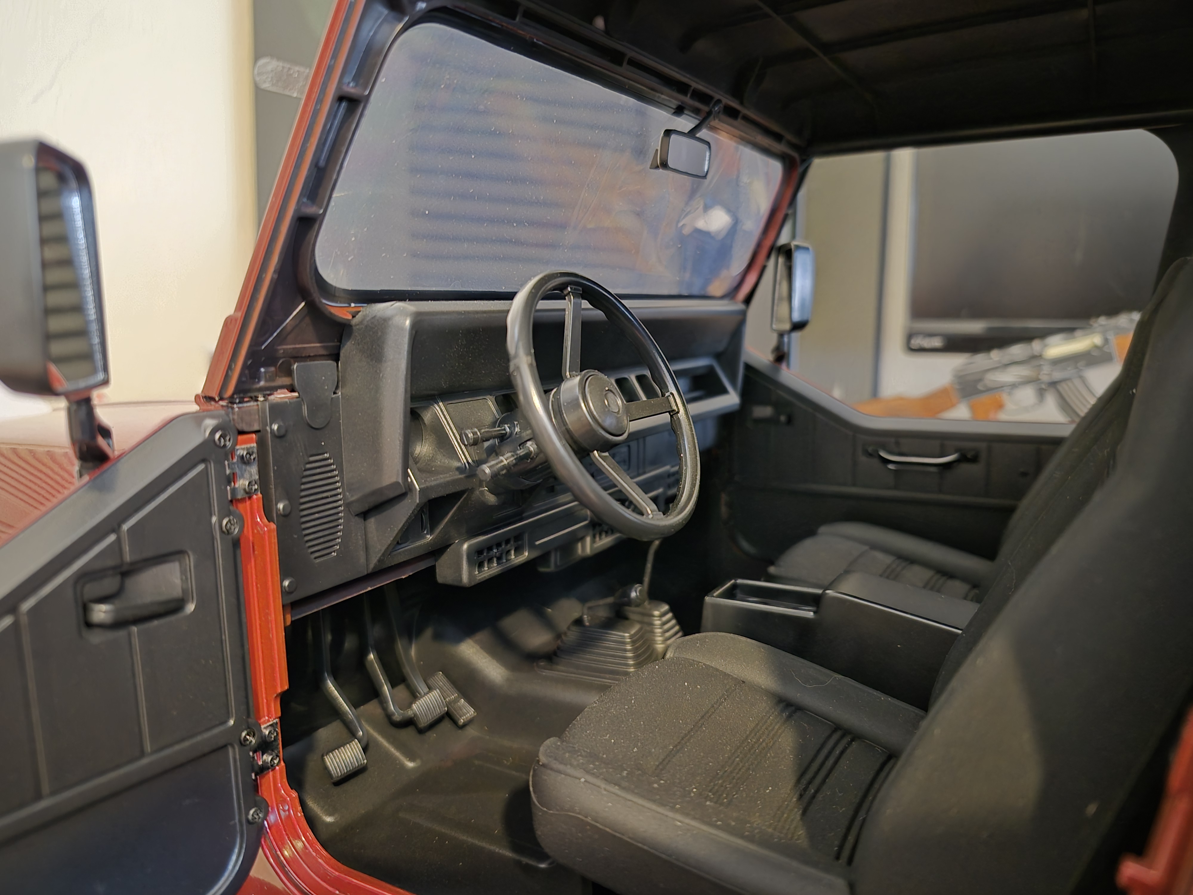

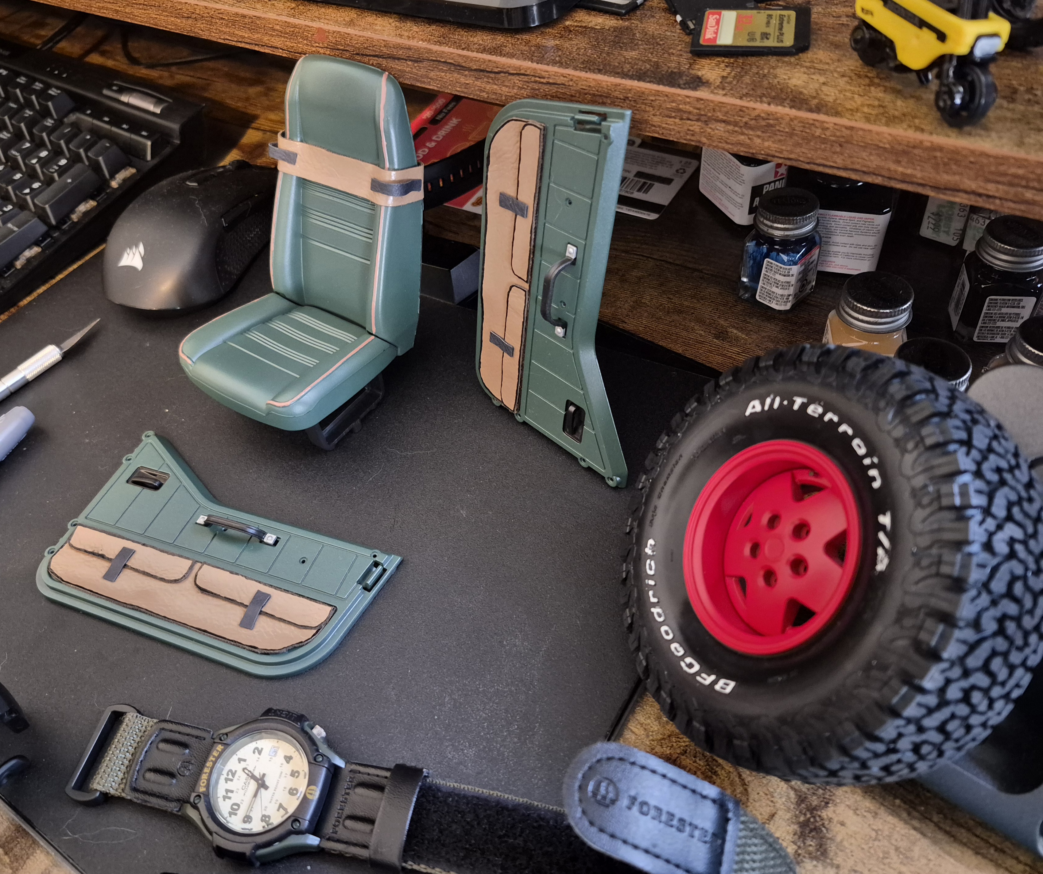

Starting this build off with the interior and painting wheels. Everything painted green is with Rustoleum Hunt Club Green. I used some thin fake leather from Hobby Lobby to create the door panel pouches and the seat stripes. The leather was originally black, so I painted it with Rustoleum Nutmeg. For the dash, I used a slate grey color and hand painted all the details with Sharpie paint pens from Wal-Mart. The gauges will be lit with LEDs and will have the instrumentation decals applied, but that's for later.

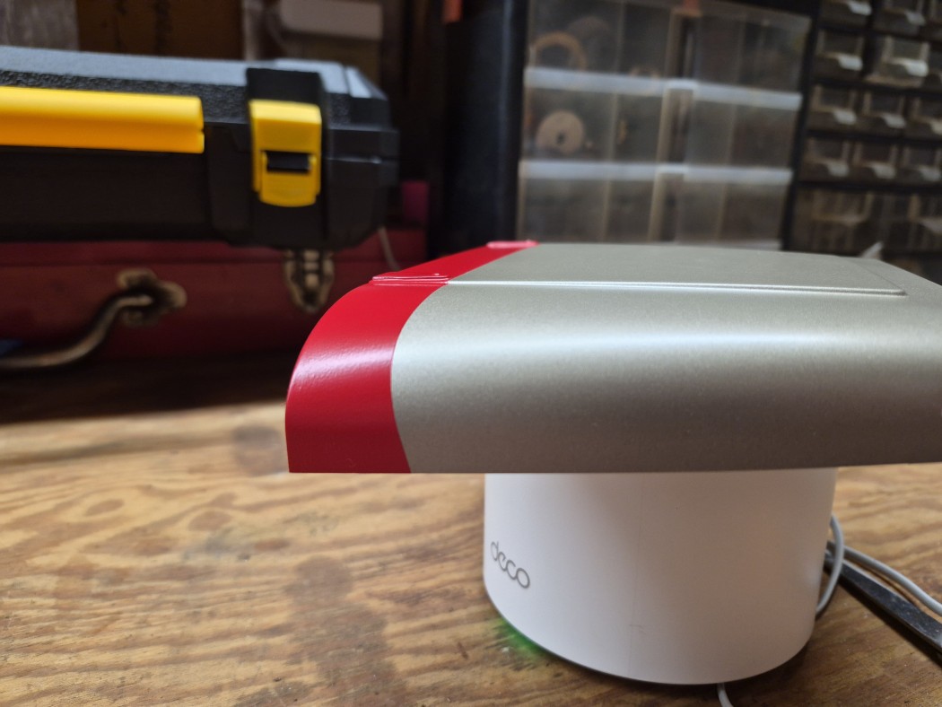

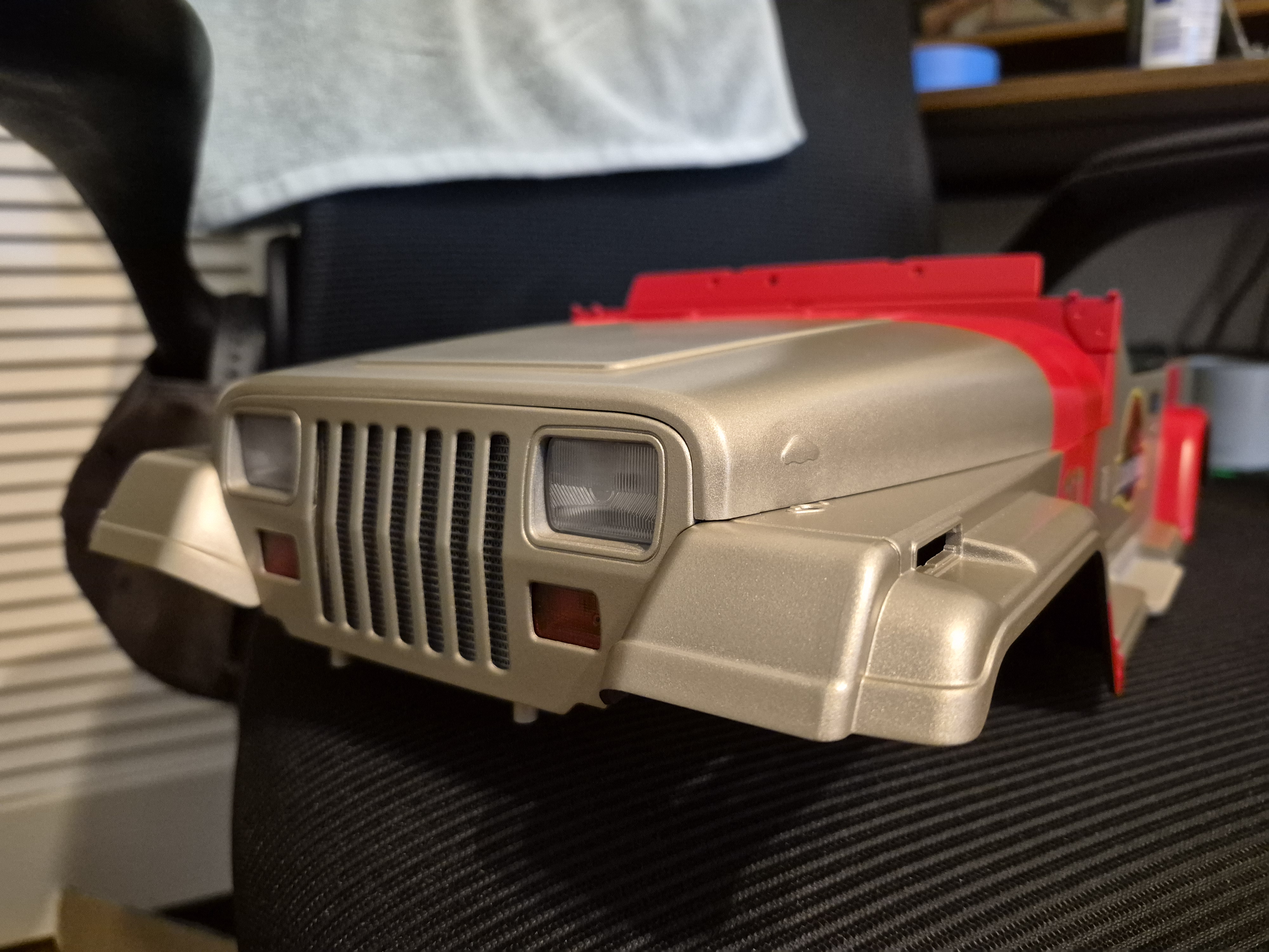

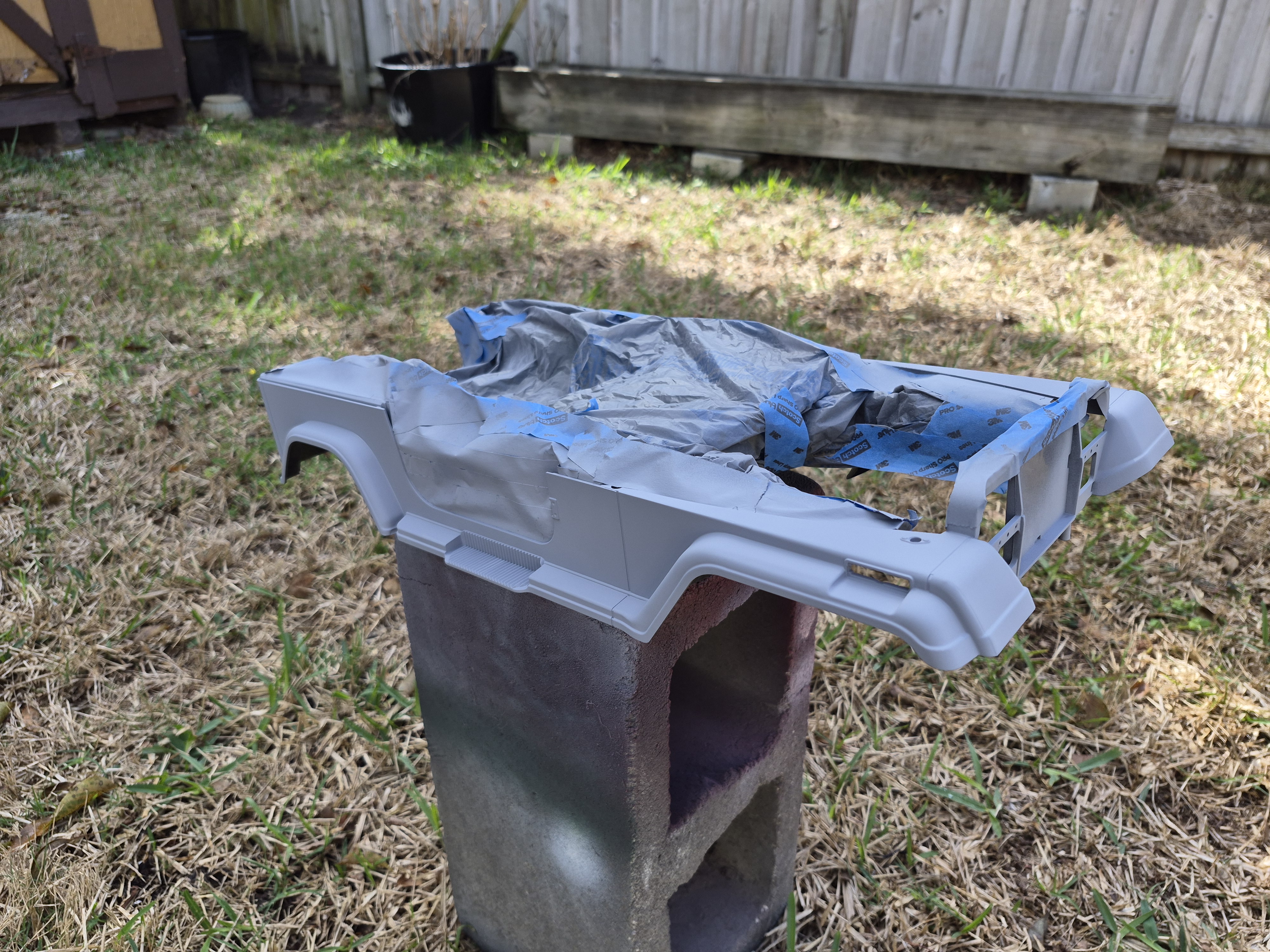

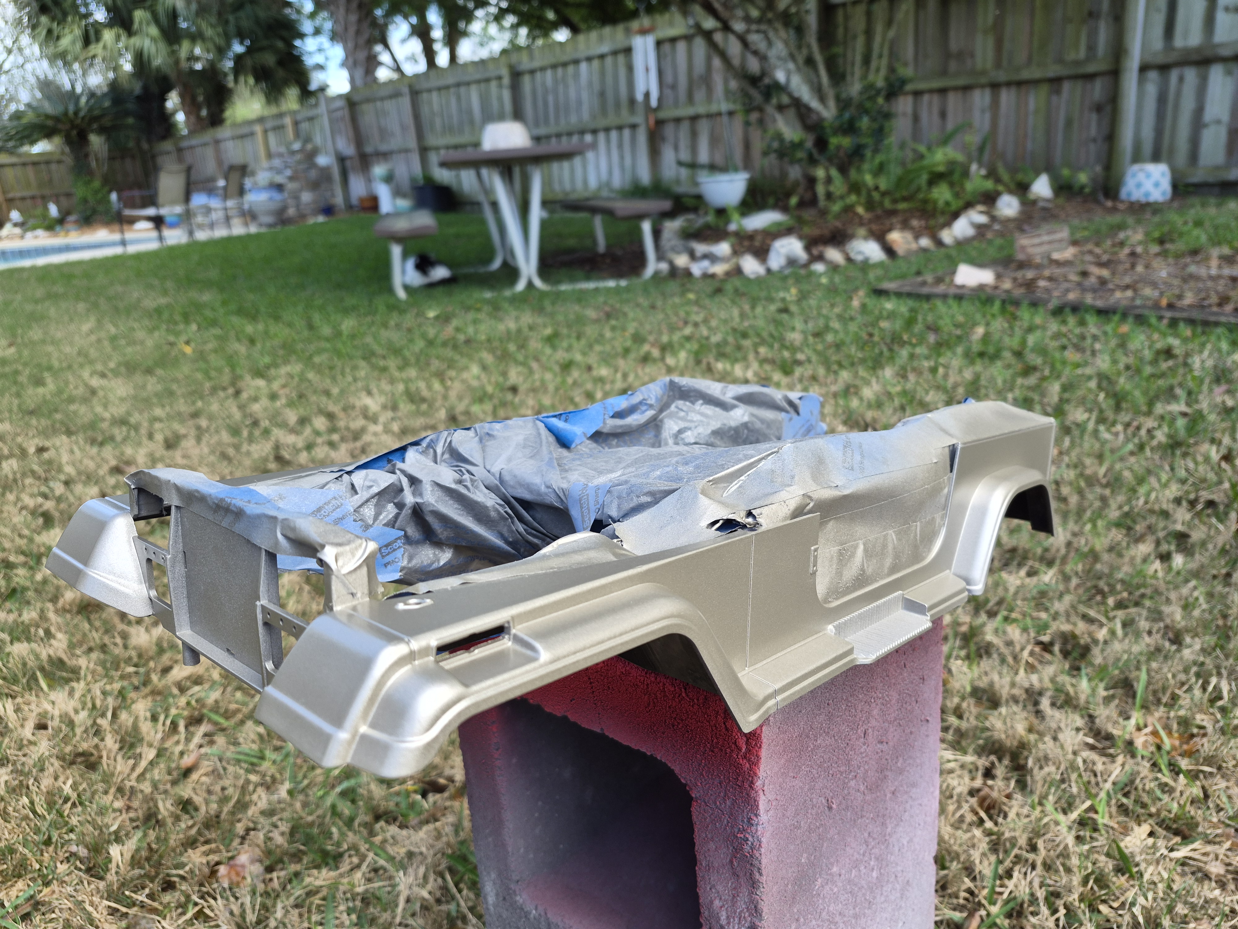

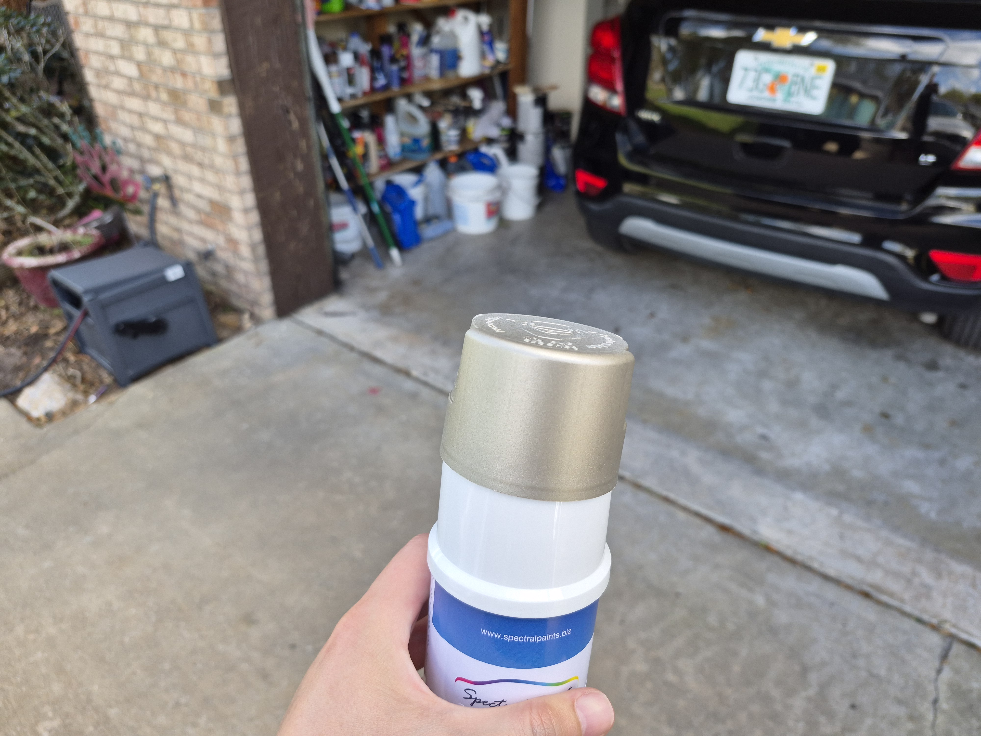

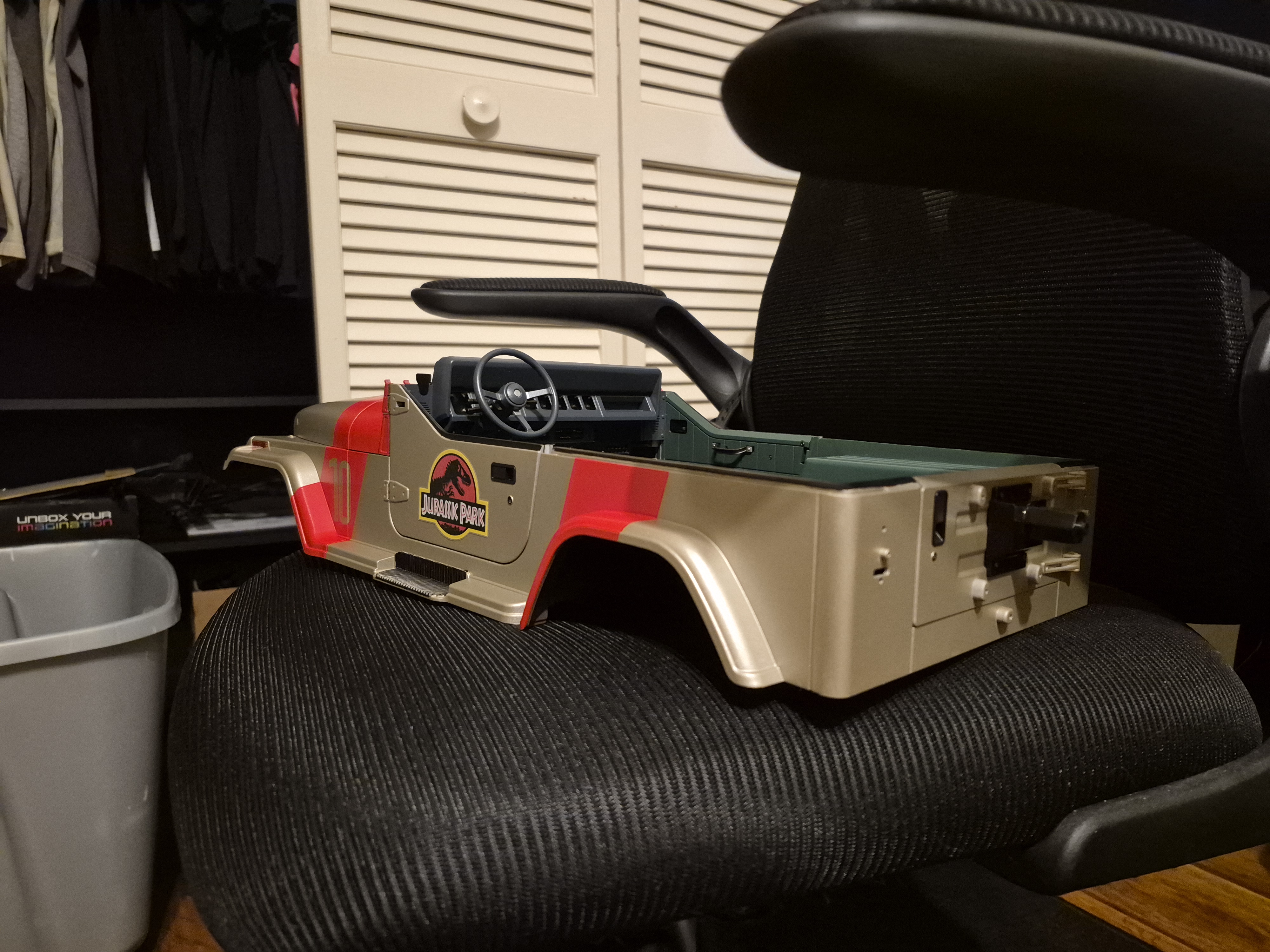

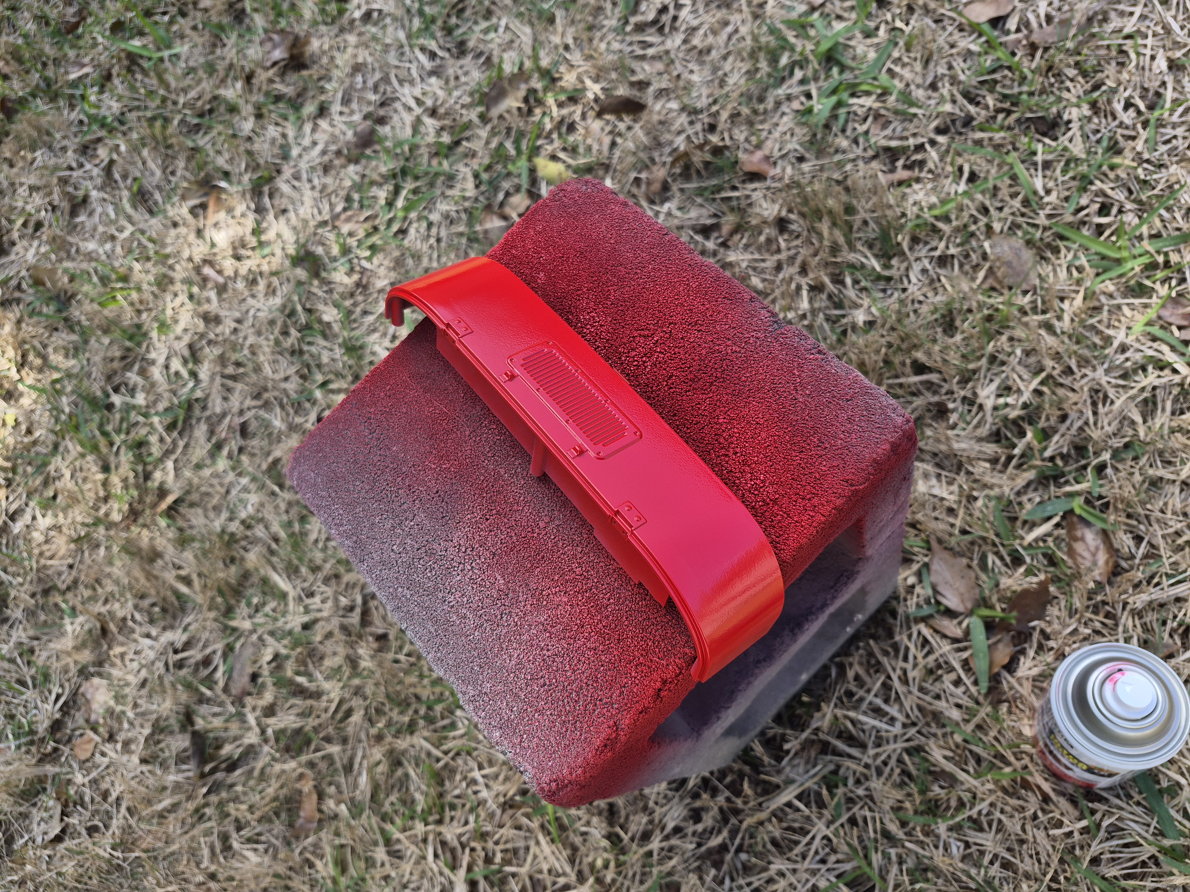

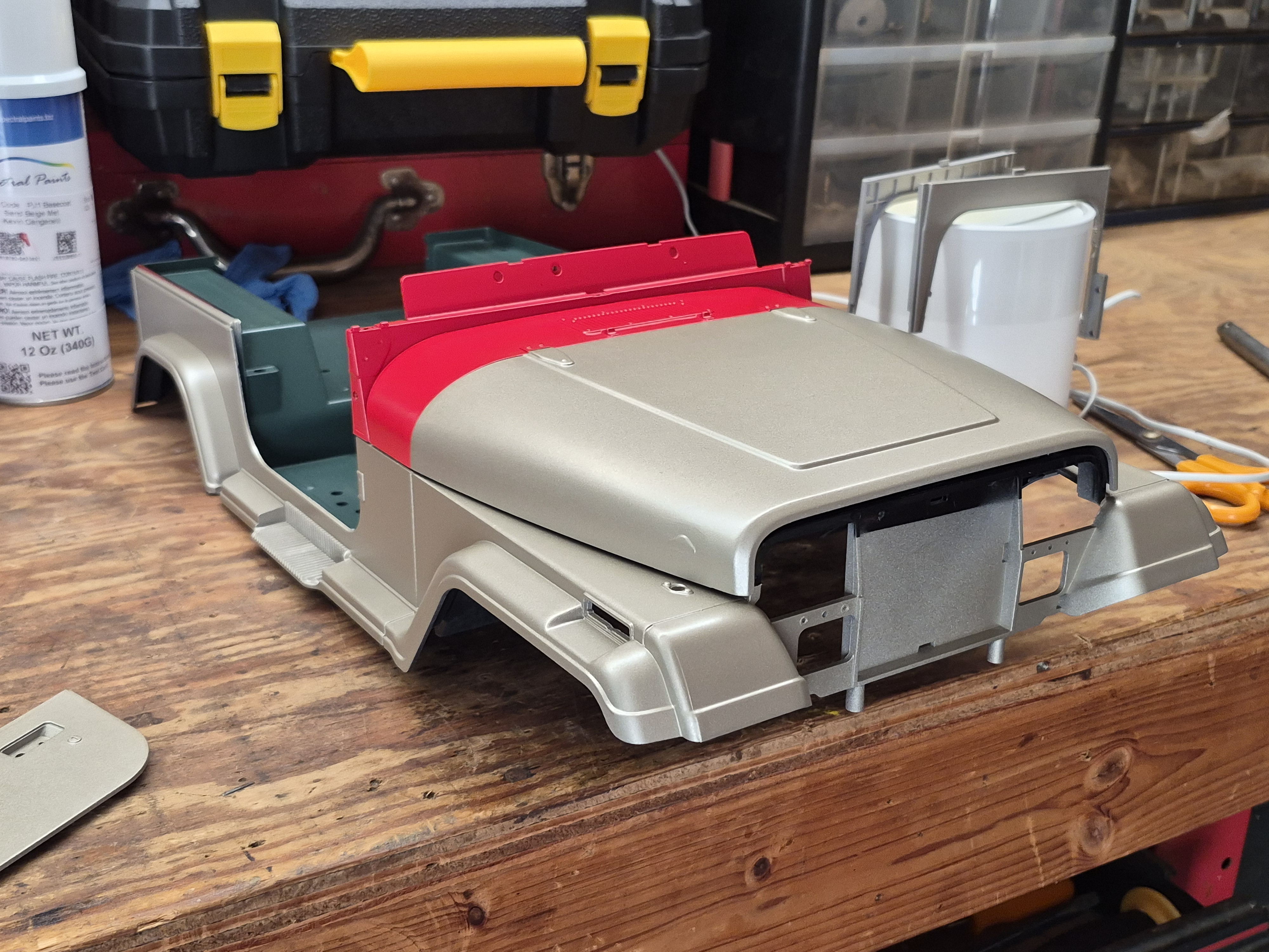

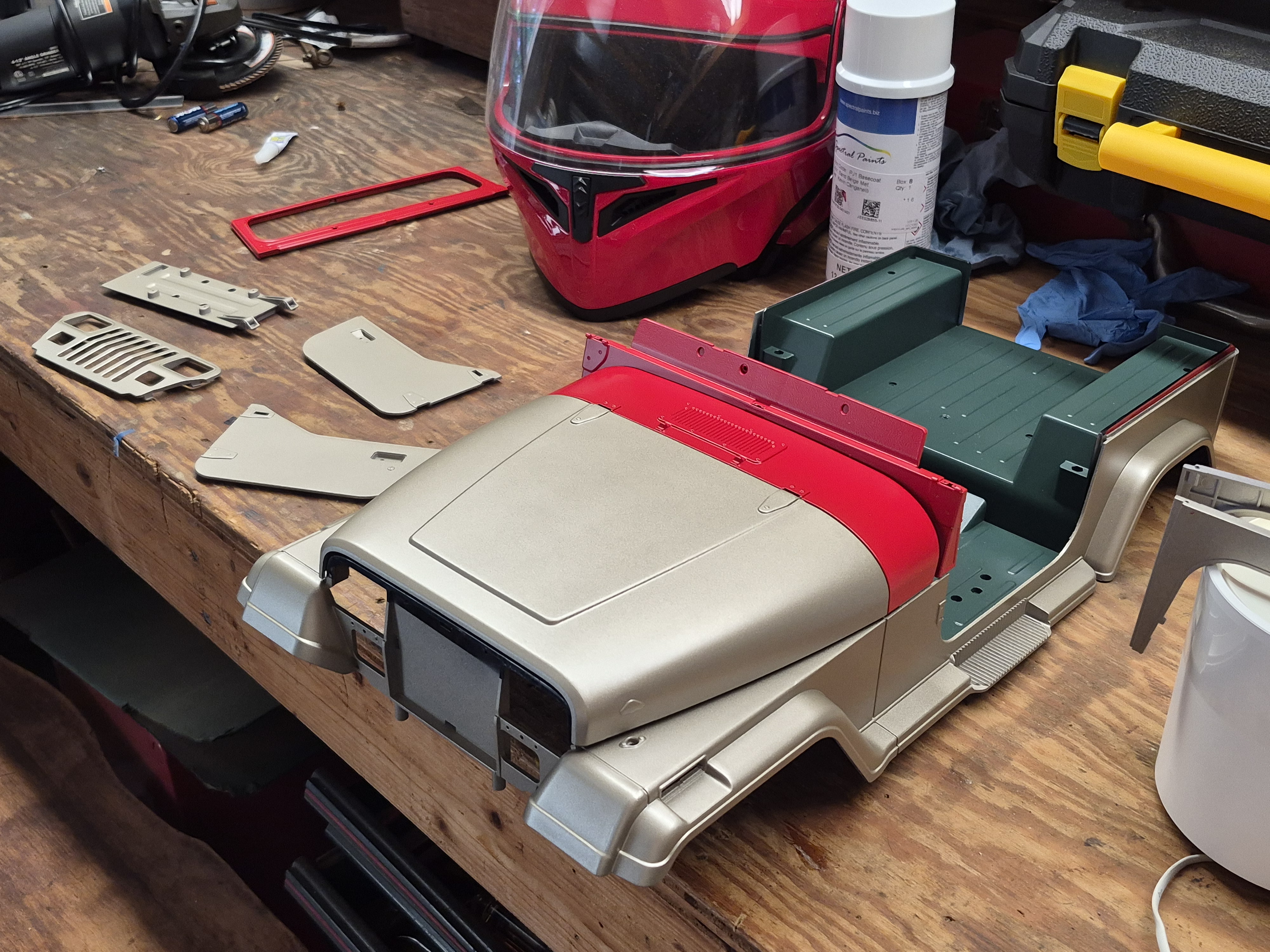

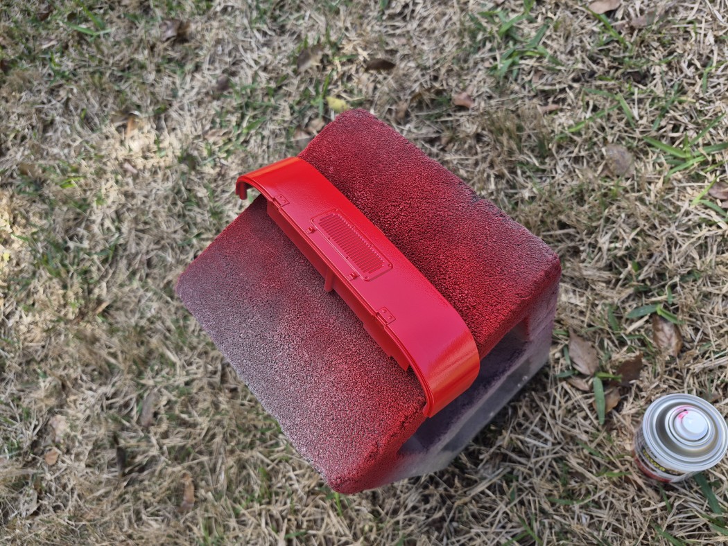

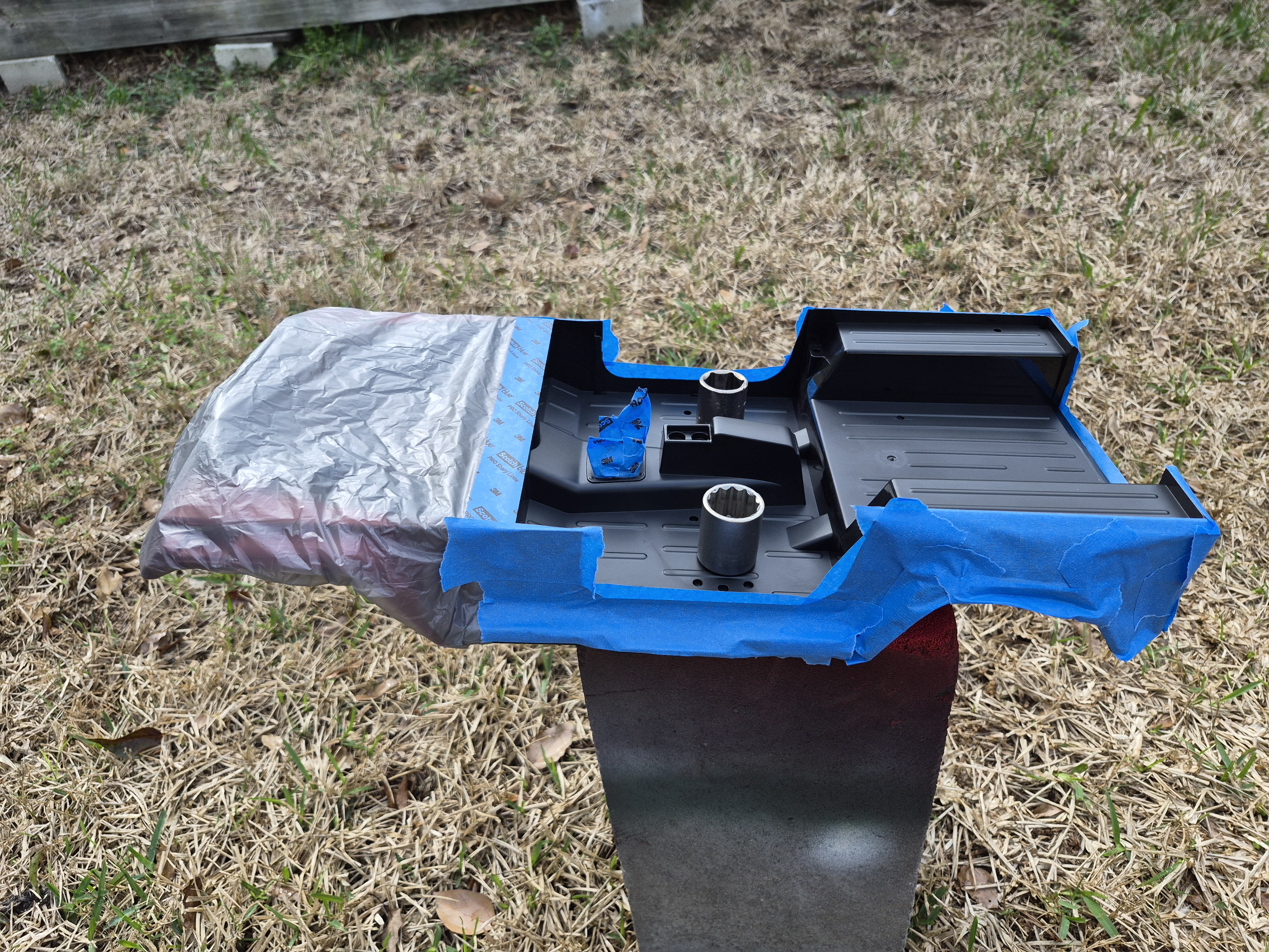

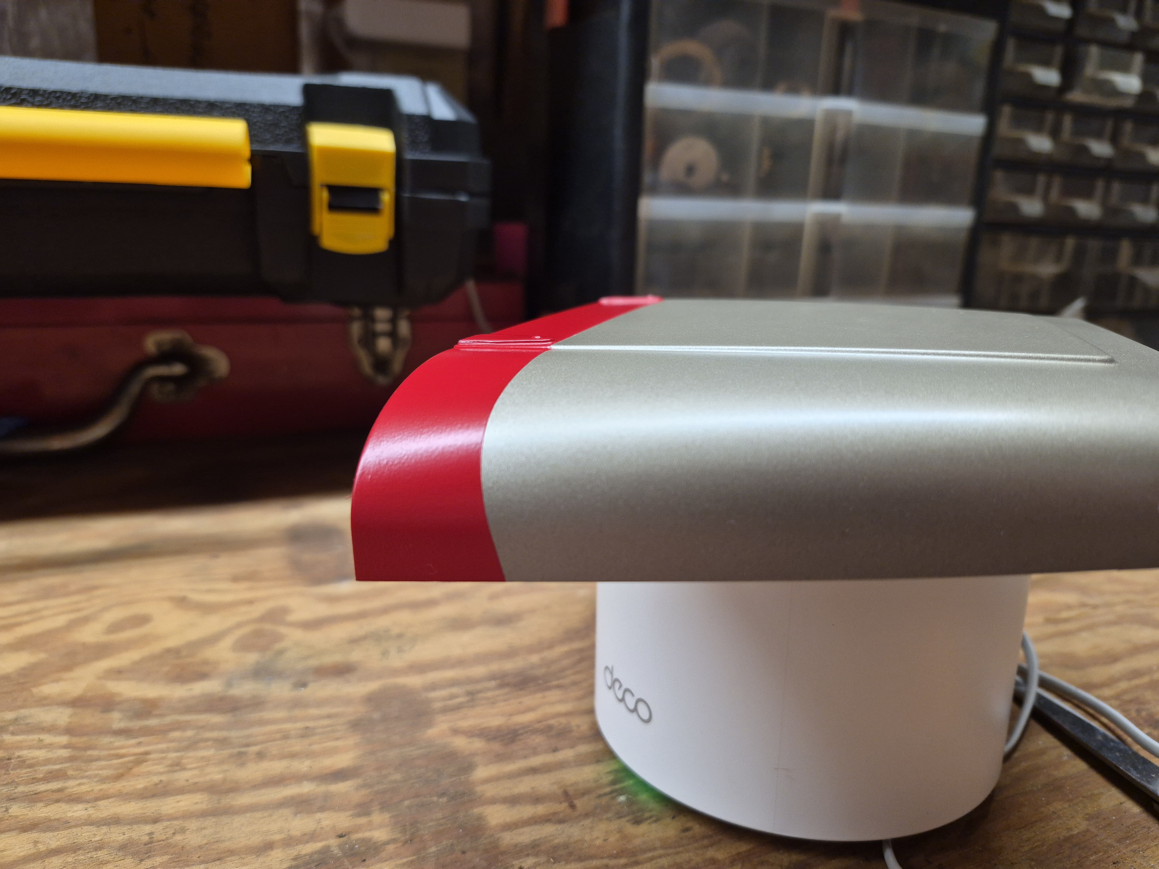

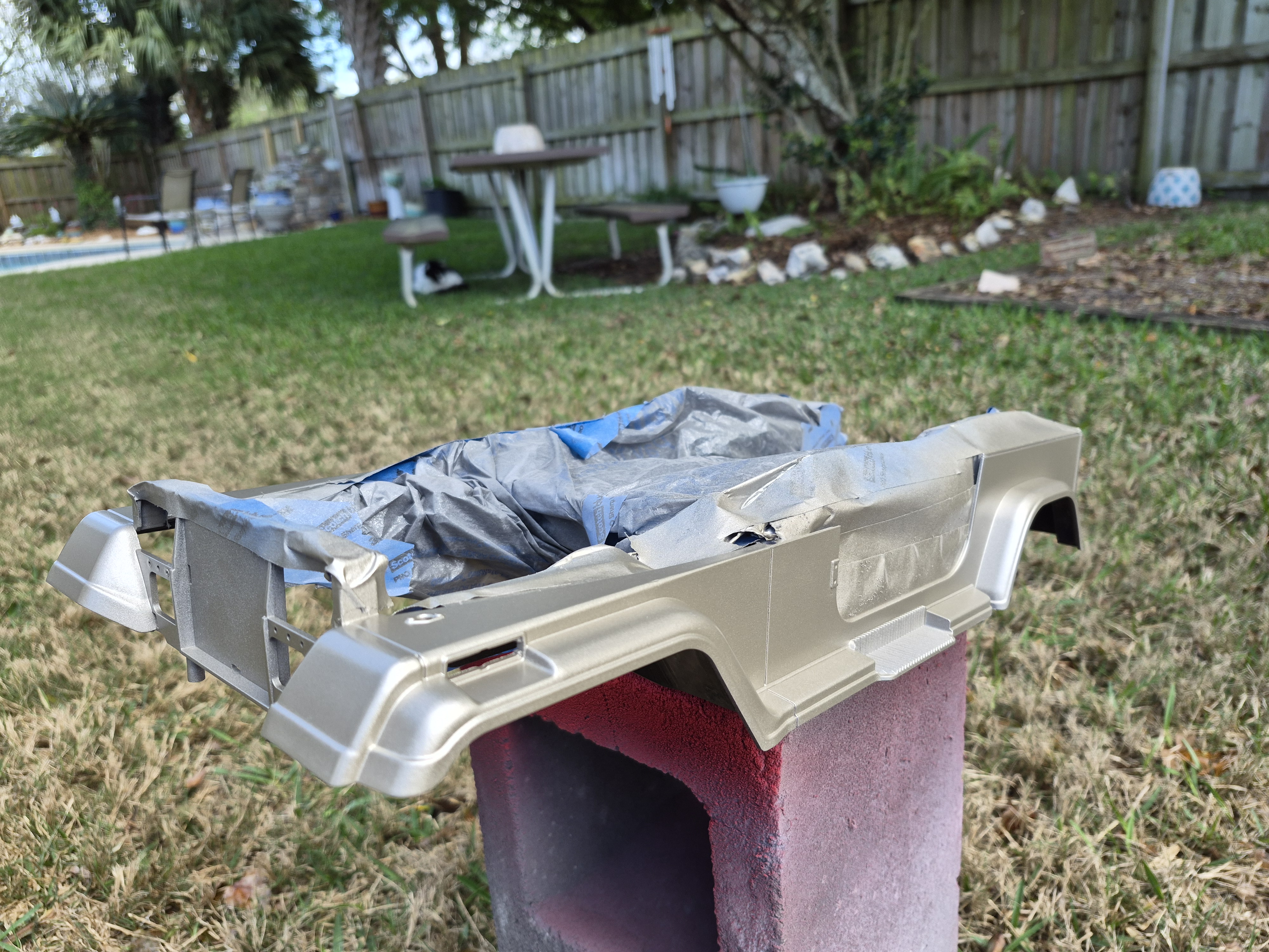

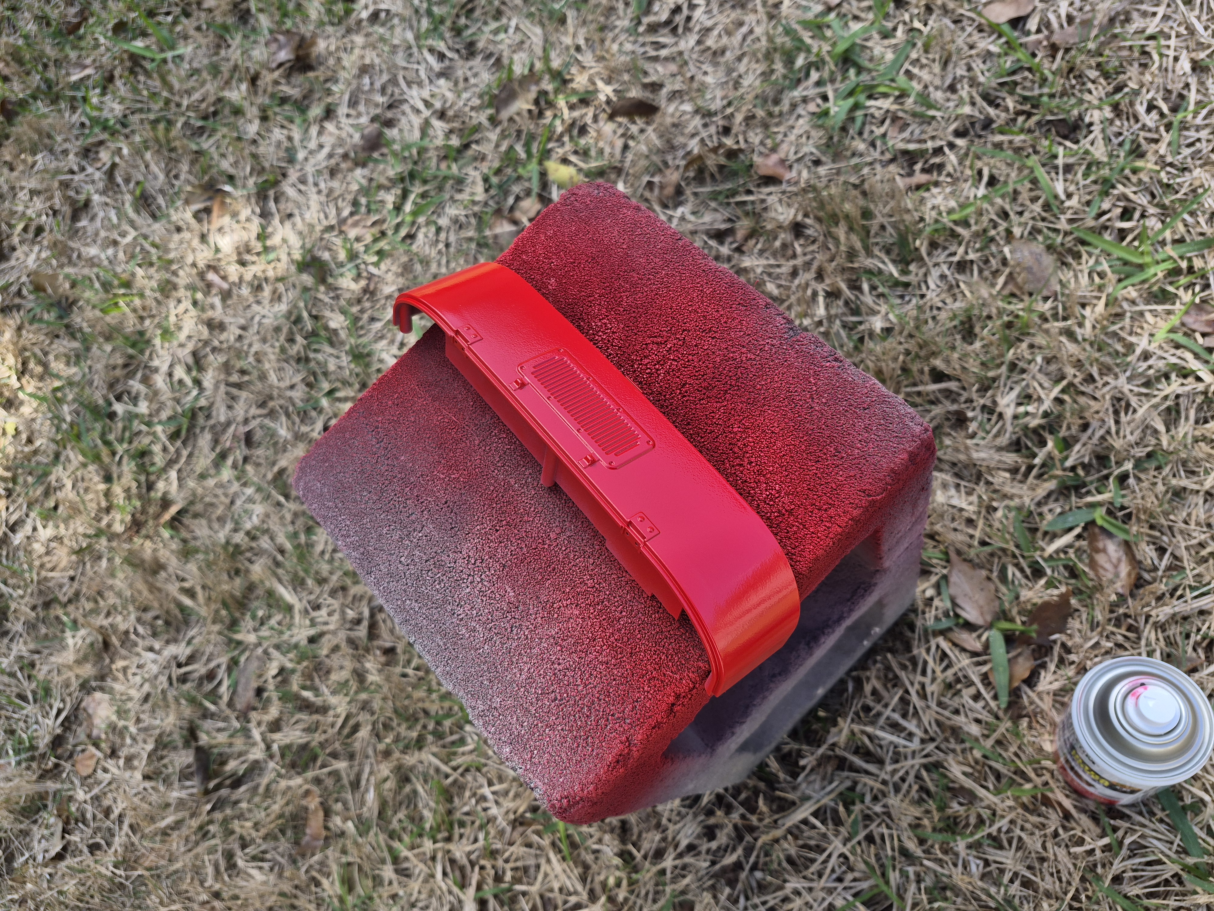

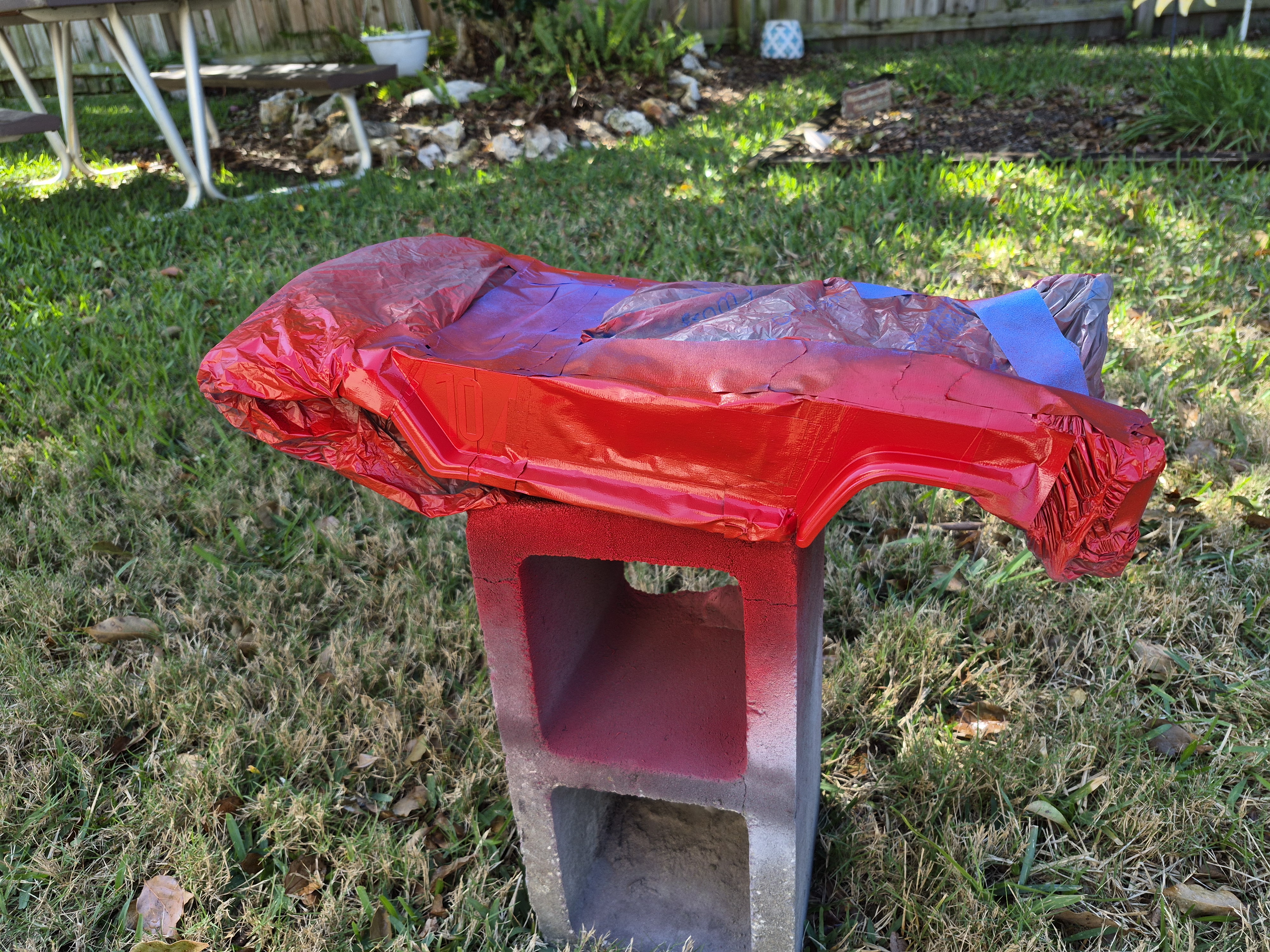

Moving on to painting the base coat and clear coat. For primer, I used a generic Rustoleum automotive primer rattle can and lightly sanded it with 600 grit before and after primer. For the base coat, I couldn't find anything off the shelf that would satisfy me, so I opted to pay the $40 for a single 12oz rattle can of custom mixed PJ1 Sand Beige Metallic by Spectral Paints. Ordered from Amazon. I was extremely nervous about spraying this stuff and really didn't know what to expect. It layed down perfect and looks AMAZING. Then I used Rustoleum semi-gloss clear on top. I decided to go ahead and paint the red section between the hood and dash separately from the stripes since that piece is removable and will make painting the stripes easier later on.

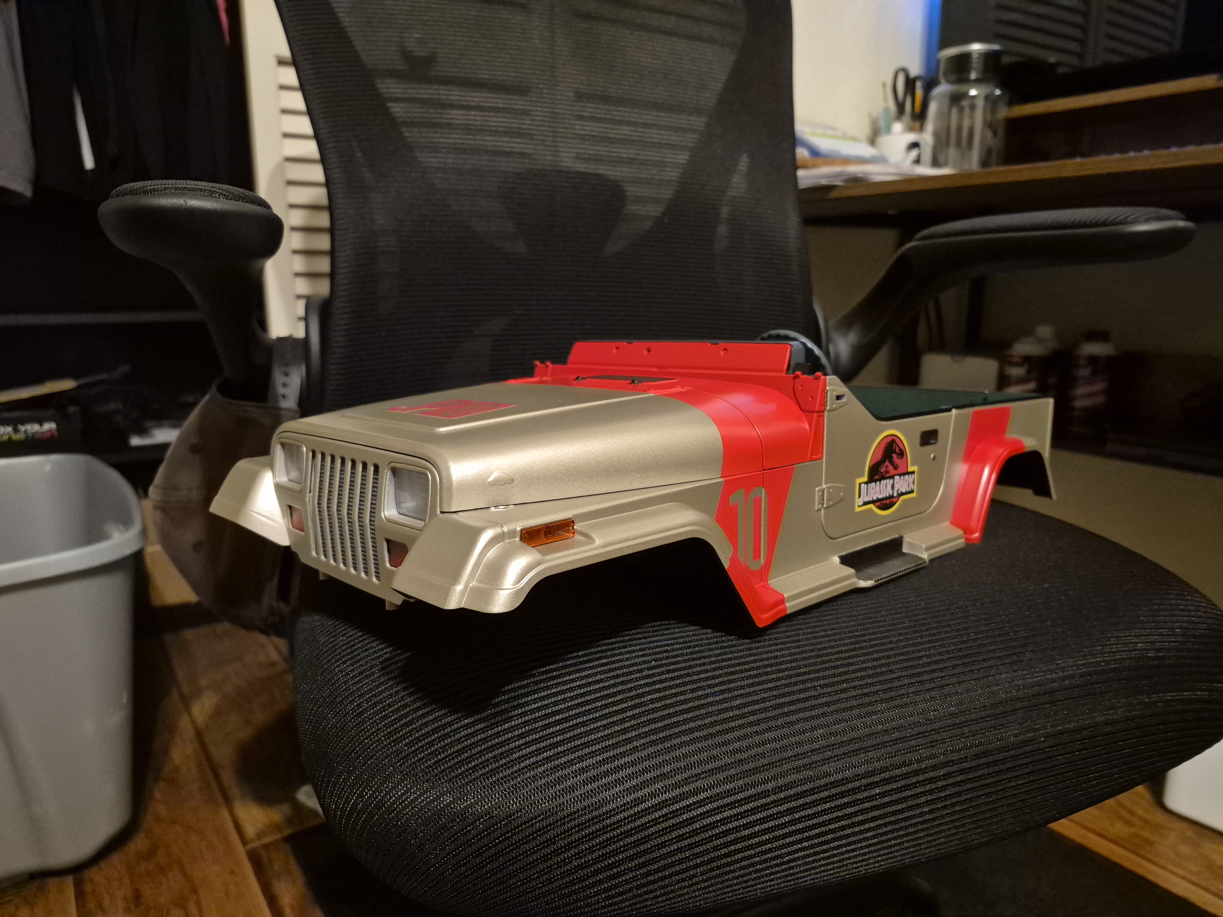

Post by Back-Engineered » March 26th, 2026, 12:45 am

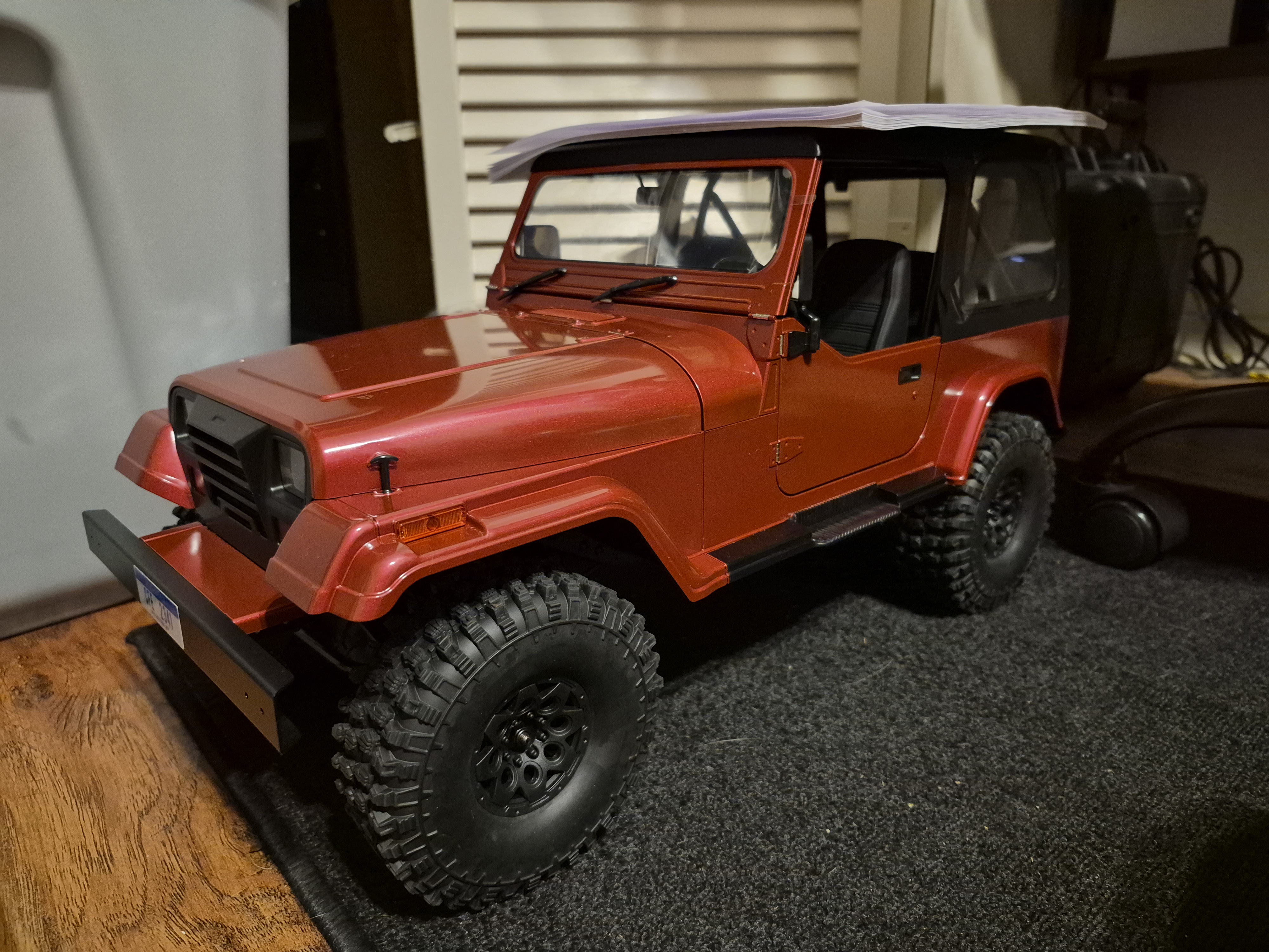

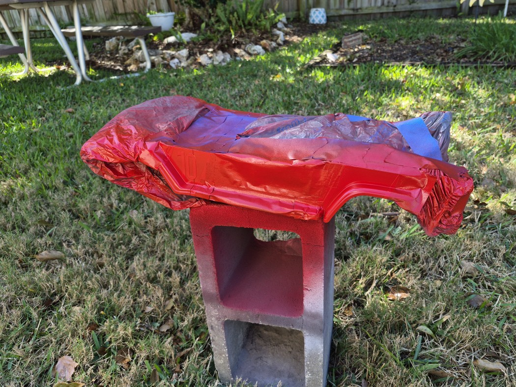

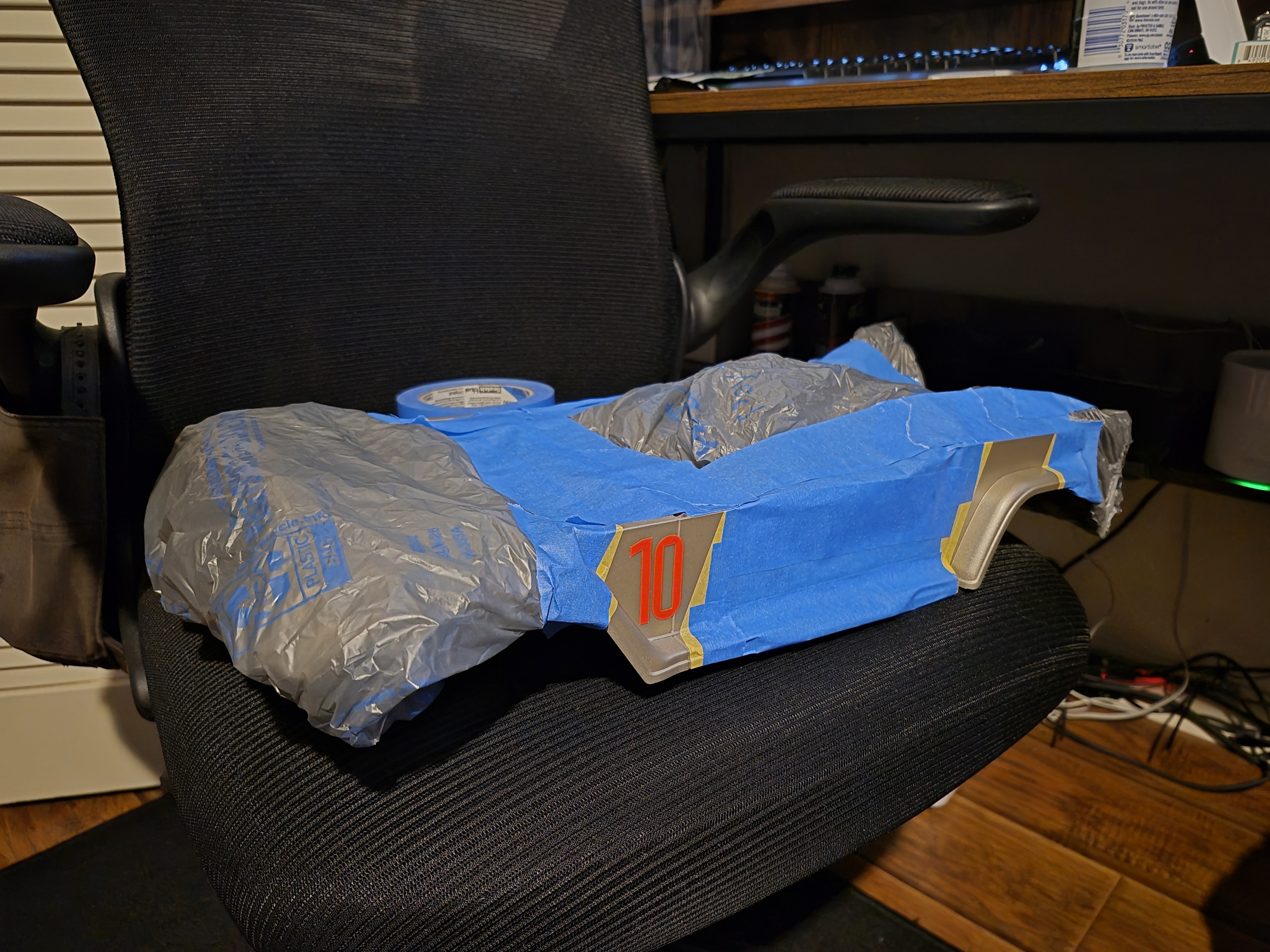

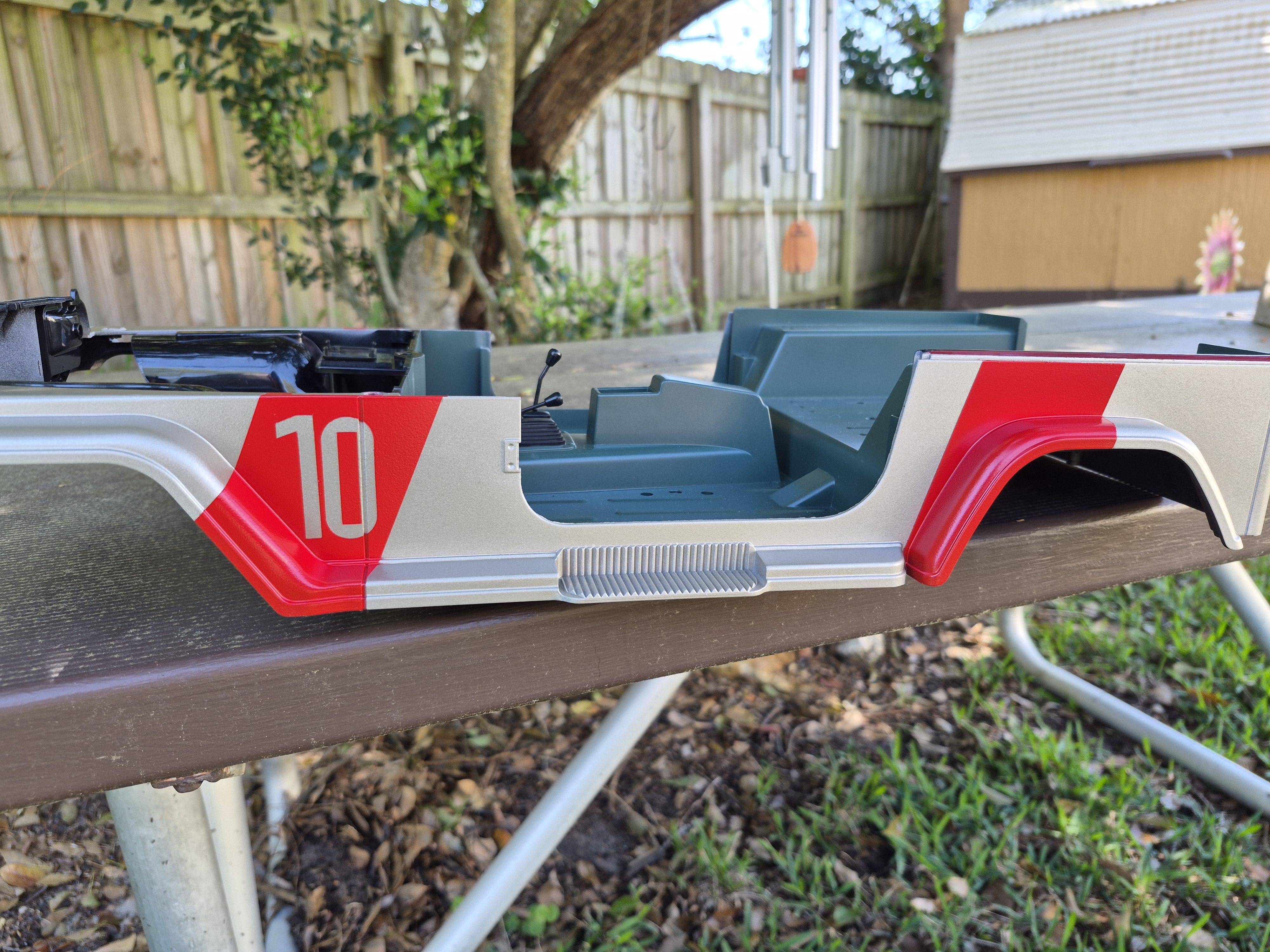

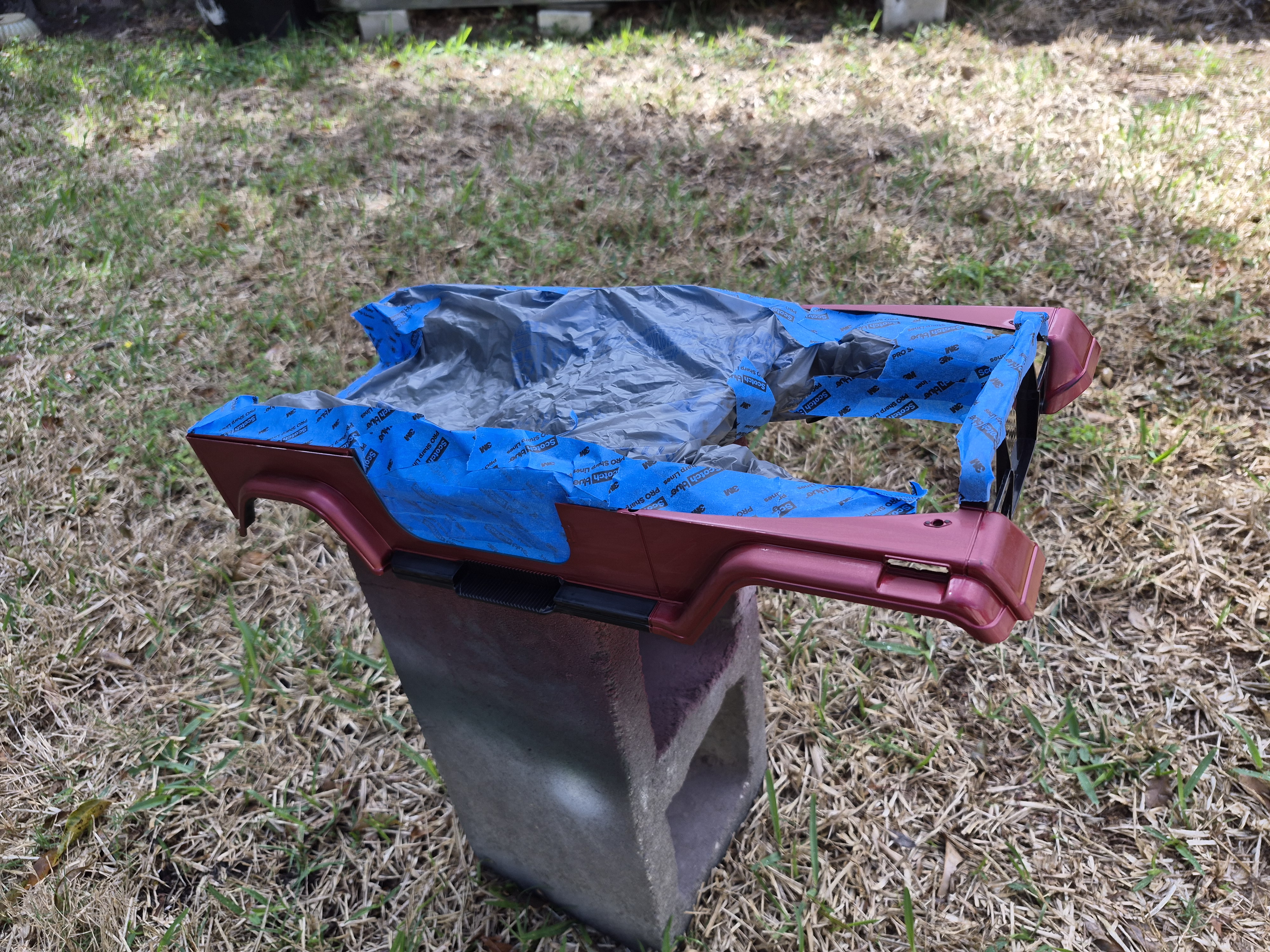

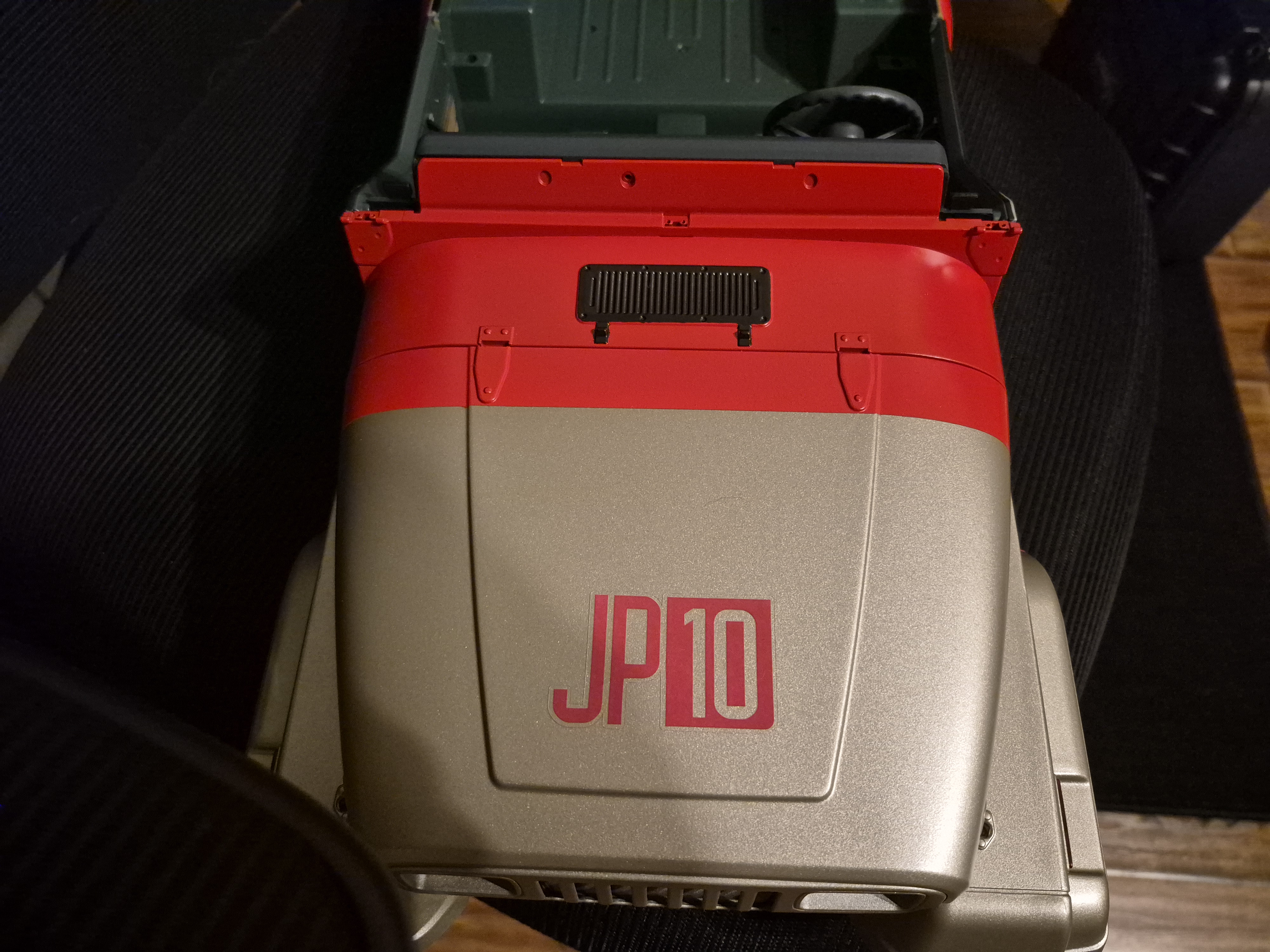

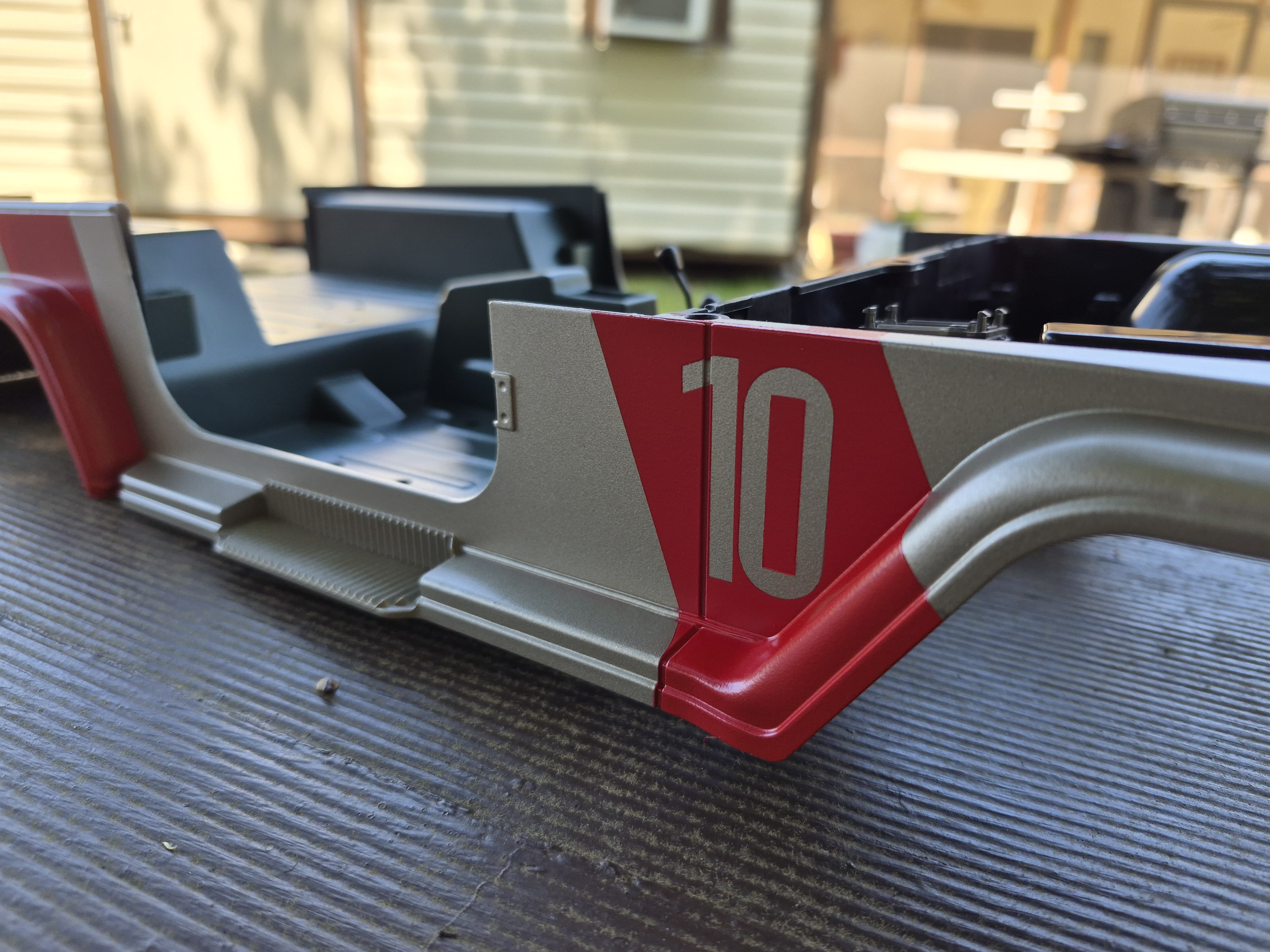

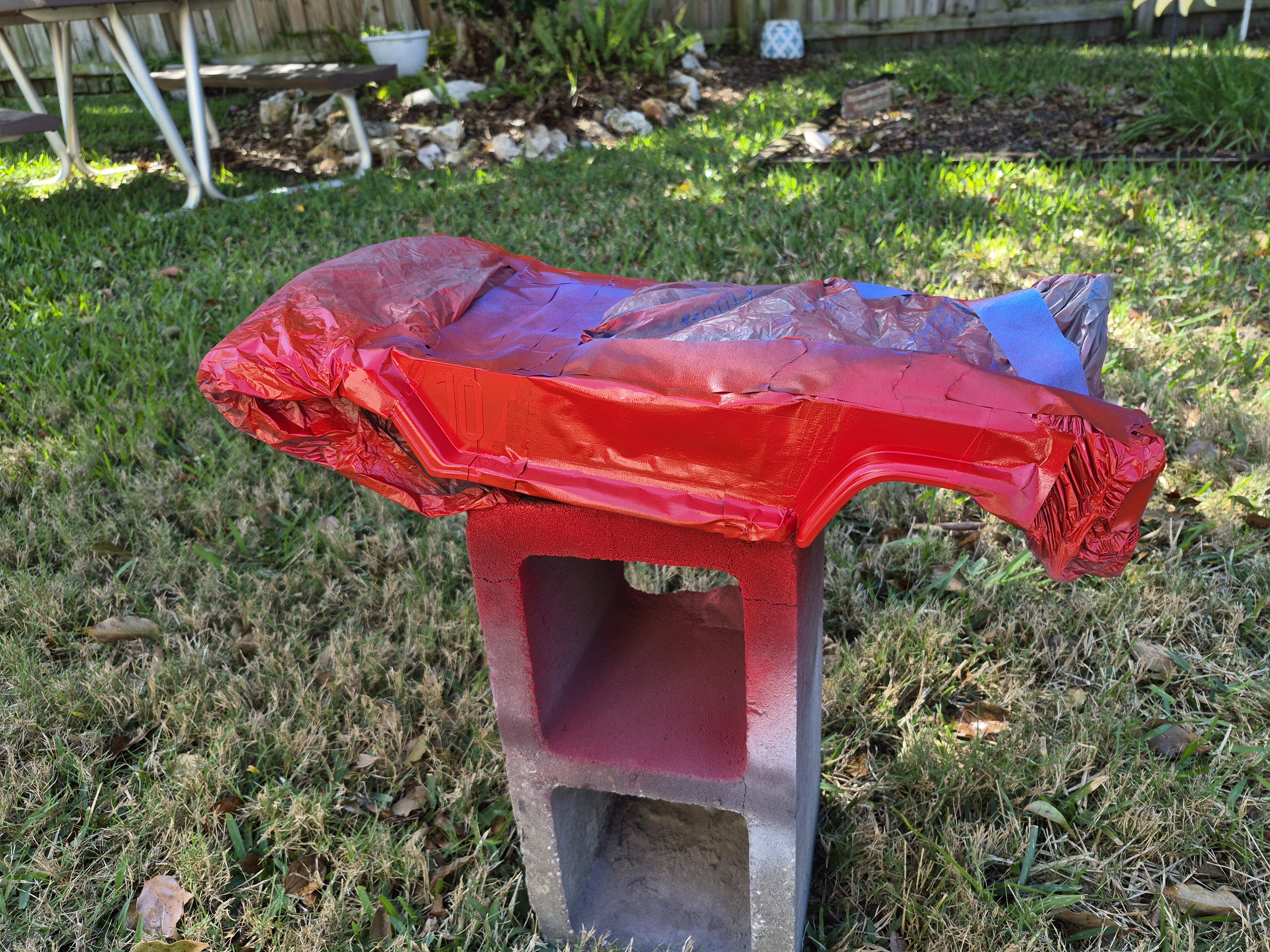

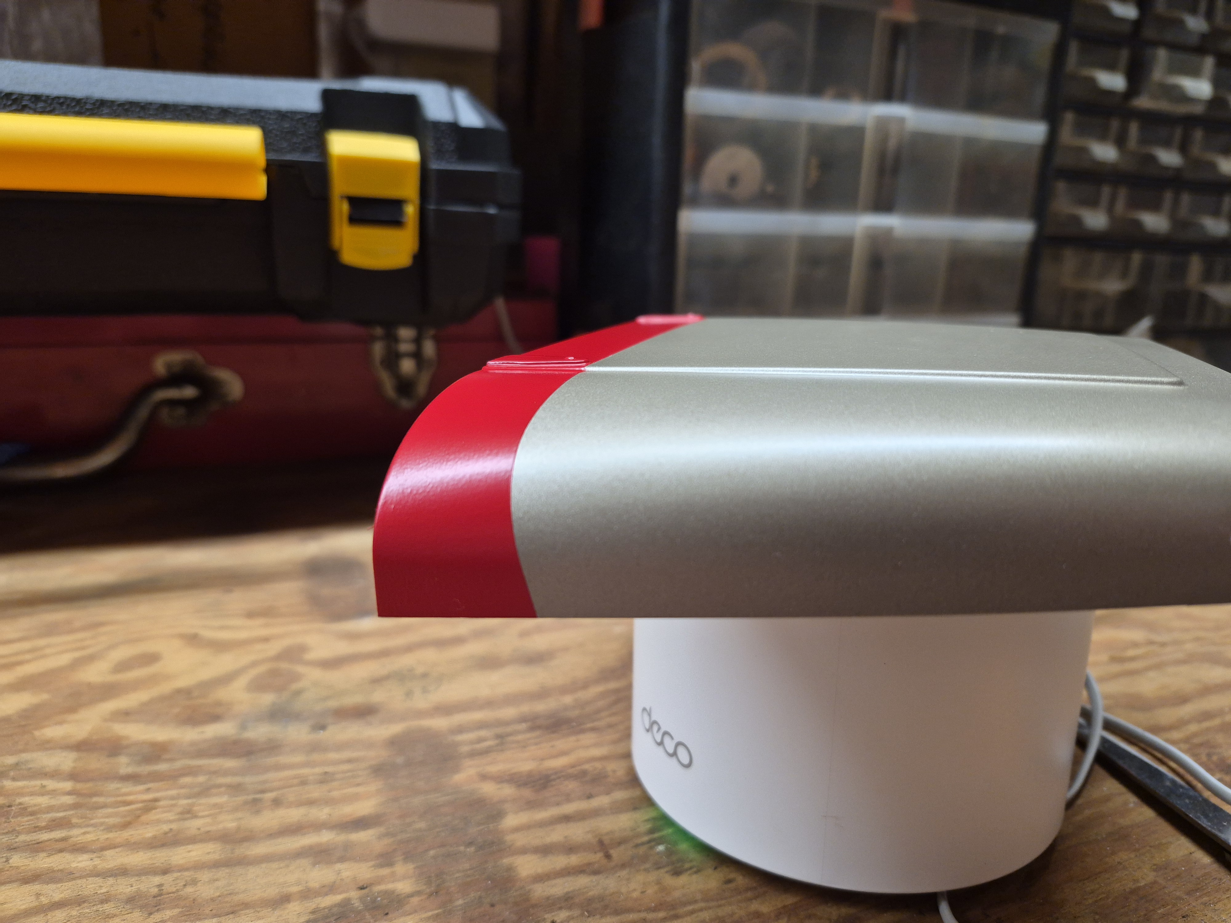

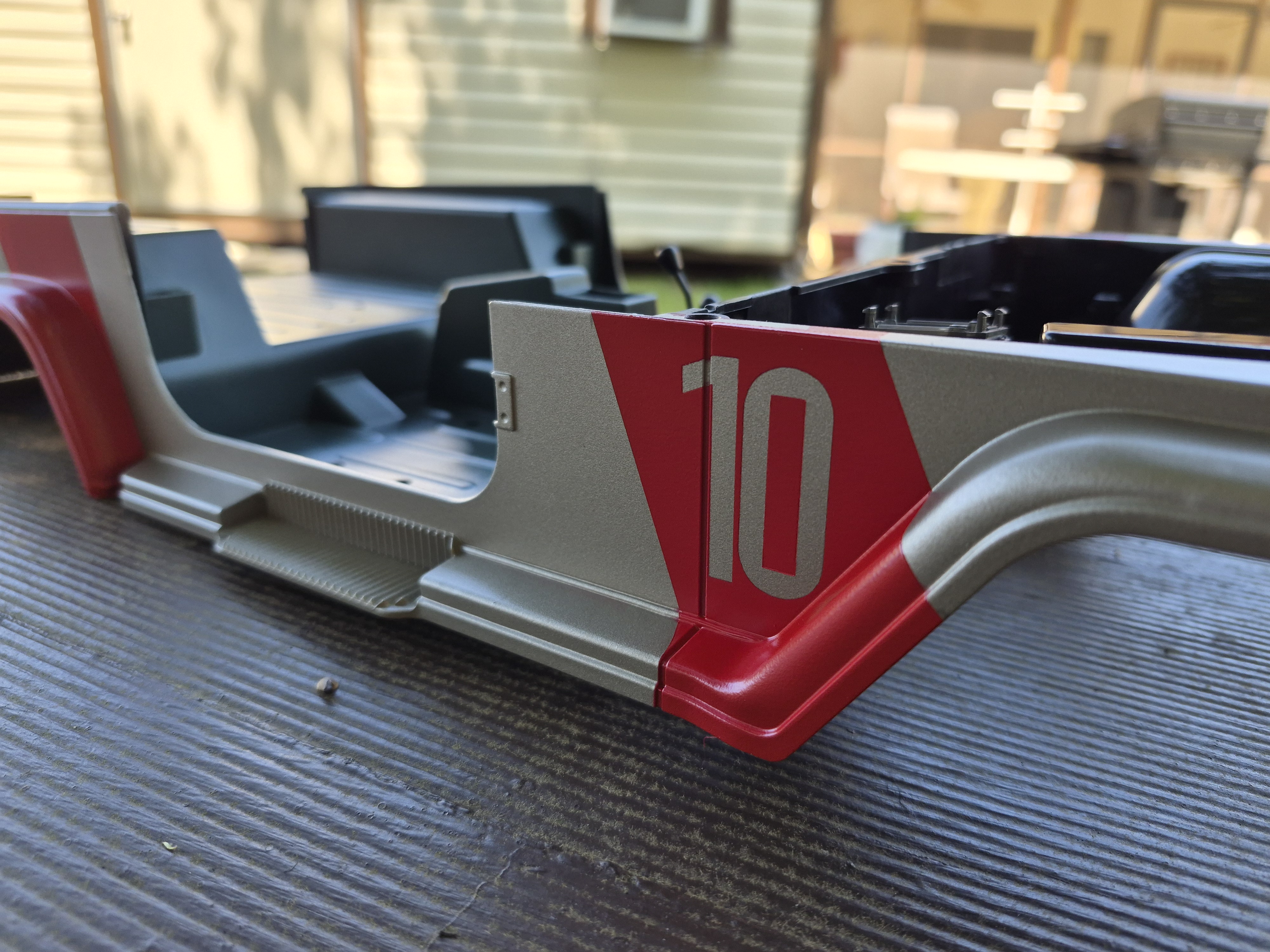

Now for stripes and decals. The decals for the doors and hood were ordered from an Ebay seller based in the UK. While they're extremely good quality, the scale isn't quite right. The door decals are too large and the hood decal is too small. These are things I can change later. For the #10 on the side, I used decals as a stencil from a jurassic decal sheet purchased from FairRC, so the #10 is permanent on the sides. The stripes were an absolute PITA to tape up correctly. It took me racking my brain for hours going back and forth between reference photos and retaping many times. The dimensions of the fender flares aren't quite accurate, so the number 10s aren't placed exactly like they were in the film. Close enough! Once I felt all was right, I taped off the rest of the truck and crossed my fingers. The end result was flawless! After that, I went ahead and used my paint pens to paint all the black trim, side steps and headlight buckets silver. The Jeep is starting to look so good!

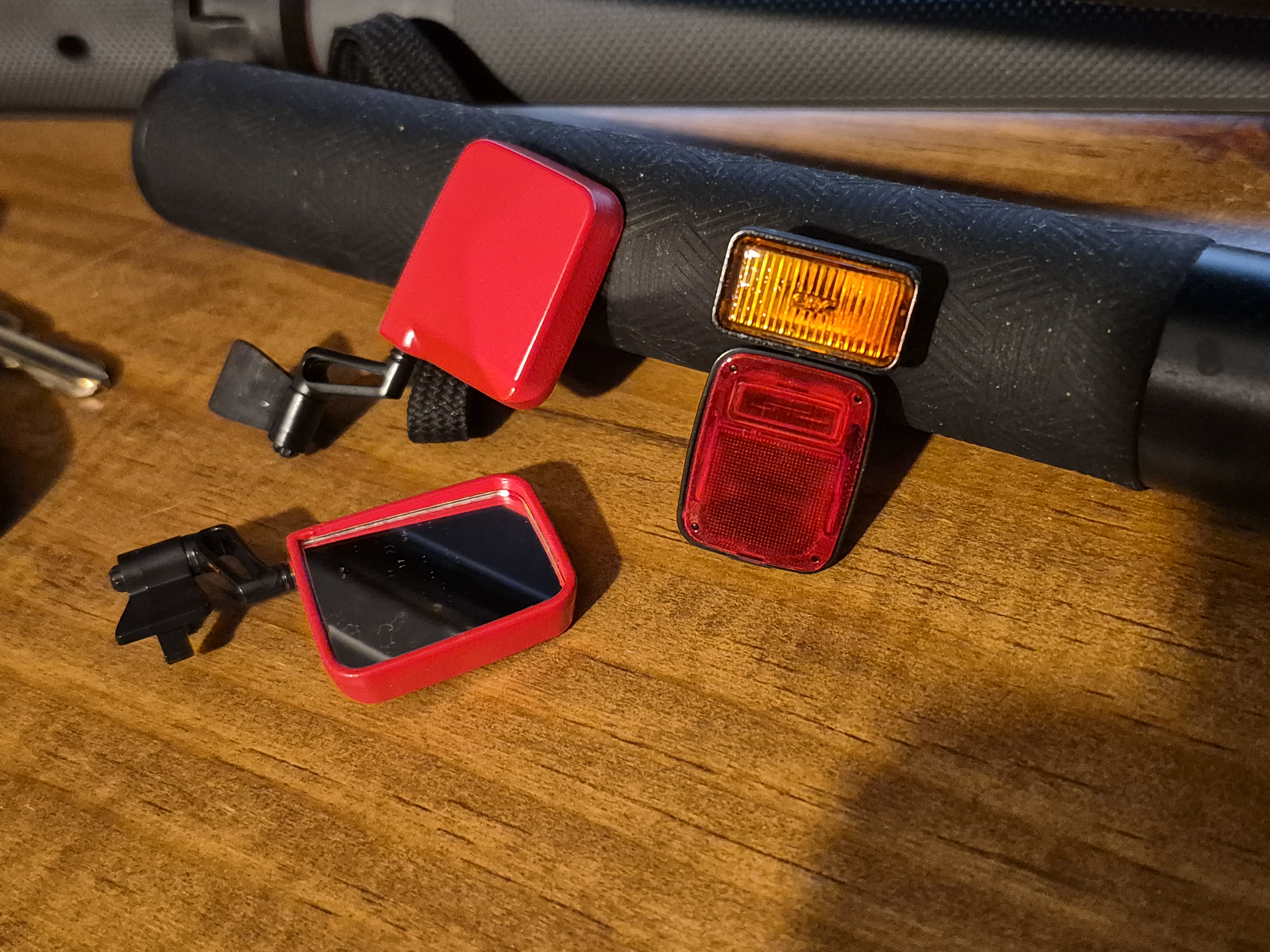

Post by Back-Engineered » March 26th, 2026, 12:51 am

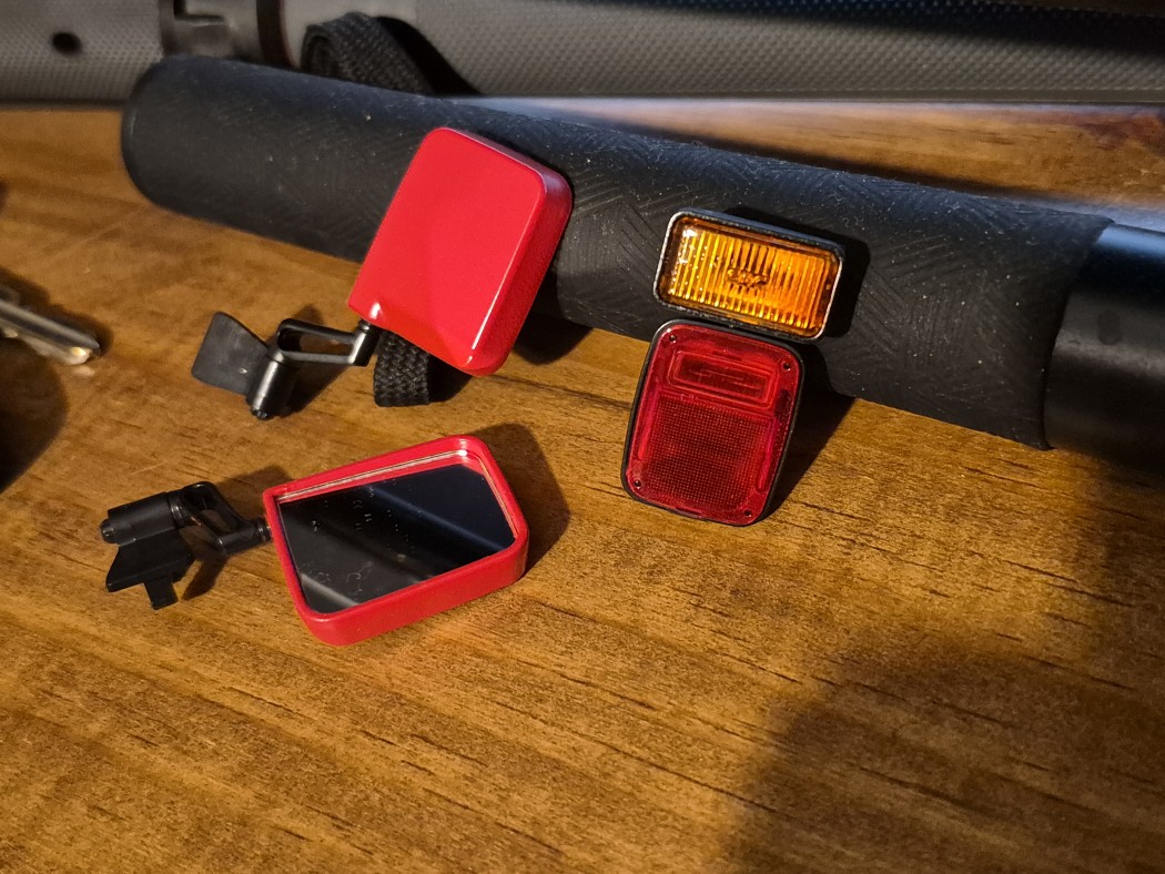

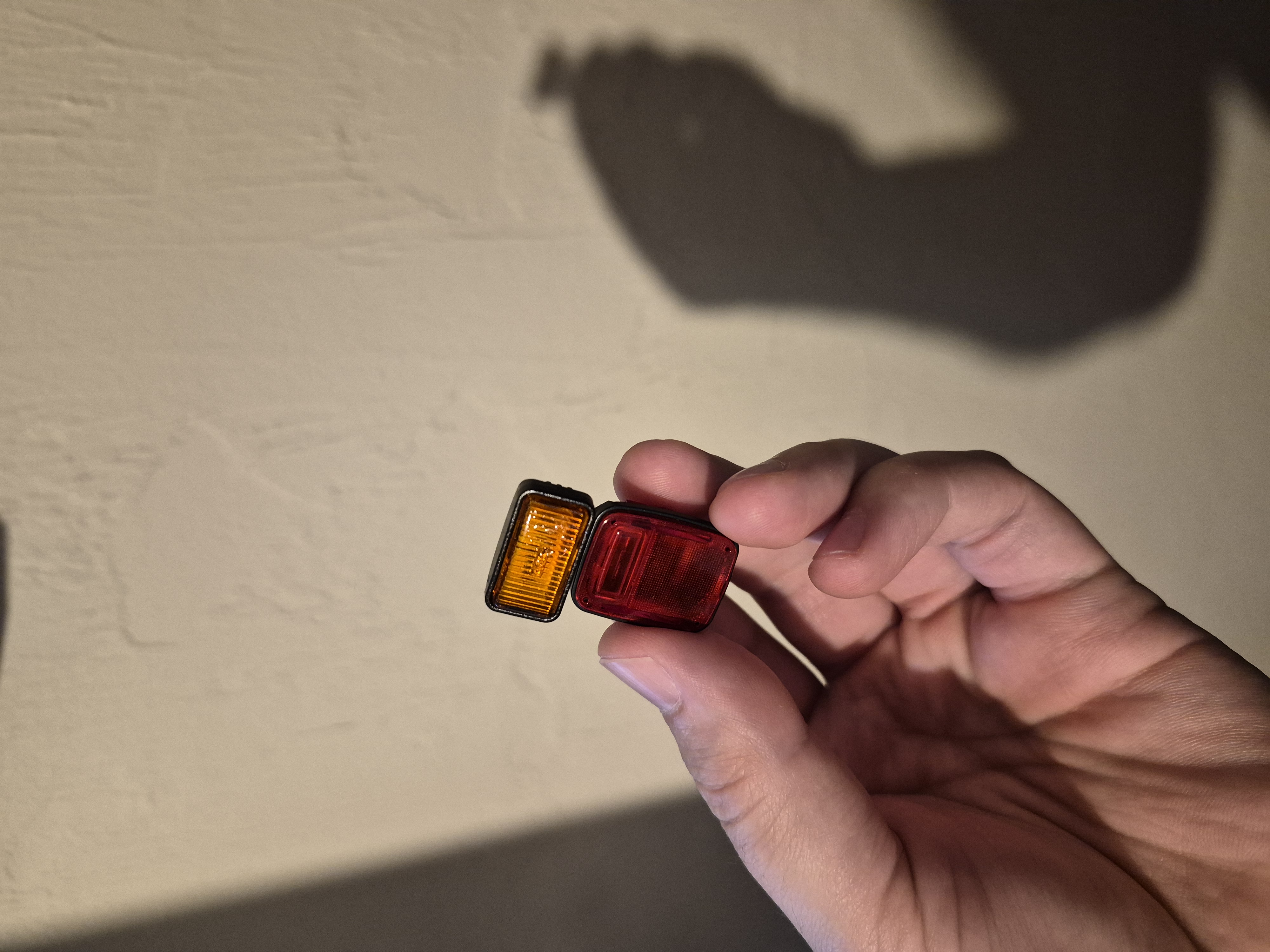

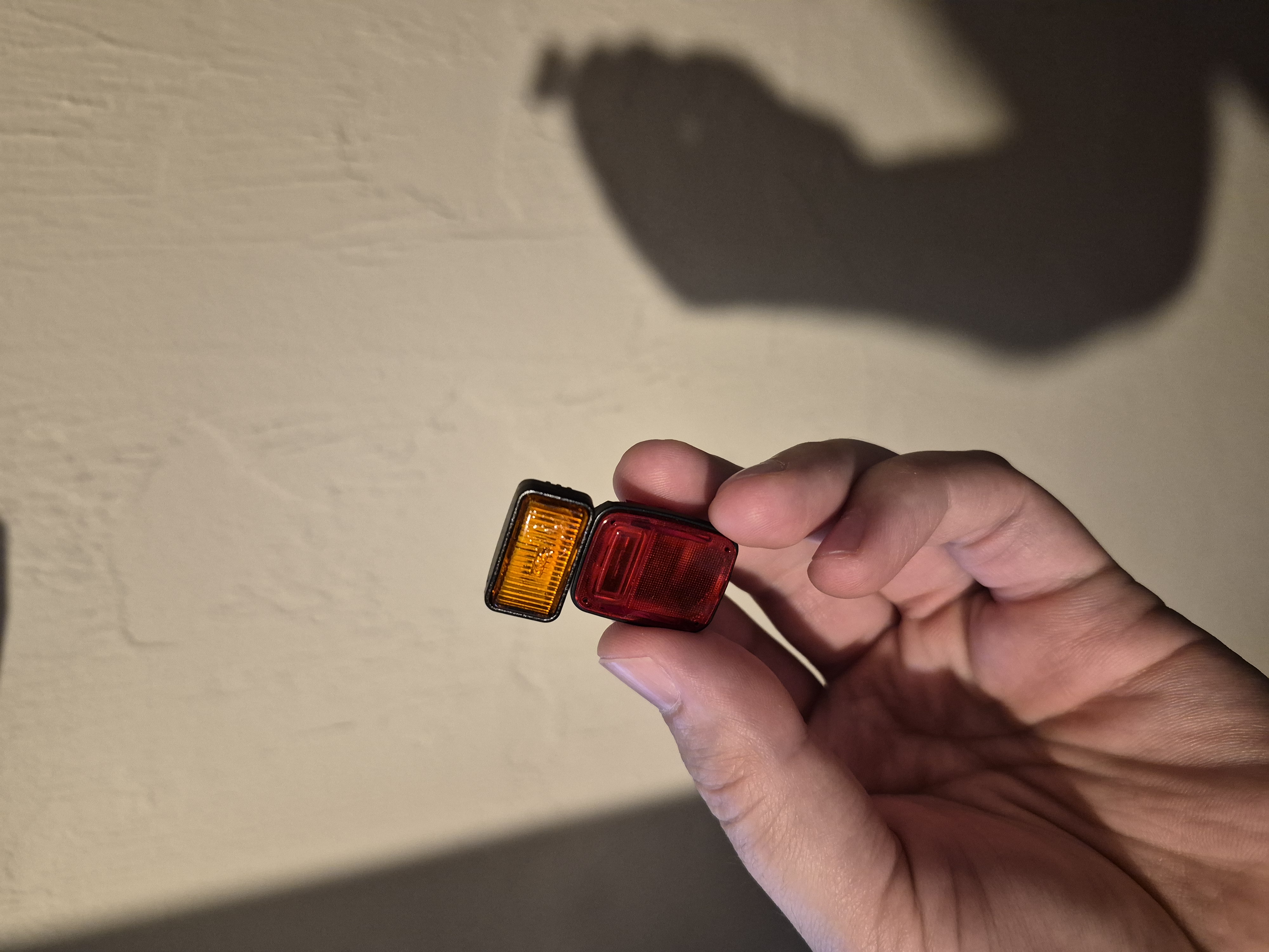

Got the mirrors painted and rear fog lights mounted to the taillights. The rear fogs are from Amazon. 20mm rectangular RC fog lights. The lens trim was chrome, so I had to paint them black. Up next will be sorting all the LEDs for the truck.
