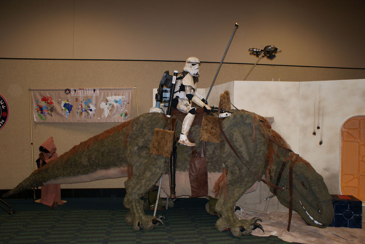

An old thread, but I noticed that I never posted a photo of the completed costume/prop as requested. (I had been absent quite awhile as I had trouble logging in). Here it is, at least the original Star Wars version. It is a functional two person costume, and when walking the tail sways realistically and leg movement goes to the top of the shoulders as the human feet fit into the creature's feet. The mouth opens (with teeth and tongue) and the head turns and raises. This costume won the "Best of Show" at Star Wars Celebration VI in Orlando and since then has appeared at many conventions.

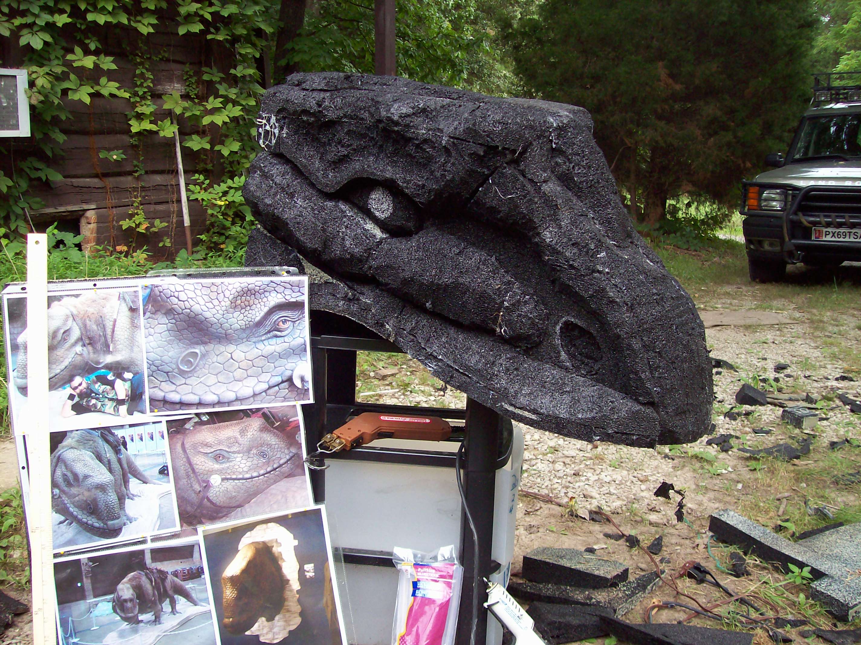

The next phase which I have begun is sculpting a matching Triceratops head which can be swapped out for display with the Jurassic Jeep, which I want to have completed for the Cincinatti Comic Con this Summer in conjunction with the JP Jeep and Park Gate I am just finishing now.
