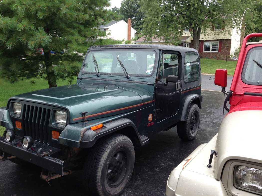

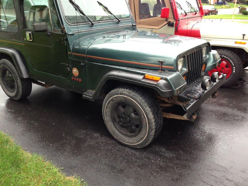

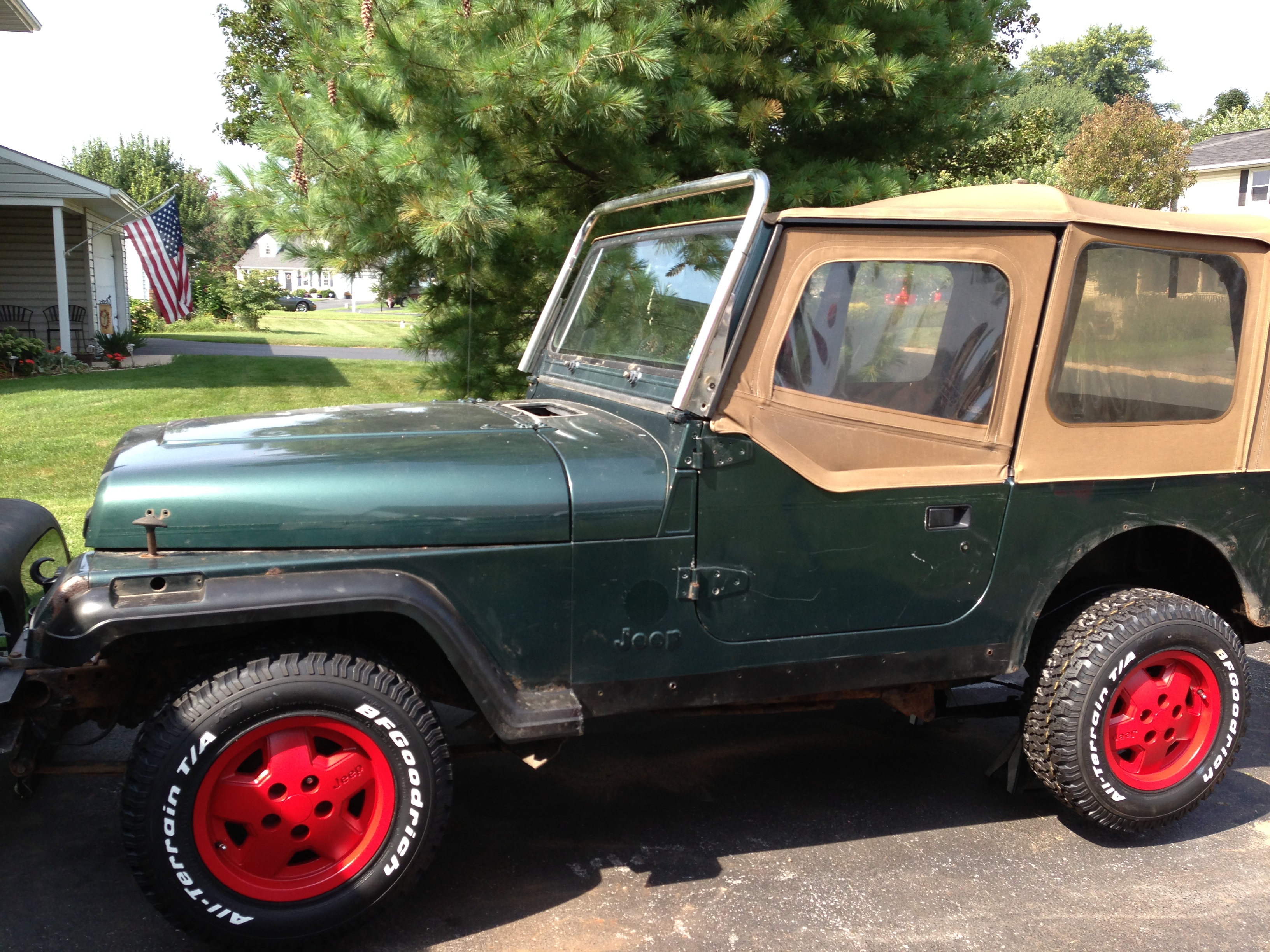

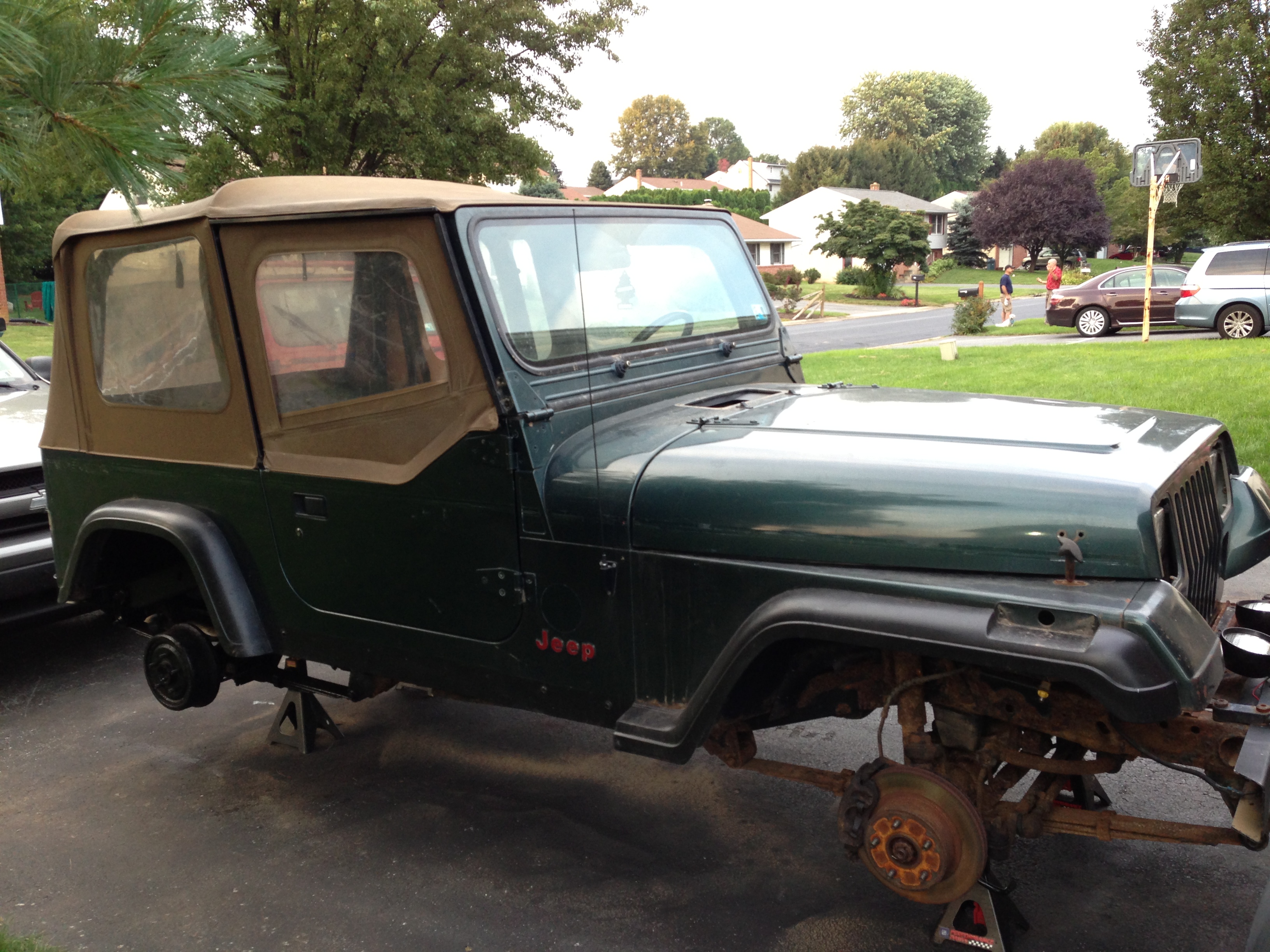

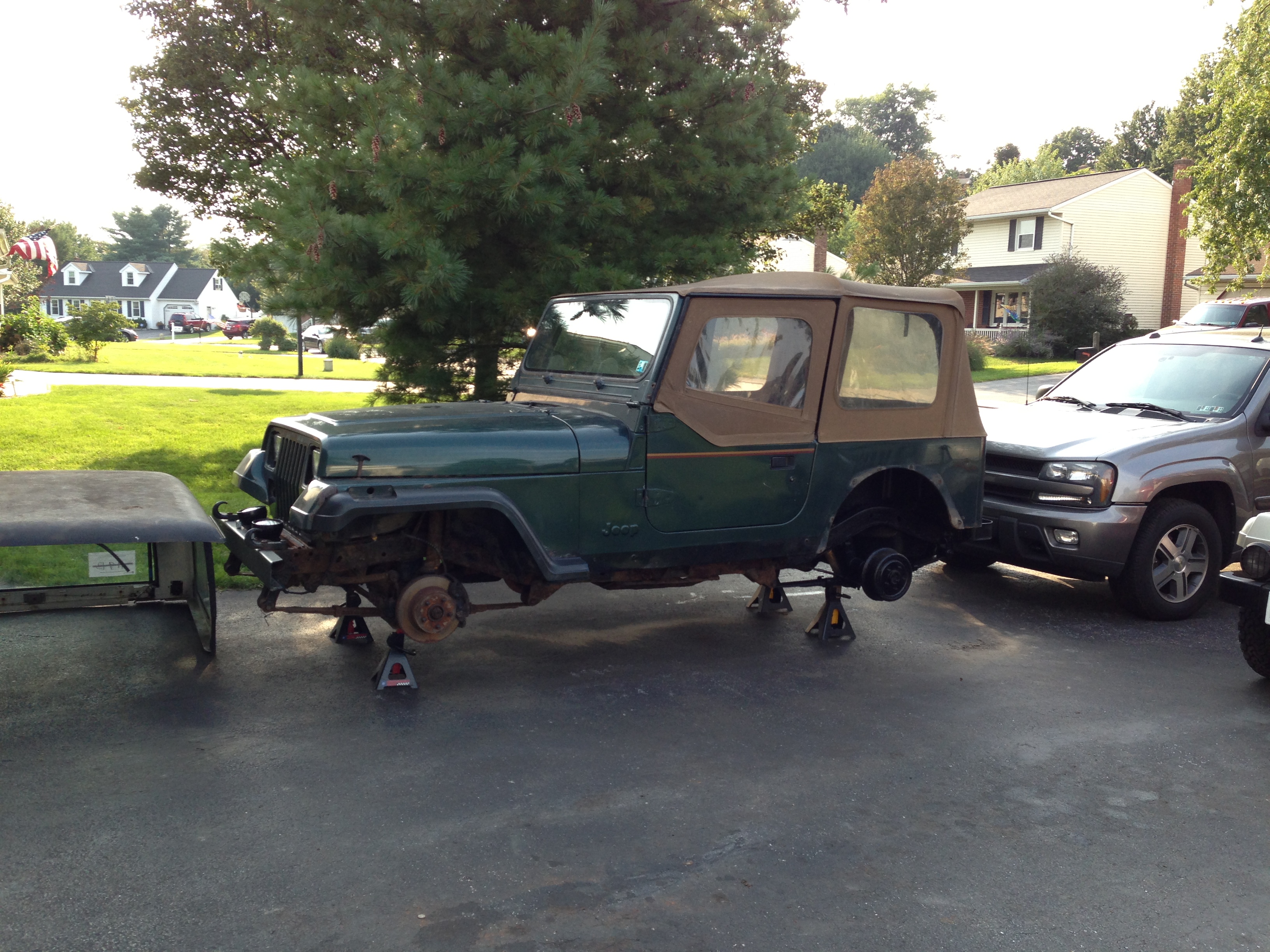

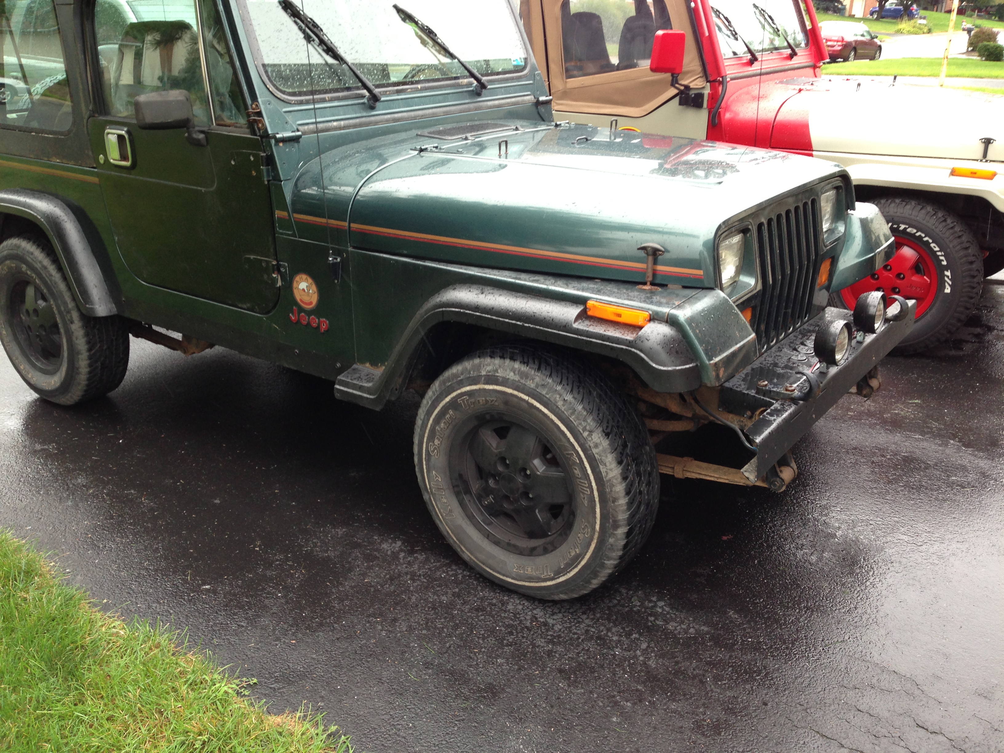

here is what we started with, A decent 1994 Sahara with all the important conversion parts
This was the day he dropped it off 3 months ago.

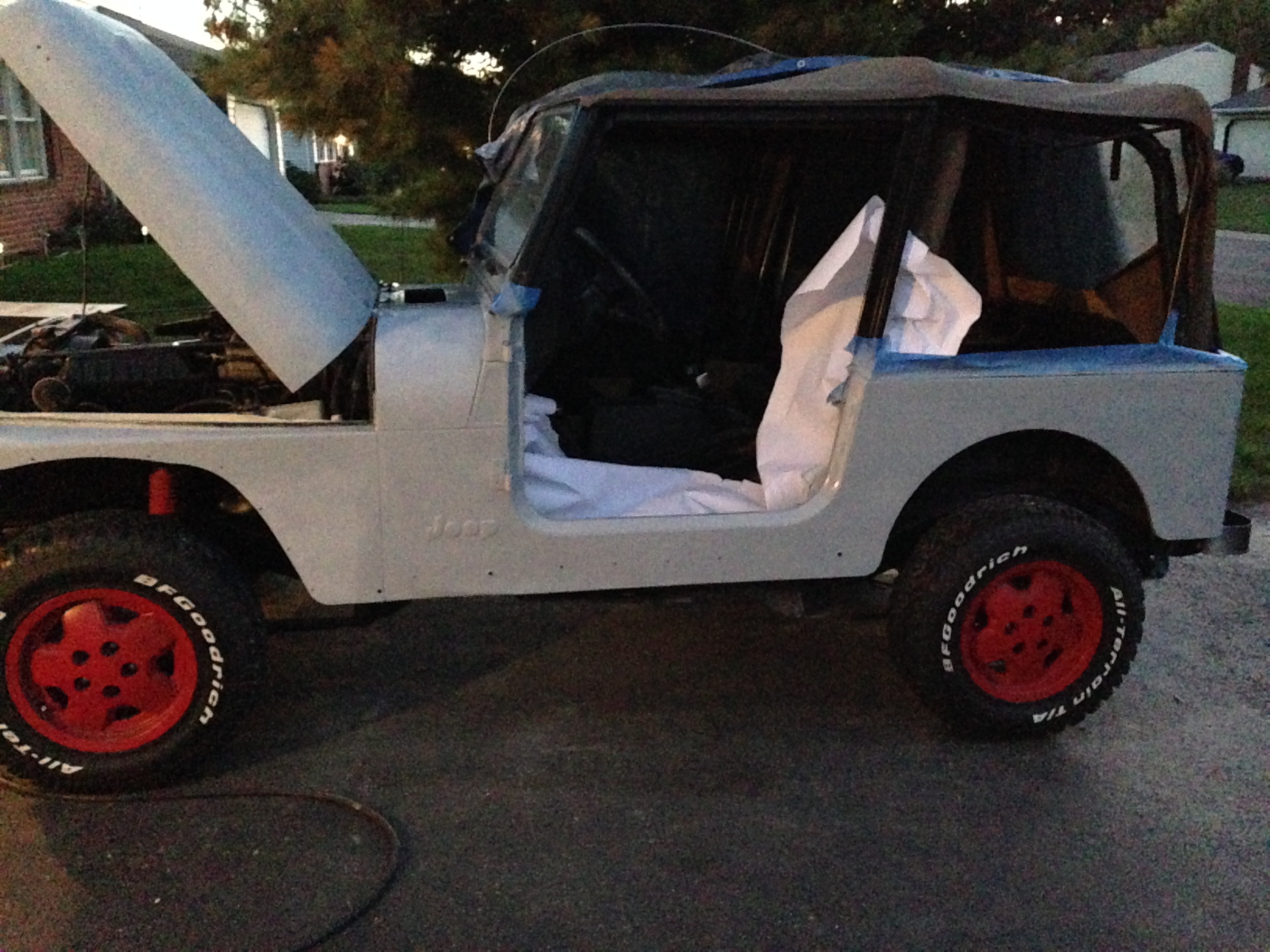

it also came with the original soft top and half door...it even had the correct door panels with the pockets

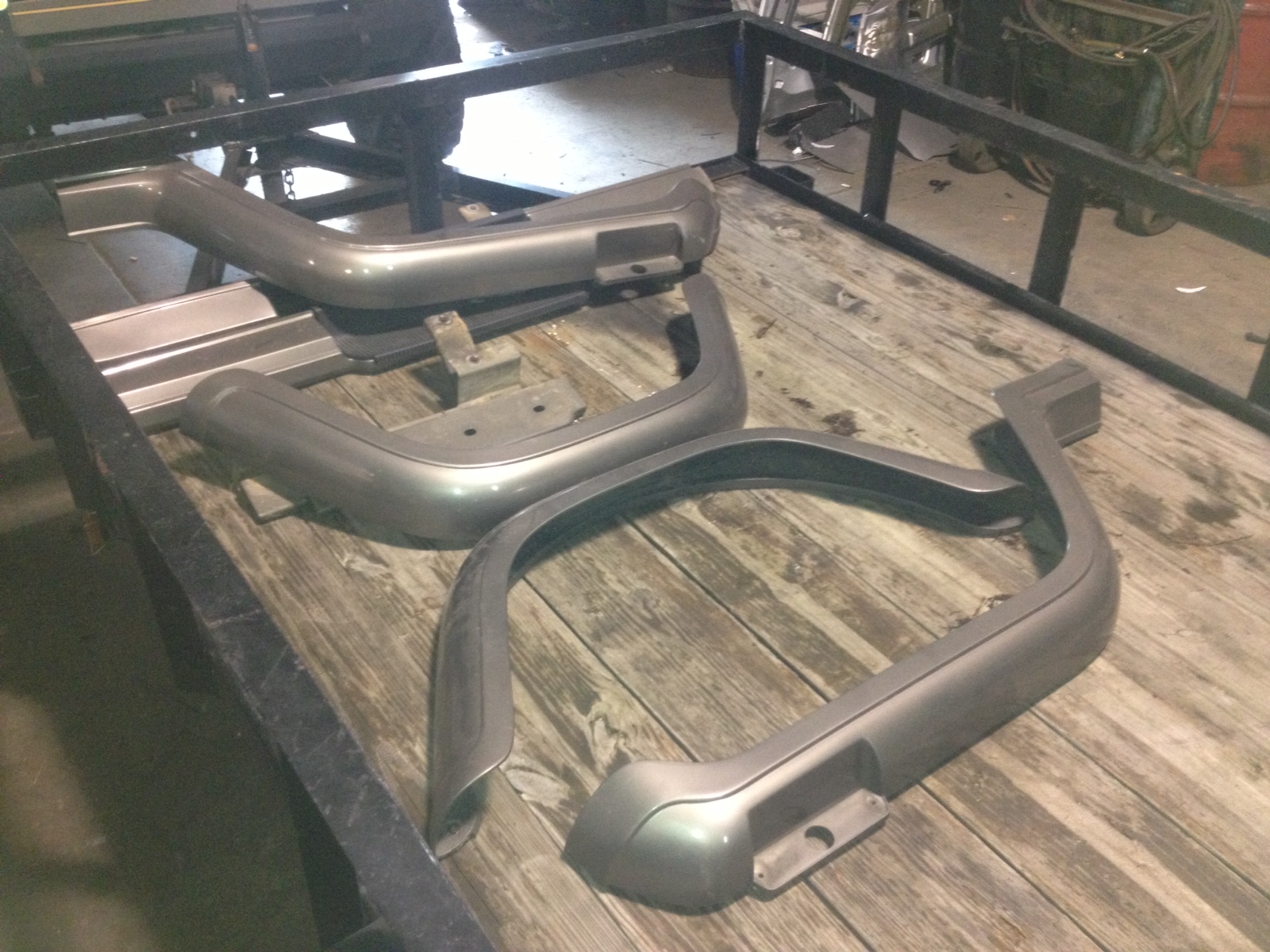

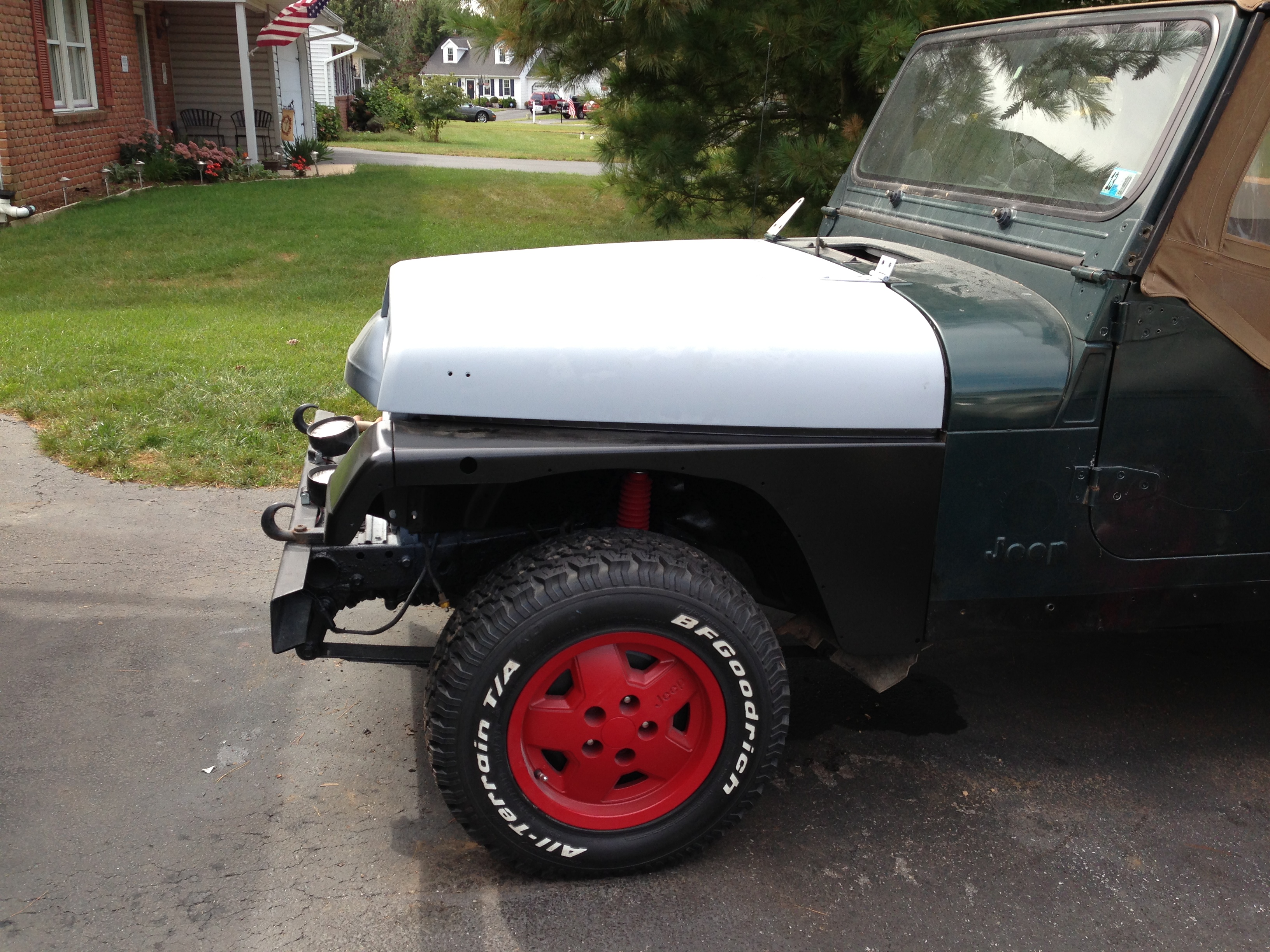

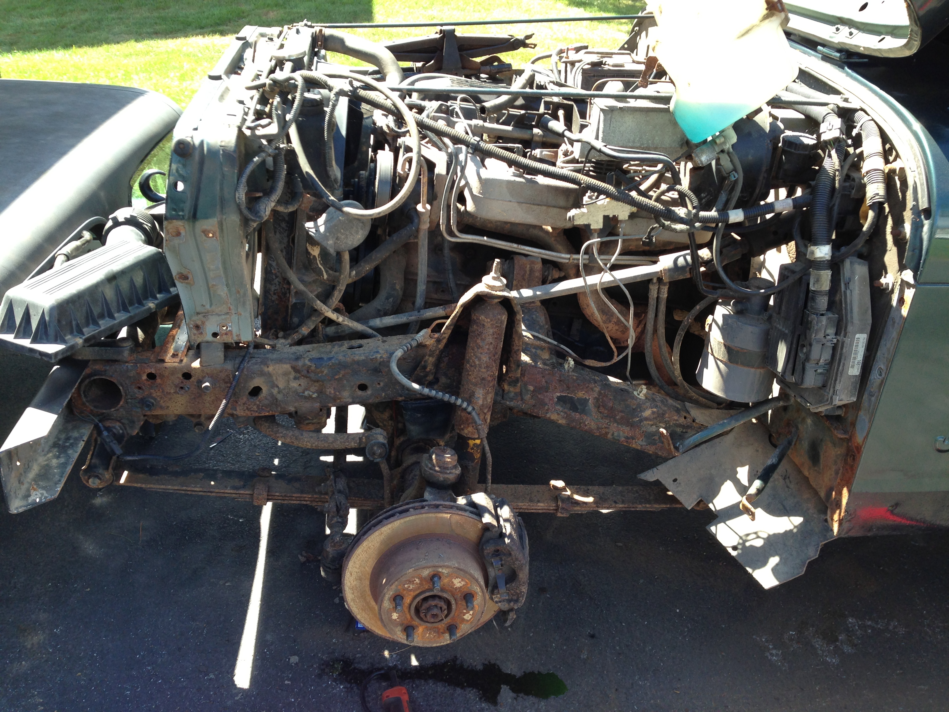

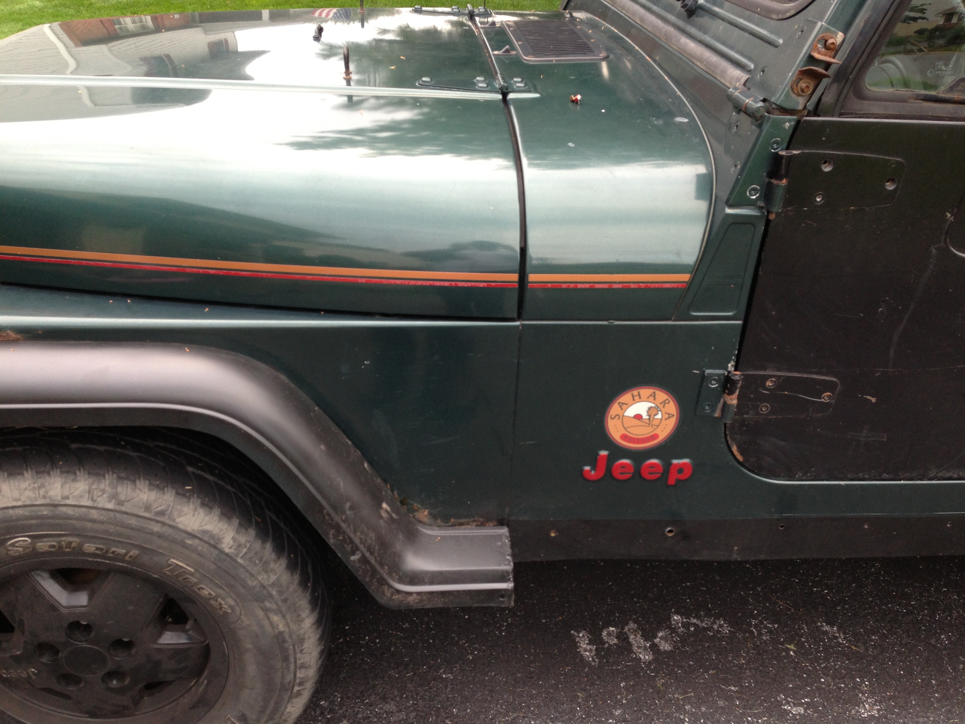

started the teardown, took off the stripes and started taking off the fender flares. Jeep had alot of rust issues...
got the wheels off it and off to get sandblasted and got the crappy broken hard top off the jeep
Looks better already....

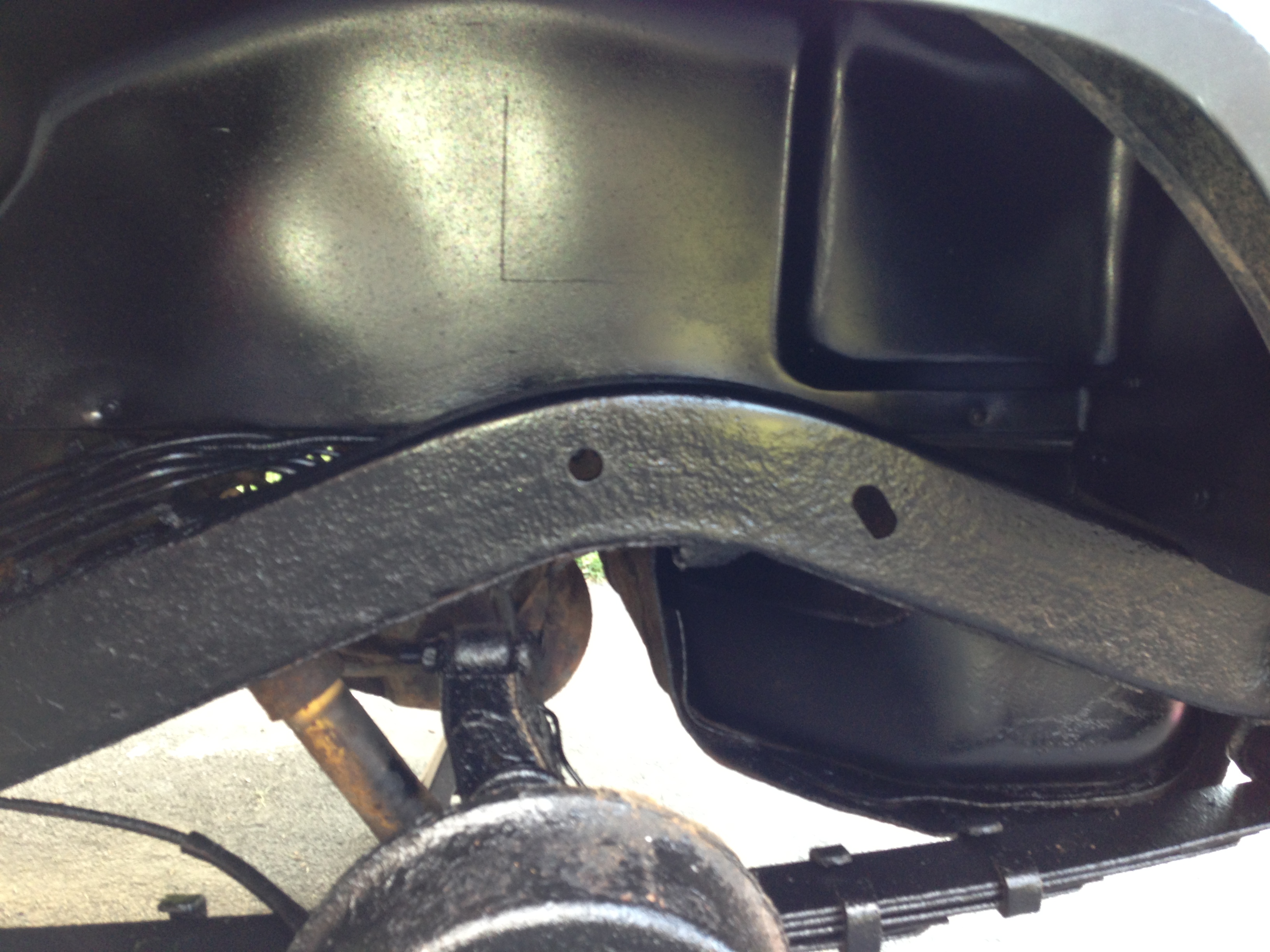

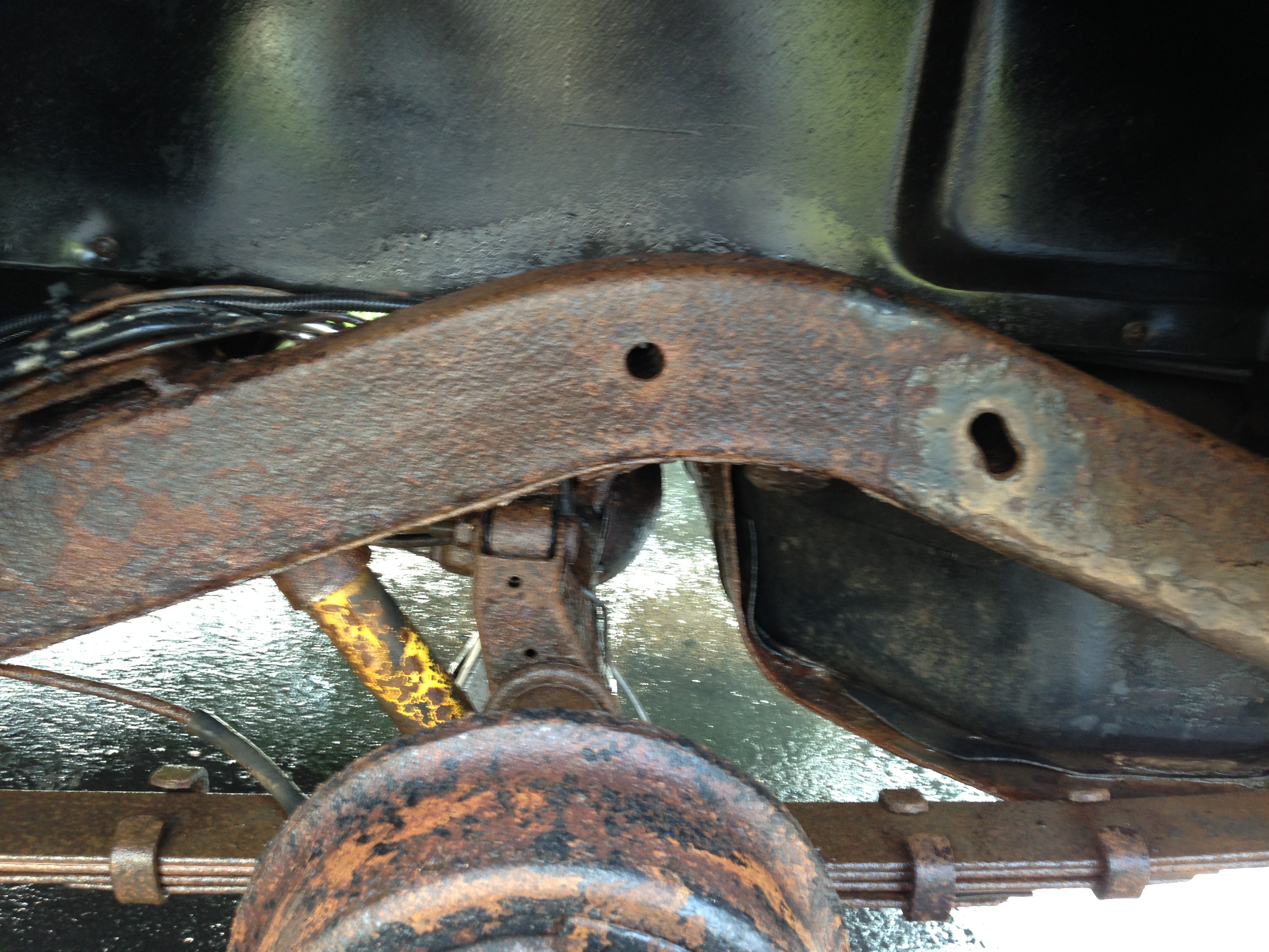

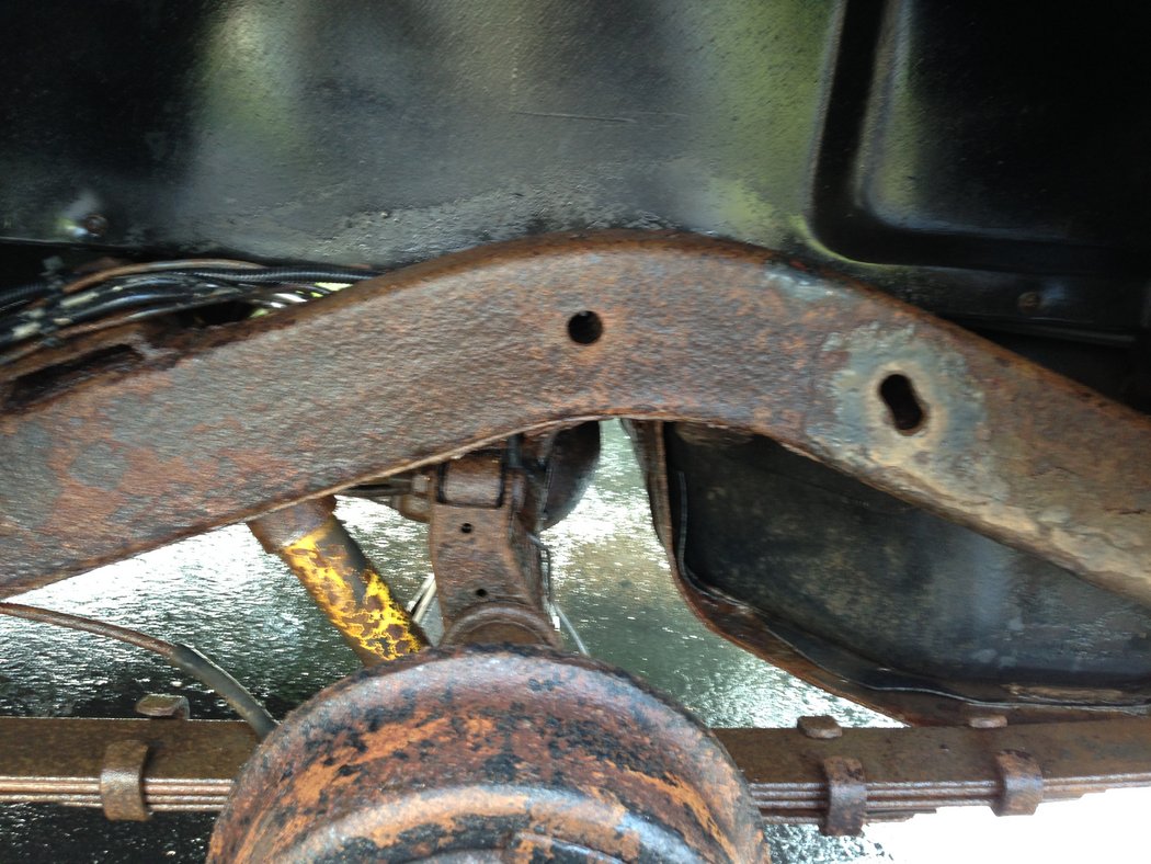

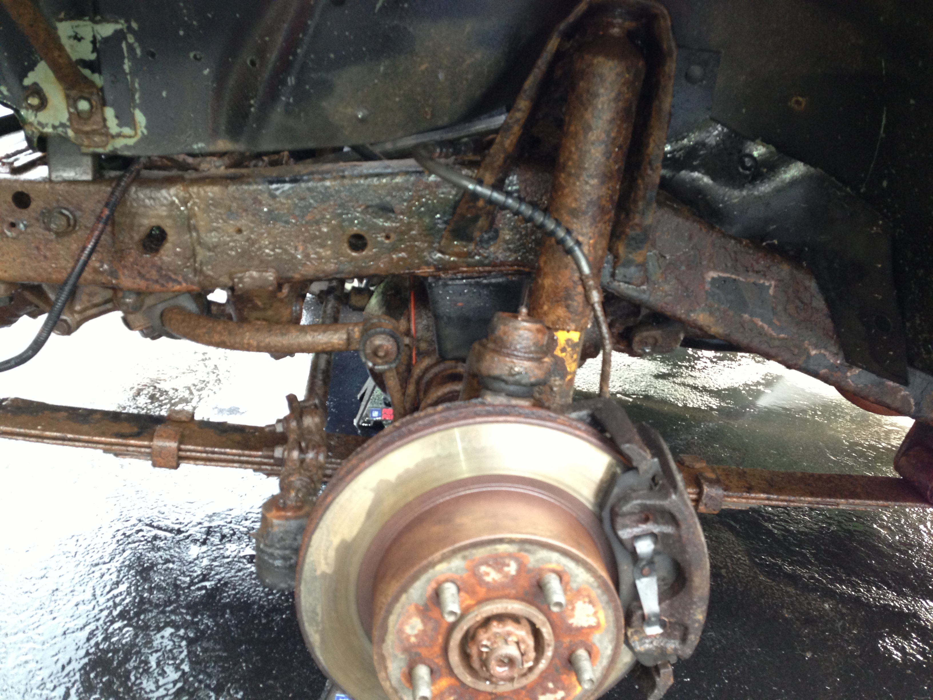

next started cleaning up the rust on the frame and under the jeep. Mostly surface rust but i wanted to clean it up and get some Por 15 on it for future protction
before
after
also had alot on the front suspension parts

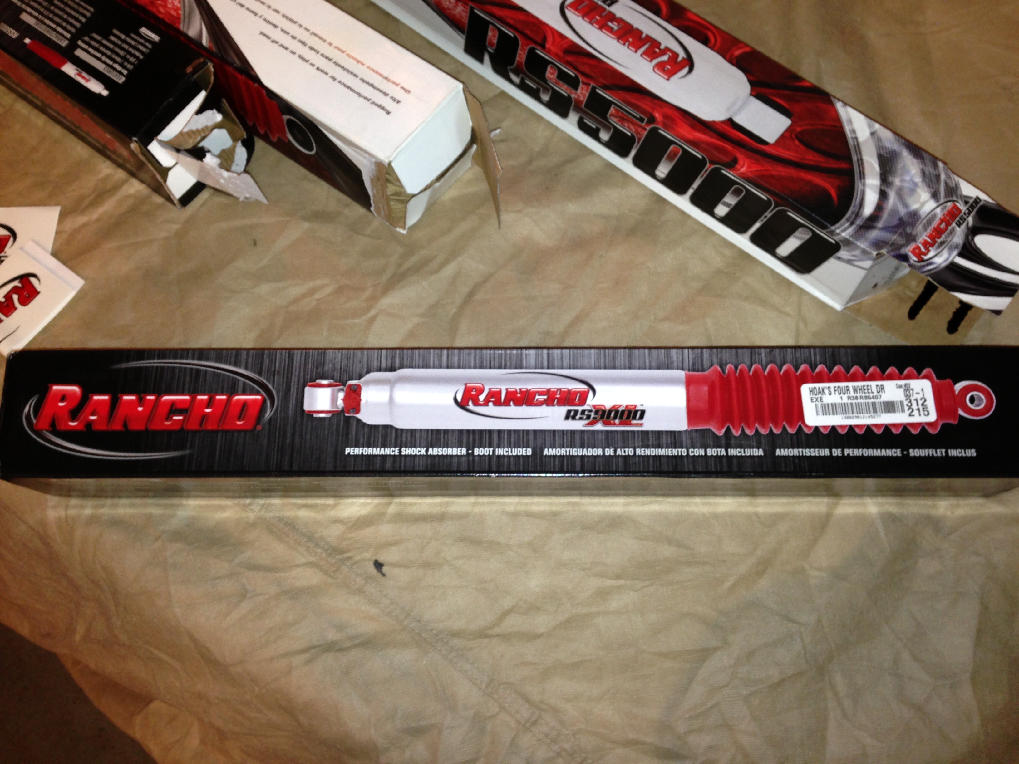

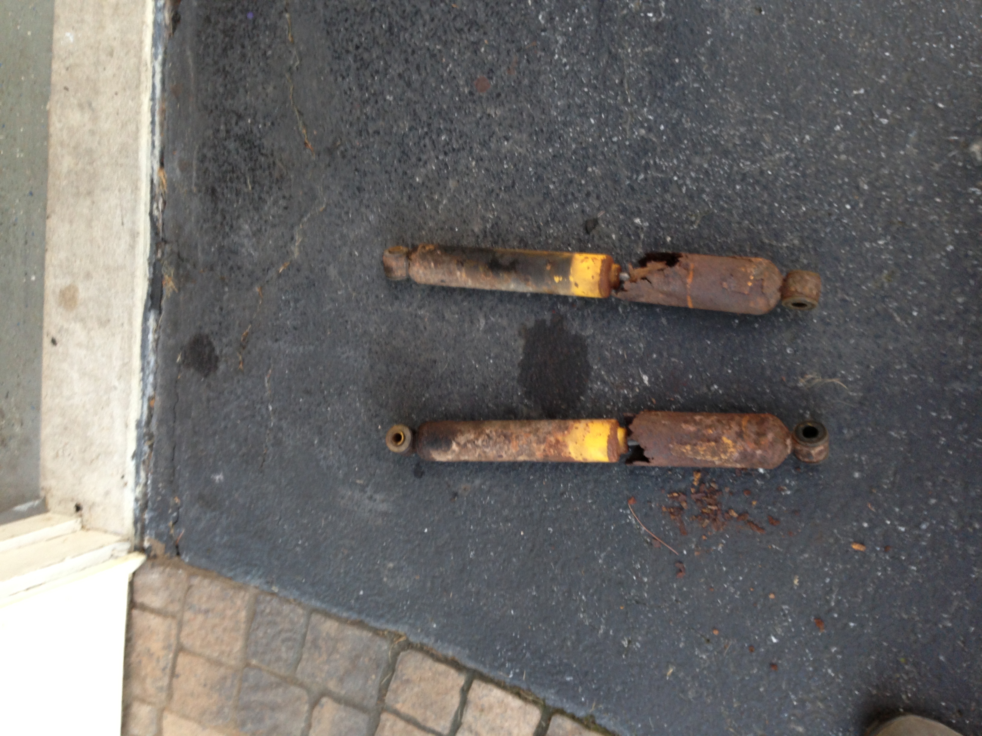

all the shocks on this jeep were dead on arrival
so we took care of that

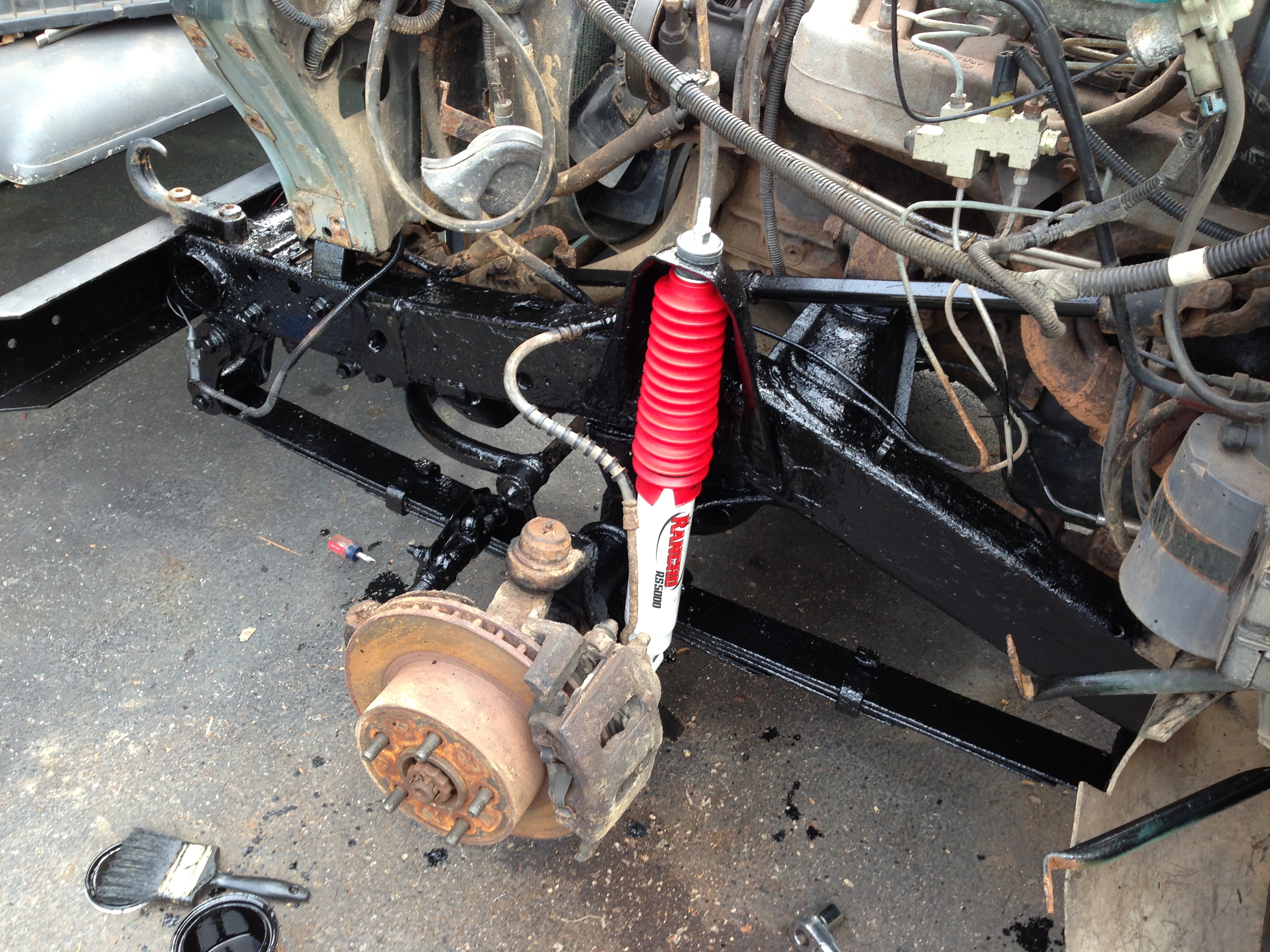

Post by Jack_Fauth » November 20th, 2013, 10:38 am

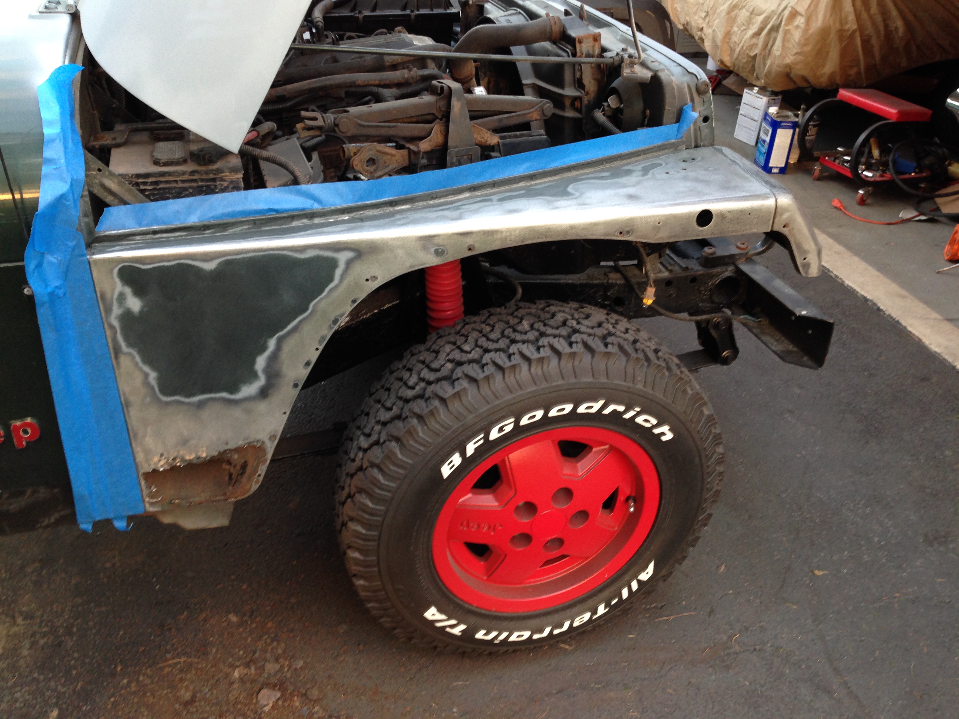

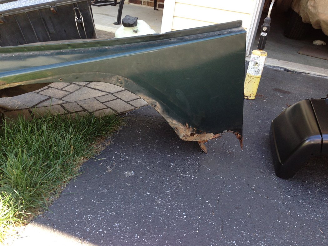

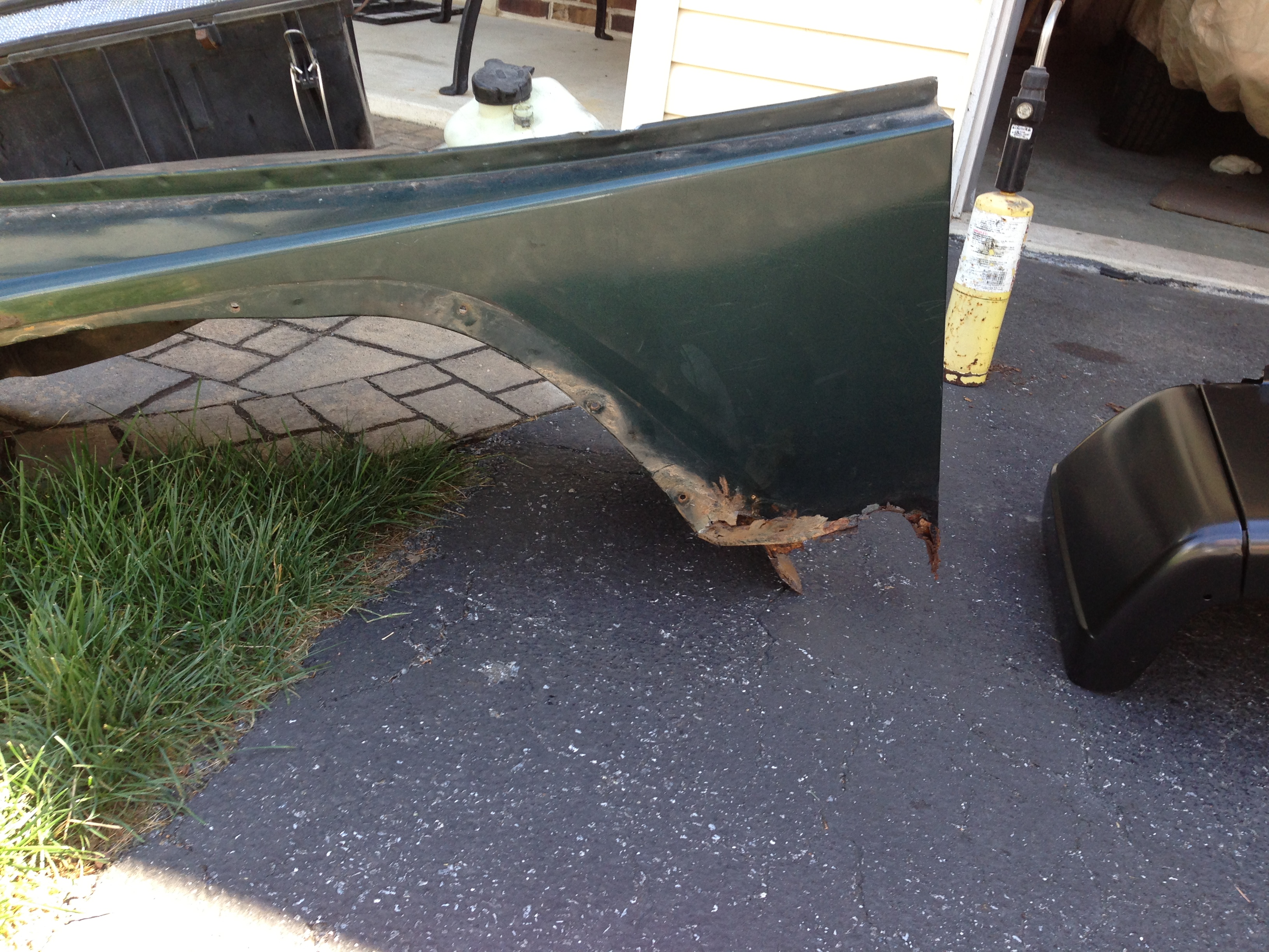

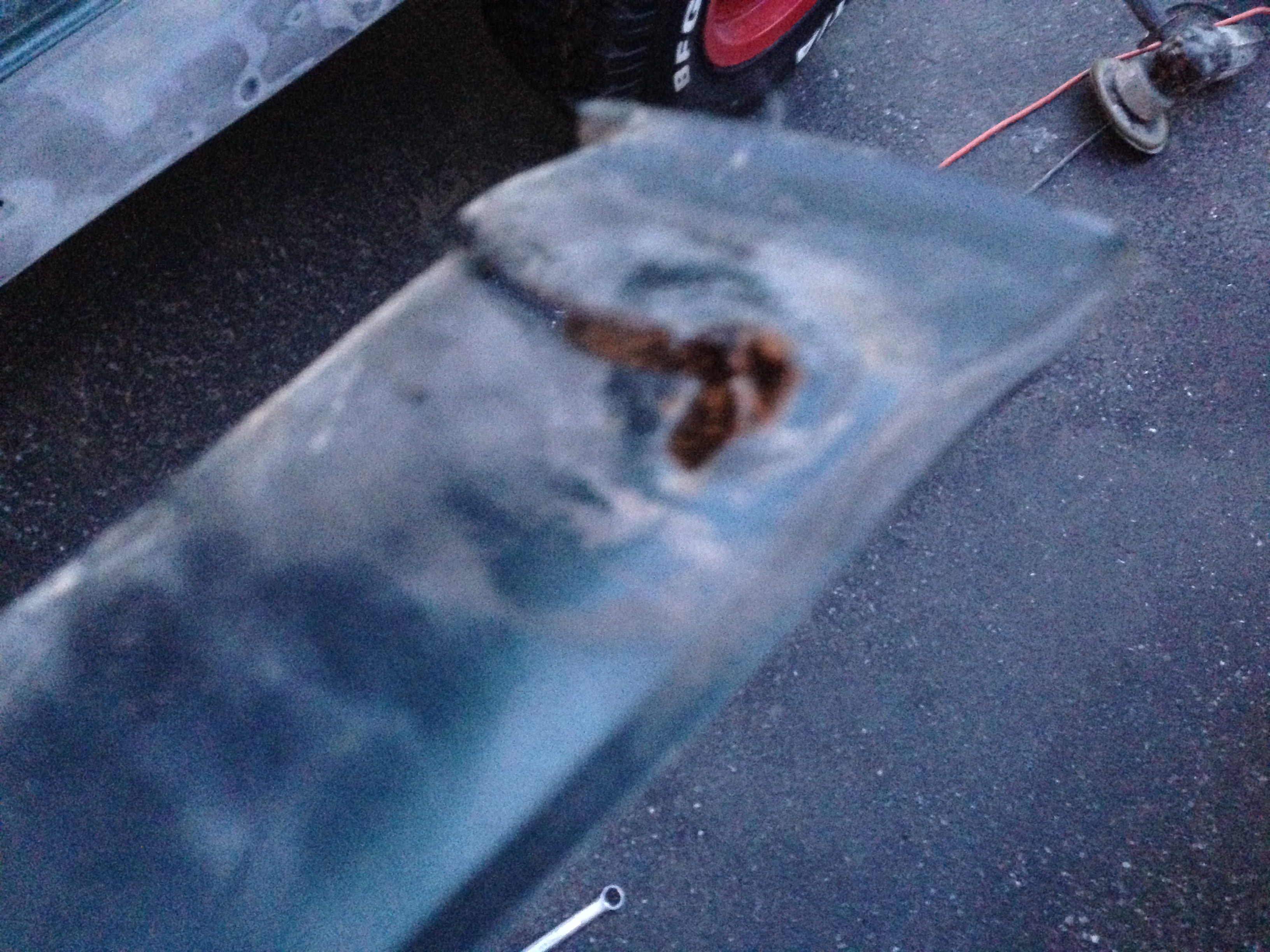

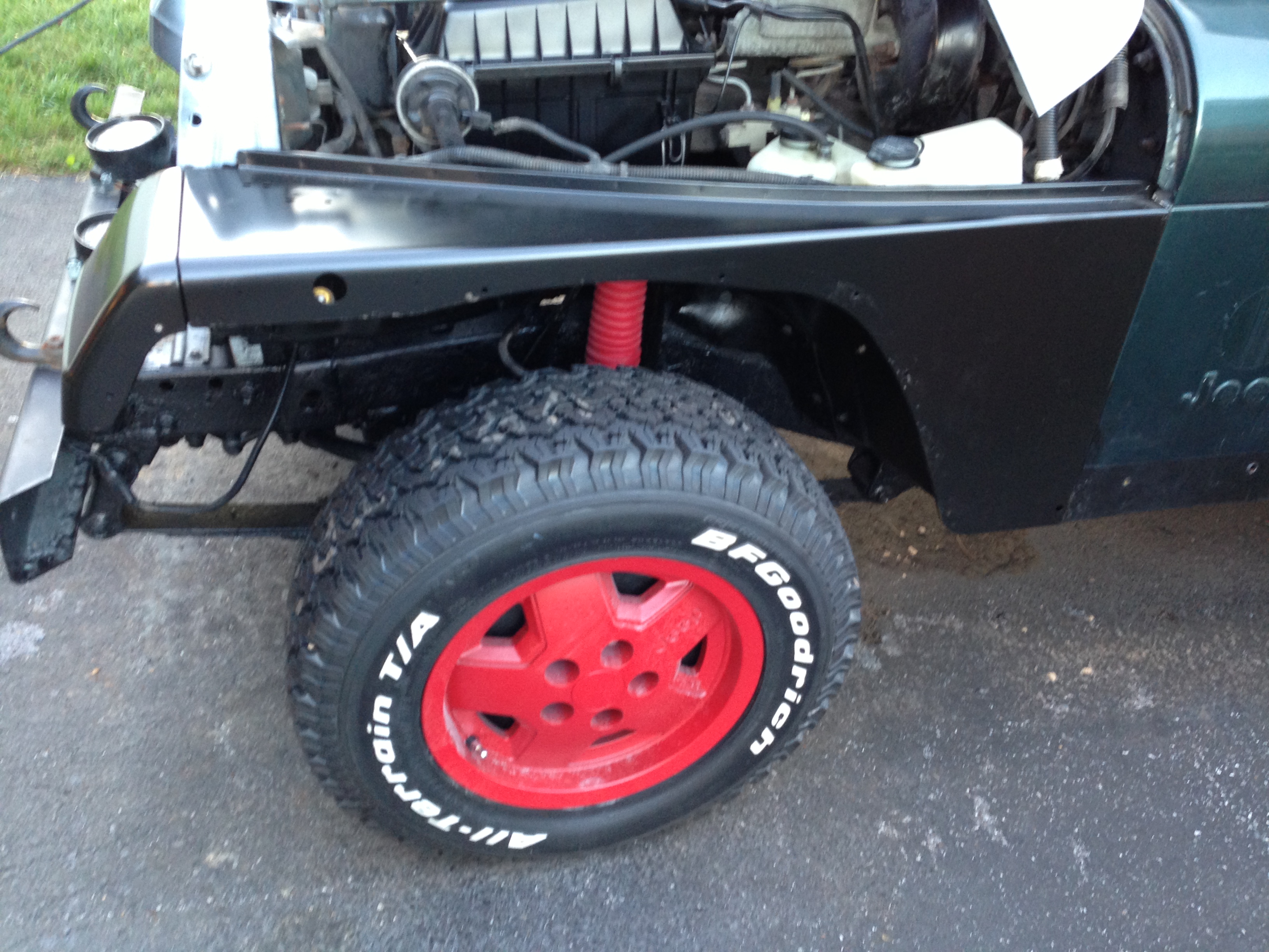

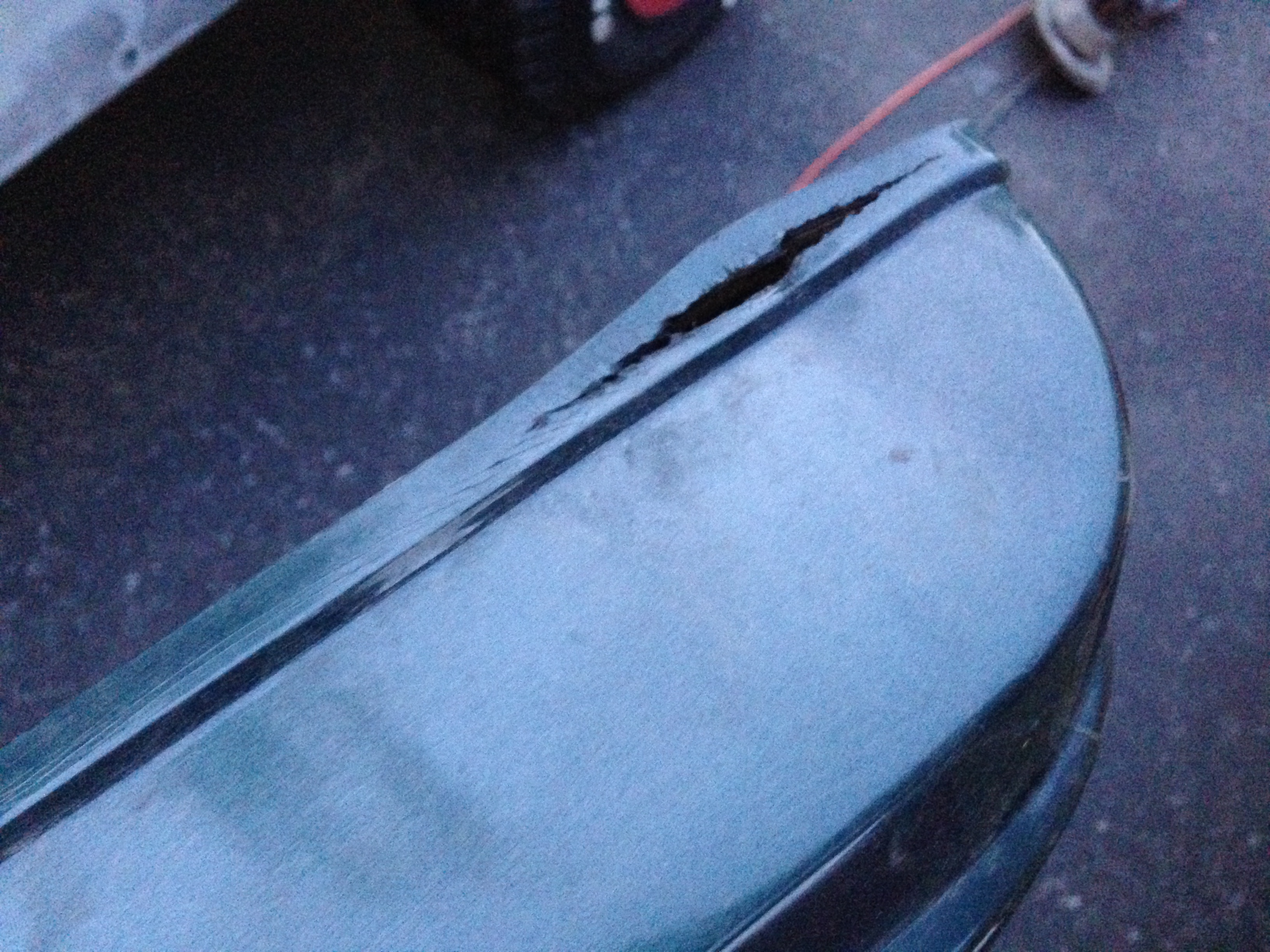

Jeep needed a drivers side fender that was a hugh pain in the ass to get off....
frame rail cleaned up and painted and new shock installed
Re: Pennsylvannia Jeep #18
Post by Jack_Fauth » November 20th, 2013, 10:44 am

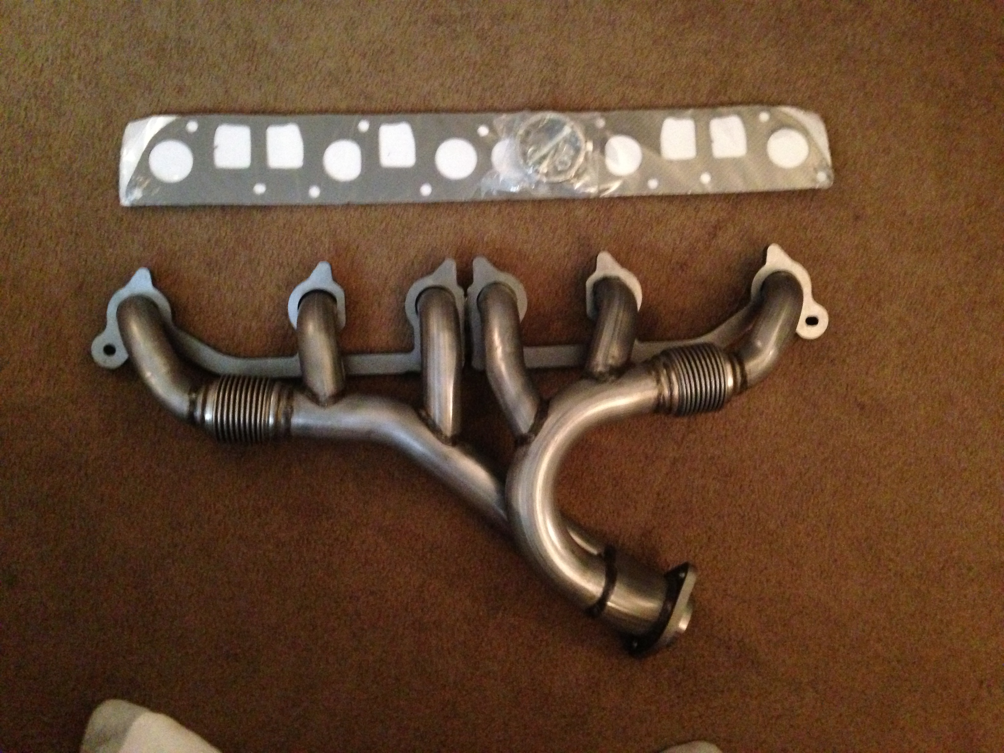

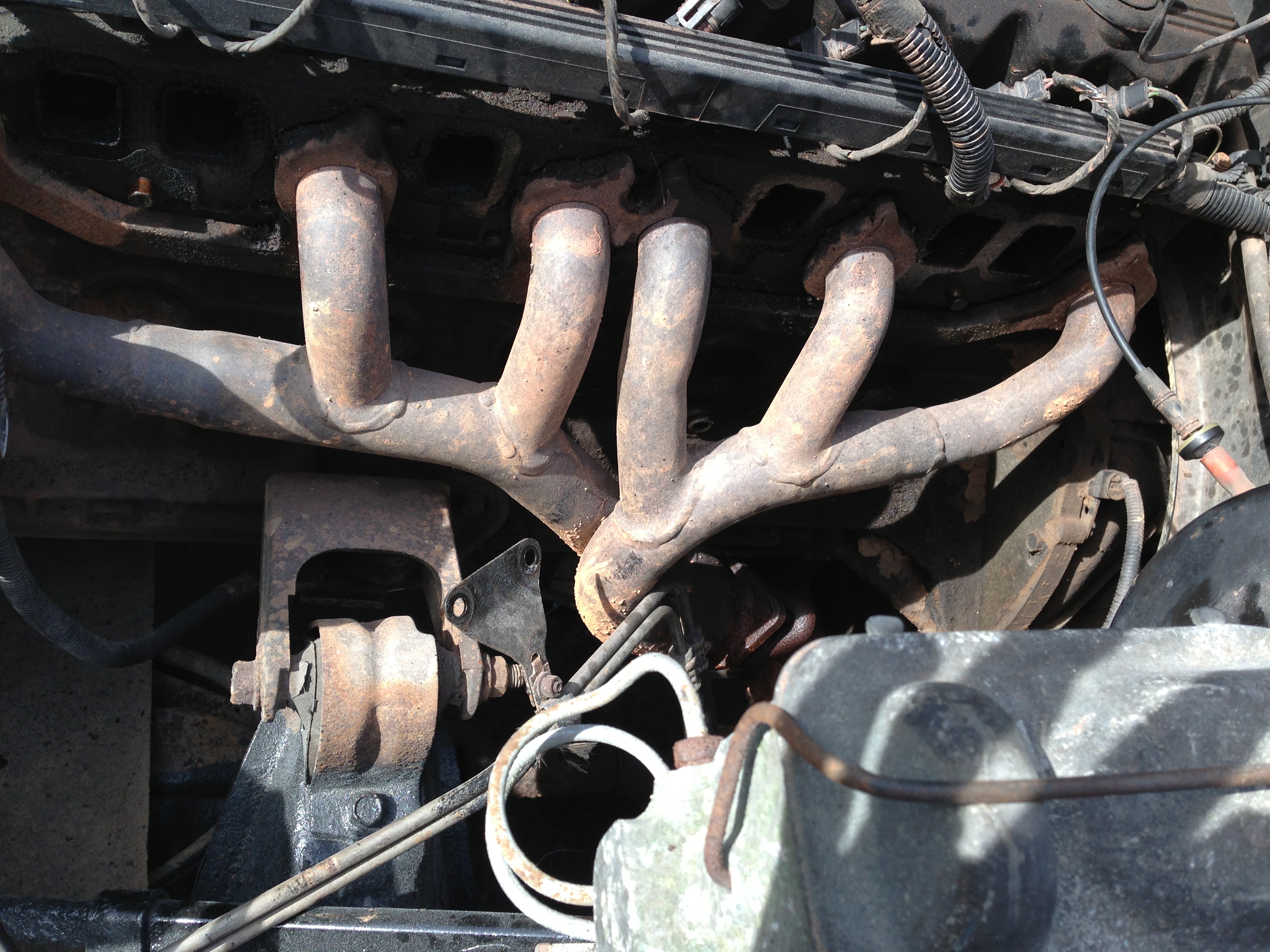

This jeep also had the usual cracked exhaust manifold so i thought it would be way easier to do this while the driver fender was off
boy was i right, replaced it in 3 hours , start to finish. That is the way to do a manifold. Mine took over 8 hours across a 2 day span

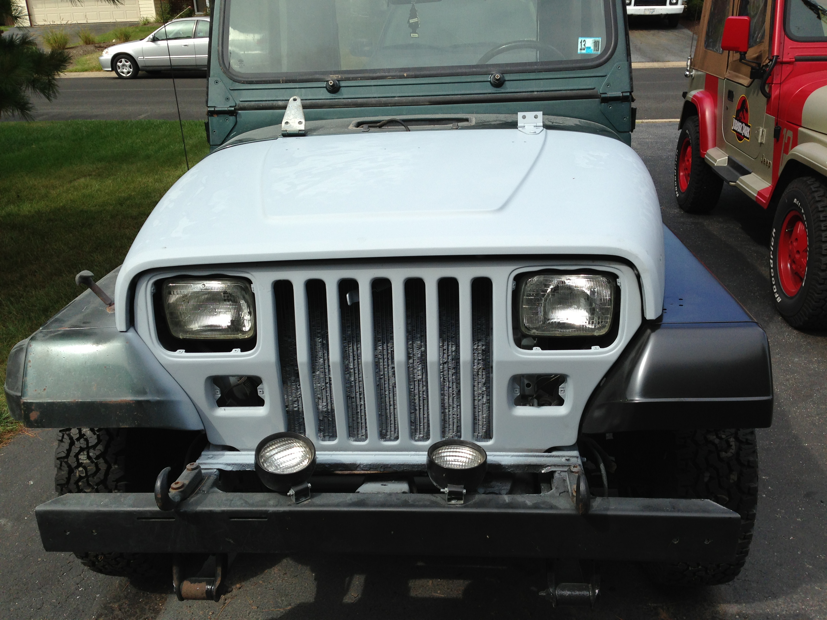

after installed i put on the new fender
even though it was a aftermarket fender it did line up pretty well

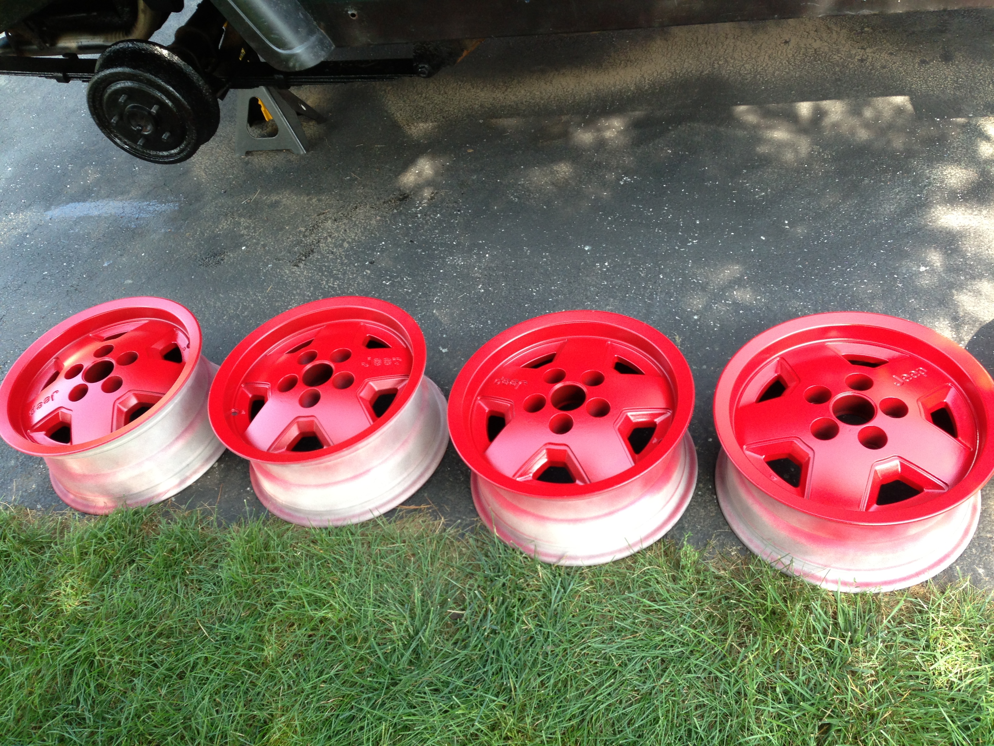

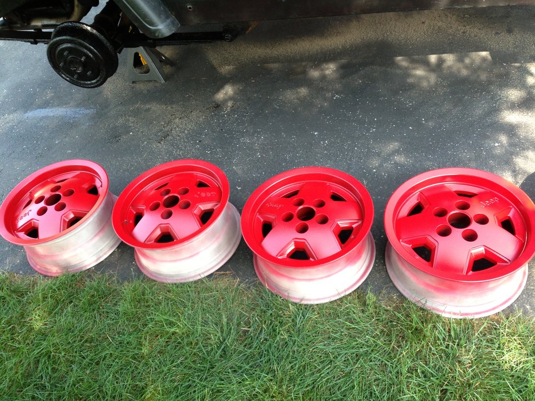

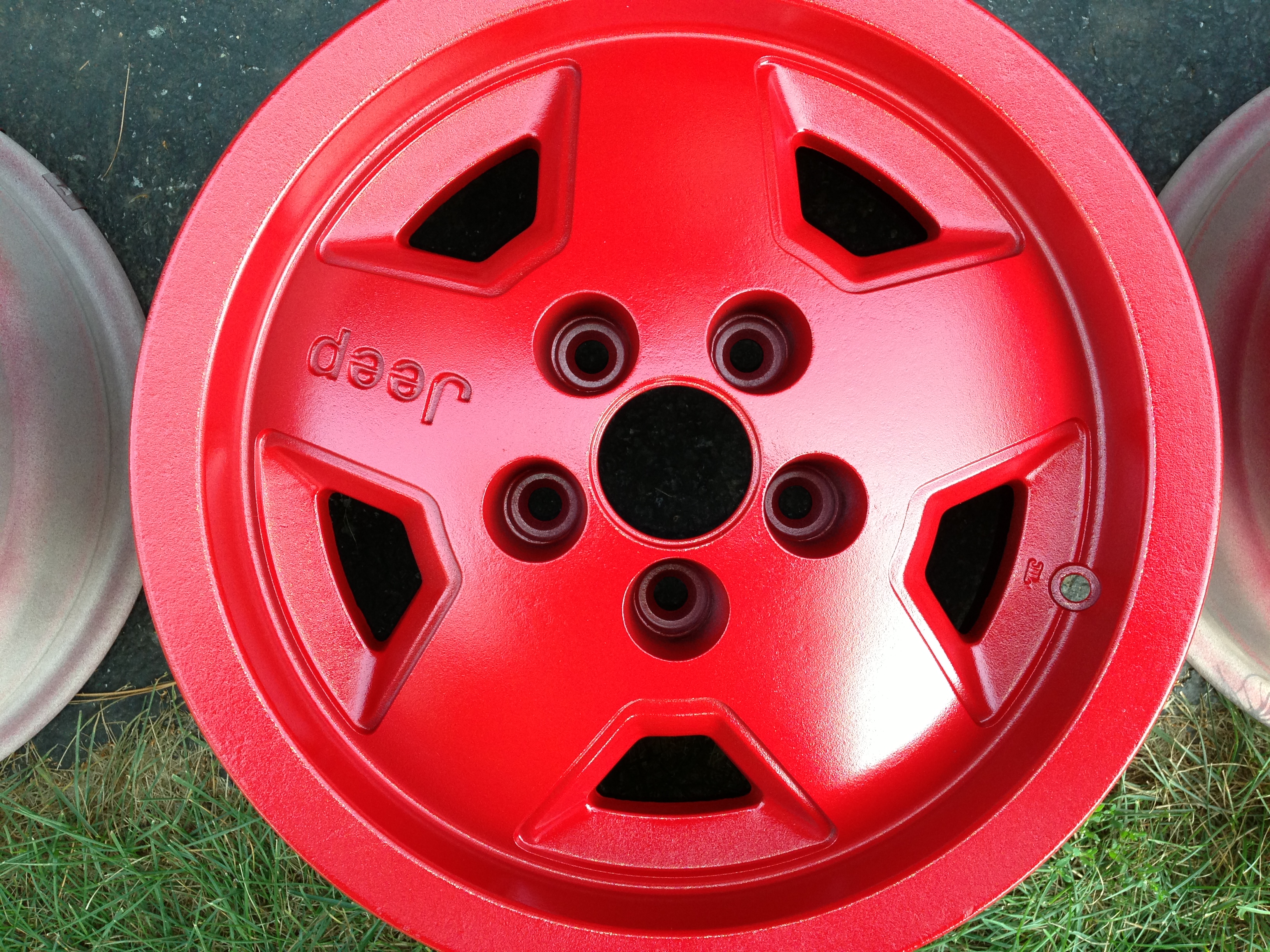

Also got the wheels and tires painted and mounted...this i think makes the biggest step towards looking like a jurassic jeep

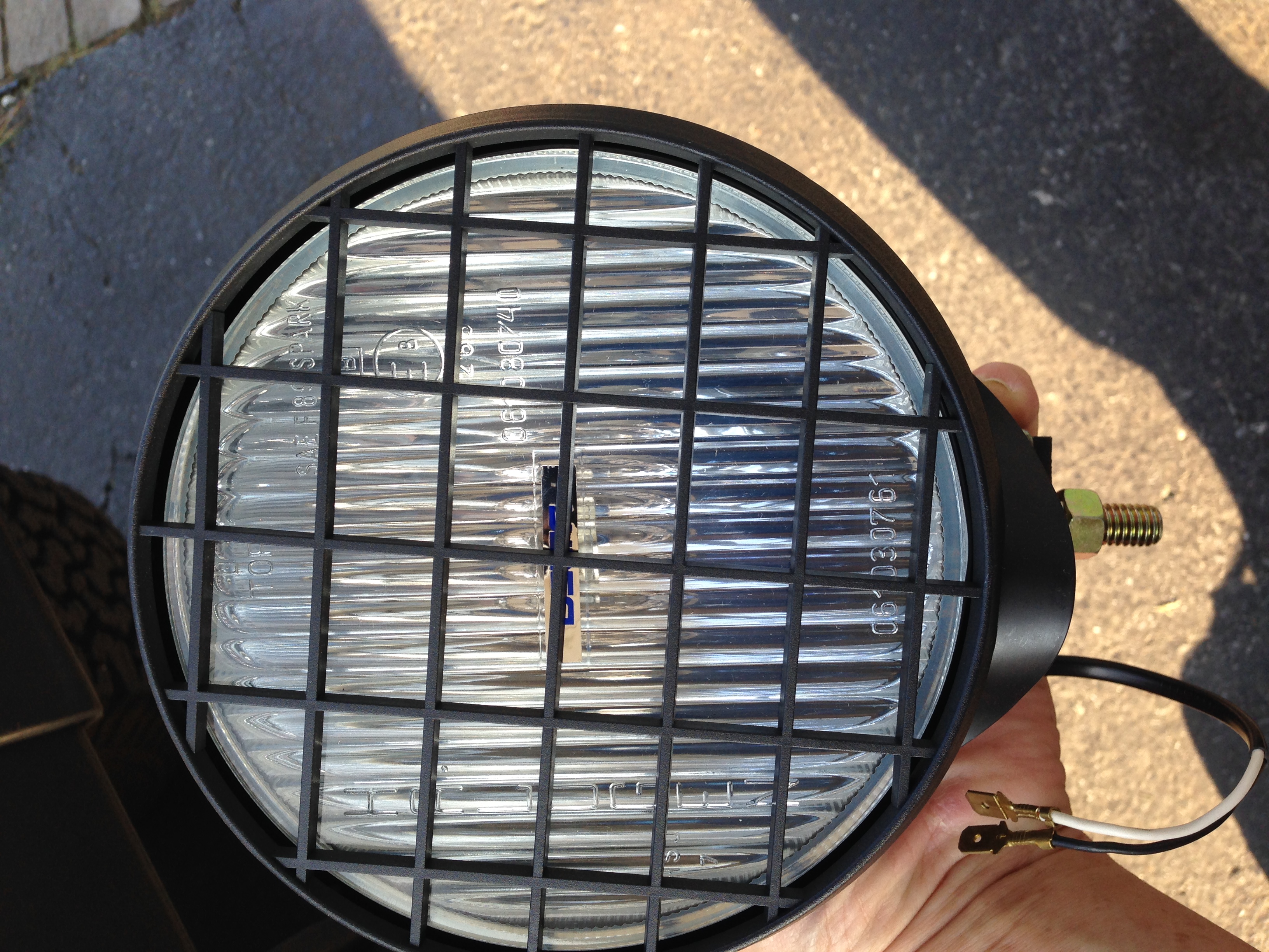

lots of goodies started coming in the mail

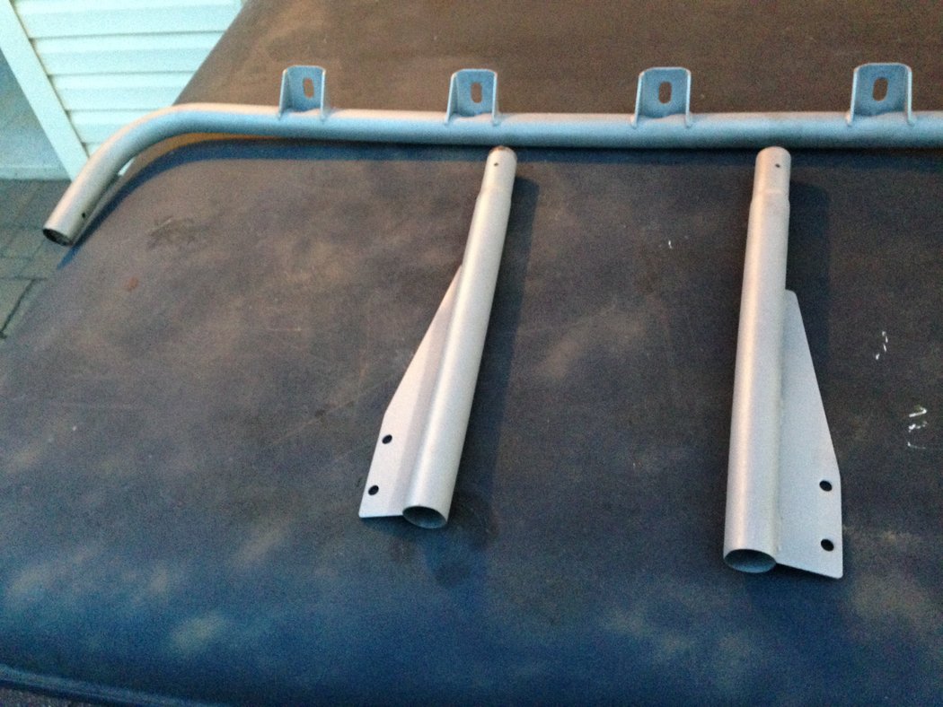

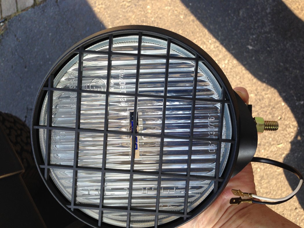

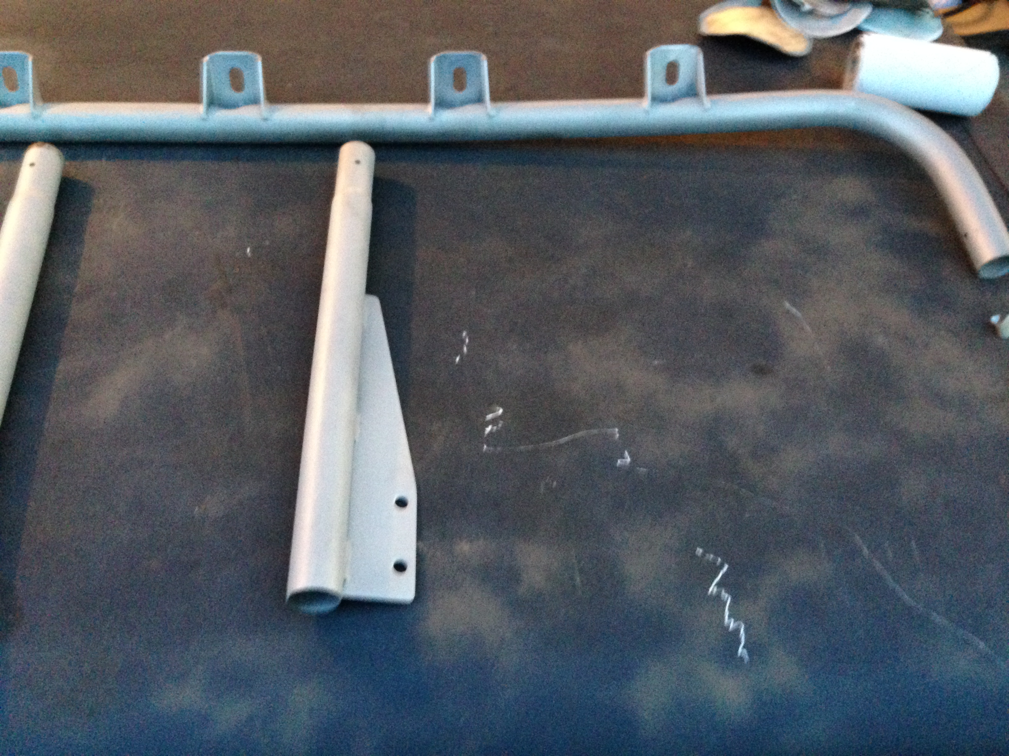

found a light bar on craigslist and had it sandblasted so it would hold paint
original owner was kinda dumb he cut alot of stuff off and broke a few things taking the jeep apart...like the side steps
These were butchered up pretty badly so we had to find new ones of these

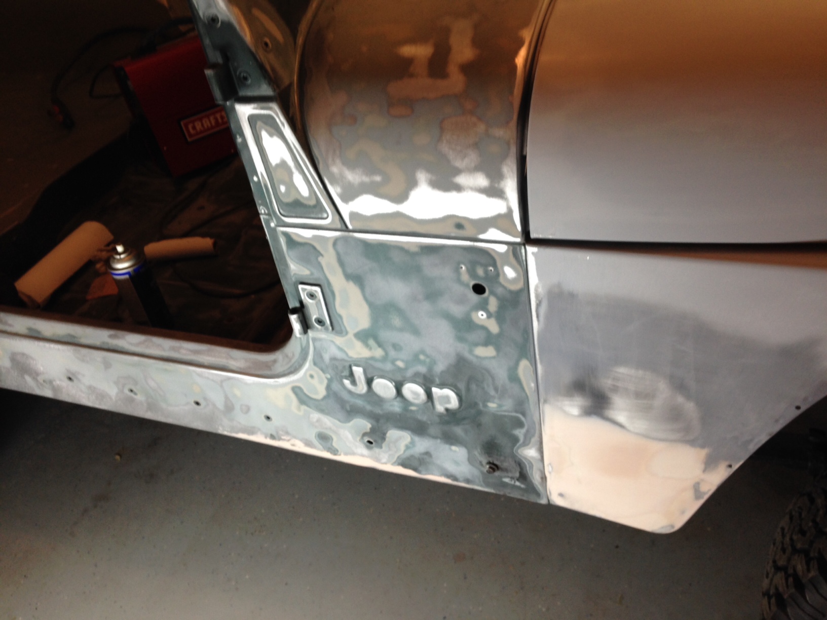

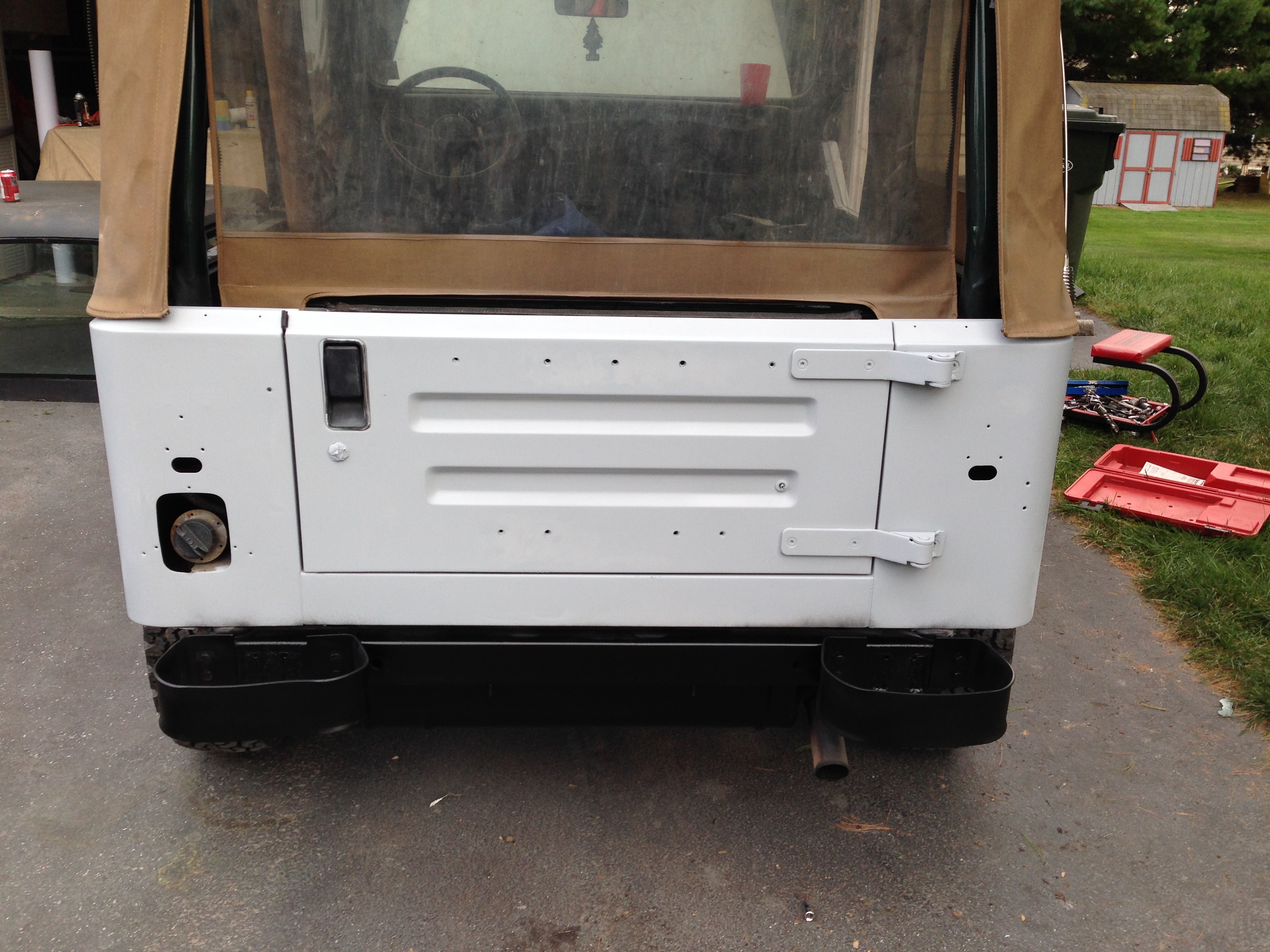

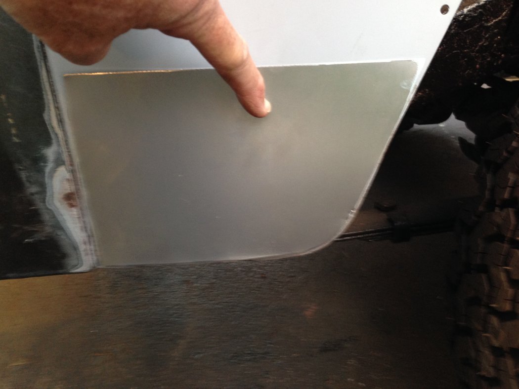

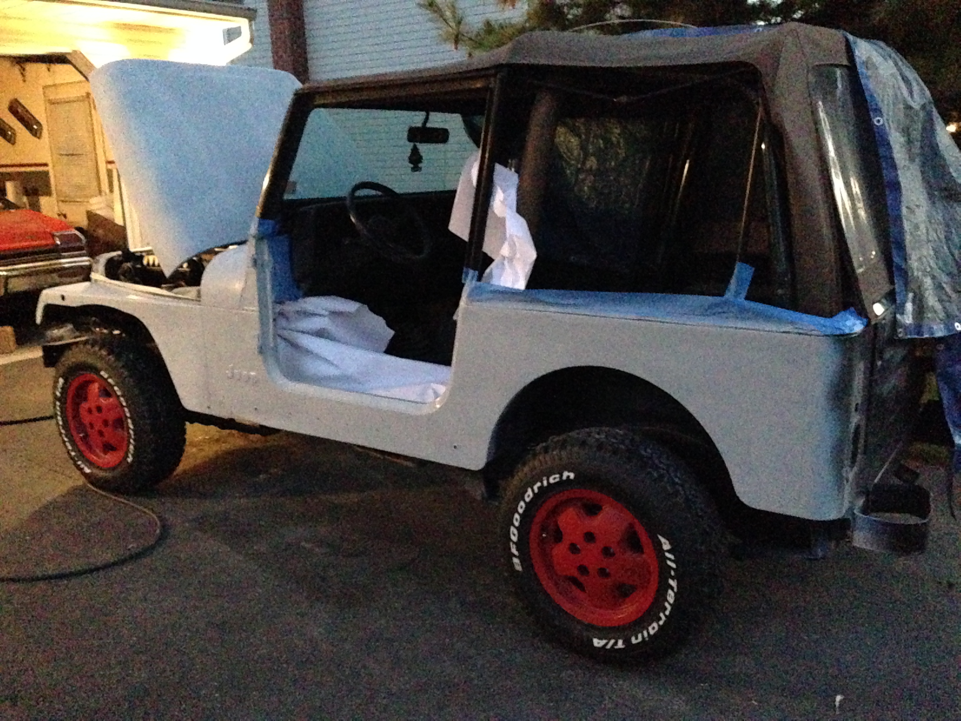

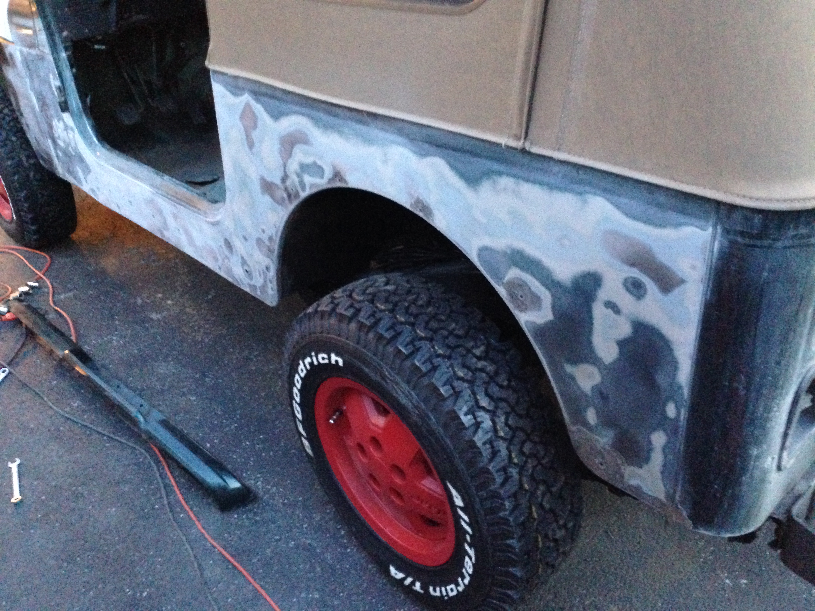

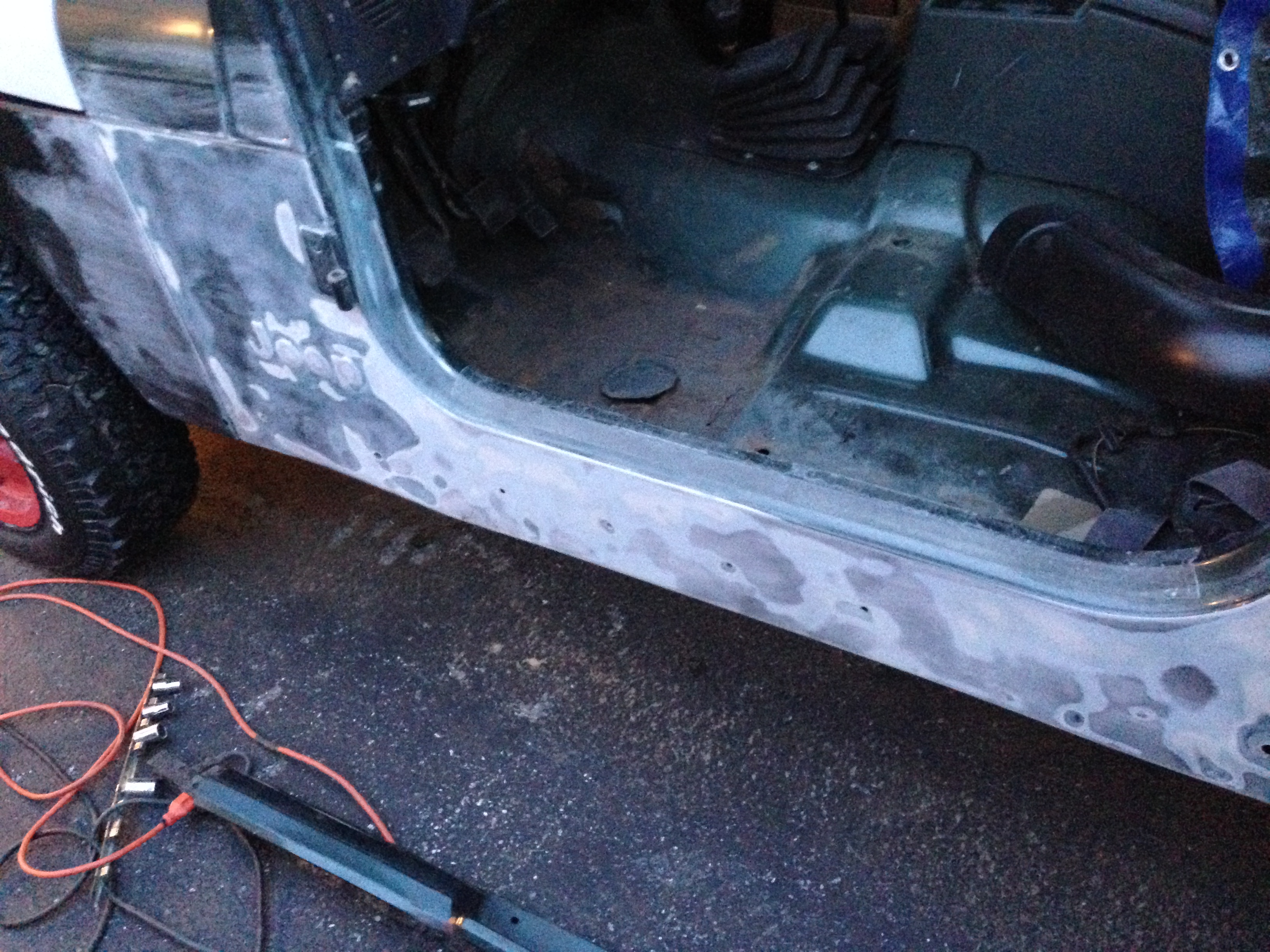

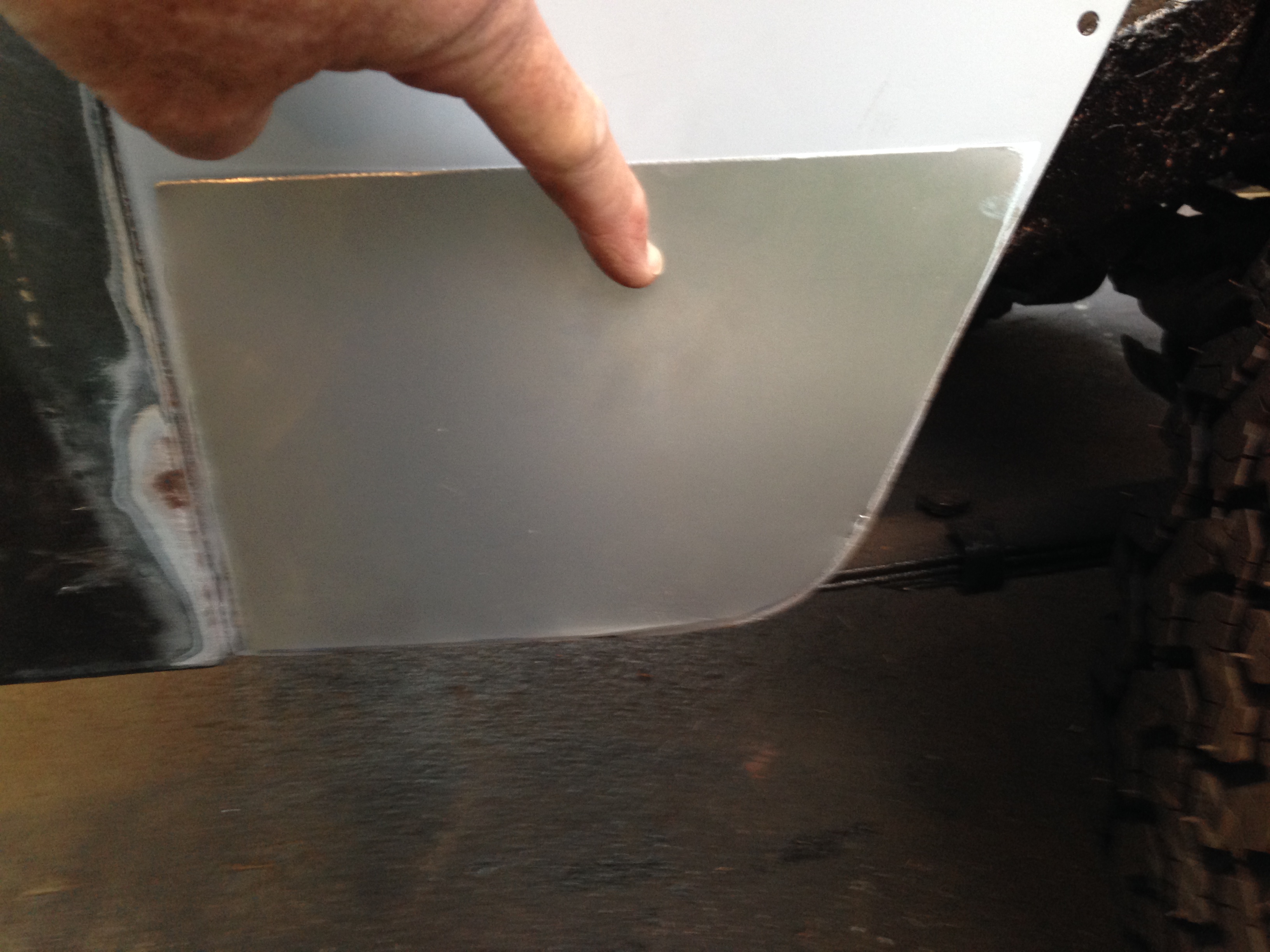

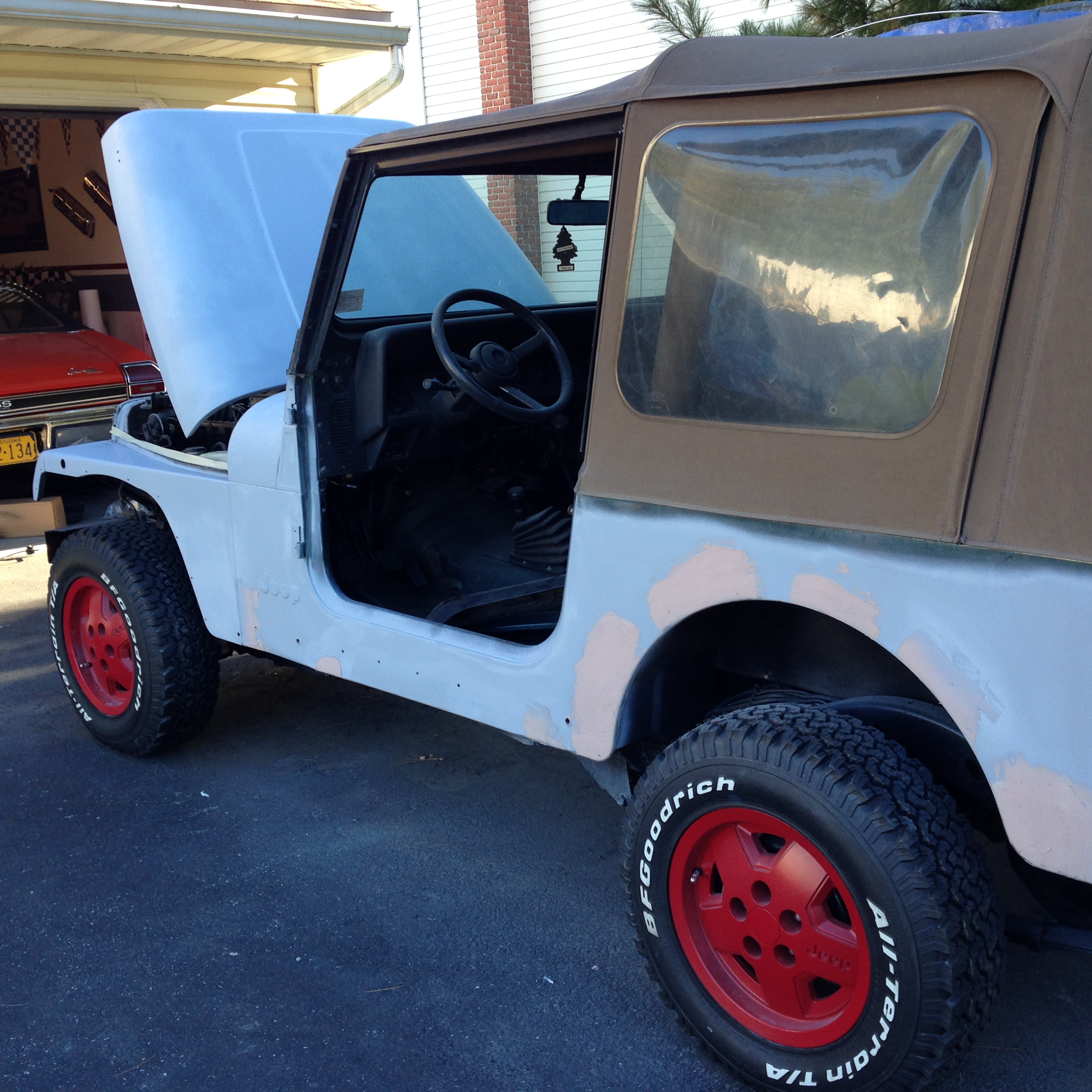

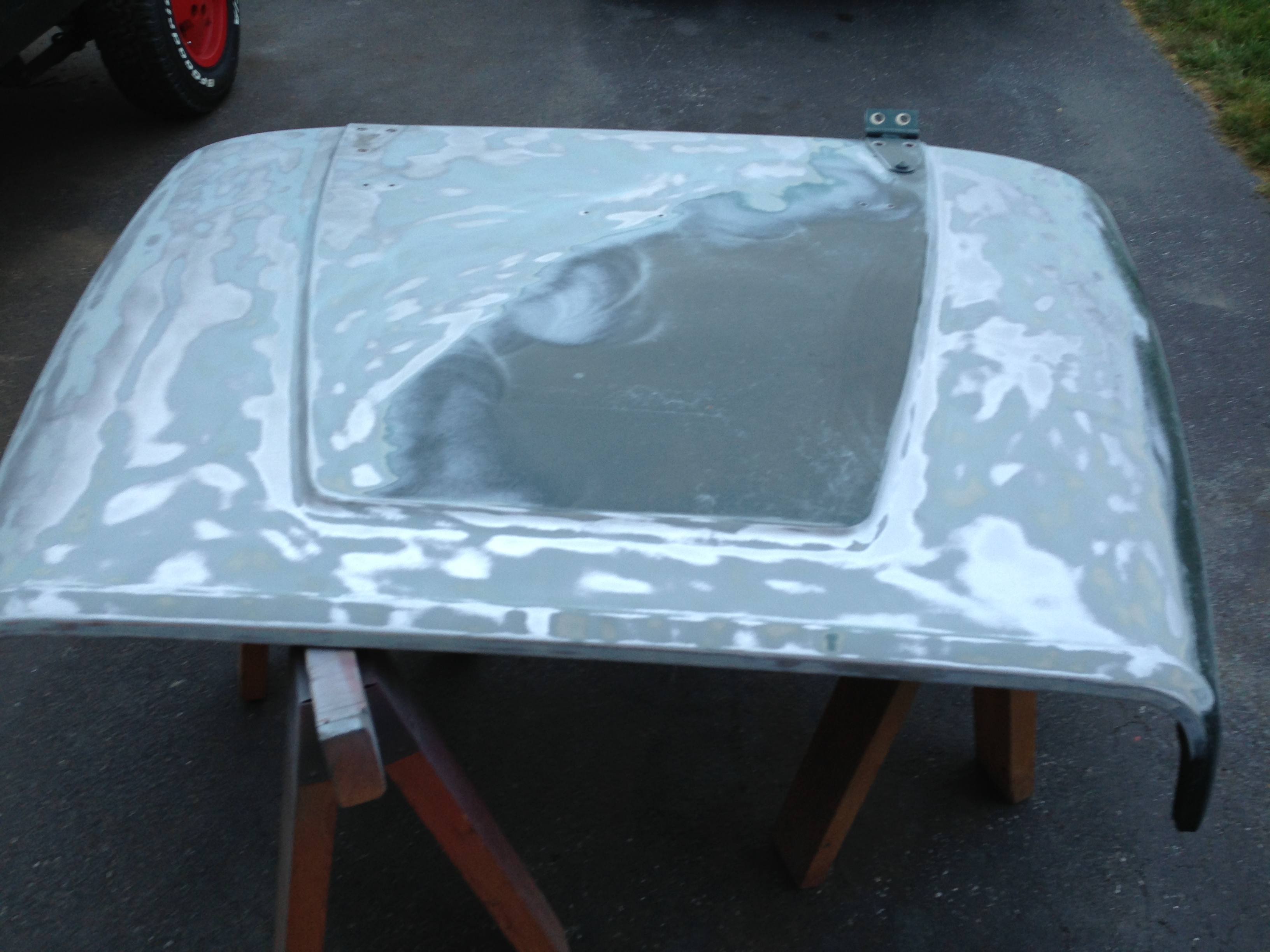

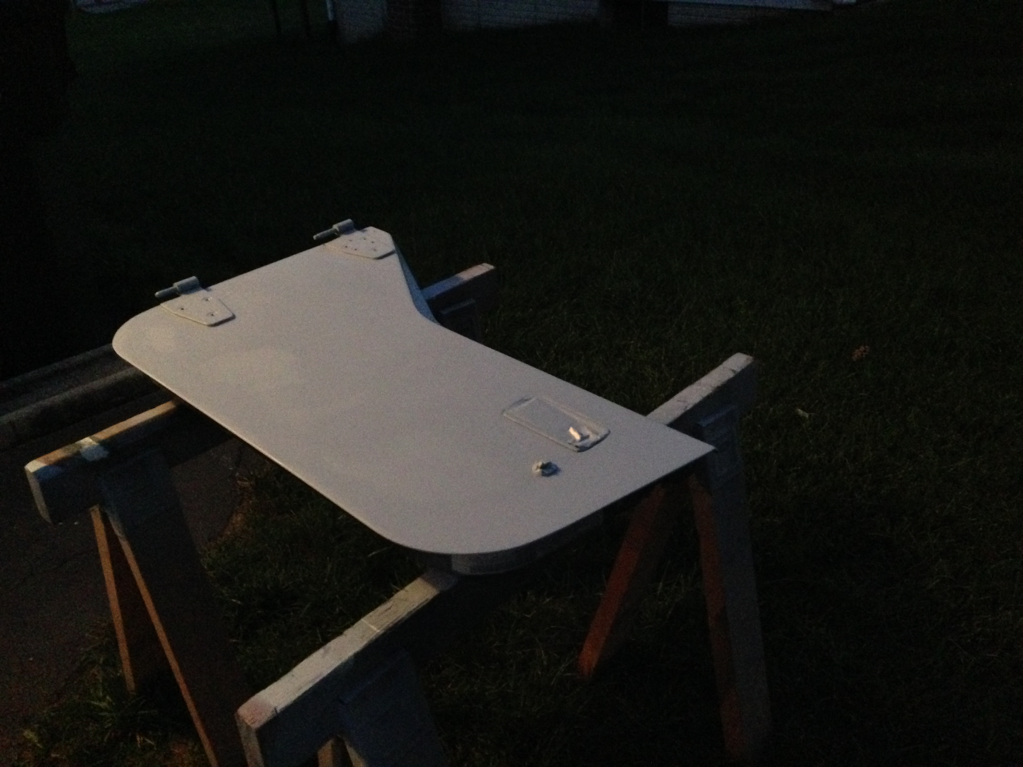

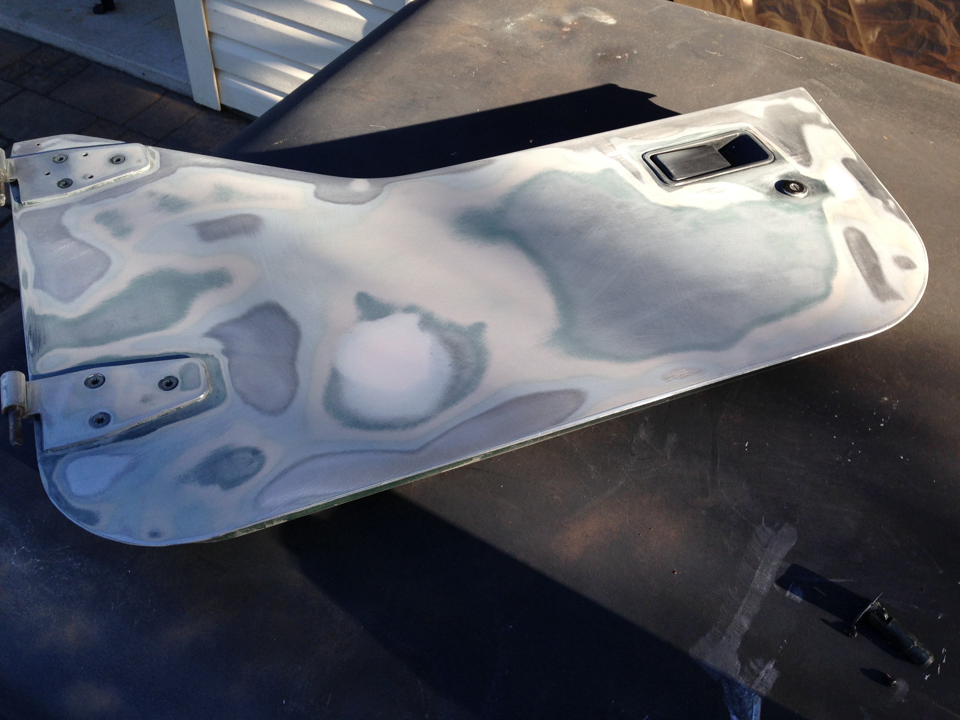

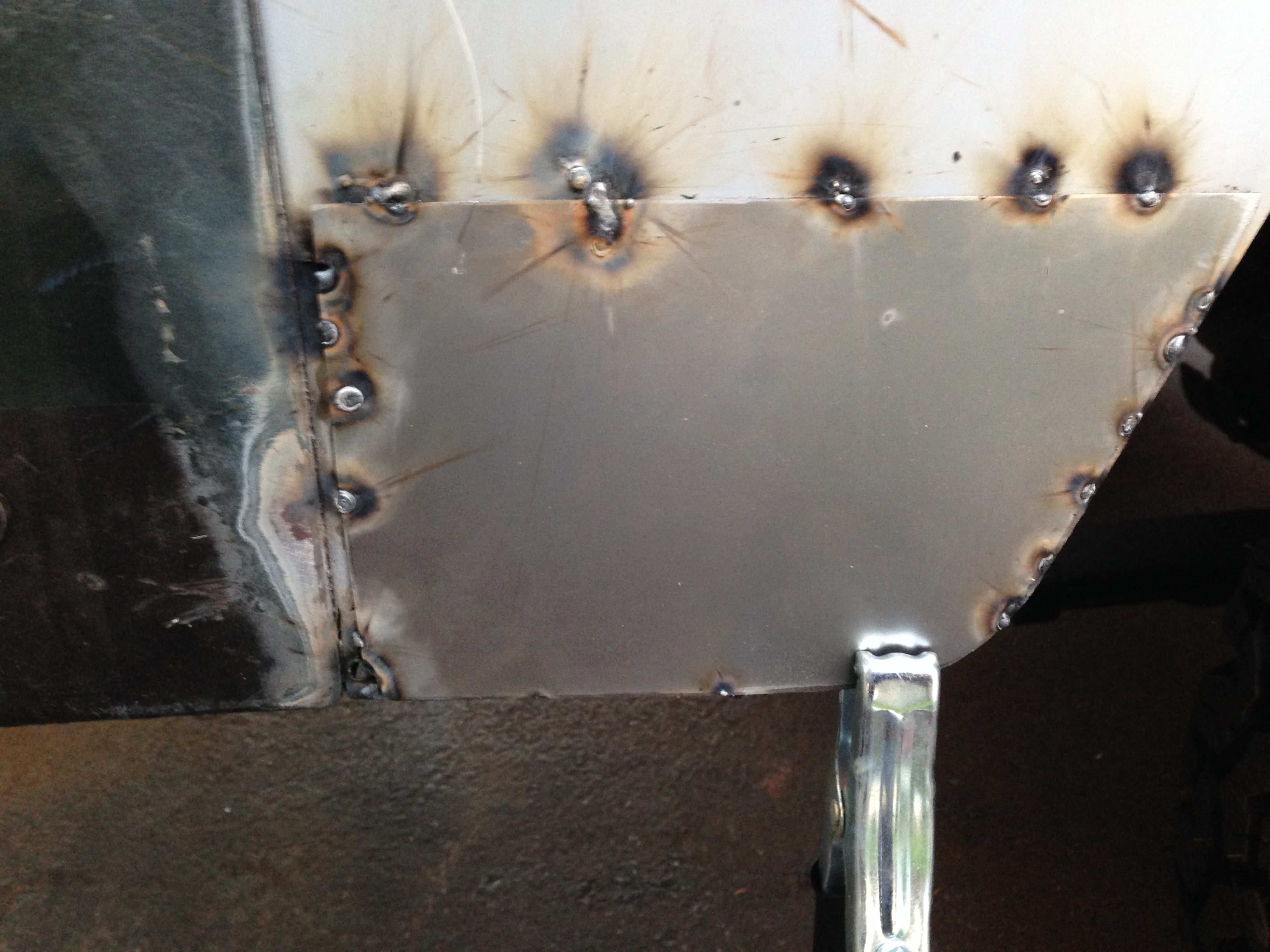

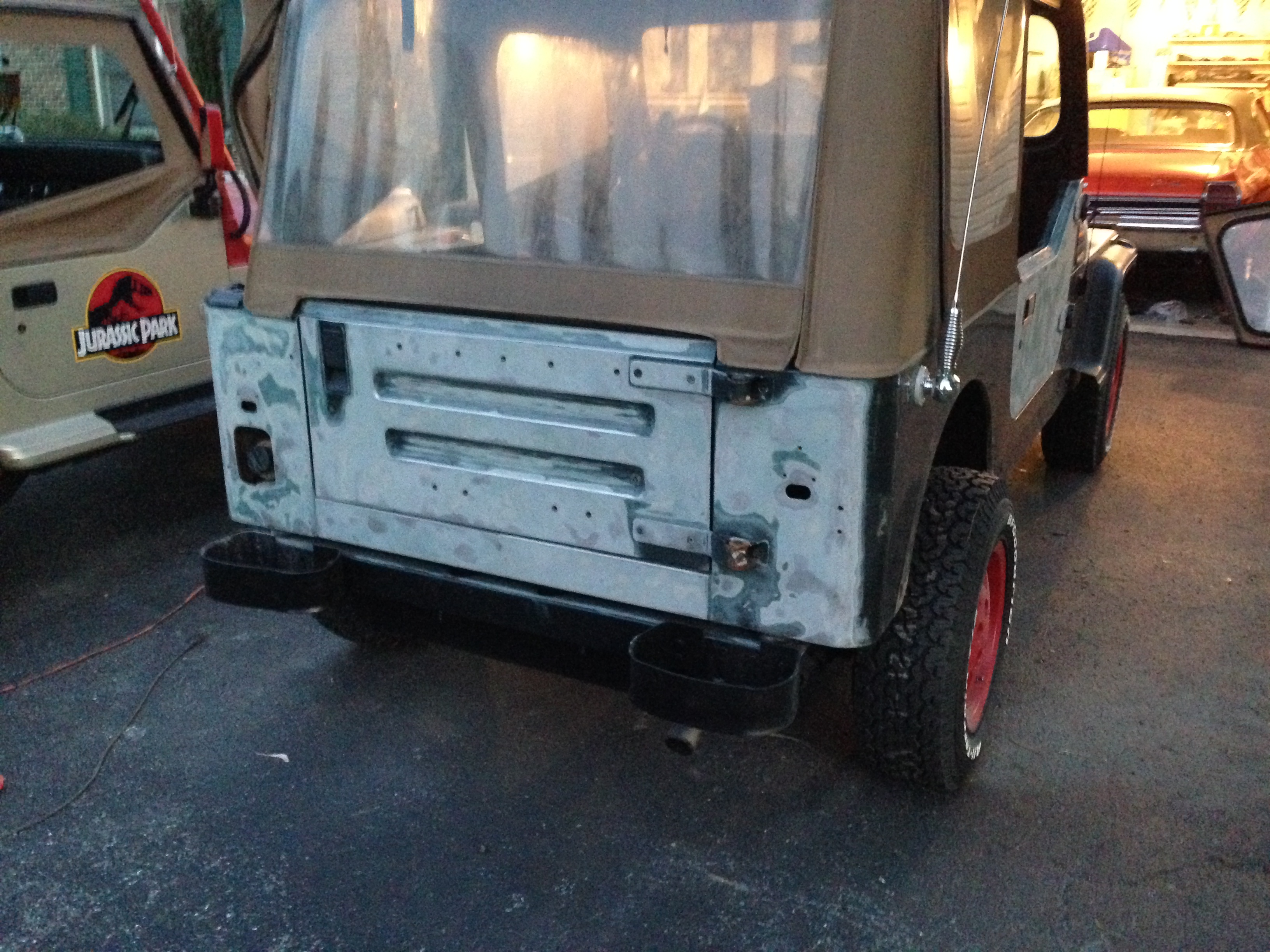

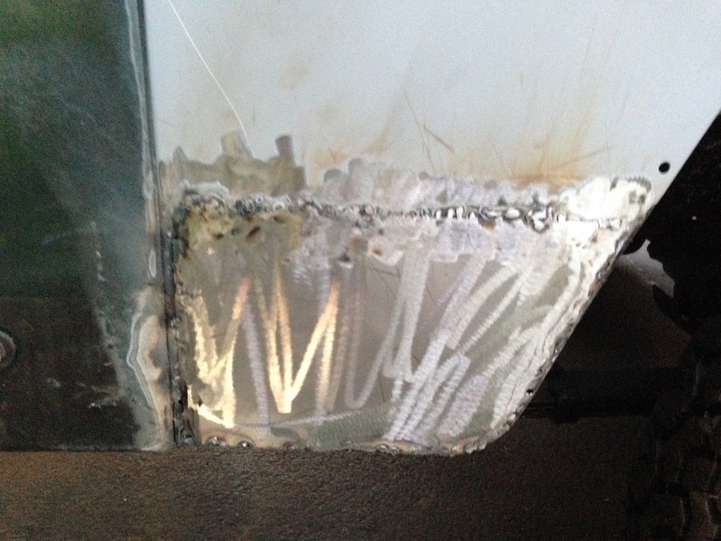

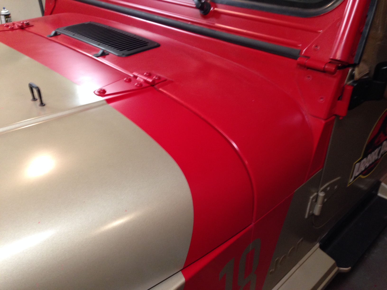

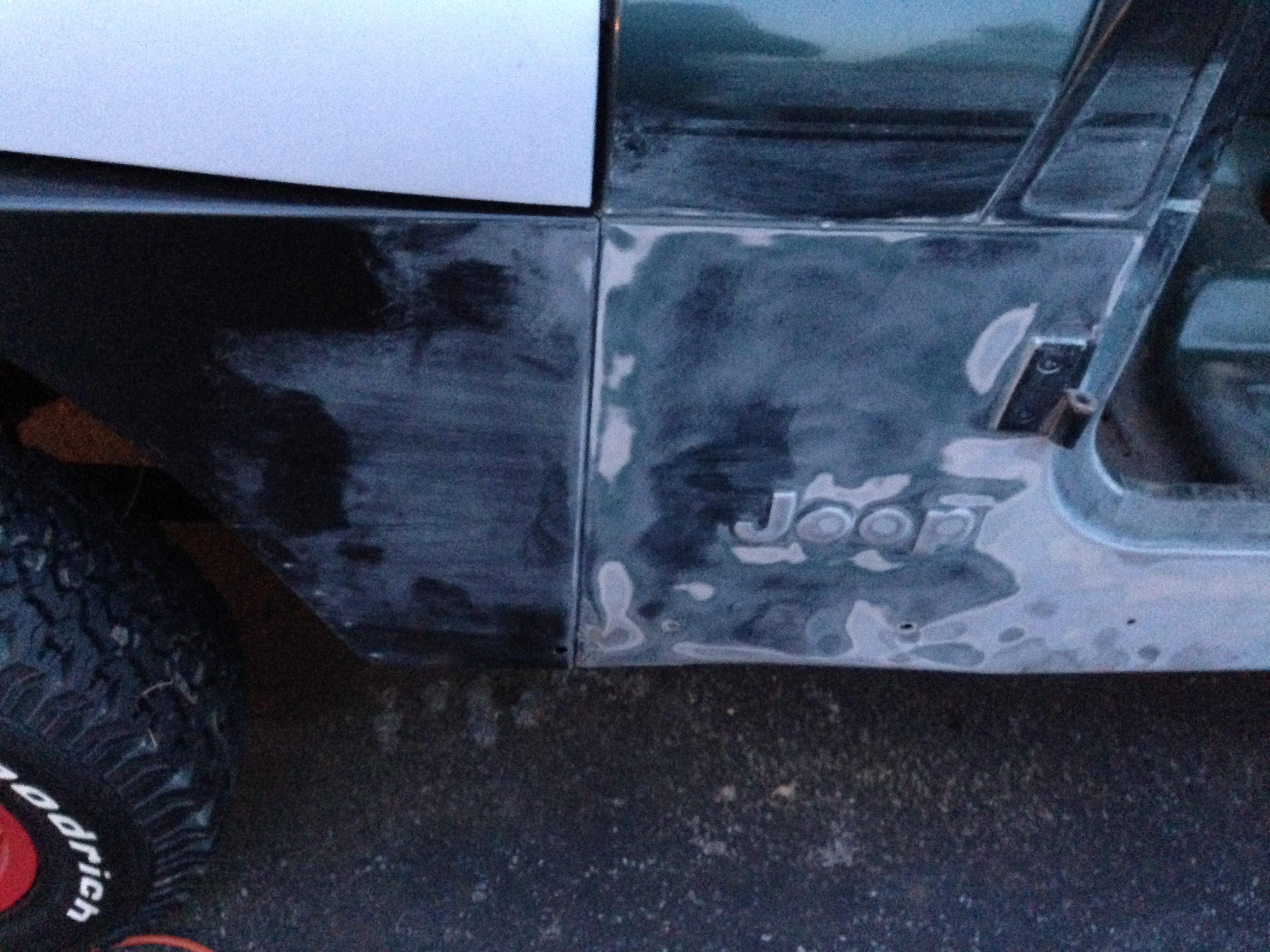

next was the bodywork....not too bad
