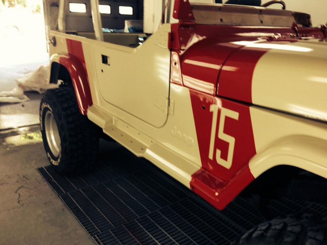

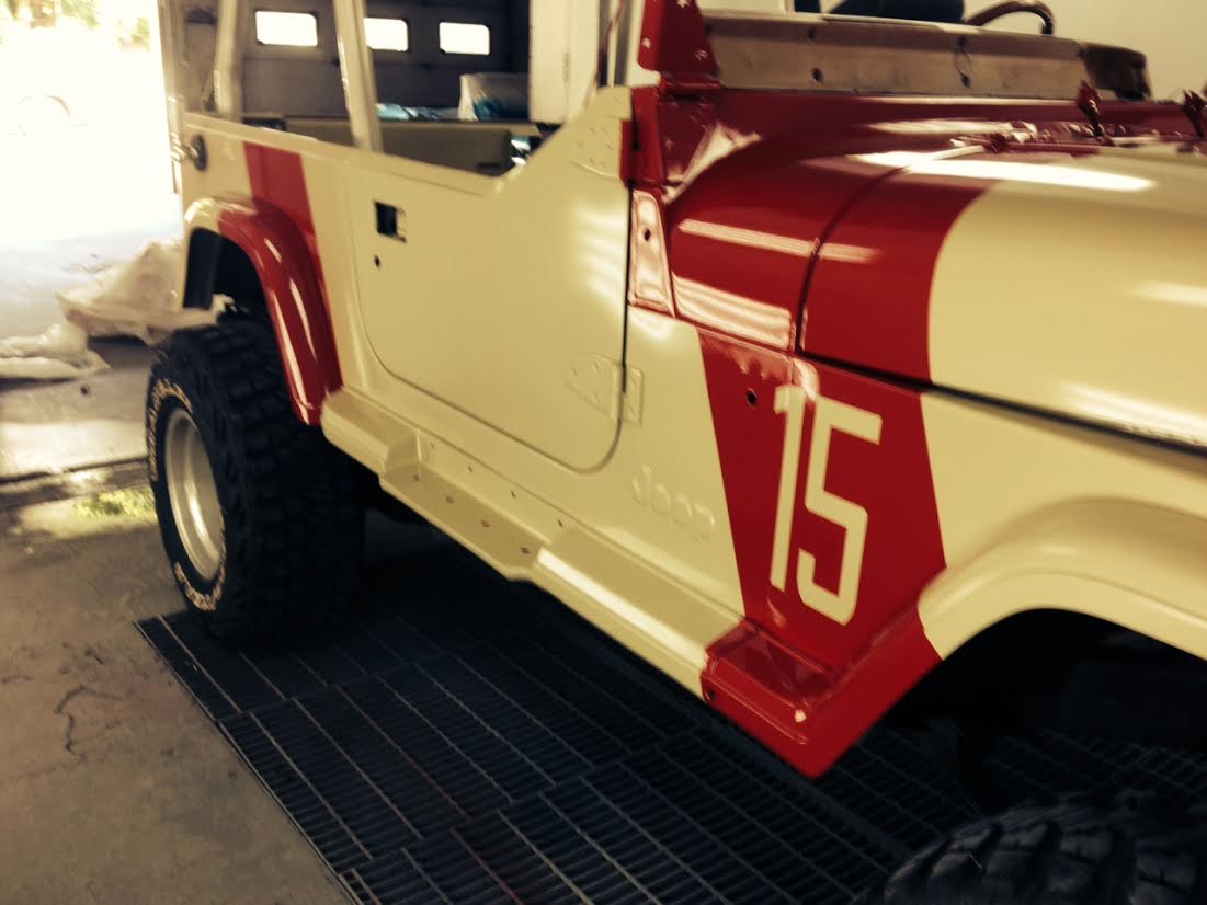

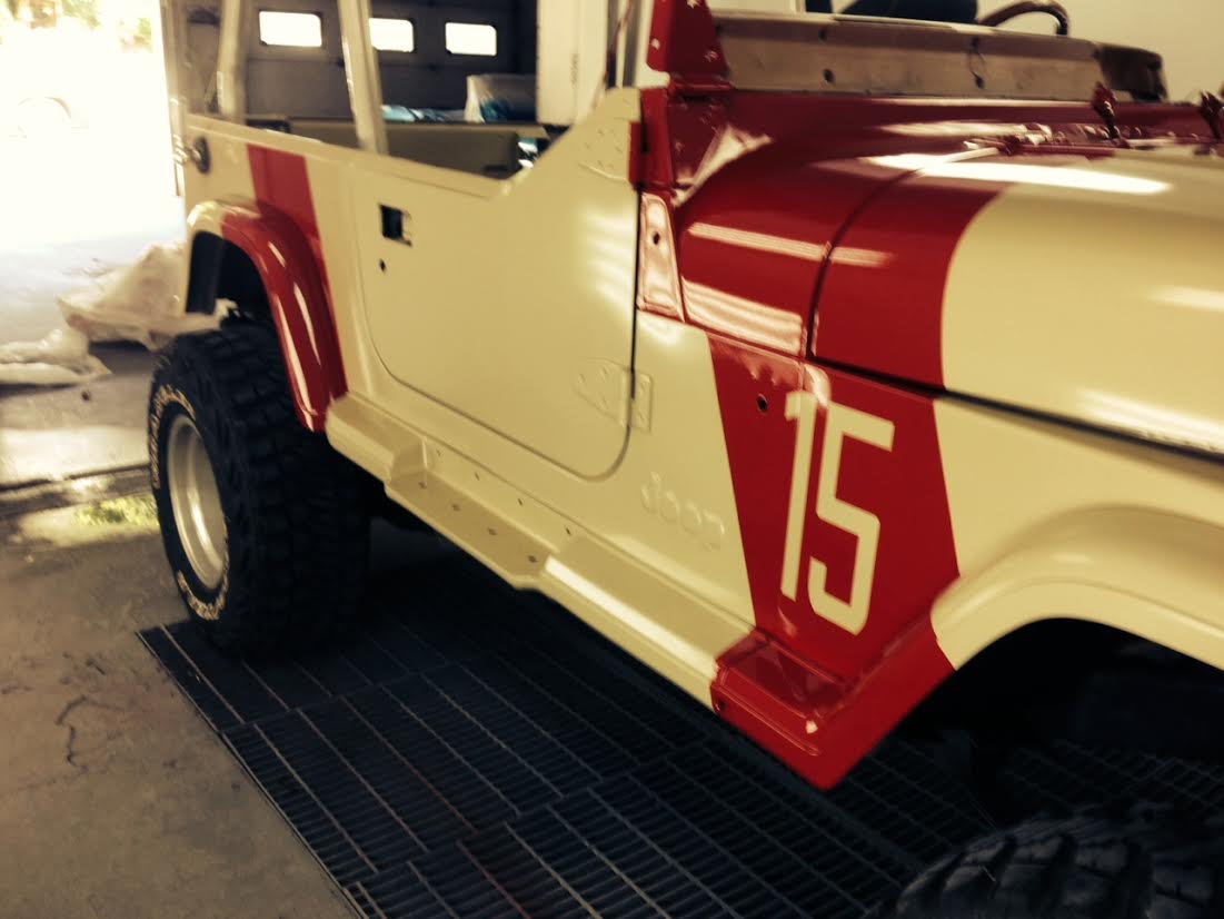

Here it is: the soon to be JP 15.
Anyways, here's the jeep in it's current state I'll use this first post as a sort of current state/table of contents page.

08/14/14 - Logos and decals applied viewtopic.php?f=20&t=1634&start=70#p17938
