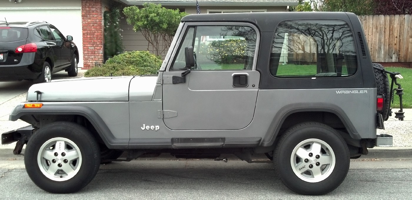

Bought a 1994 SE automatic this week. It's currently my daily driver so I wanted to go with full doors and a hard top. I've seen JP Jeeps done this way and think they look good. Not like I can't do the soft top later. 8-)
I've ordered the front bumper and fog lights. Not a big fan of the chrome grill overlay either. I think that's going away this weekend.
I plan on painting it myself. Shouldn't be too tough.
Wife made me blur her out. Easier than taking another pic!

Good start! I'm a HUUUGE fan of the hard doors and brown hardtop look that a lot of people have been doing. Keeping the door a single color and letting the stripes end where they would on a softtop: perfect! Keep updating!!

It's a good start, thanks. Since it's my dd I had to start with drivability and reliability things first. New tires, alignment, crank & cam sensors, stereo, center console, tow hitch, and cowl seal are all on the list this week. Hope to paint it this summer sometime.
I should probably figure out why it doesn't unlock with the key sometime soon too. :roll:

Nice jeep I also used the hardtop and whole doors like how you were saying you wanted to but I only put them on in the winter then in the summer I put my soft top and half doors back on.

The eventual plan is to do just that, but for now it's going to be just a hardtop for a couple years.
