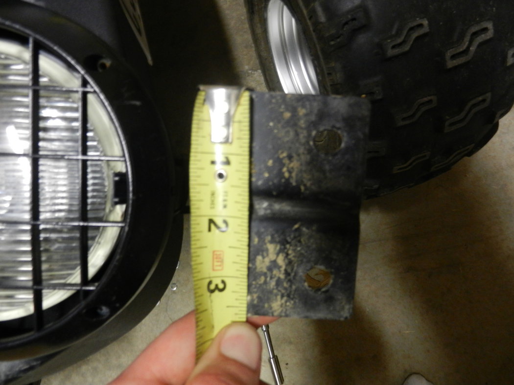

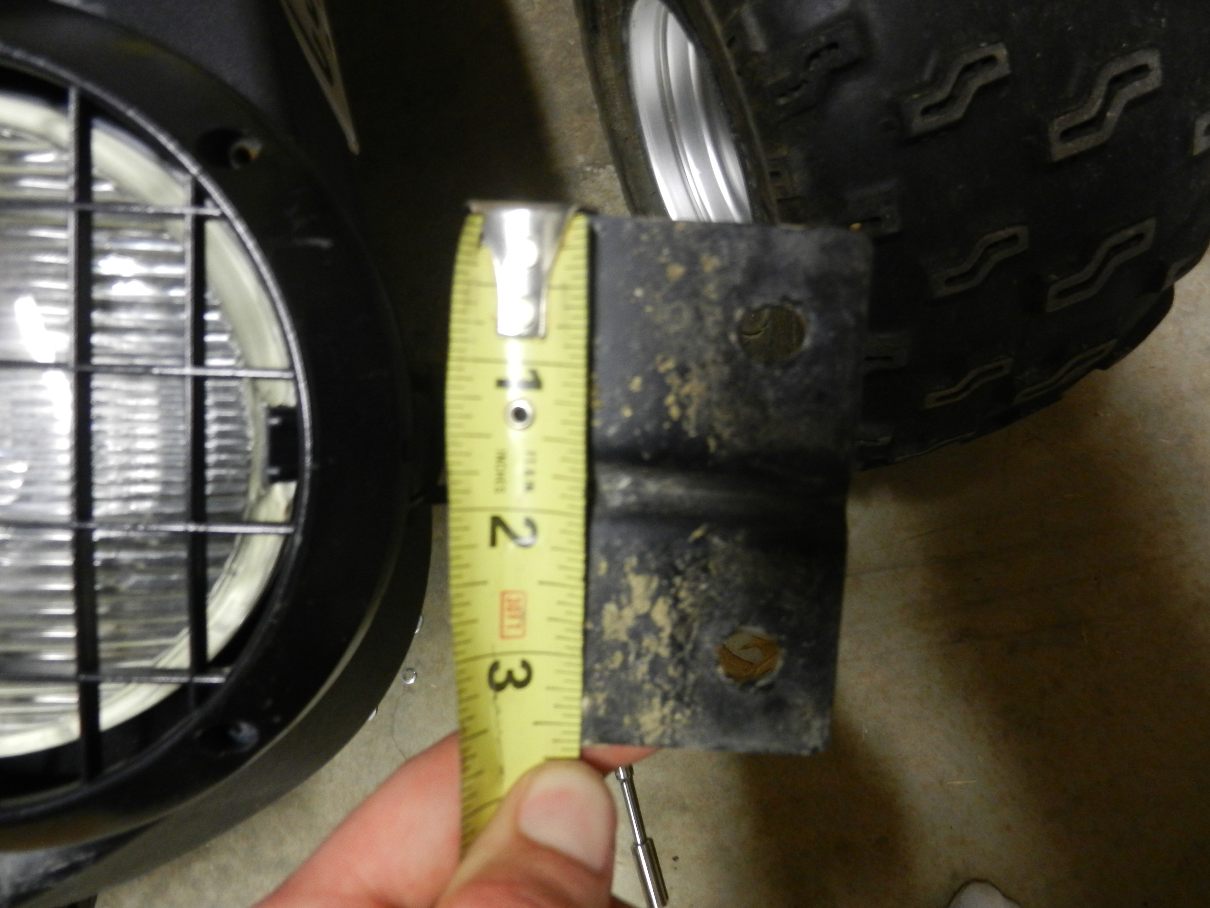

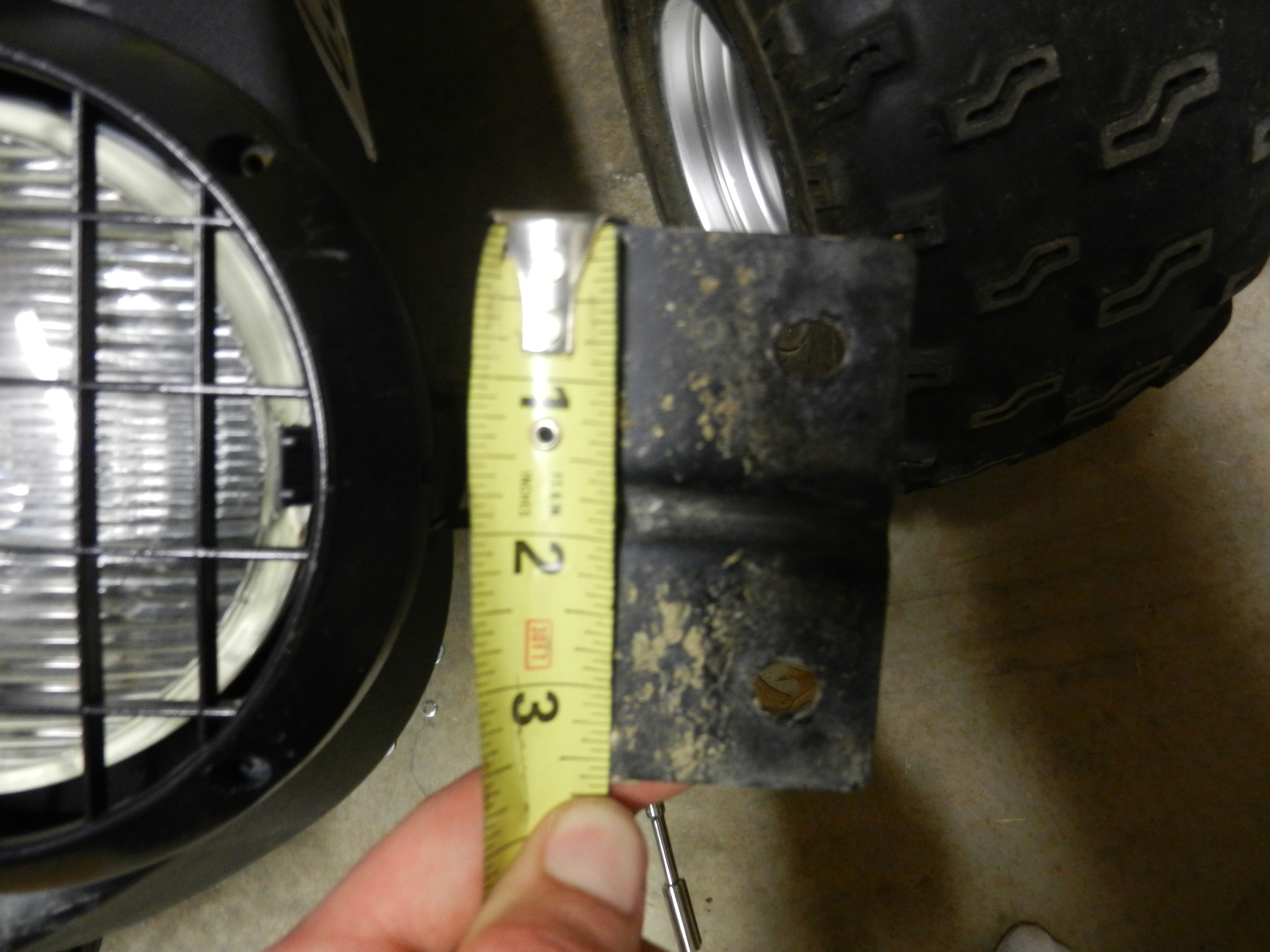

Would you mind taking some pictures and detailed measurements of the mounting bracket? I need the bracket and can have some fabbed for me, but I need the dimensions/measurements. Thanks!

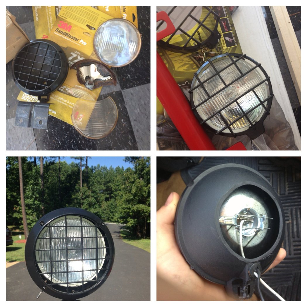

Heres some pics I hope these help if you need anymore just let me know.
kind of hard to tell but it's 3 1/2

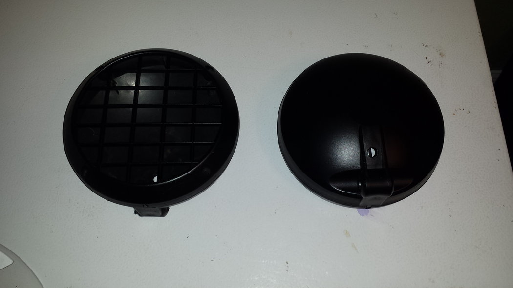

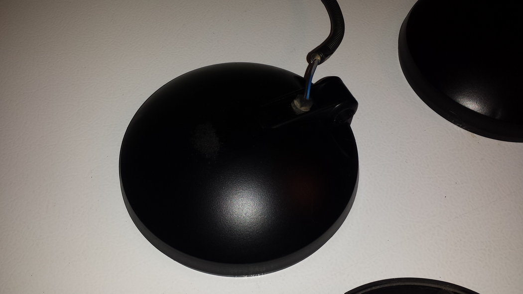

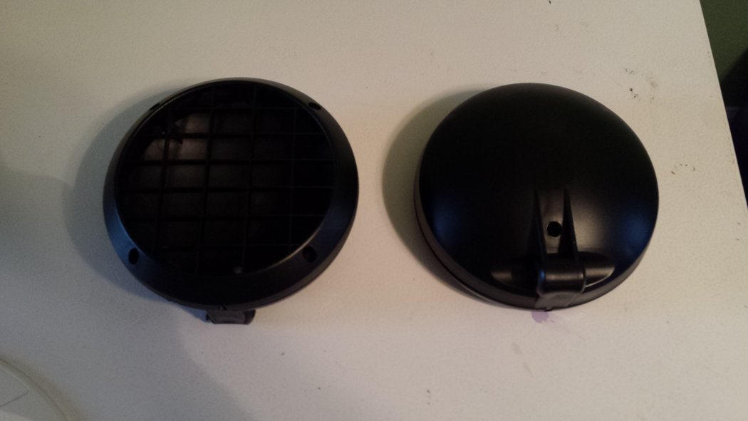

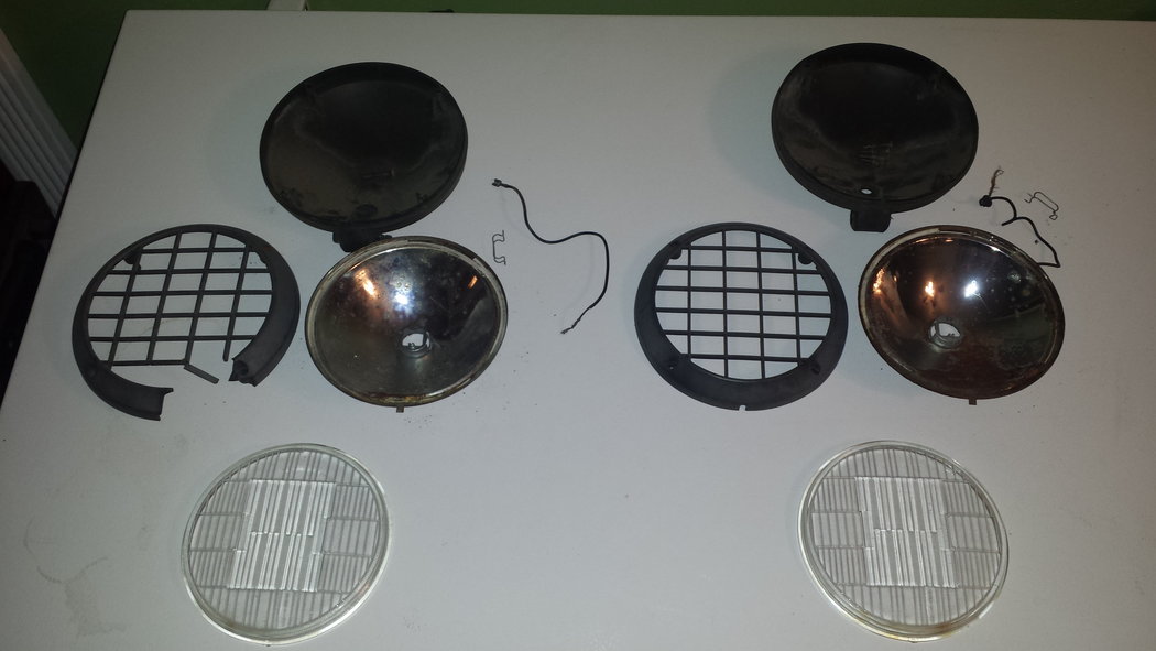

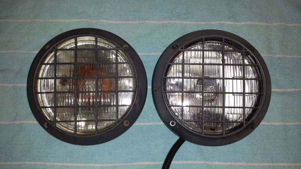

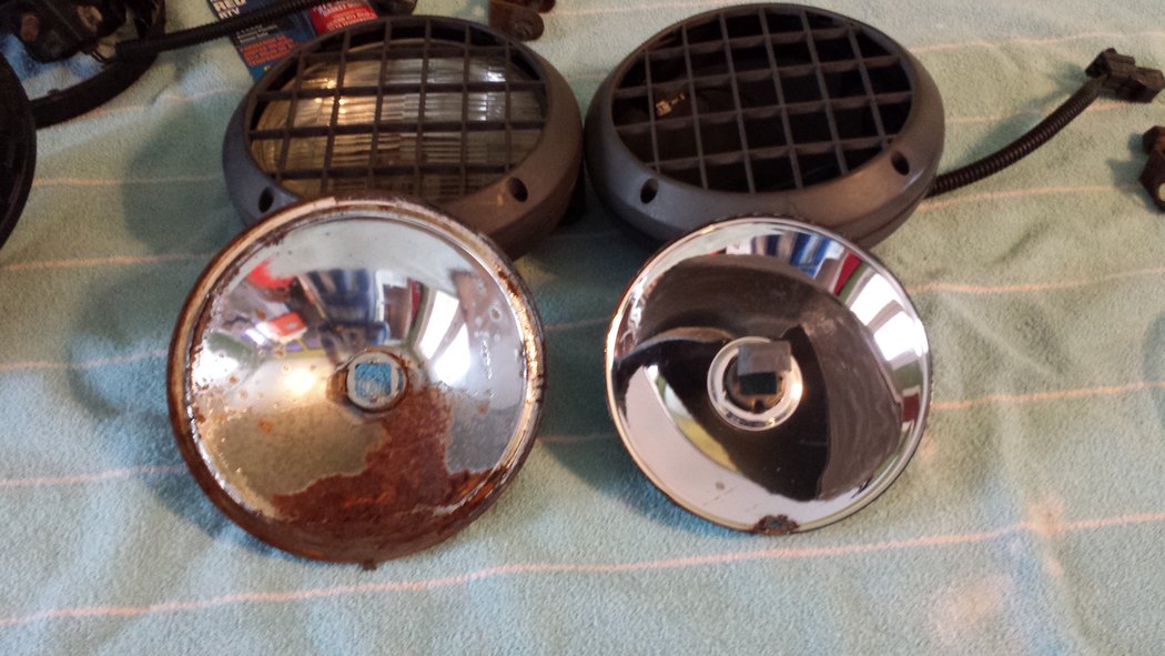

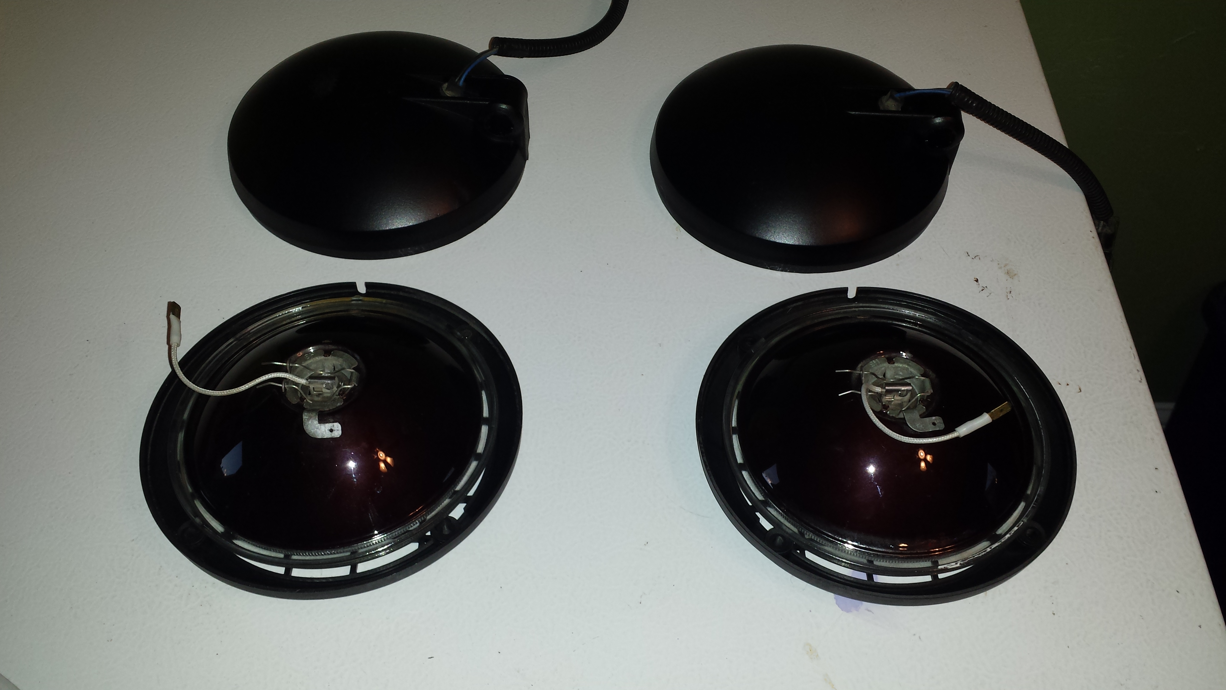

I took the YJ Sahara fog lamps I had received apart today so that I could clean them and see what it would take to fix the lenses and reflectors. While messing with lights #1 and #2 I found on the Cherokee, I noticed that the lens on #1 was loose and was able to pull it apart from the reflector.
Fog lamps found on a Jeep Cherokee
Since I was able to do this I could get a better look at them. As you can see they are not in the best of shape and a good clean and polish alone are not going save them. However since I was able to separate them I think I can take them and have them chromed to make them usable.

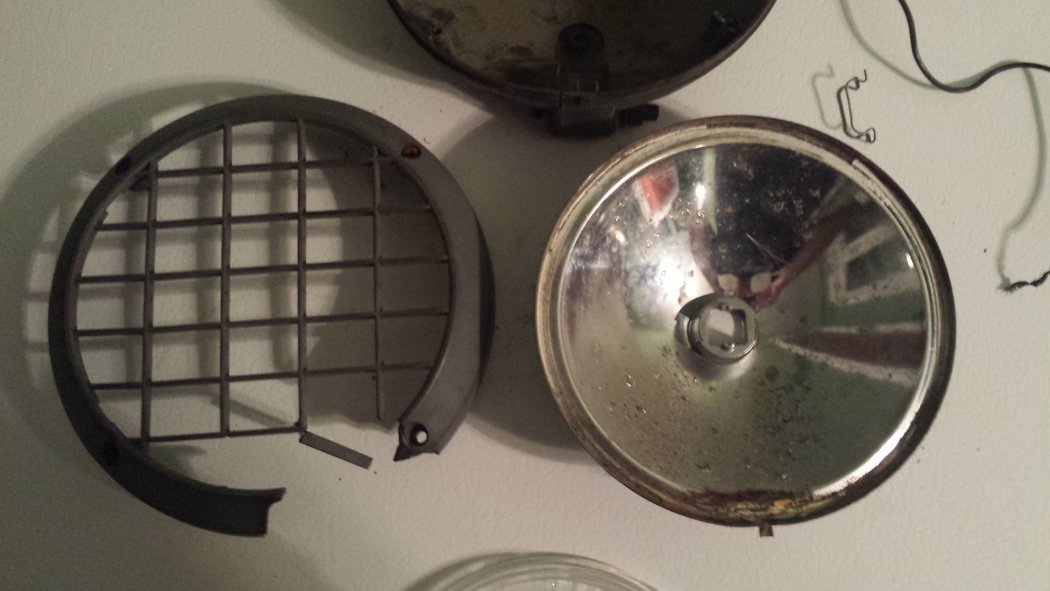

Fog lamp #1 has a broken front and back bezel. The lens is intact and the reflector is in better condition than the other 3.
Fog lamp #2 has a rusted lens and the bezel is in good condition.
Fog lamp #3 came off of a Rio Grande. It has a hole in it from a rock and I was unable to separate it from the reflector. The bezel however is intact and in good condition.

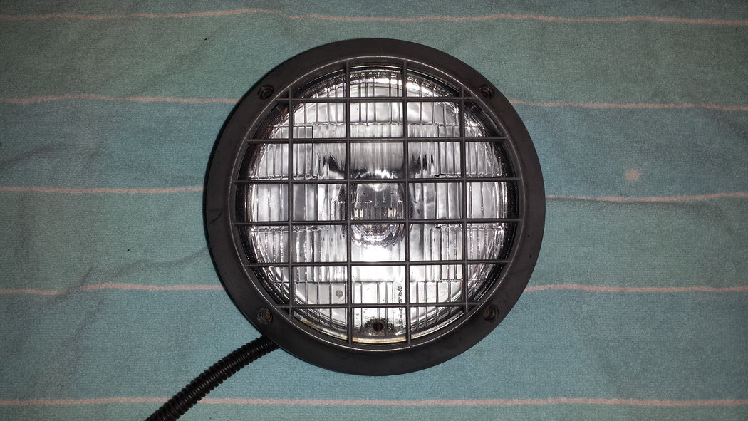

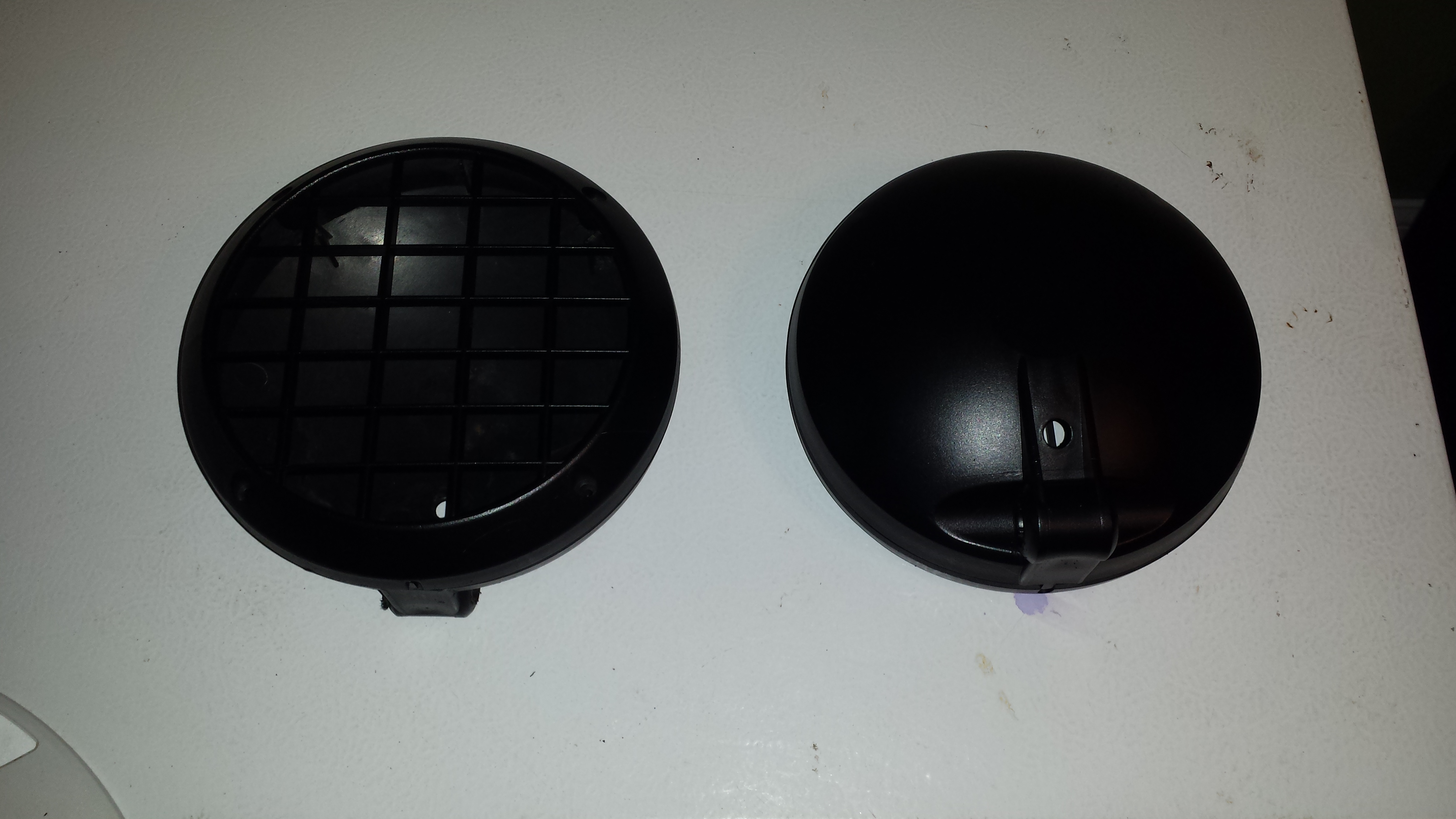

Below are pictures to show how I refurbished the fog lamps I found for my project. I am still planning on having the original lenses re chrome plated, but for now this worked extremely well.
I had picked up a pair of TJ fog lamps from a fellow Jeep club member. I originally did this to see if they could be used as a suitable replacement since the originals are so hard to find. Please see my post on TJ fog lamps if that interests you.

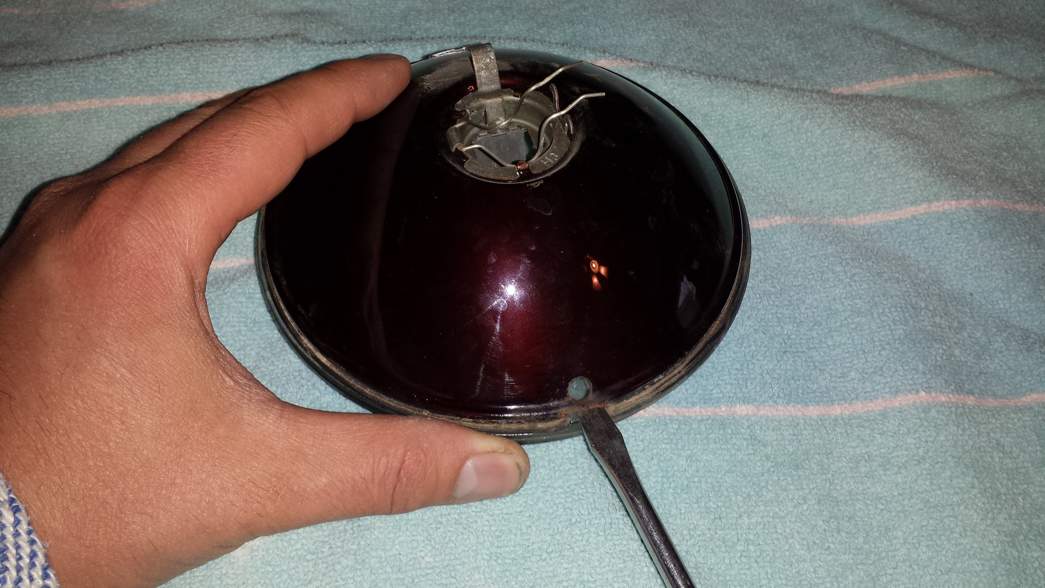

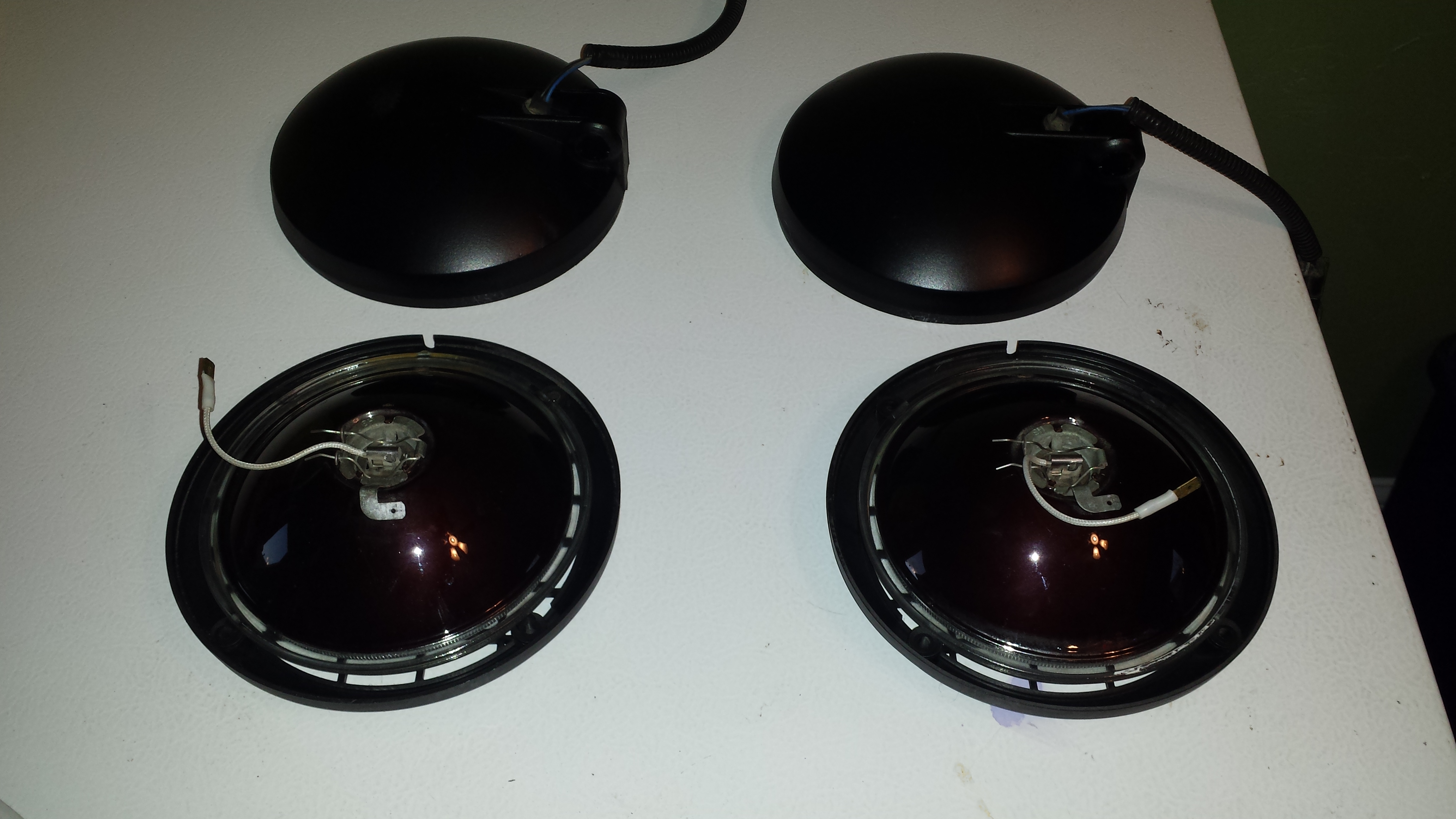

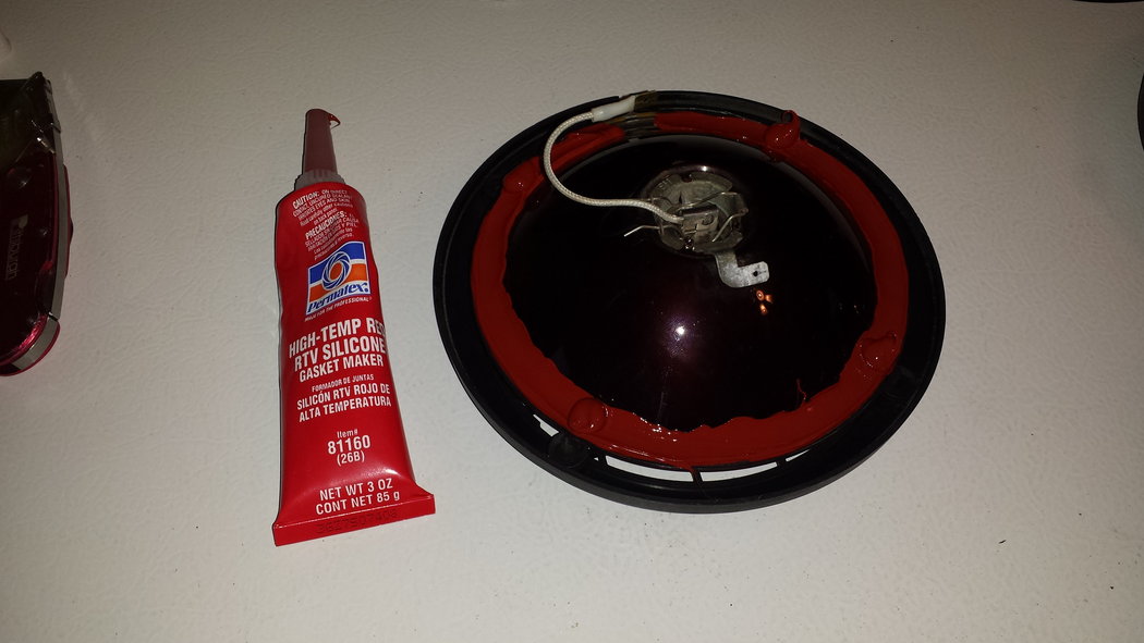

So I had these TJ fog lamps sitting there next to my YJ ones and I noticed that they are not much different in size. So I pulled the lights apart and to my dismay the TJ lens and reflector are quite a bit smaller. So they were not going to just swap out and into the YJ housing. Then I happened to notice that the TJ lamp almost fit inside of the lip of the YJ glass. I took one of the TJ lamps apart to do some more research. If you decide to do this there is a space at the bottom of the lamp that you can get a screw driver or other tool into to get it started. Be careful and take your time. After getting it apart I discovered that IT FIT! I couldn't believe it. So I pushed it into the glass and then stuck the lens into the housing. That is when I ran into a problem. Since the YJ glass fit inside the YJ reflector it took up more space. So as you can see from the pictures I ended up using a high temp rtv silicone to seal the lamp and placed a little extra where the housing would hold the lens in place. It worked extremely well. I had to position the lamp up against the front of the housing before putting it together, but that wasn't too hard. I did paint the fog lamp housings with a flat black bumper and trim paint I bought at Orielys before putting them together. Hope this helps someone else out. Oh by the way I found out that the YJ glass lenses are a much higher quality than the TJ ones, but the reflectors rust easily.
TJ lamp on the left YJ lamp on the right.
There is a small space right under the drain hole.
After getting it started you can run the screw driver around to break the seal.
YJ on the left and TJ on the right.
The YJ lens with the TJ reflector placed inside.
Before picture
Before picture
The after picture with YJ fog lamp with YJ lense and TJ reflector.

Here are a few more pictures from the refurbishing process. One of the TJ reflectors has a dark spot on the bottom you can see in the pictures, but still a considerable difference.
Before and after comparison with the TJ reflector.

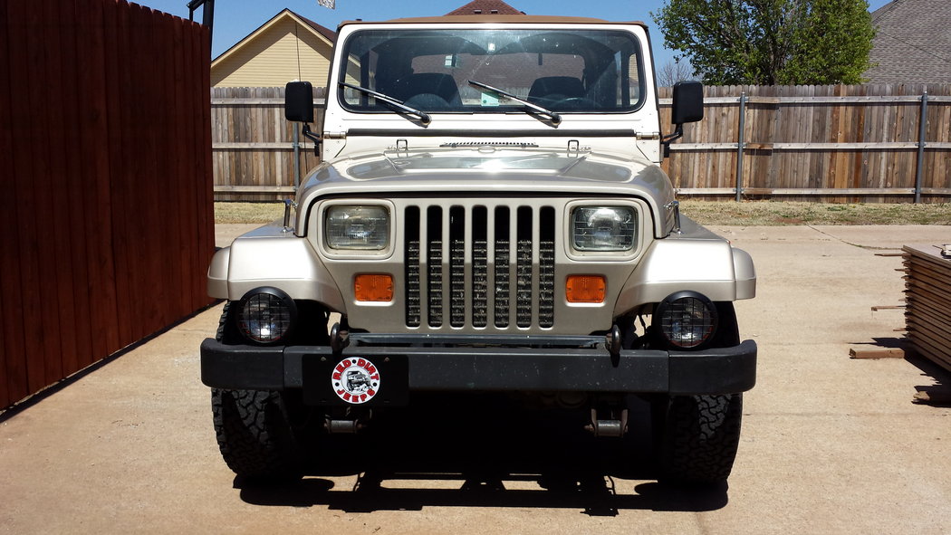

Post by ScottWarrior » April 14th, 2014, 7:35 pm

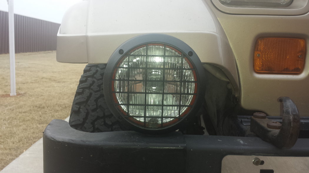

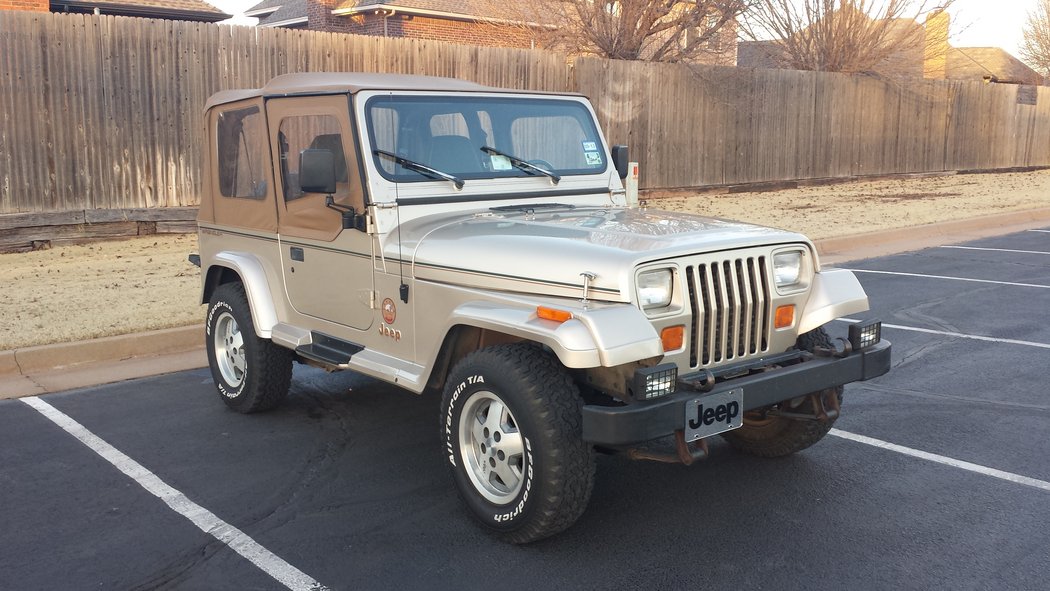

And here are the pictures of them finished and mounted on the Jeep. Such a big difference from the cheap rectangular ones. It looks like a completely different Jeep. The lenses worked so well it made me realize how crummy my head lights were. So I am getting a new set of Sylvania SilverStar headlights to make them look better.
Also if you noticed since the reflector went inside the lens you can see the red silicone around the outside of the lamp. At first I was worried about this, but then I think it will tie in once the Jeep is painted. Obviously if you are doing this and don't want the red then you can find some other high temp silicone that is a different color.
