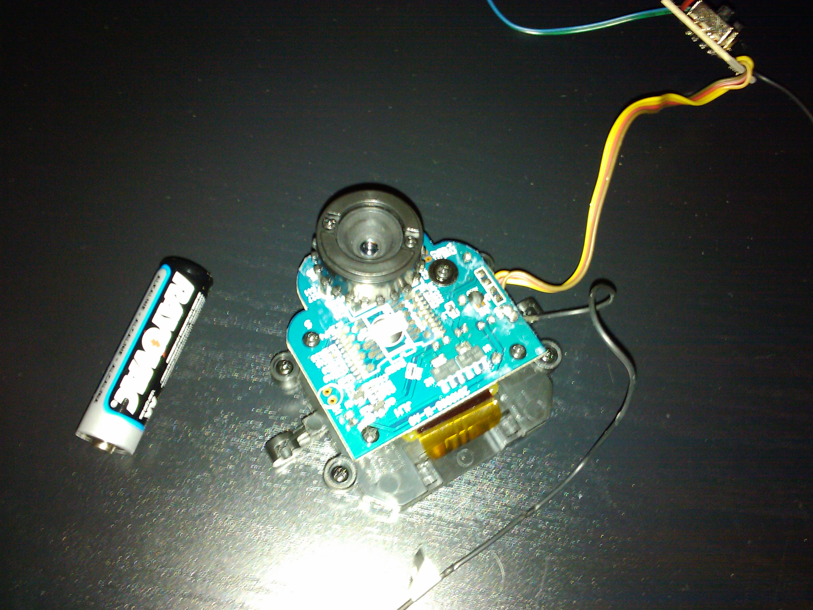

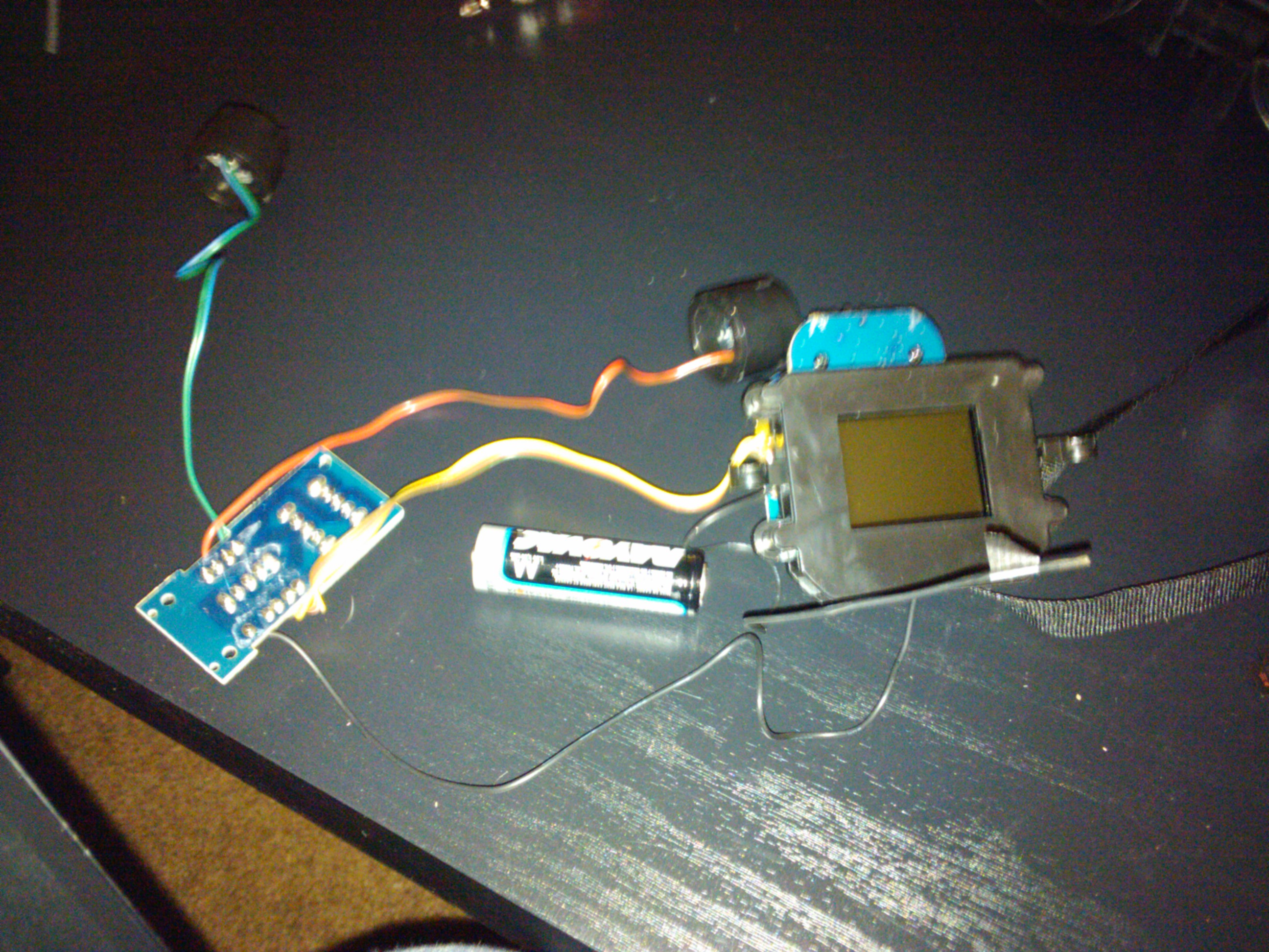

and here's the guts of it. There's a small ccd chip underneath that lens. It'll take quite a bit of work, but I think it will be possible to build the lenses to focus light onto that ccd. If not, I could always make the lenses just have dummy lenses in them and hide this thing inside. There's a small, probably 1.5" lcd on the back side that displays the image in B&W, green, red or blue tinted. It does surprisingly well in the dark, with the IR illuminators.
