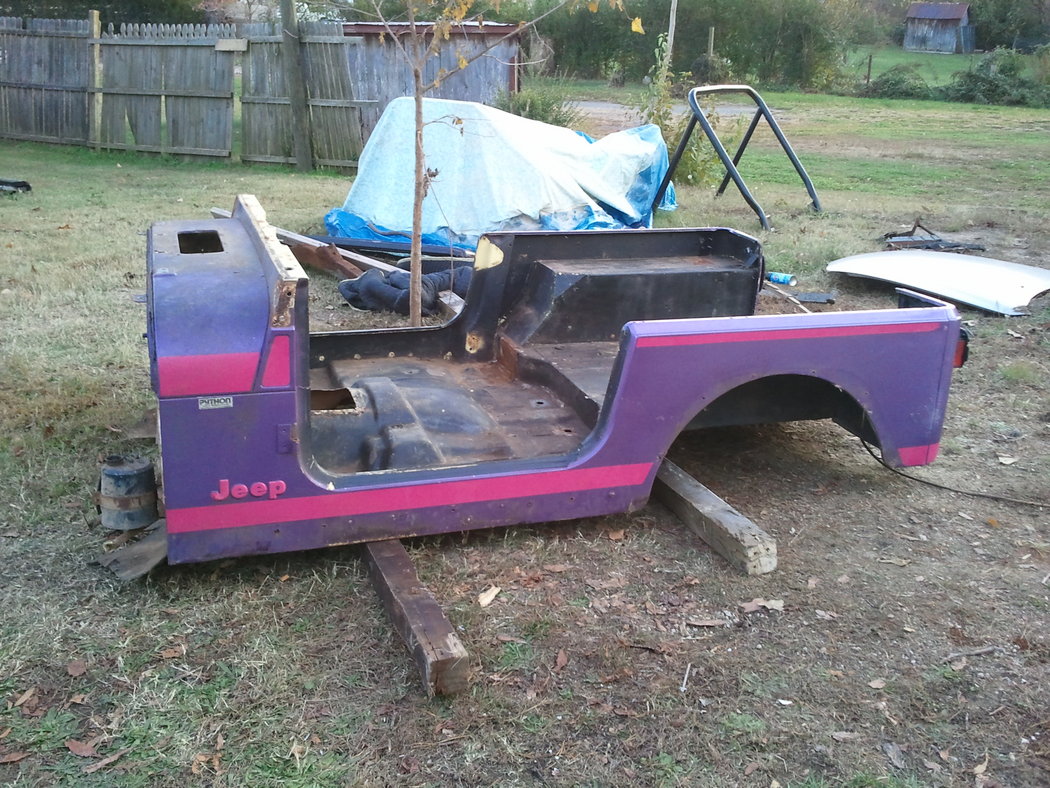

The Tub, It has a little rust. But is a big eye sore till I get it totally in primer.

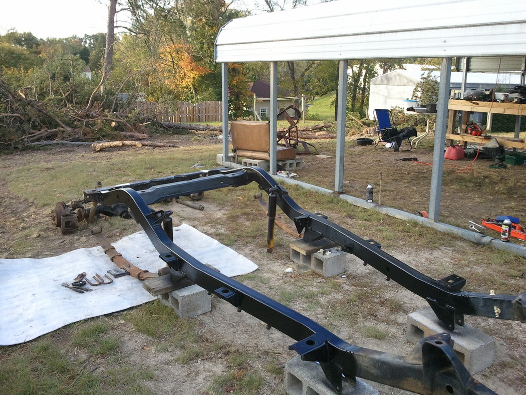

The Frame
The Frame

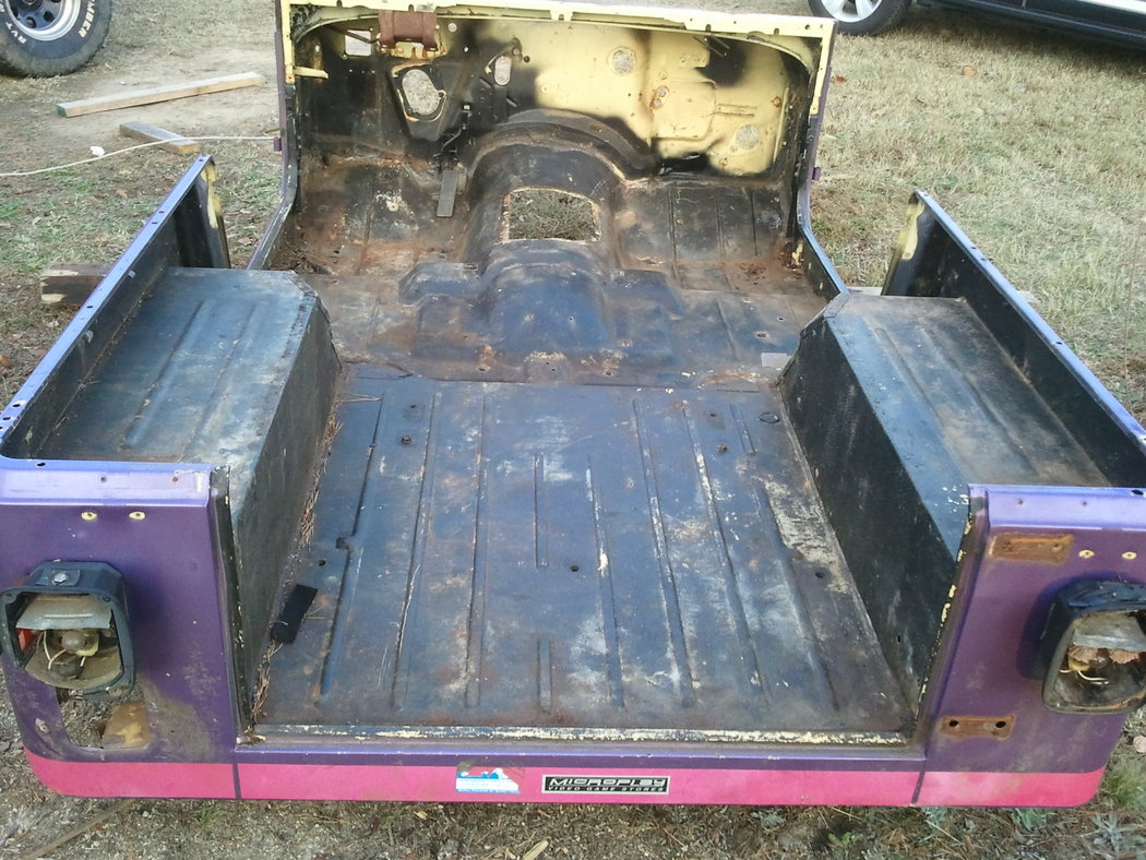

Rear view of the Tub

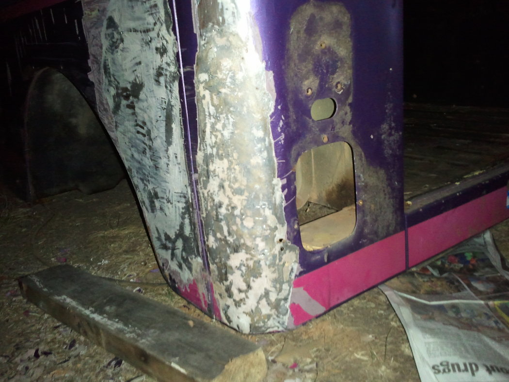

Some Bondo 1/2 inch thick was removed

Yeah, Barbie Jeep came to my mind when I seen it. The former owner was military, so I woul hope it was a female. A local guy here was parting it out. I got it and a insturment cluster and a few small parts from him. I will be happy to see it in primer, and all the body work done.

Any one know of how to strip the paint quicker then sanding or wire brush. Lol, my backs killing me.

Have you tried aircraft paint remover? I think they even sell that at Walmart in the automotive section by the paints.

I am going to pick up some AirCraft Stripper Monday. I priced it, lol cheaper for a gallon then a quart.
