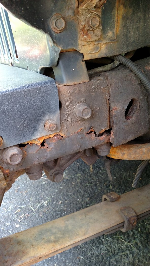

stress fracture from the steering box

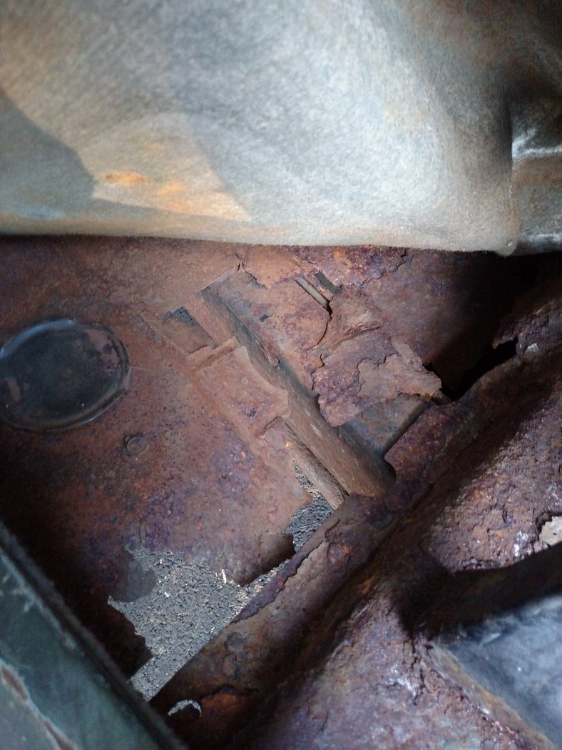

no floor under the driver side

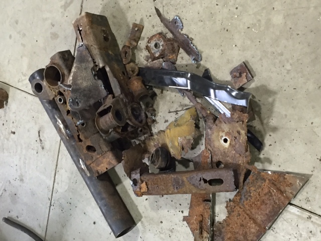

Replaced all 4 corners of the frame
Frame rust pile.JPG (123.08 KiB) Viewed 24225 times
The weather is finally warming up so it's time to hammer down on the Jeep build.
I had all 4 corners of the frame replaced and a new floor pan for the driver side.

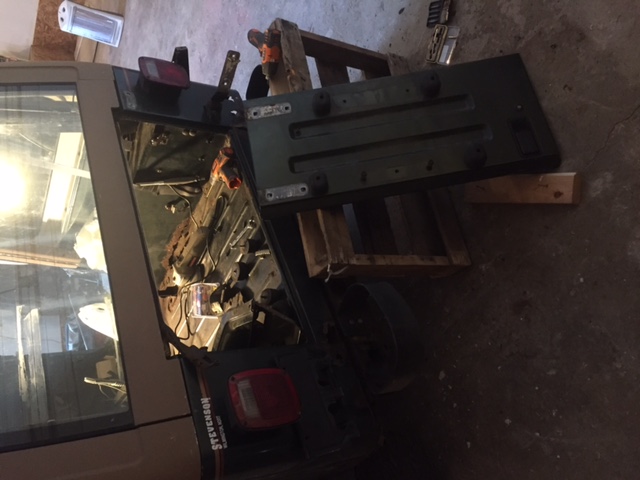

replacing the tailgate
tailgate off.JPG (84.3 KiB) Viewed 24225 times

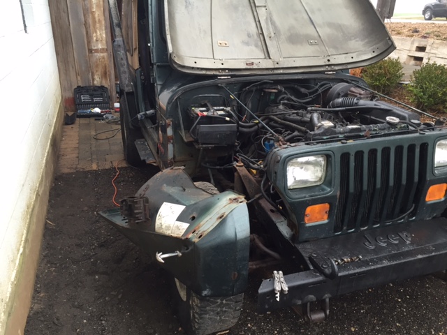

replacing both front fenders
pass fender off.JPG (124.26 KiB) Viewed 24225 times
The original tailgate was rusted through so I bought one a used one in much better condition.
Got used fenders that weren't rusted through that I'll put on after I paint them.

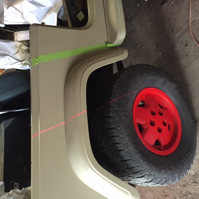

Got some paint on (Rustoleum Fossil and Rustoleum Apple Red)

Thanks, glad i'm not the only one that thinks it looks good! I put a lot of time in sanding, painting, resanding and repainting to get rattle can to look really good!
For the main color i'm using Rustoleum Fossil color. From what I found, the correct Sand Beige is Red 167 Green 161 and Blue 125, Fossil is Red 174 Green 167 and Blue 138.
It's the closest color I could find in a can. I know someone else on here used Rustoleum Camo Sand and that is Red 182 Green 175 and Blue 147 but still looked close to the original sand beige.
For the red I'm using Rustoleum Apple Red, which is what a lot of people on here seem to have used (including JP Motorpool via their YouTube of wheel painting).
As for time, I actually got the fenders and tailgate off a month before but didn't want to post till I knew I would start working on it regularly as I have been. Now I'm very limited by the temperature on which days are warm enough to paint, so I do all my sanding and prep work, then on warmer days leave work early and get a couple coats of paint on. Also, I want to finish asap so I can be considered for one of the last 2 vehicle slots for our local Comic-Con this fall.
I'm going to paint the doors, tailgate, and rims last since they are small enough to be brought inside.

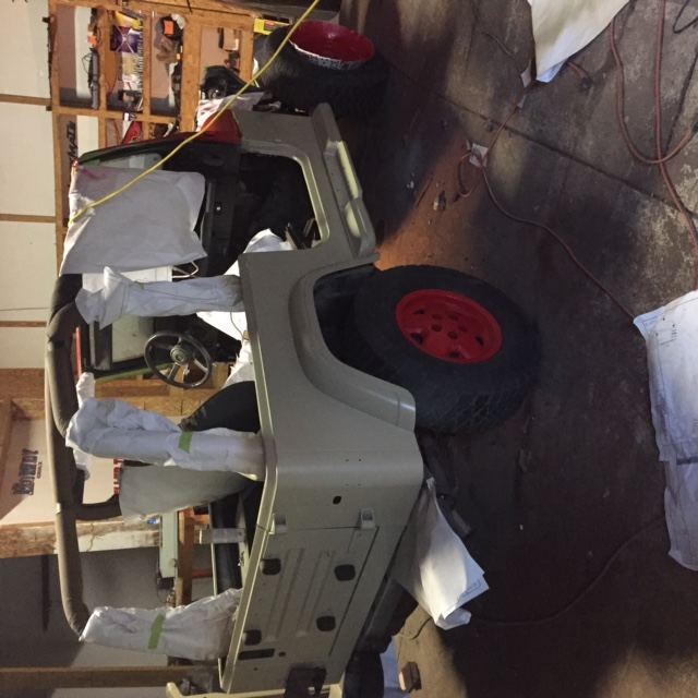

10 body paint.JPG (133.06 KiB) Viewed 24118 times
09 body paint.JPG (145.72 KiB) Viewed 24118 times

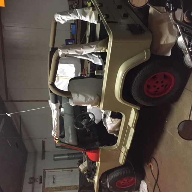

Painted the main body!
Painted the tailgate.
Got a couple tires painted.

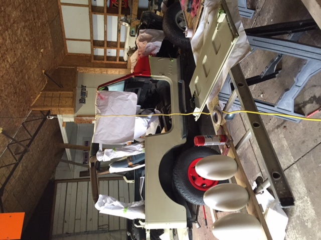

Bought 3 large easter eggs from target and painted them to be dino/raptor eggs.

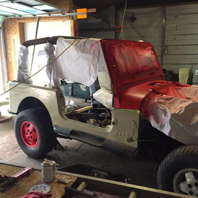

Tailgate on, Rear Flares on, Left fender on, all rims painted!
