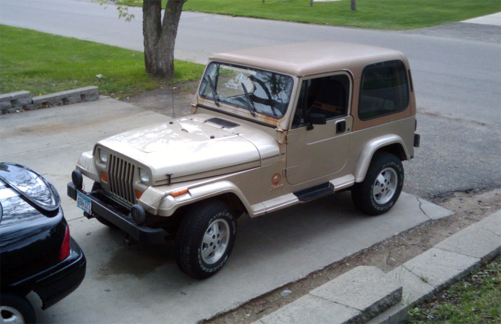

Thanks for the help guys. This is the start of my build. It is a 1993 Jeep Wrangler Sahara.
I purchased this car today for $4000. Its quite a bit of money but it is probably worth more. The previous owner had a lot of work done to it and provided me with receipts for thousands of dollars worth of work rannging from the clutch, to brake lines, and frame repair. It only has 73,000 miles on it.
Came with full hard doors and a hard top. The first owner may still have the half doors and soft top. I hope I can get my hands on them. There is a bit of rust as you can see, but it is all quite basic. The worst is on the windshield frame and on the full doors. I will be cutting out metal when I can (or replacing parts). It will all be repaired right.
After purchasing the Jeep I brought it over to my buddy at Tires Plus and we did an "Inspection". Went under it and found some parts that need to be replaced such as the steering damper, sway bar links, transfer case seal and rear axle seal. I wanted to take a look at the parking brake and find out why it wasn't working properly. Turns out the parking break was SEIZED ON in the driver side drum. The brake was getting hot. We just cut the line and it released the brake. Problem solved.
Noticed the frame has some rust where the rear leaf spring attaches. I hope that will be a easy fix. Do they have frame end kits I can buy to weld on?
We checked the oil and it was rather low. So we also did an oil change. Now the car has a slight knock, but I think it will be ok.
After repaying my buddy at Tires Plus with food, we hung out in the parking lot and figured out how to disable the seat belt buzzer and get the lights to work. I guess we were at it for a little while the battery ended up dying and I had to push start it.
Time for a new battery too!
Overall, I am loving this thing.

I found frame repair sections. There were some expensive ($250) sections that were boxed in, or some cheaper ($100) plates that you weld to existing metal. I opted for the cheaper ones as there is still plenty of metal to secure to.
I haven't driven the Jeep since the day I bought it (Thursday) because the battery went dead. I wasn't happy with the battery connections (they were old and rigged in there) so I worked a bit today to replace them. In the process of doing that I had a rusted stud that refused to come out, so I had to cut a wire. I could have been driving the Jeep today if that had gone smoothly.
The last few days have spent scouring information on JeepForum, this JP site and on parts supplier sites. I have spent quite a bit of money on some parts that I need / wanted such as:
-Rear Fog Lights (The amber driving lights). I went with the Pro Comp 100 4"x6" amber fog light. I will be replacing the bulb with a lower wattage lamp and then wiring a flip switch to allow for switching between red and amber.
-Front Fog Lights. One of mine was missing the lense / reflector assembly. Replacing this with a factory one would have cost quite a bit of money. I decided to go with the Delta 150 Foglight. It is a pretty close match for the factory light, just a little bit thicker I presume.
-Fenders. I found a company that claims the fenders they sell are OE quality. If they are not, I will be returning them and attempting to get my money back.
-Soft Top. I managed to find a Spice Bestop top here on Craigslist locally. It has quite a bit of hardware (2 of everything) and a decent top. I picked it up for $200 which is a great deal.
Looking for:
-Half Doors. Saw some on eBay, probably will be out bid even though they are up to $400 right now.
-Windshield Frame. I really don't want to buy a aftermarket steel frame. I am trying to find a used rust free frame. Currently bidding on one, but its already up past where I really want to pay.
Future Steps:
I have a bit of maintainence to do. Hopefully I can get it all done tomorrow. I have the battery, steering stabalizer strut, rear axle seals, TC output seal, and fluid changes for those.
Now that I have a soft top, I want to pull off the Hardtop and install the soft top hardware. That will require a lot of cleaning and painting of the parts as some of them are rusty. I hope there is enough components to make atleast 1 good set of hardware.
But before I put the soft top on, I want to pull the rollcage, seats and carpet and Herculine the floors and interior. I am pretty sure my floors are rust free (atleast no holes). So I want to keep it that way. I figure 3-4 coats of Herculiner should do the trick. After that is done the carpet will go back in. (I really like that look of that!).
