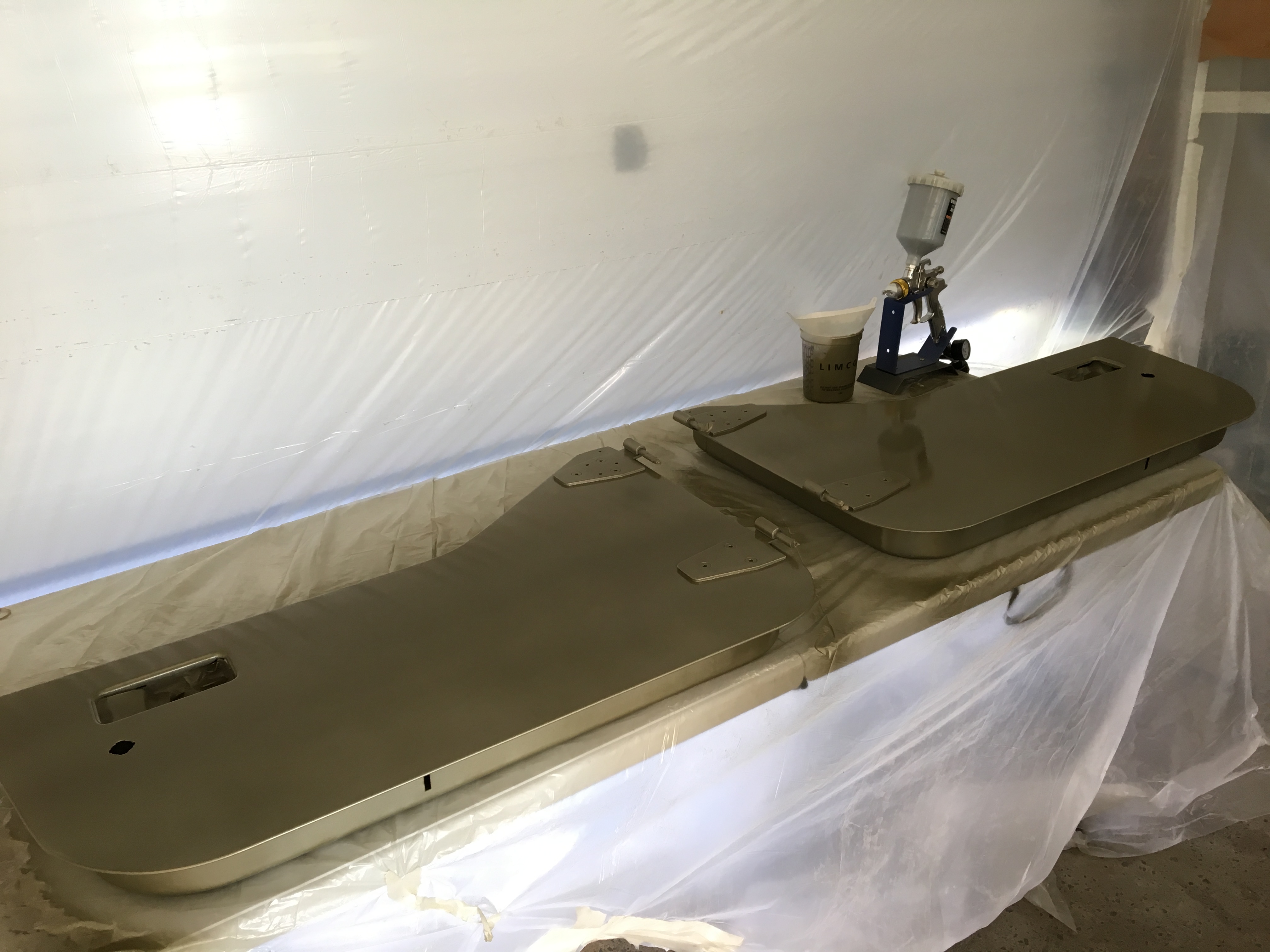

Paint Specifications:
[Ext. Beige] Limco MM217.40 Basecoat (LJ1 Sand Beige Metallic Poly Substitution) - 1 Gal
[Ext. Red] Limco M6564A Basecoat (M6564 Ford Performance Red) - 1 Quart
Limco LR12 Reducer - 1 Gal
Limco LVC10 Clearcoat - 1 Gal
Limco LVH10F Hardener - 1 Quart
Limco LF10 Flattener - 1 Quart
Evercoat Dura Build Acrylic Primer Surfacer - 1 Quart
U-Pol Dolphin 2K Polyester Body Filler
[Rear Fogs] Krylon Stained Glass
[Int. Door Panels / Center Console] Rust-Oleum 2X Satin Hunt Club Green
[Int. Dash / Sun Visors] Dupli-Color Vinyl And Fabric Coating (HVP111 Charcoal Grey)
[Interior Tub] U-POL Raptor Liner + TBD SBP Tint
[Frame] POR 15 Semi Gloss Black + TBD Top Coat
[Misc. Black Trim Accents] Rust-Oleum Semi-Gloss Black

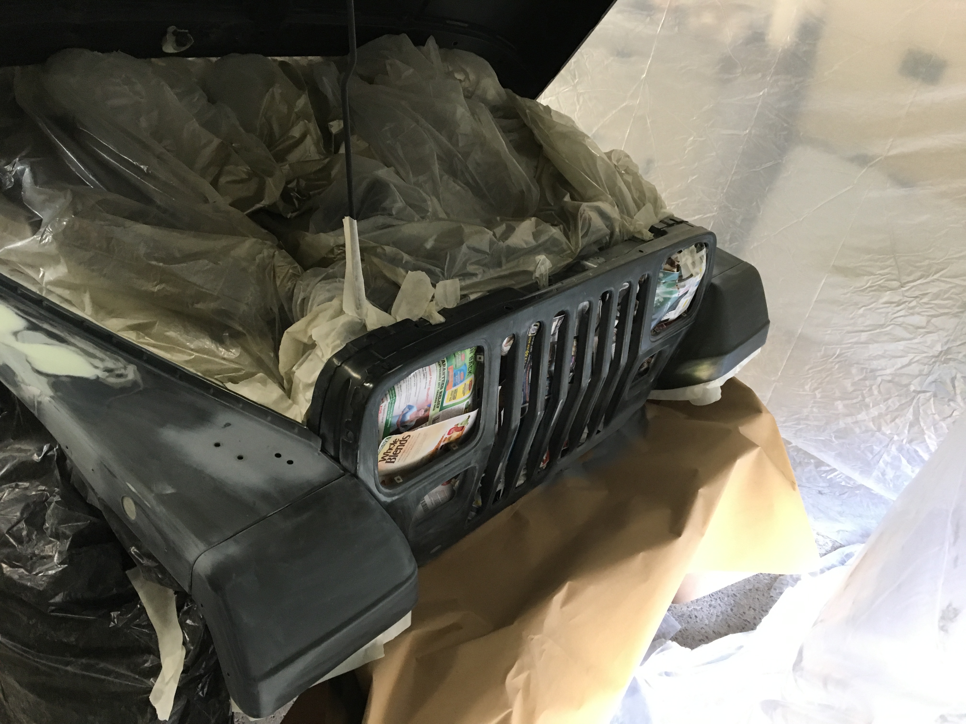

Paint Sequence:
[1] Sand dents and surface rust areas to bare metal
[2] Body filler
[3] Sand everything
[4] Etching primer on bare metal
[5] Primer surfacer coat
[6] Beige base coat
[7] Tape off stripes and red base coat
[8] Clear coat
[9] Sand, particularly stripe edges
[10] Re-clear coat
