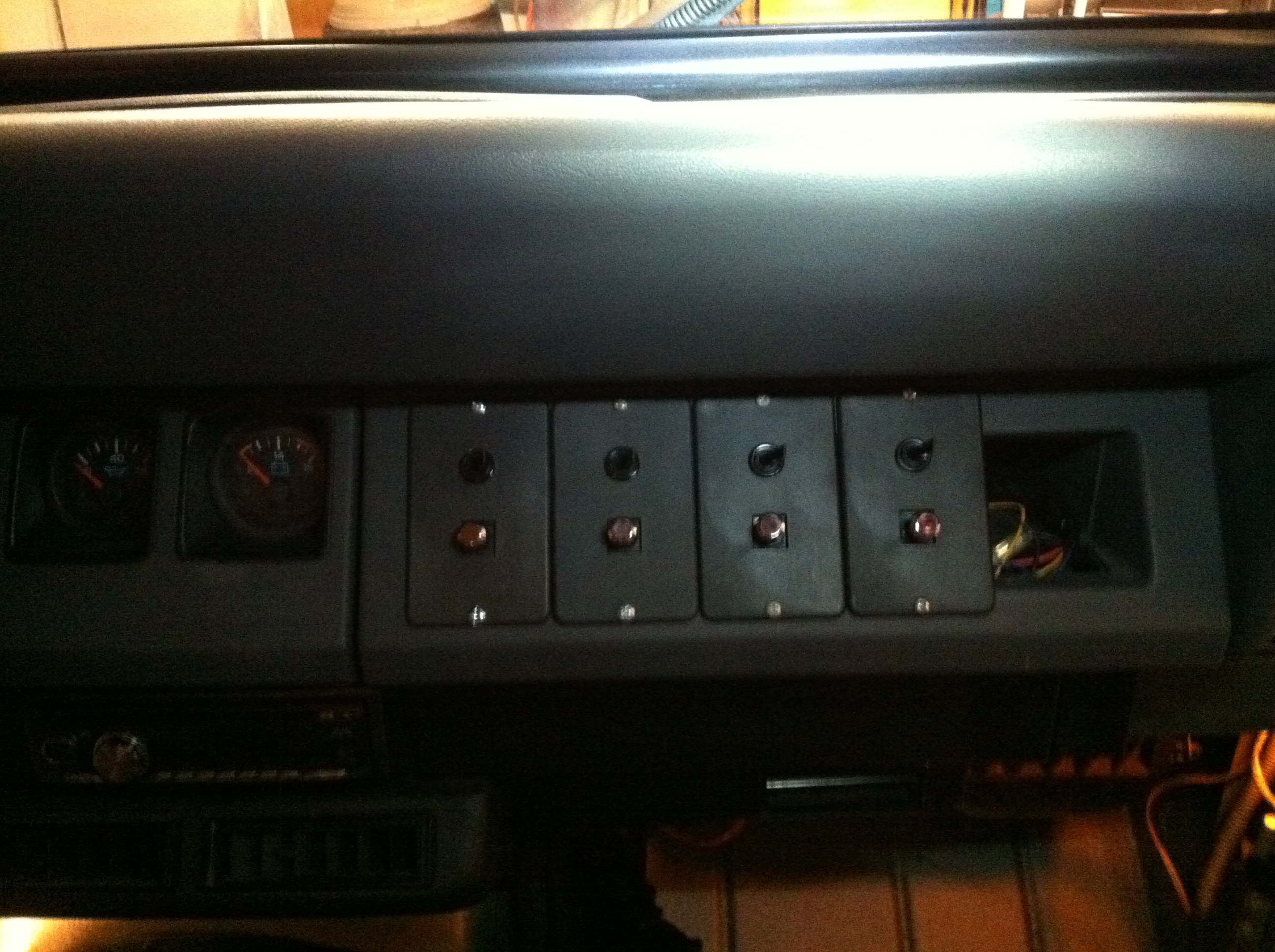

Where did you mount the switches on the inside?

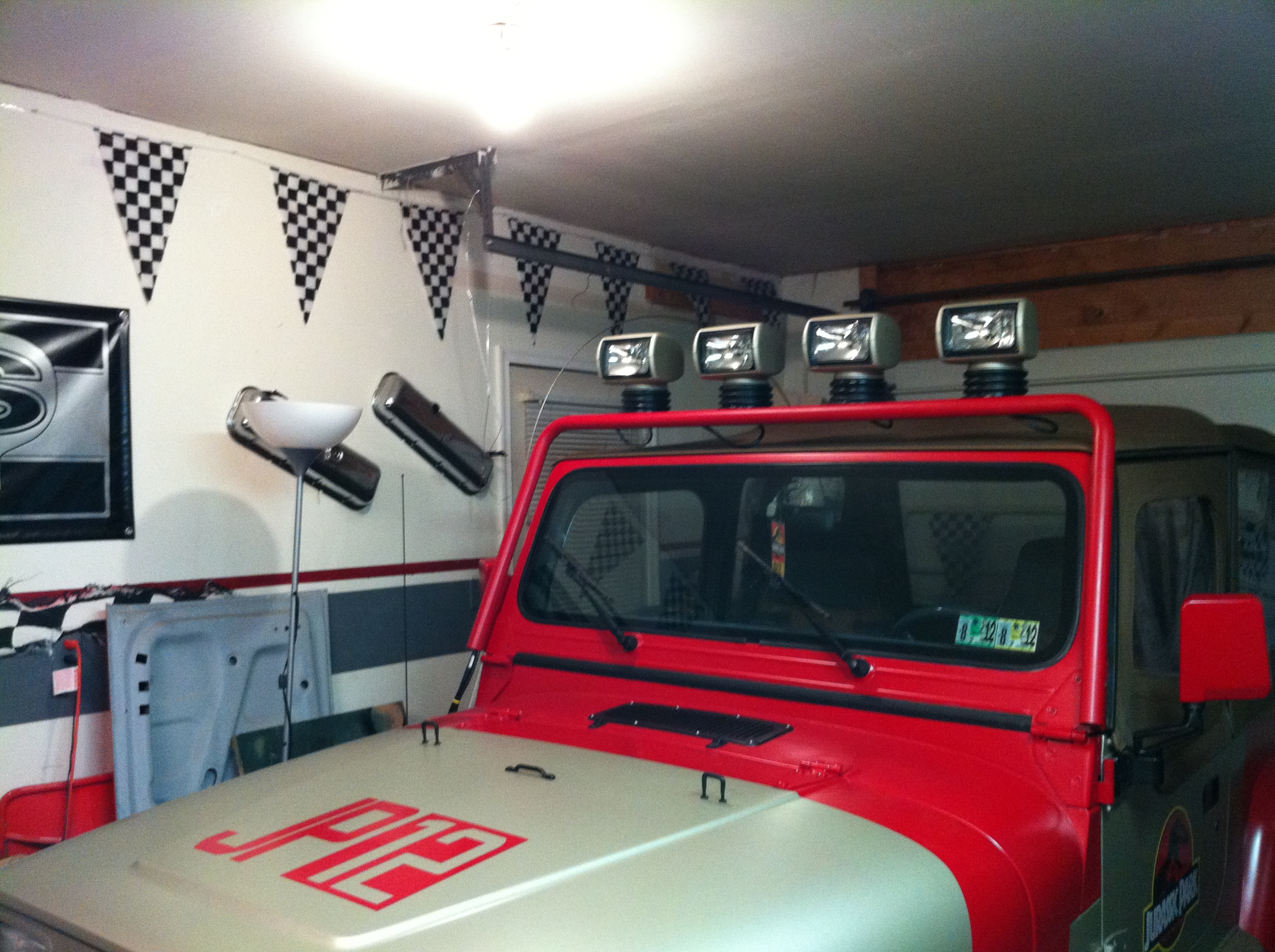

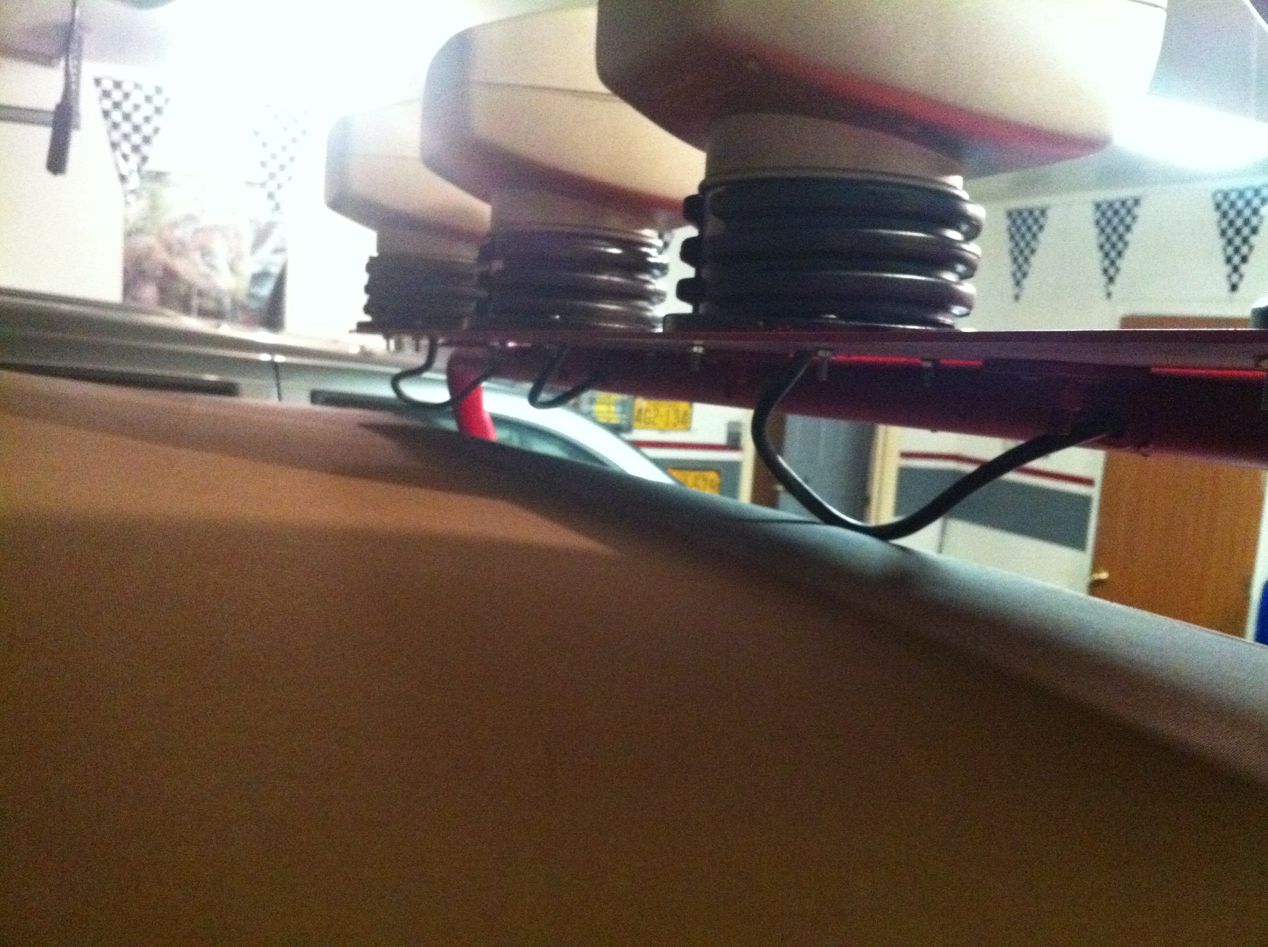

what about the inside of the light bar how did u stop rust?
1995 YJ Sahara
Re: Pennsylvannia Jeep #12
Post by Jack_Fauth » December 15th, 2011, 9:49 pm
Maverick20 wrote:what about the inside of the light bar how did u stop rust?
I think the bar will be fine as it is, mine has zero rust on the inside.

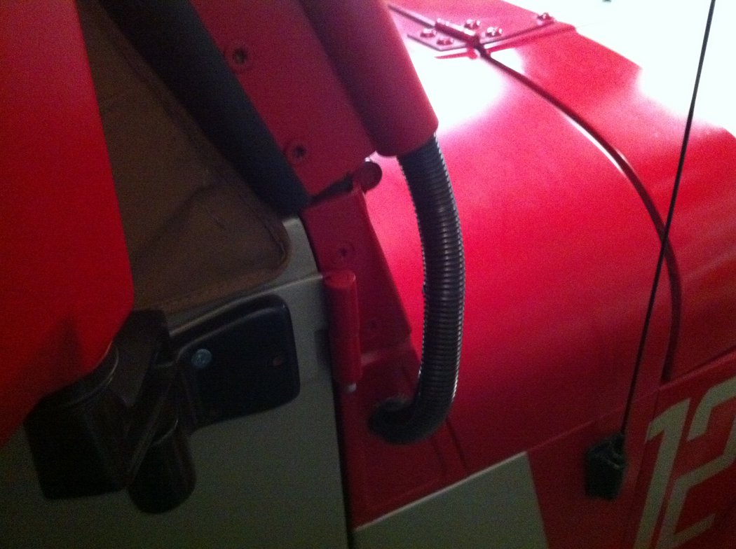

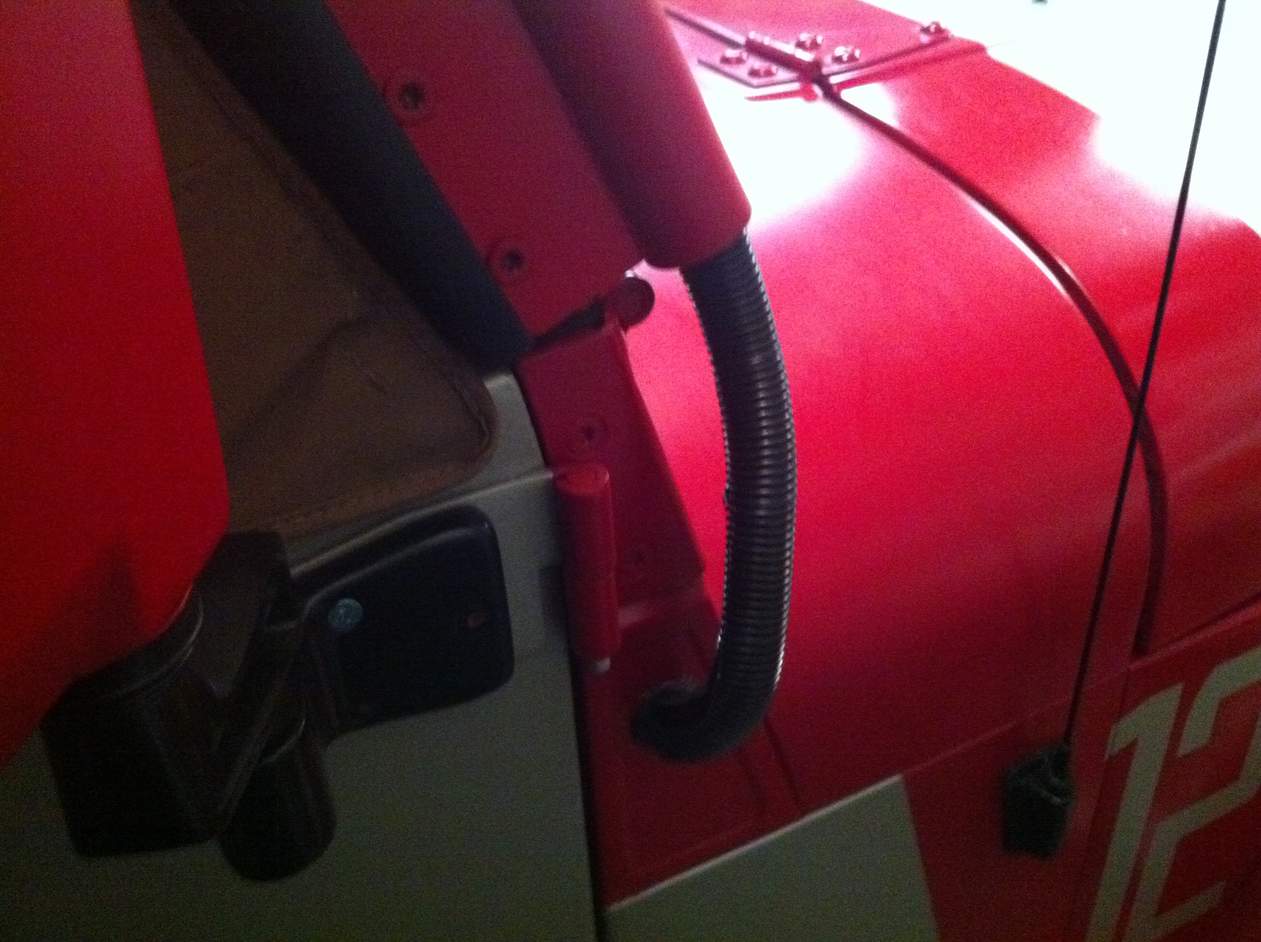

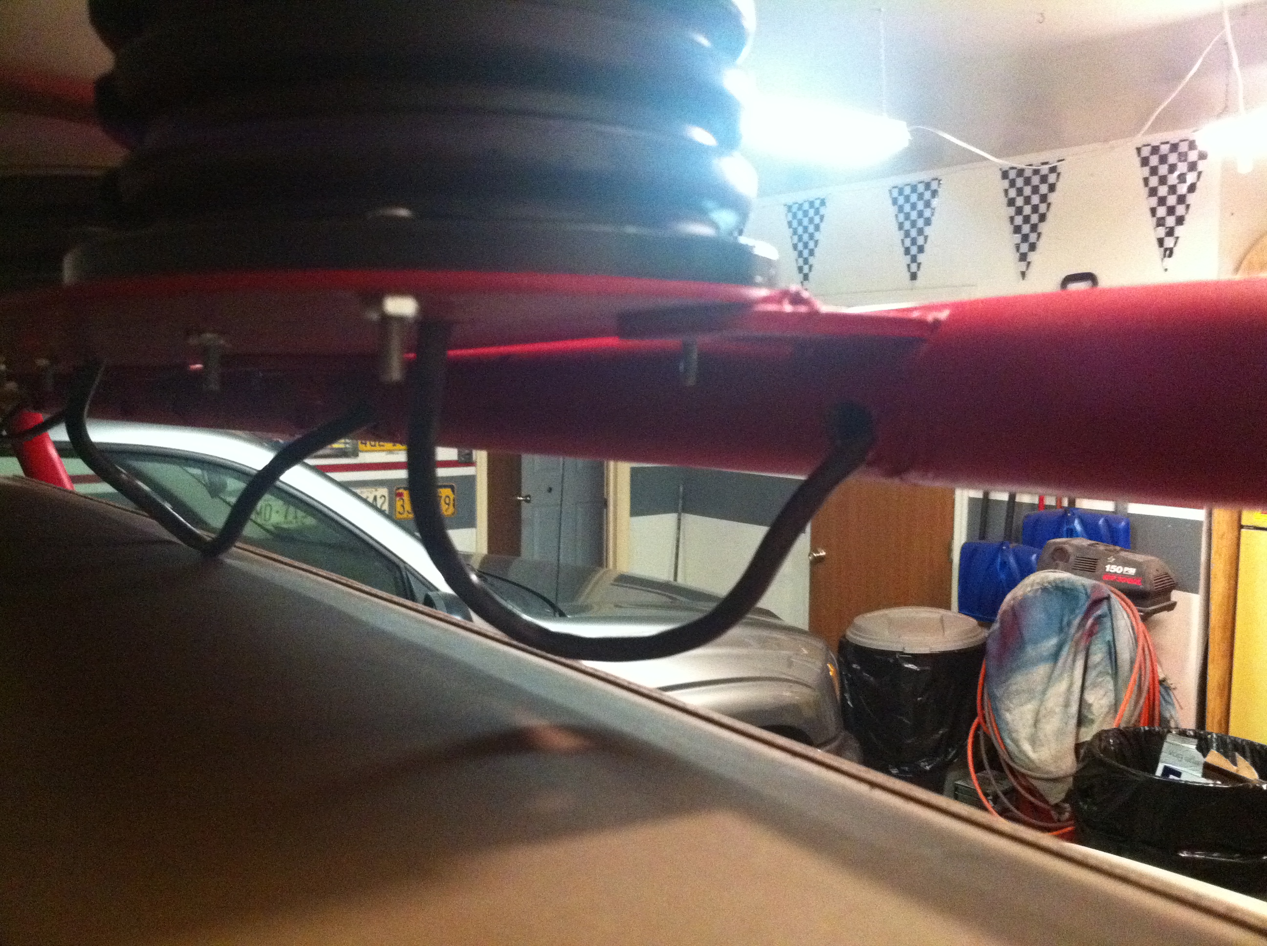

as for mounting the switches i ran each lights wire through the hole in the back of the bar near each mounting tab.
then i drilled a 1" hole into of the side of the jeep that goes into the passenger compartment. Then i ran all 4 wire through a grommet and into the interior compartment.
Here you can see that i mounted the switches to the oh shit bar above the glove box
Ran all 4 light to the accessory switch in the fuse box under the dash. LightS all run indepently as they did in the movie
here is a photo of the switches mounted. I think i will get a blank cover to fill in the end and hide the rest of the wires

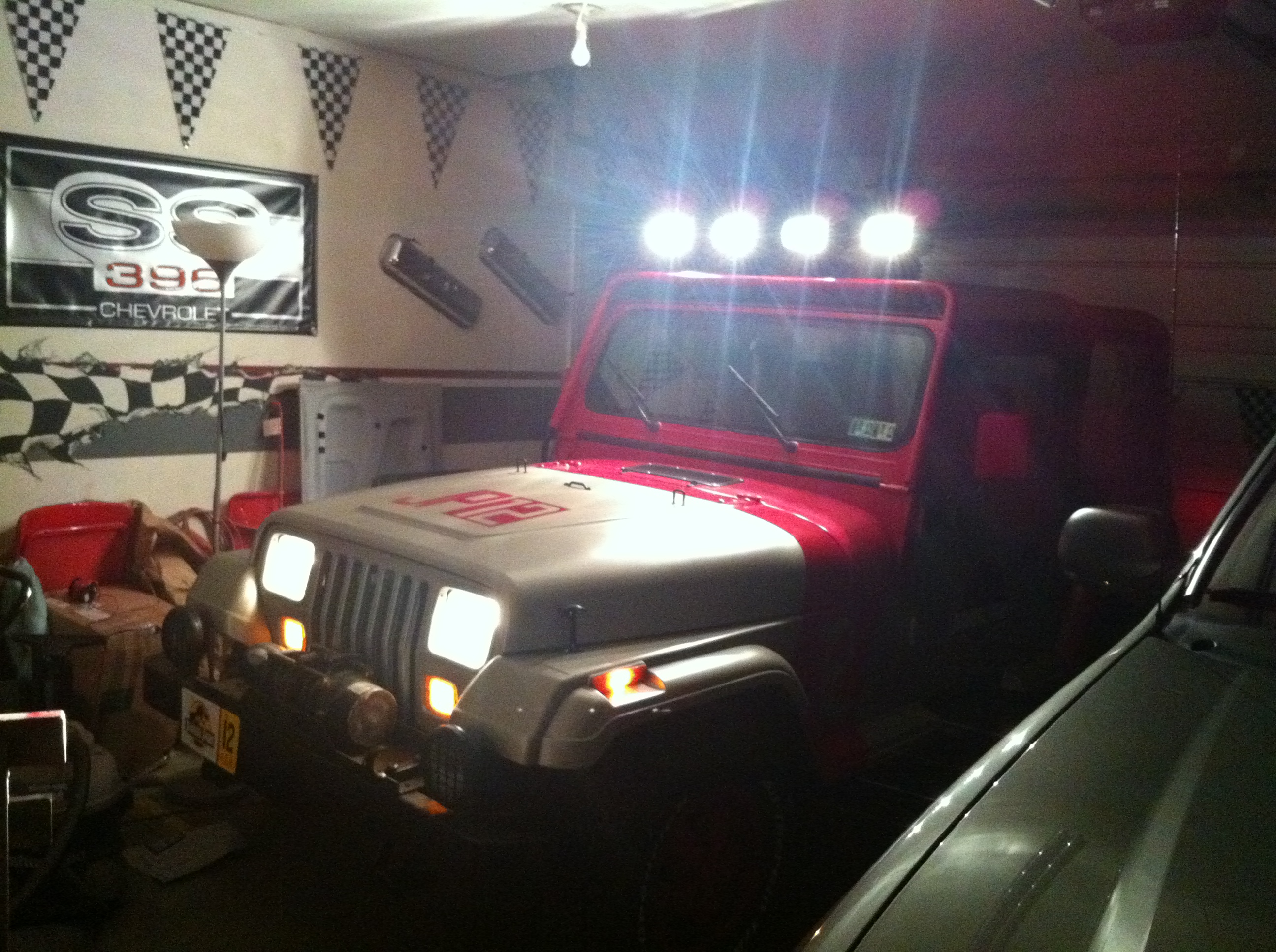

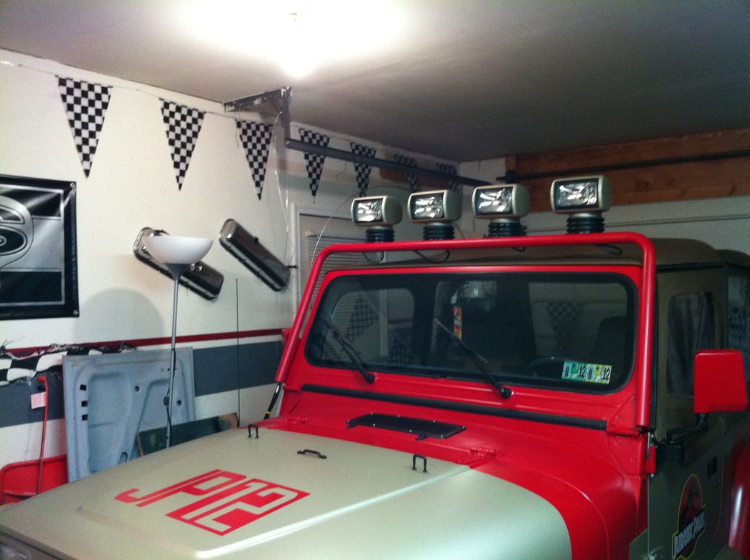

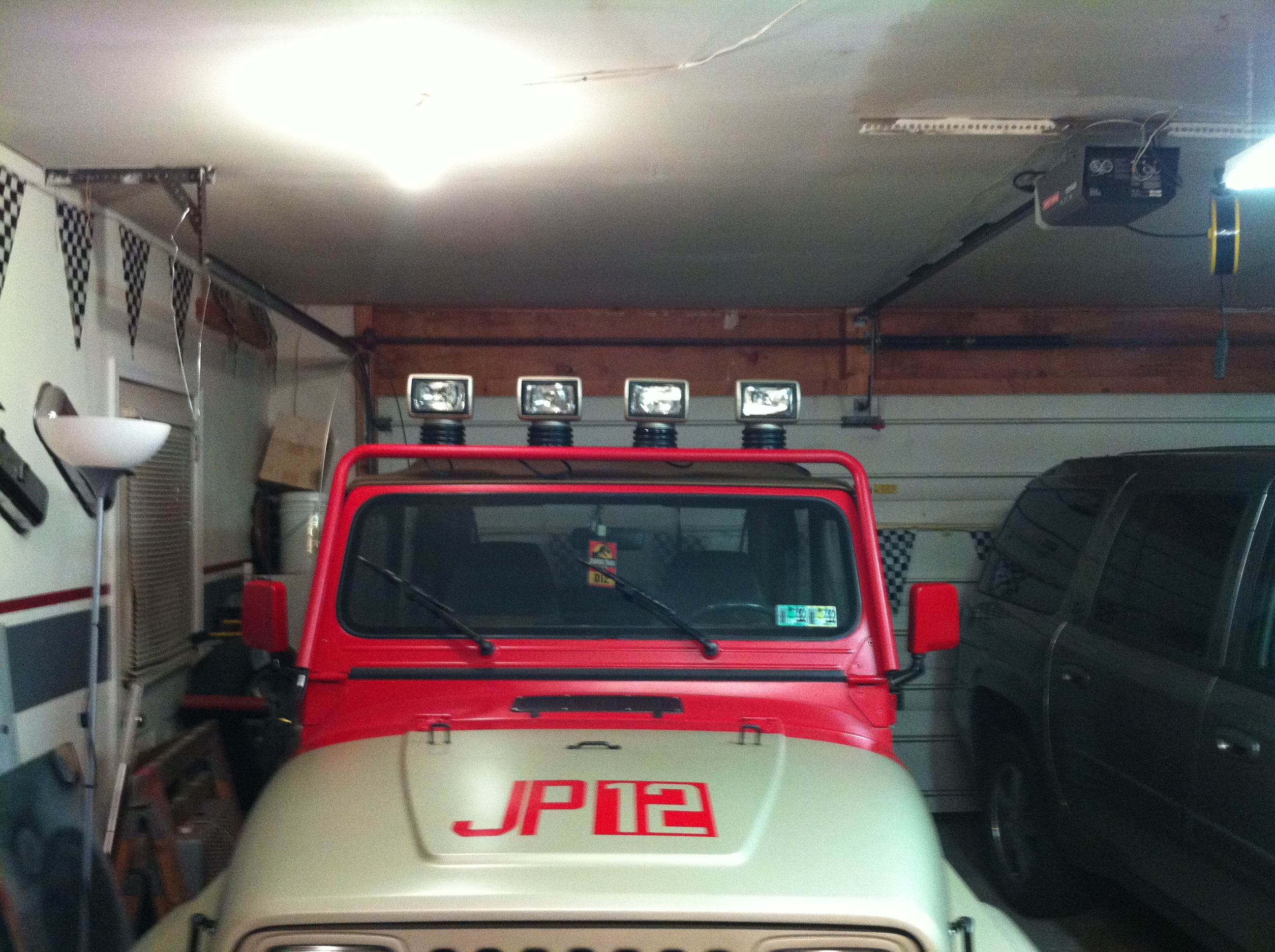

MONEY SHOT......!!!!!!!!!!!!!
Post by fantomas » December 15th, 2011, 10:38 pm
Holy crap that looks great! When you test it out, let us know the actual functionality of those lights are.
