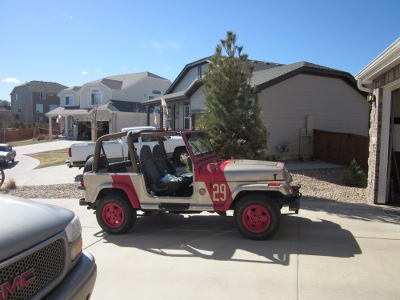

Ok so. I ended up deciding to use a paper stencil for the numbers and try to peal it off quickly. One side this worked well on, the other side, I wasn't quite quick enough and there is a small section on the 2 that is not straight. Pulling larger sections I had to CAREFULLY run a box cutter along the very edge of my tape to make sure pulling tape didn't pull the plastidip. I had to redo the back stripe becuase when I pulled it my last coat along one seam wasn't thick enough and it didn't soften up the existing dip, so it pulled big chunks off when I pulled the tape.
PIcs: Now I need to go the vinyl guy and get my doors and the hood number. If he can't match the tone of the red, I could create stencils and do the hood number in plastidip if I have to. but stencils were a pain with the plastidip.

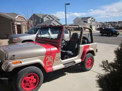

Got the door Logos today. They are on. Tried to get some pics in the garage and the lighting sucks and my flash sucks.. so I'll get pics tomorrow. I used the same vinyl guy as Boomerjinks, and he accidentally printed my hood logo as Boomerjinks JP18. So my hood logo isn't applied yet. I'm going to stencil it and just use plastidip. So it matches the stripes exactly.
Re: Colorado JP #29

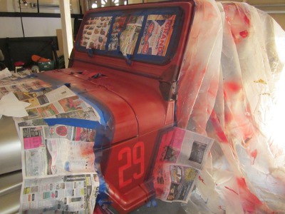

PIcture before I painted(plastidipped) hood logo ...
