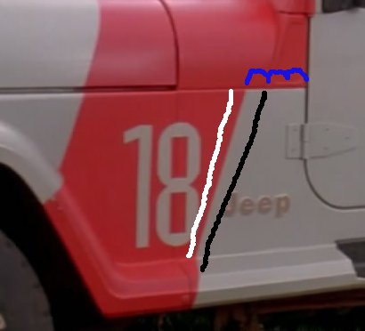

The angle of the stripes were laid out with a laser line from the side. I used the windshield and the body triangle in front of the door(just below windshield) to get the angle to use. Note: On my Jeep the windshield and the body angle are about 5' difference. I measured my windshield at 70' and the body angle at 75' . I tried both of these angles with known body points and my laser. If I used 75' and matched the bottom of the angle to the seam in the side step, then the line hit to far forward on the welded body seam. If I used 70' and the seam, then the angle hit too far back on the body seam. I also aligned the top of this stripe to what I believe made sense. The Top of this stripe edge should be 1/2 the distance of the windshield body angle, from the screenshots. In the below image I have drawn (crudely) where the difference angles ended up.
Black line is at same angle as windshield, and hits body seam too far back. White line is at same angle as the tub's triangle, and hits too far forward. The blue humps show the relationship of where the stripe hits the seam being 1/2 the length (1 vs 2 humps) of the bottom of the triangle.

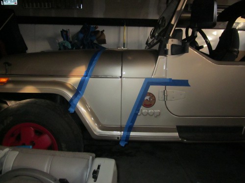

With the angle now set I went about laying out the rest of the lines. Front stripe edge starts at 1/3 down wheel flare. Turns to meet hood line at edge of hinges.
Front Stripe Layout
Front Stripe Layout

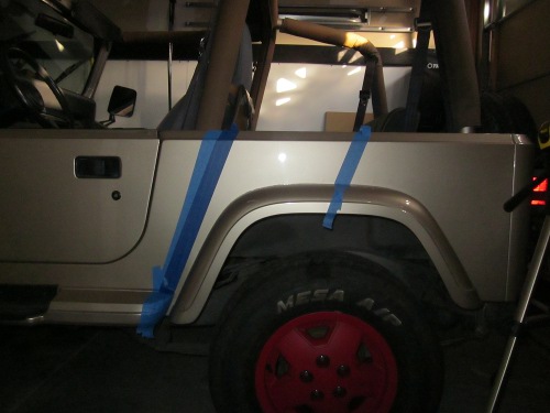

Back stripes, Front Edge starts at rear edge of side step, Back edge is just in front of the middle of the wheel flare.
Back Stripe
Back Stripe
Now I measured up the stripes. The Front stripe is 15.5" wide, and the rear stripe is 13.5" long. Ugghhhh.
I poured over the screenshots, and did some measuring, and this may be correct. from every image I pulled up the back stripe does measure smaller than the front stripe.
I highly recommend using a laser line or some other method to project from the side, as the body plays all sorts of tricks if you simply try to tape them up... I tried that initially on the back stripe, and once I got the laser line, I had to redo the back edge where it goes over the wheel flare.

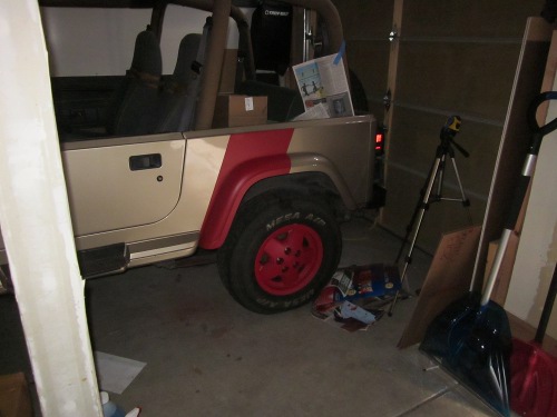

Testing out getting plastidip for the stripes. I got my first try on toooo thick and it had runs in it. Never fear, waited 4 hours, peeled it off, and started again.

I really can't believe this stuff... I mean the plastidip forums are full of people doing whole cars.. but seeing in person is believing.. it really is very cool.. Sure if you get up close, its not as smooth as paint, but the process is nothing compared to paint. All you have to do is clean the surface really well, Tape, and spray. And the overspray is not like paint, as it is thicker so it doesn't just get in the air and cover everything.
According to the plastipdip forums: you can poer wash it fine after it fully cures in about a week. Yes it is dry in a few hours, but fully cured is about a week. When I peeled my mistake I waited about 3 hours and it was dry and didn't get any on me when I peeled it. In order to peel it I had to rub a corner really hard with my finger before I could get it started, so even after 3 hours it isn't coming off just by looking at it ;)
