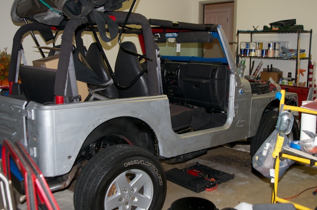

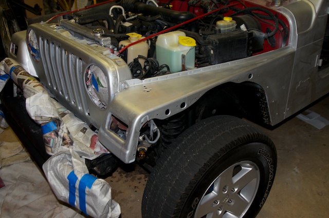

Update-

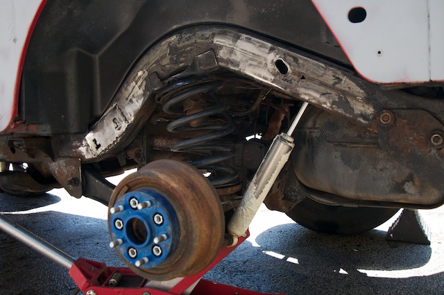

Started on the frame restoration today. I had some rust throughout the frame so I started cleaning it up. I stared grinding it down.
Then I applied a stripper so I could really clean it and continued to grind it down.
Through a deruster on it, didn't really do much but it looked a little better.
Pulled off the trailer hitch. Had to cut through most of the bolts, that took forever but finally got to take off that rusty piece of junk.
Repainted the handles and trim pieces. Kept priming areas that I hadn't finished.
Started with two coats of rustoleum undercoat and then hit it with 2-3 coats of flat black.
Put everything back together and tried on my pocket style bushwacker fender flares.

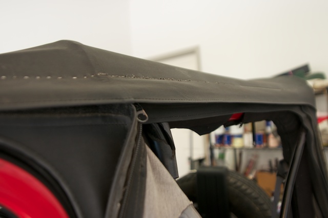

I think it looks pretty good as is at this point. Next I had to restitch the top. Its in pretty good condition apart from the typical rip by the front on the drivers side and the stitching was coming out. I got polyester nonwicking thread from an upholstery shop and decided to undergo the process.
Before After Took awhile but if you spend the time and restitch through existing holes, it turns out great for all of 8 dollars.
Also I found the best top cleaner that I've ever used. I've gone through specialty top cleaner and most things that people recommend. This stuff took off Georgia red clay that had been sun baked on the top for over 8 months. The bestop cleaners and pressure washers did nothing, but then I threw this one, scrubbed it for about 10 seconds and it was gone.
All in all, I think she's looking pretty good. Now to decide on paint and really start the transformation.

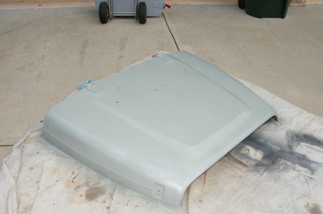

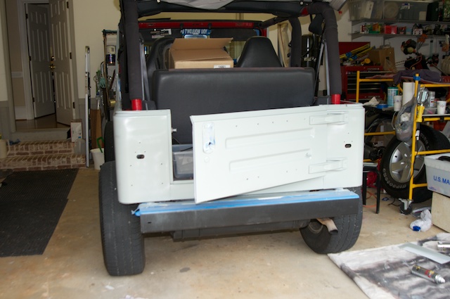

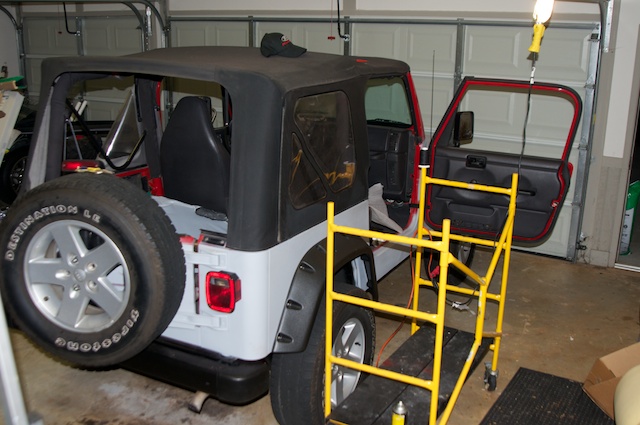

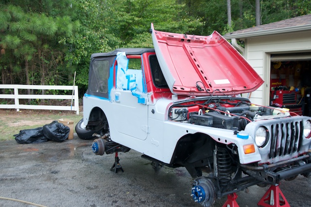

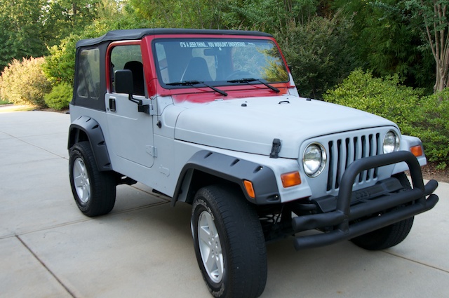

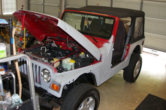

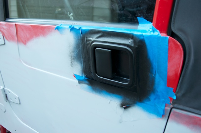

More progress being made-
Brought it into the garage to start. I purchased a gray color that I really liked, but didnt realize last night that it was REALLY metallic.
So back to the store and picked up a different gray. I like it a lot better. It will go better with the safety red that I'm using.
