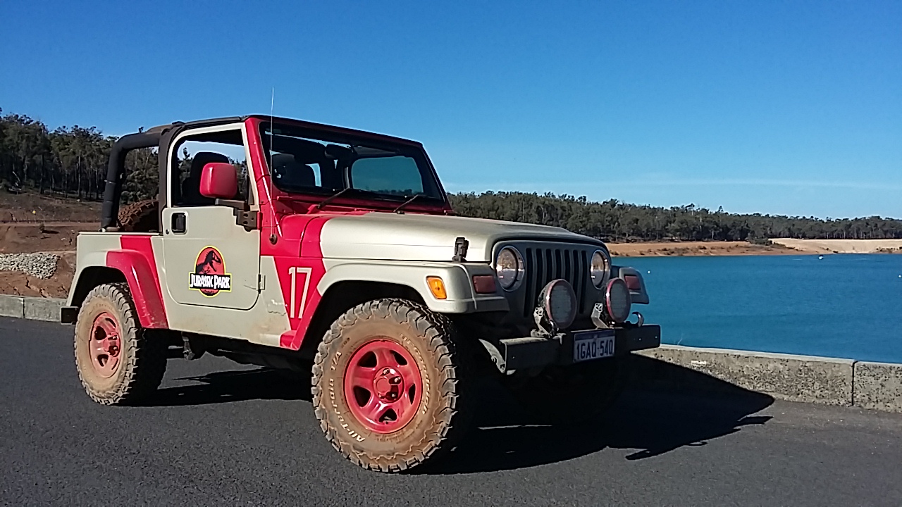

Re: Philosoraptor's Canadian JP#90 Build
My tyres got pretty dirty at the 75th Anniversary weekend meet here in WA and the lettering had some scuff marks which came off with a high pressure cleaner

Hey Philosoraptor,
sorry for the late reply.
Getting parts into Oz isn't too difficult, normally the overseas stuff is cheaper than local, the freight costs can sometimes make it waste of time though.
Haven't done anything on the Jeep lately, just enjoying the summer sunshine, still get lots of positive comments. There is another Jurassic Jeep here in Perth, the guy has fitted YJ front guards, flares and bonnet, it looks fantastic, I need to make sure I never park beside his though, it will show mine up big time.
Lee
Lee
