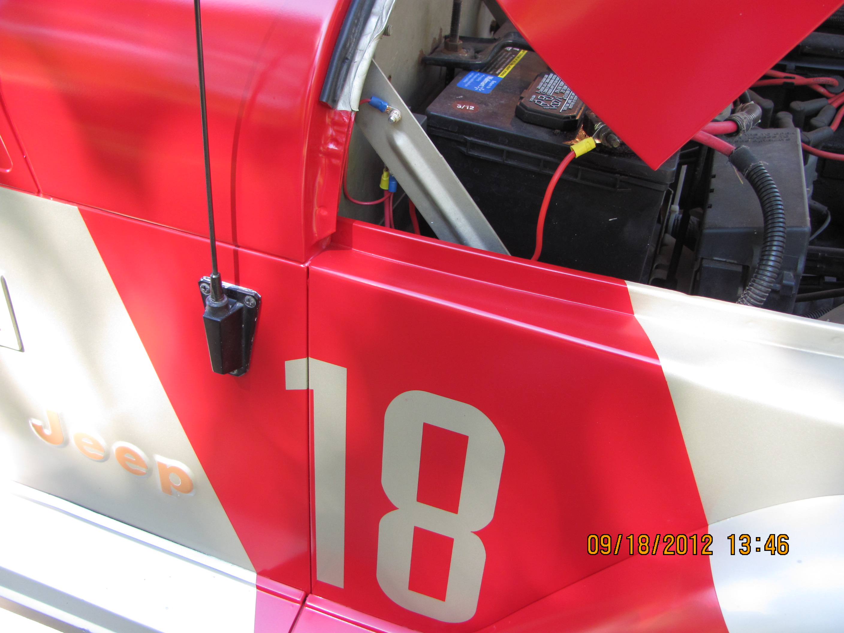

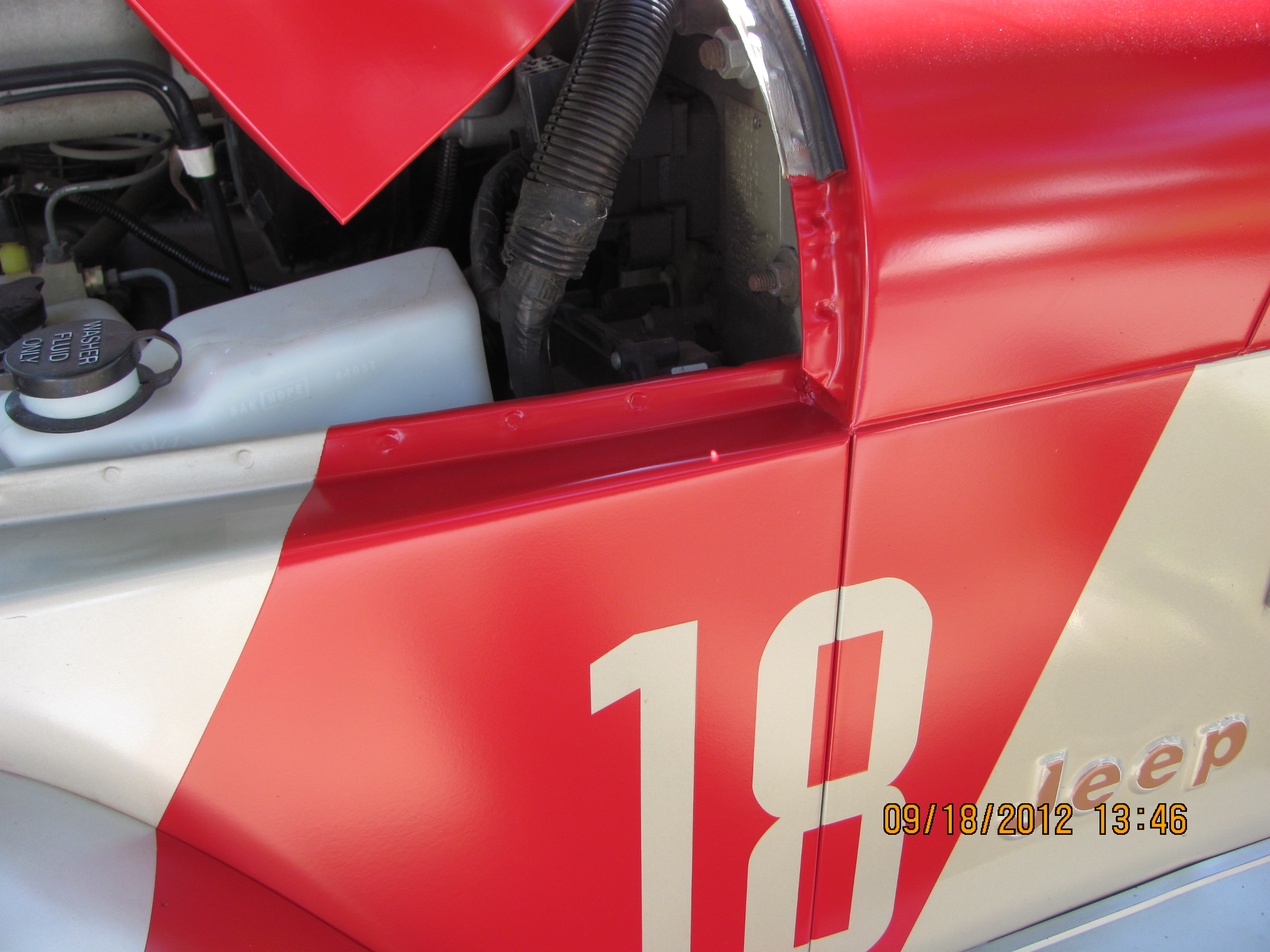

After close examination of the HD screen shots my paint guy noticed that the 8 does not center in the body line
The 1 goes right in front of the body line on the pass. side

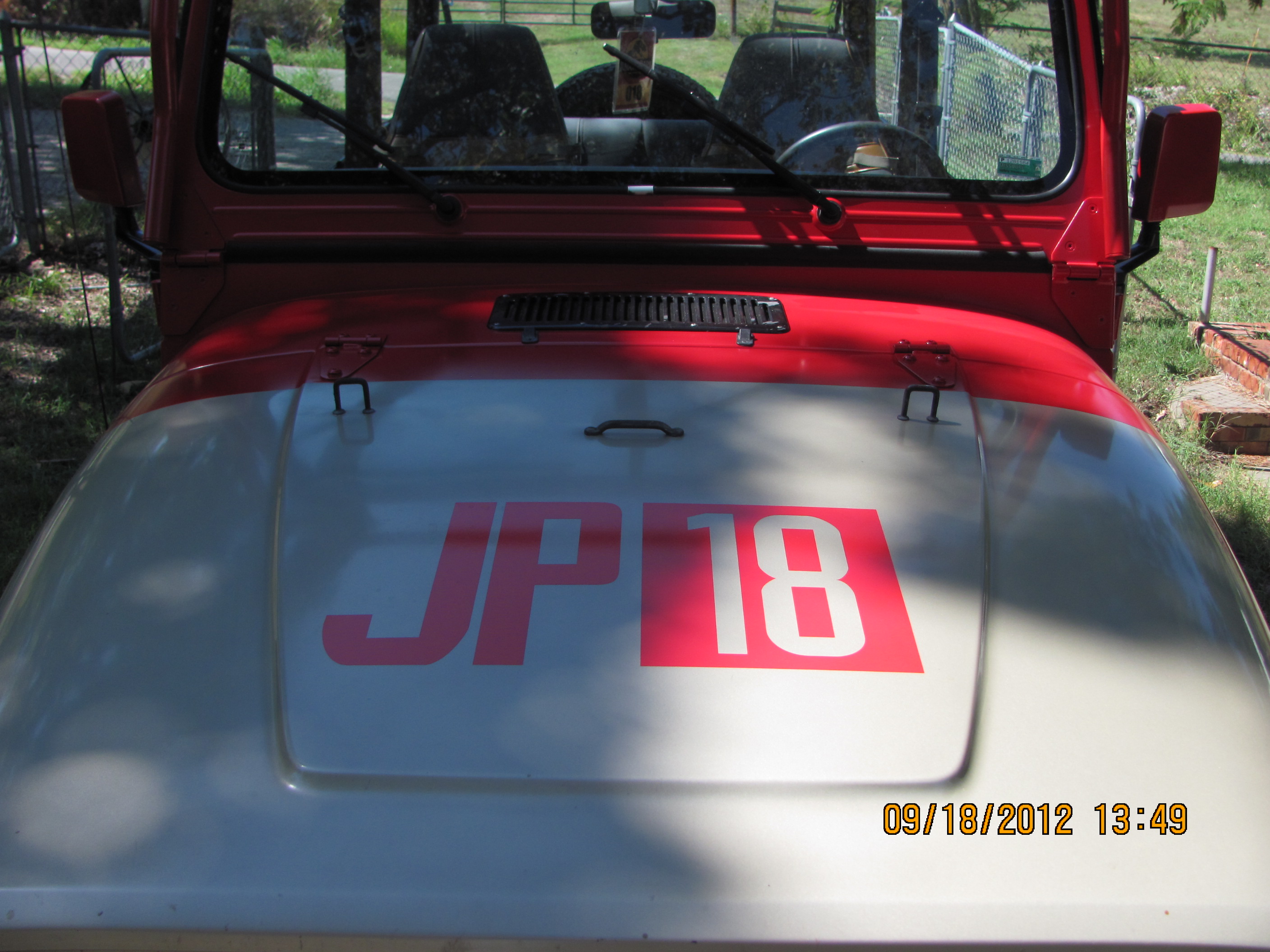

I didnt like the size of the hood decal from 8bit so i custom ordered a larger one from them.

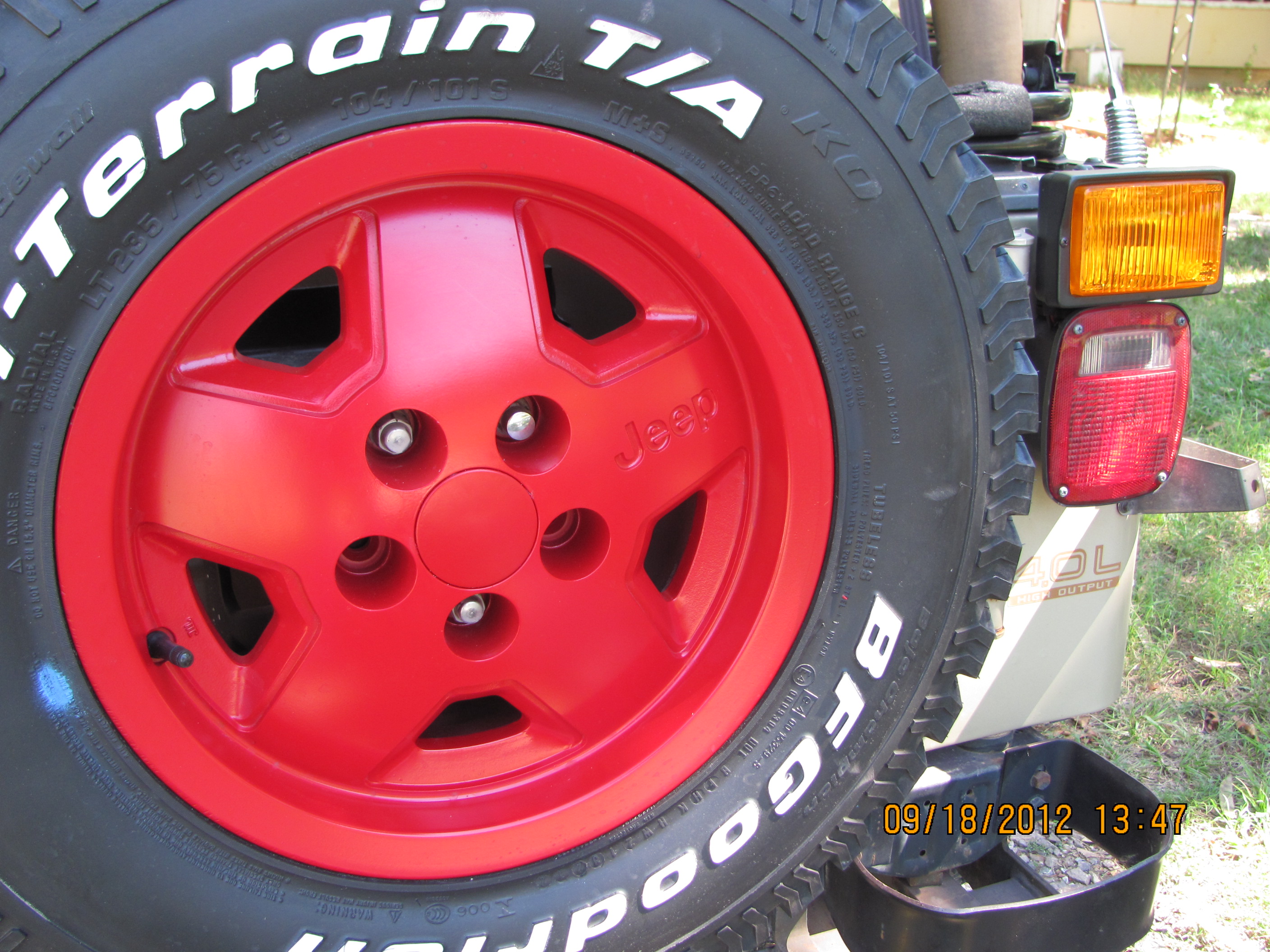

I chose to paint the wheels before mounting the tires. Two of the wheels flaked some at a little spot on the edge but nothing a small touch up wouldn't cure

6) Three coat's of Radiant Fire red base.
7) Next was to apply the clear coat. The red finish on the jeep was a low gloss so I added a flattener to the clear coat. I applied two good coat's of low gloss clear.
8) Now the real challenge, striping out the Jeep. Using the still photo's, I found some reference point's. I didn't have a picture of the Hood but I found a starting point of 5.5 inch's on the forum for the hood stripe. This was a reference point from the hood's edge to just past the hood hinge's. Now I could bring the striping tape down to the flare to the second reference point. I found this by using the front of the fender and running a straight edge to the rear of the flare. To keep the curve consistent, I used 8.5 inch's at the lower hood to fender gap. The rear of the stripe by the door was found by finding the center of the second "e" in Jeep and running a a straight edge up to the body line. This gave me a starting point for the tape line that ran down to the flare seam. Fine line tape was used to tape off the stripe. The 18 is in the wrong position at this time.

12) Just before painting, I apply the decal's used for masking. For location of the 18., I found the bottom of the "1" stem is lined up to the bottom of the antenna base and the body seam just to the back of the stem. The "1" is just under 3" from the hood gap. The decal is applied with soap and water.
13) The left "18" was placed just under 3" from the hood gap.
14) This put the "18" where it suppose to be by looking at the still's. About a 1/4 inch of the open area is lined up with the top of the "J" and the body line is in the right place. The panel was spritzed with soap and water and the decal was applied.
