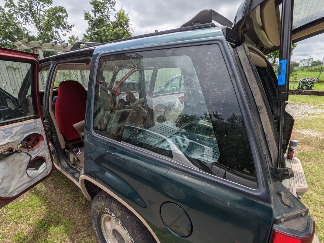

If you can get aerosol methylene chloride it will strip that film on the glass almost instantly. Do heed the warnings on that stuff. Second best thing I have found is just use a brand new razor and the moment it stops working effectively switch to a new one. figure 2 blades per glass. Also, I believe now that the tint is not actually aftermarket, and probably factory applied. I've pulled multiple sets and it is too well and consistently applied compared to other glass that old that obviously has film tint.
I'll have to give the methylene chloride a go; was just reading about that last night. I'm betting this particular tint was put on by the dealer. The edges are not as clean as I would expect from the factory and there was a cutout in the tint for one of those window-mount cellular antennas.

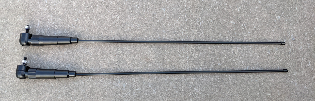

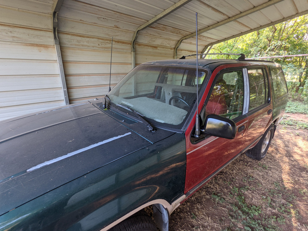

I picked up the Tram 1607-HC 46-Inch from Amazon (directly from Amazon, not one of the other sellers) in November 2020. The Tram antenna mast section is 14mm / 9/16" diameter and is roughly 37" long to the mount section (wedding cake, as we would call it at the transmitter sites at work). If the mast were still attached and I measure down to the "grip" section on the wedding cake, that would be 43". If the entirety of the mount is included, that gets it to the 46" as advertised.MrDNA wrote: ↑March 22nd, 2021, 3:28 amOn your antennas; when/where did you purchase them. Have you verified the size to be what you expected? Another international builder had 2 shipped from The Home Depot to my home and the 46" were actually 43", and the base was ≈1mm taller than the ones I purchased 2 years ago. The difference is insignificant here, but still any change in these parts warrants mention.
"Wedding Cake" Measurements:
Grip section: 25mm
Grip section to first step (centered on wire hole): 12mm
First step/center of wire hole to middle step: 45mm
Middle step to start of taper: 40mm
Taper: approximately 2mm
Taper to antenna mast base: 20mm (there is another slight taper where the antenna mast joins in, it's 1mm)
Overall "wedding cake" length: 145mm
The rod I picked up from Lowe's is a 48" long driveway marker with a diameter of 8mm / 5/16".

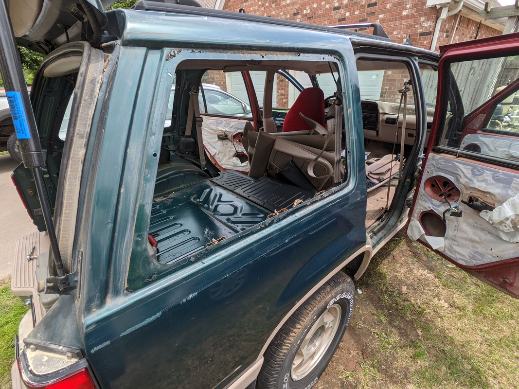

Peeled apart a bit more of the interior this weekend. Everything is now out except for the dash and front carpet. Will have to track down three of the little plastic press-fit keepers that go under the rear windows. The rear windows were leaking quite a bit from the previous painters damaging the seals and the carpet was soaked.
I scraped off the bad sealant and dropped in the AS2 glass. I'll be pulling them back out when I'm ready to paint. Hopefully I'll have a different passenger side glass by then as the rubber is quite pitted.

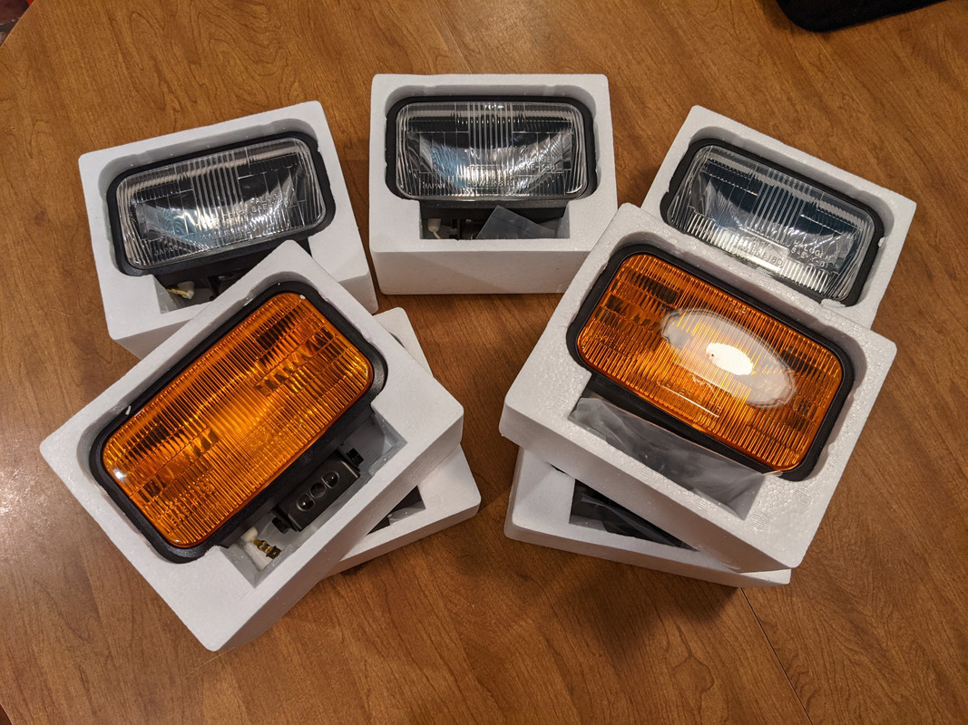

Also picked up the hood light and top fog lights. Figured since I was already ordering a few I might as well take the opportunity to upgrade the rear fog lights on both of the Jeeps.
