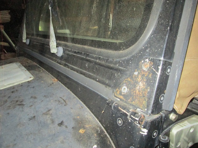

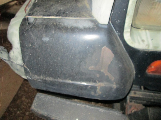

I have a few rusted spots (Not as many as I was expecting, thankfully), and at least three tiny dents in the front, side, and rear.

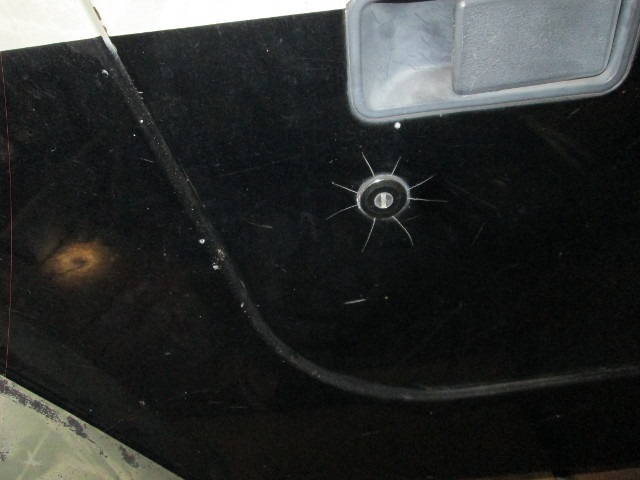

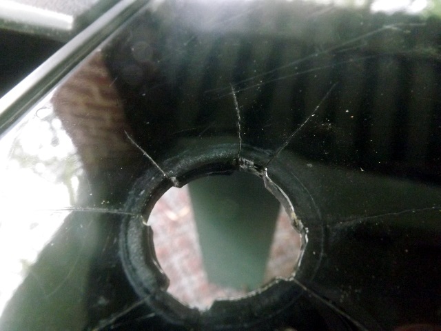

I also have a series of cracks in my passenger door frame (also, on the right headlight frame.....):

the cracks around the door lock look like its only the paint. Or is it wrapped with vinyl? There is a lot of color customizing going on here. Its going to be time consuming bringing this back from the previous owners dream.

A hard painting project is something that won't surprise me, but I'll worry about that after I fix it. From what I can currently tell, the cracks are in the shell. There doesn't seem to be a layer of vinyl.

While I wait for my paycheck to get some jack stands I need, I decided to remove my passenger door and take a closer look at that crack around the lock:
Again, it seems to be in the shell:

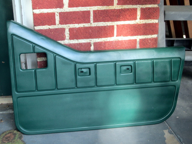

:? Yeah.... Speaking of green...... I screwed up:
Even though I was consistently going in a back and forth motion, I got several blotches, ugly lines and it turns out that this panel has several sun spots (which can't be fixed). Later I might try sitting the panel in the sun for a while to see if the paint blotches fade in, or go spray vertically instead of horizontally.......

Post by ratrace427 » July 5th, 2019, 7:44 pm
looks like the spray paint was laying down at different thicknesses. the light color under the green might not be covering completely and showing through. im guessing you didn't "seal" the panel first with primer. just put another coat on

ratrace427 wrote:looks like the spray paint was laying down at different thicknesses. the light color under the green might not be covering completely and showing through. im guessing you didn't "seal" the panel first with primer. just put another coat on
Thanks for the tips. I was using a "Paint and Primer," so I thought that was good enough. I'll know better when I paint the other cover......

Here's where I stand now. I had no sunlight today so later I'll take a better picture:
Adding some more layers didn't fix the problems, but I understand that this is a learning process. I'll do better when I go to paint the other panel......
