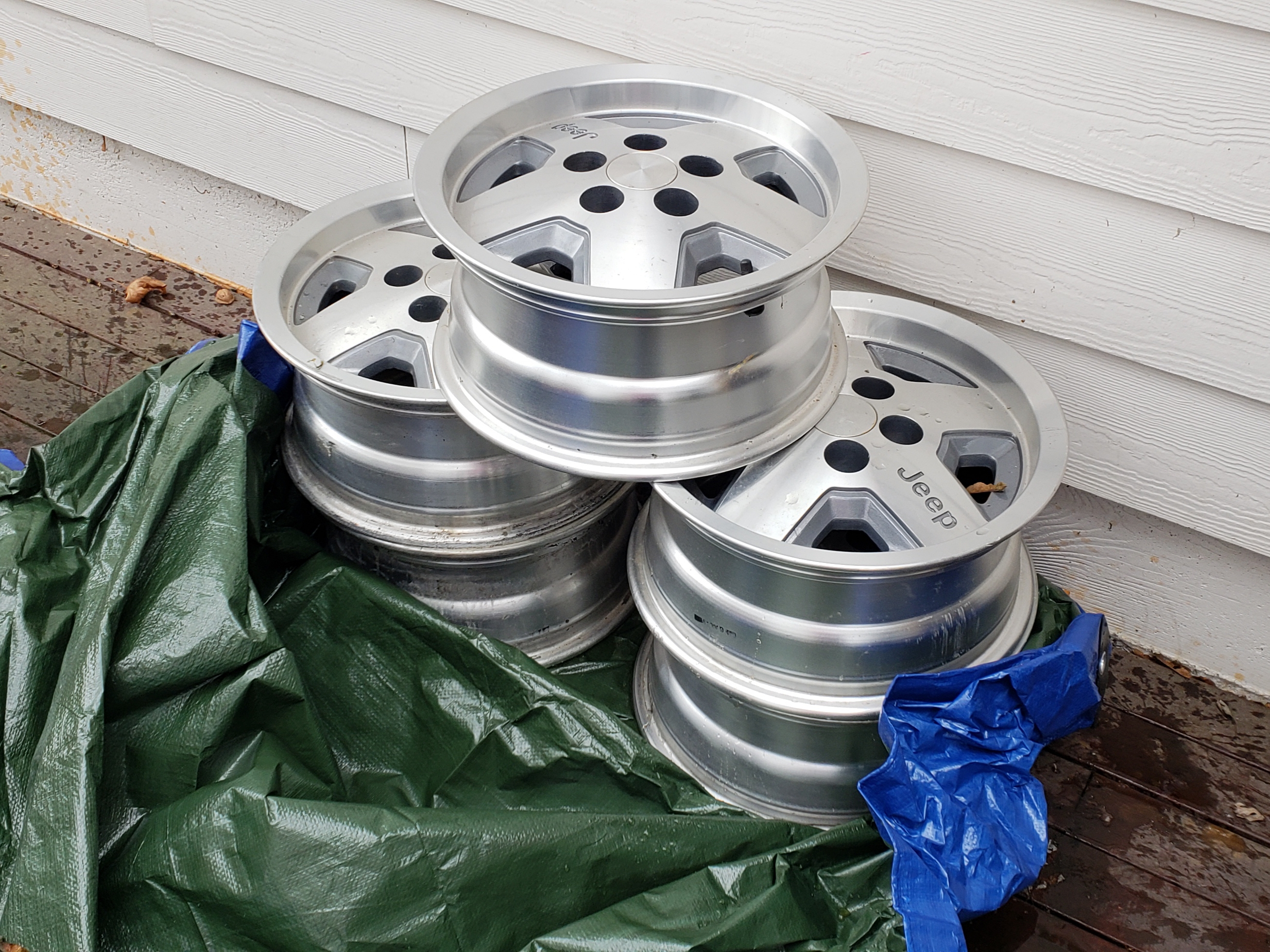

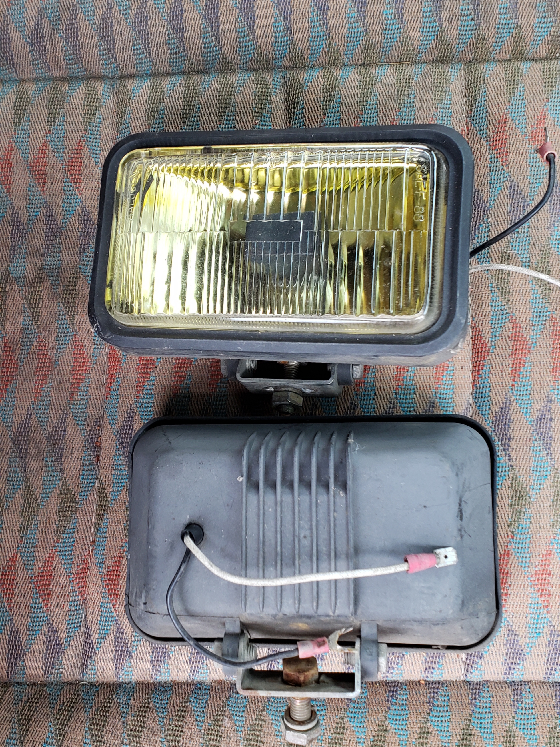

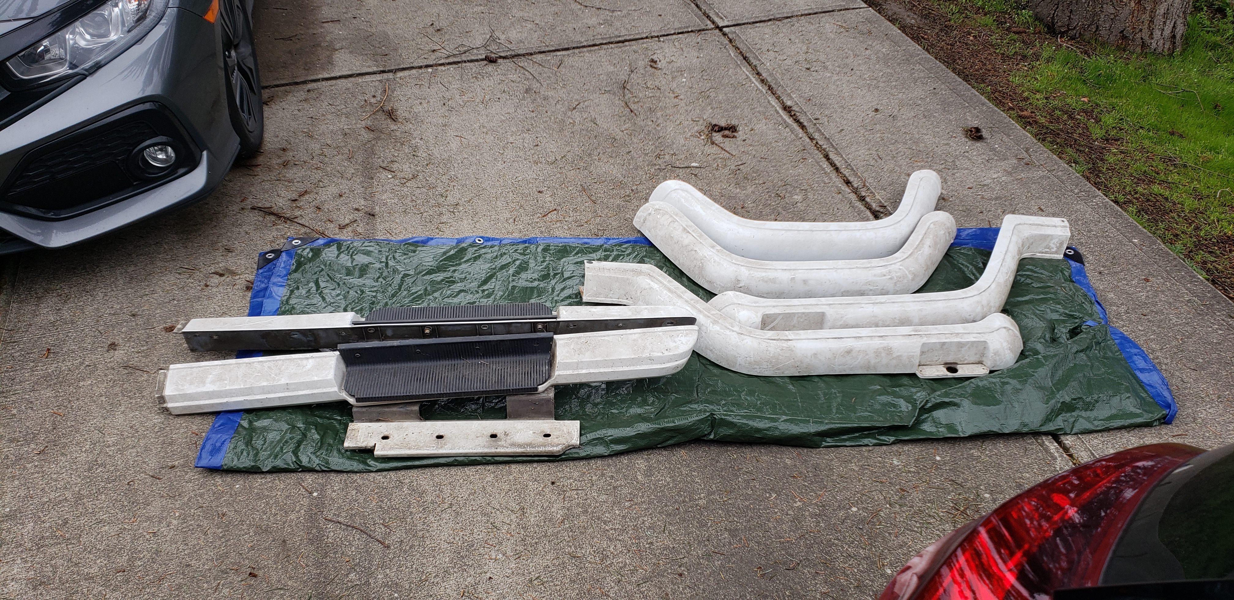

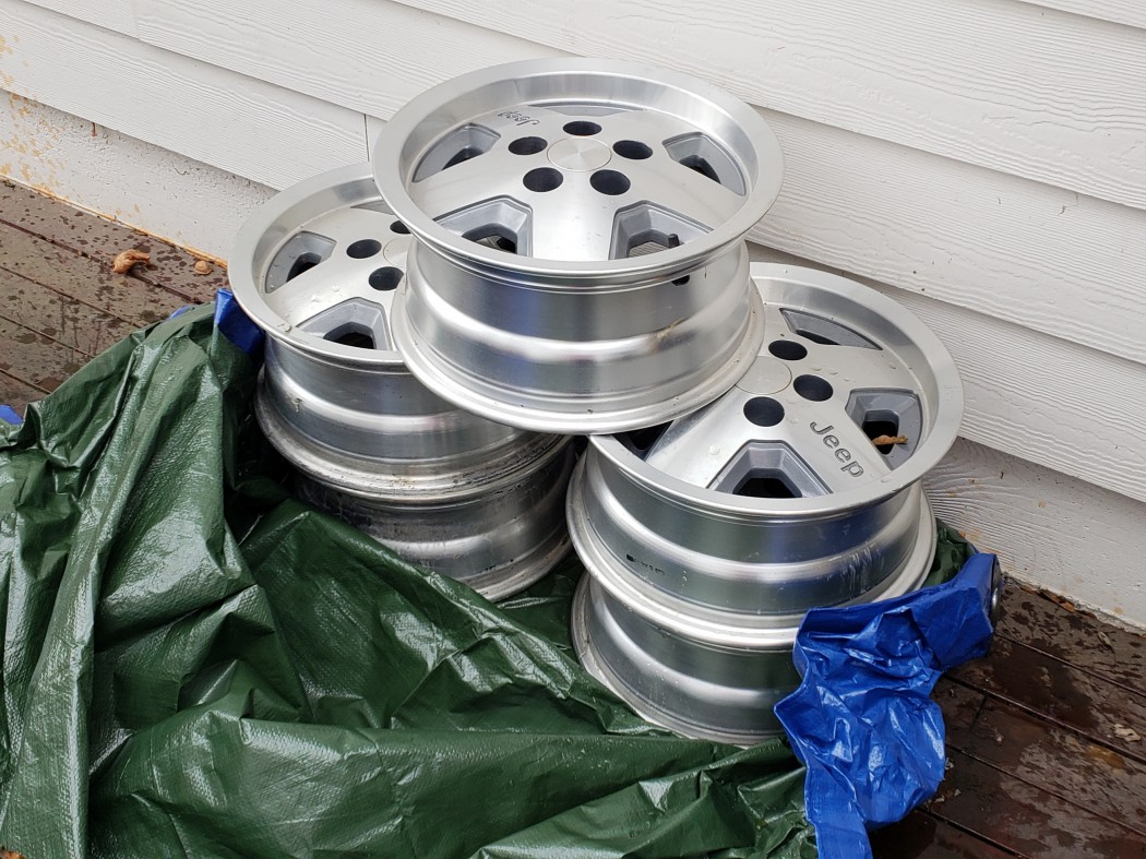

While I was outside organizing things today, I figured I'd take a few photos of the odds and ends that I've gathered so far. Pictured is the set of 5 stock wheels I picked up for around $125 on CL, the amber fog lights that were a freebie (not right, obviously, but hey they were free), and a set of fenders that I got for around $80 from a guy on FB Marketplace. Obviously I only need the steps, so I'll probably sell off the fenders themselves.

Those are some clean looking rims! Do you plan on sand blasting them or just sanding them down yourself?

I totally forgot to answer this! However, I'm not really sure yet. It depends on how much sand blasting costs. I'm leaning towards sand blasting since, like you mentioned, these wheels are in REALLY good shape. I don't want to mess them up!Dwight wrote:Those are some clean looking rims! Do you plan on sand blasting them or just sanding them down yourself?

So I paid $170 to get all 5 of my rims sand blasted. I'm glad I did because it resulted in some nice looking rims after painting.

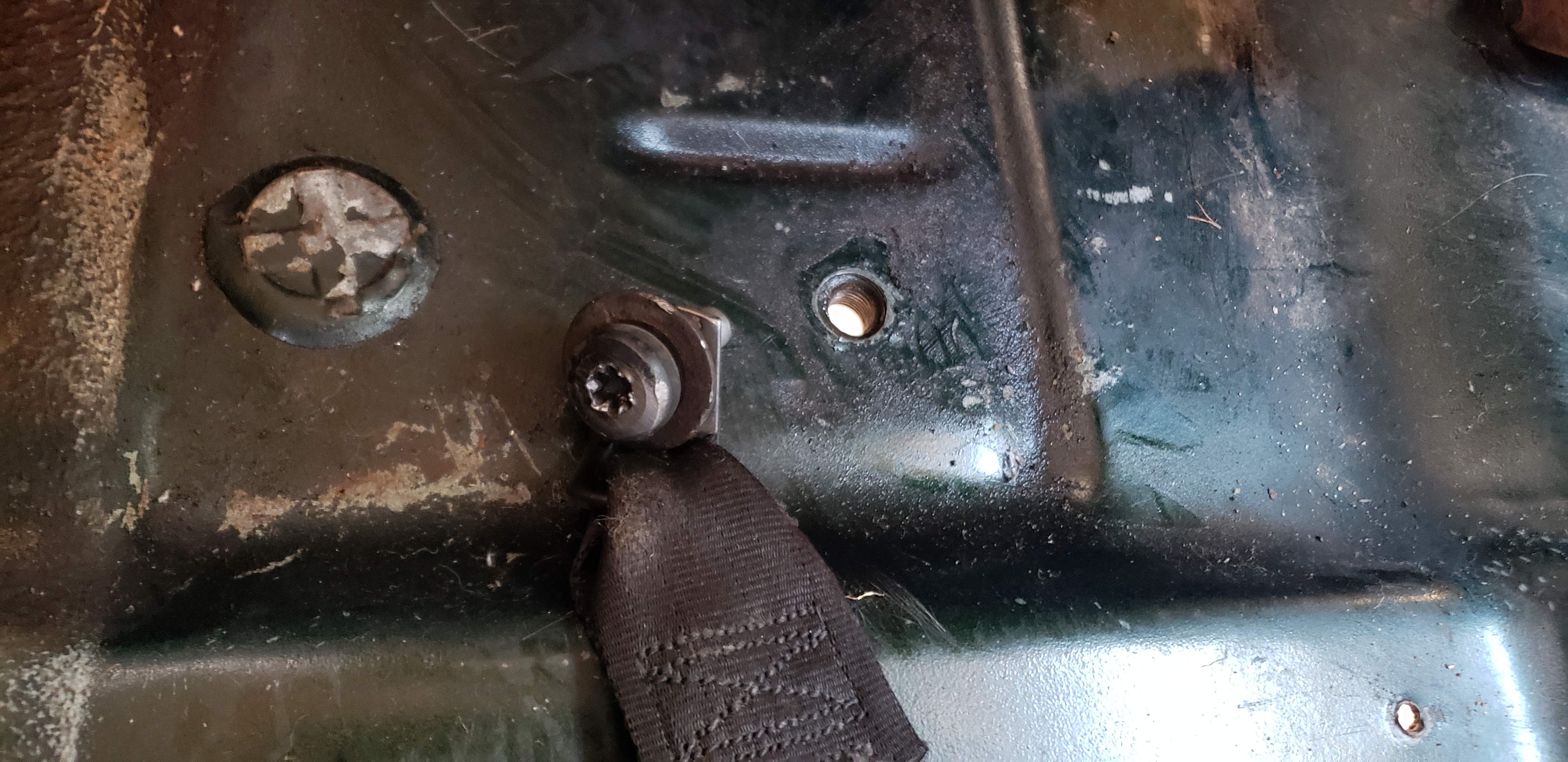

First and foremost, I finally got the rusty seat belt screw to come loose. I combined multiple methods I've read about with what some folks have suggested. I started by saturating the top side and underside with PB Blaster. Once it sat for a while, I cleaned the rust and grime off the head and the threads using a wire brush attachment for my drill. Then I used a small butane torch to heat it up from the underside. After a few minutes, I had my friend give it try with the hammer drill from above. Seeing that screw twist was sweet sweet vindication!

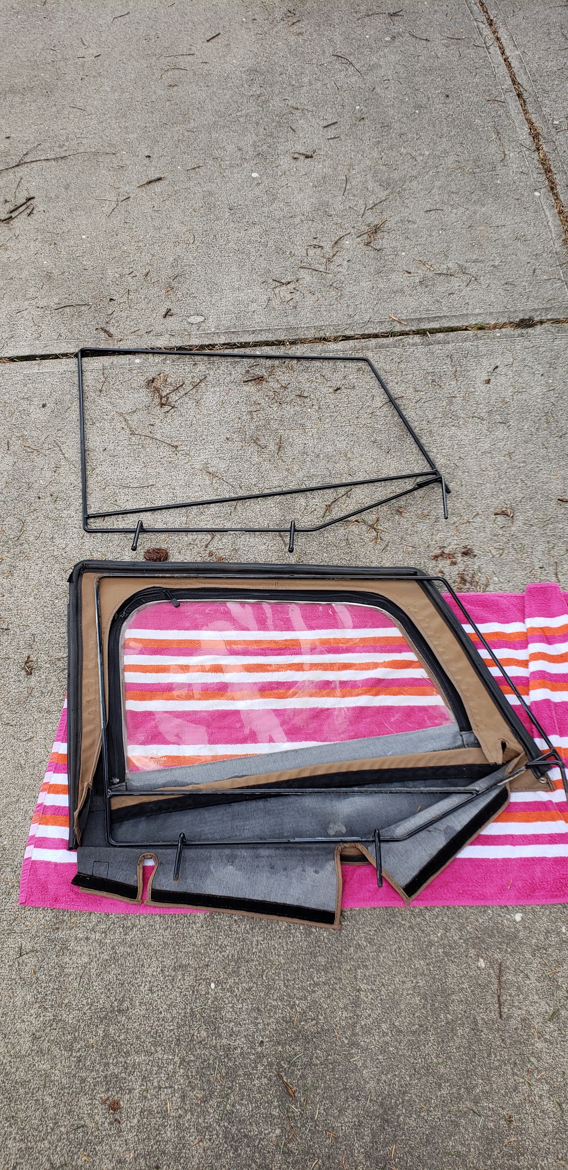

I purchased a new set of window frames. I've laid the old frame on the panel to show how the cut of the fabric doesn't line up with the angle of the bar. The new frame is laid above, and you ca see the angle of the bar actually matches the fabric. I'm not even sure what brand of soft top would fit on the old ones. Maybe one of those slider windows? It was also nice to let the soft window panels fully dry in the sun. It's been a very wet spring here in Oregon.

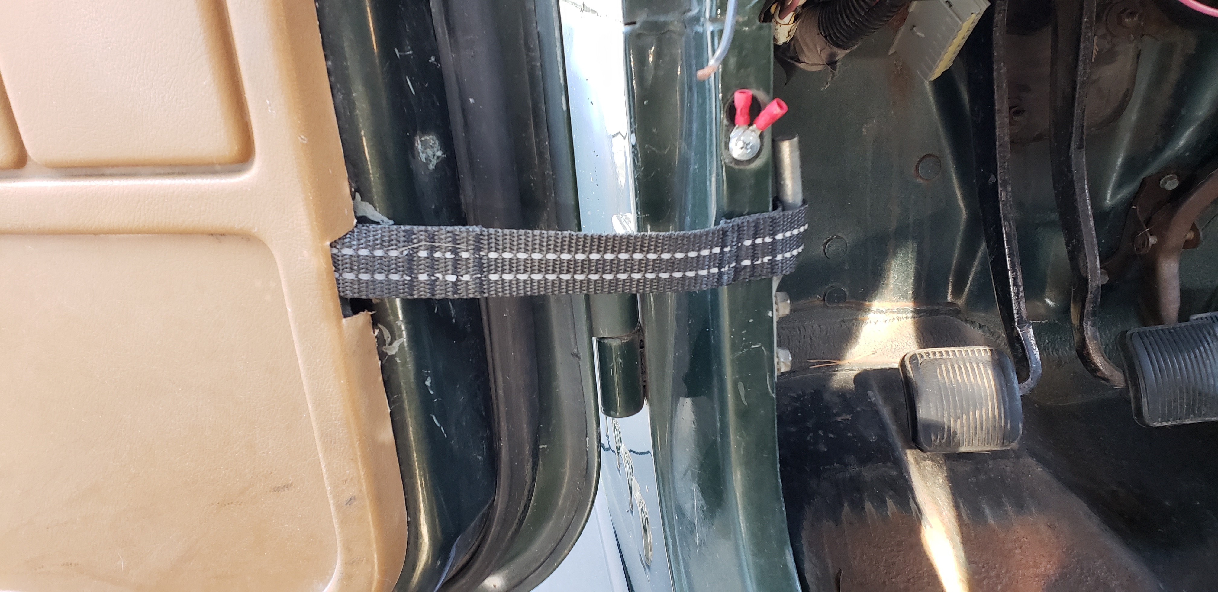

The previous owner had damaged/lost the original retainer strap. So I ordered a new set and installed them.

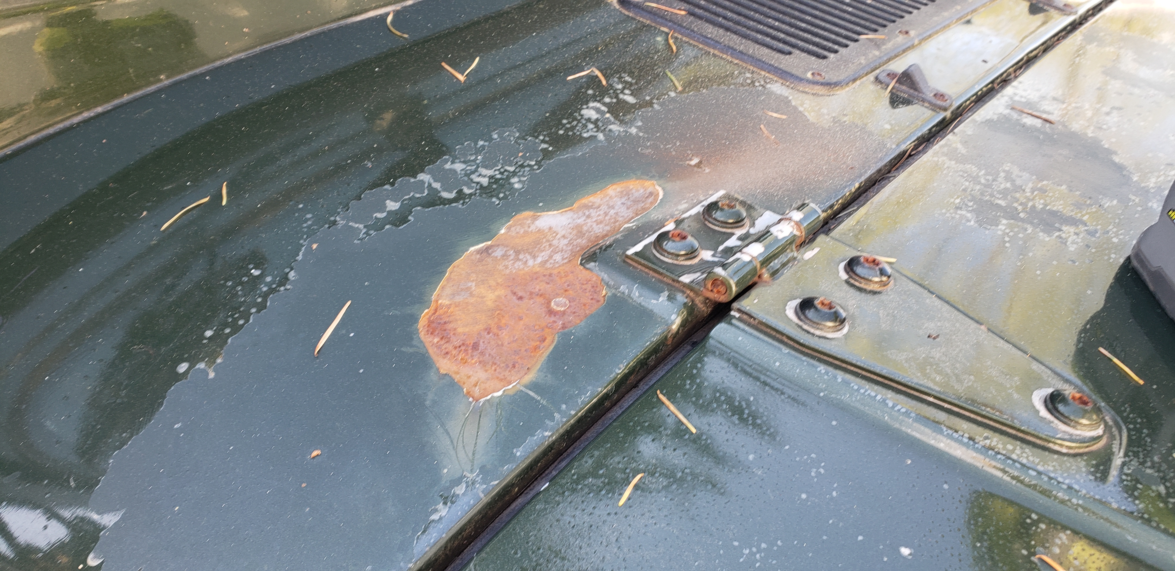

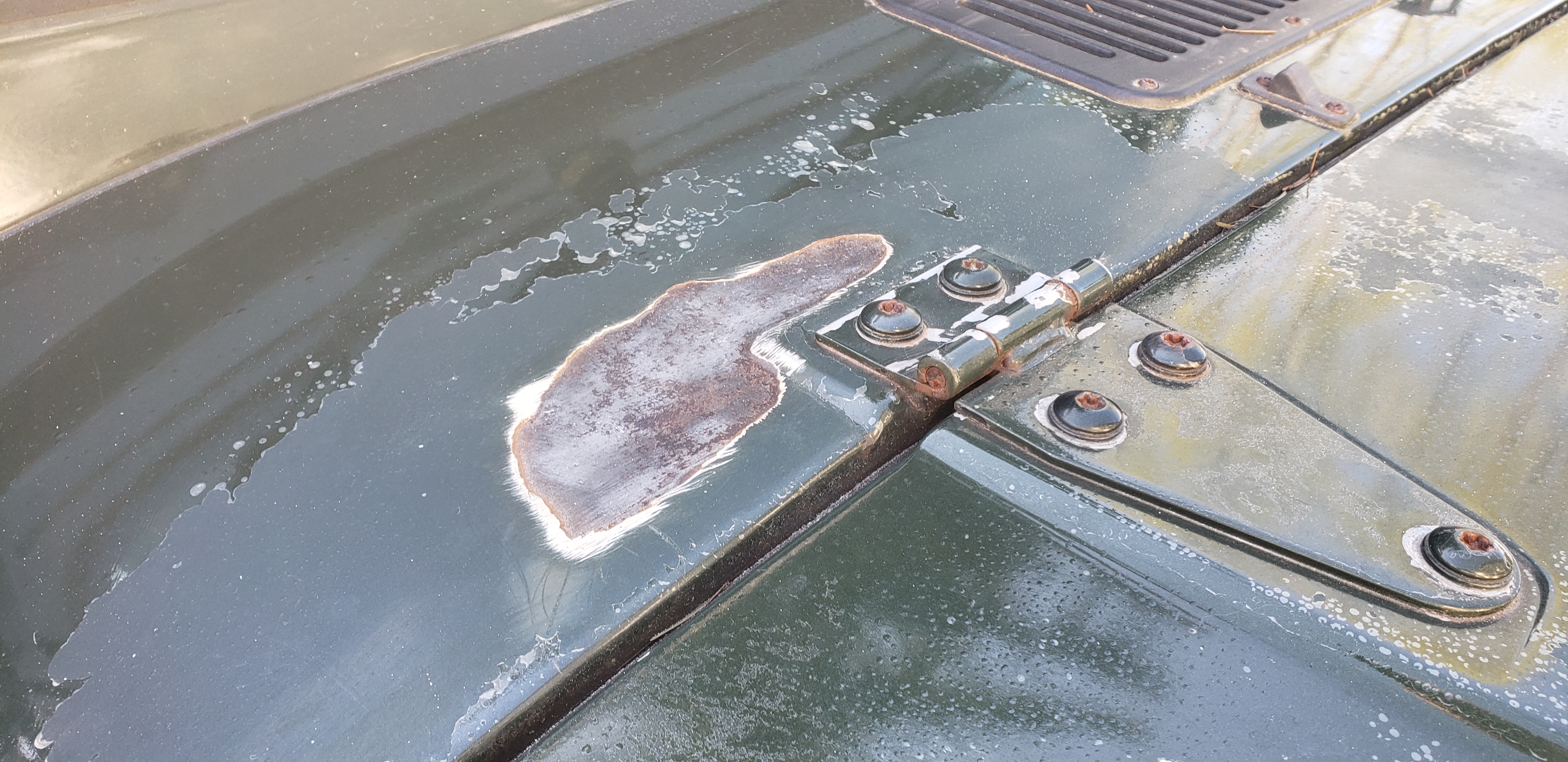

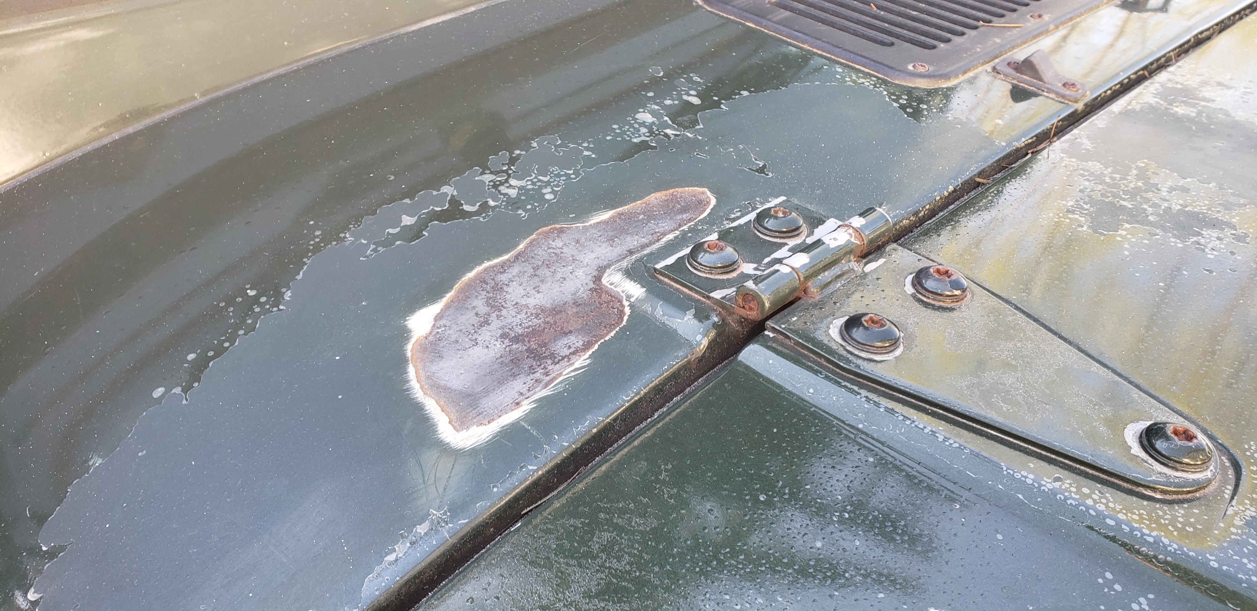

This is a before/after of the biggest rust patch on the body. Since it was so severe looking, I hit it with the wire brush to make sure the damage wasn't too deep or beyond repair. Luckily it looks very salvageable, and will smooth out when I start sanding the whole thing down. (Hopefully next month!)

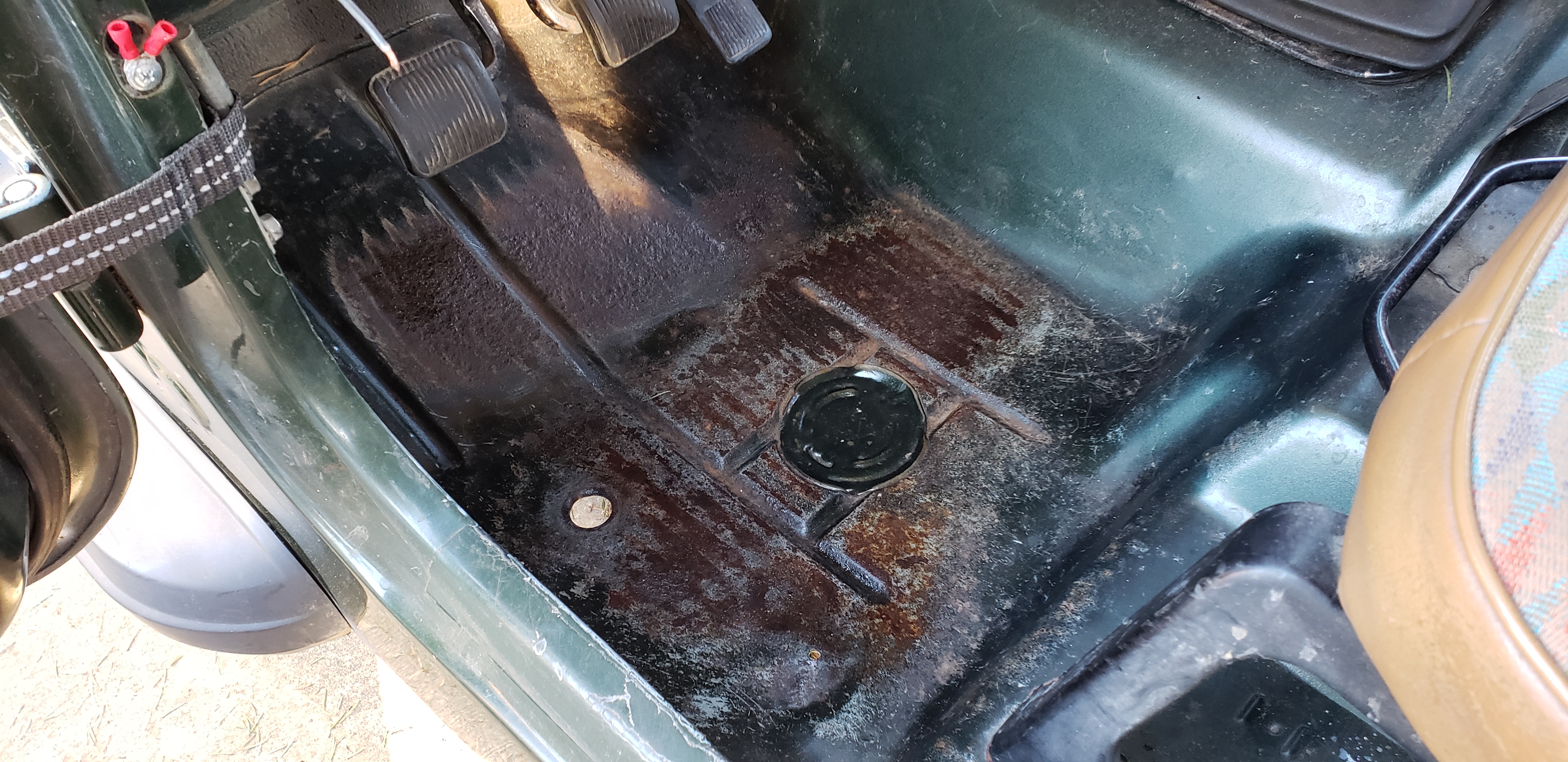

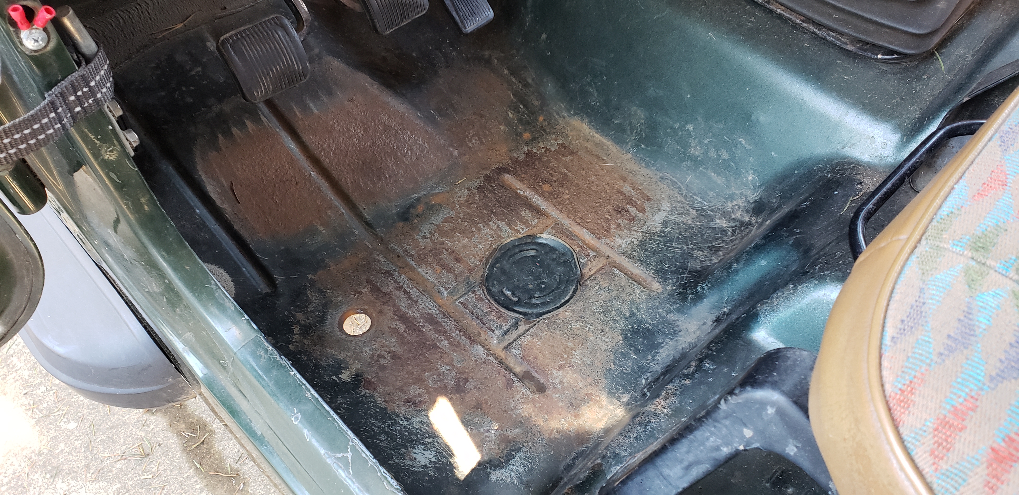

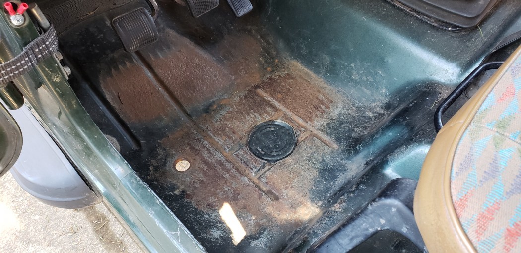

This is a before/after of the rust in the footwell (I was mistaken earlier when I stated there wasn't much visible rust there). All I've done is scuff it with a wire brush and lay on 3 coats of Loctite Rust Neutralizer. So far the rust has turned mostly black, which means the chemical reaction has turned it into a paintable surface. Once fully converted (or sanded away in some areas) I'll lay a coat of regular Rustoleum to protect it in before laying in the new carpet.
I tracked down the leak in the footwell to the failing windshield cowl seal. I intend to replace it around the same time I replace the windshield itself due to a crack on the passenger side.
