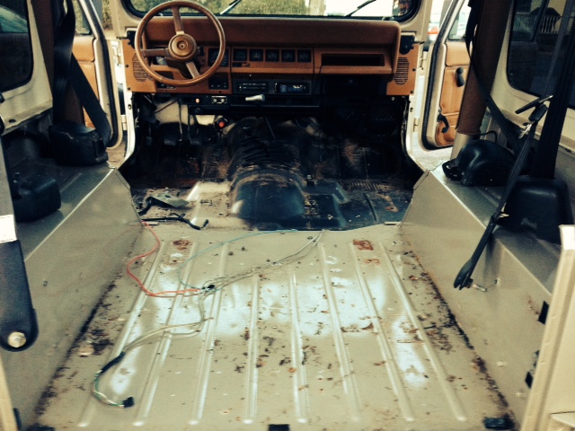

Finally warm enough outside. Spent the last two afternoons stripping out the interior. It should have gone a bit faster than it did but I have a locking insta-trunk things and unfortunately one of the bolts to remove it was just spinning. It probably added an extra 1.5 hours of me trying to see if I could get at it through the wheel well liner.
So anyways, the interior is stripped now. It looks like I need to just replace the driver's floor pan and everything else is in pretty decent shape!

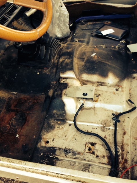

So the next step after repairing the floor pan is to bed line the interior, and I'll be running wires and whatnot for a new sound system since all the carpeting is up. I might actually get the jeep painted before I put everything back together. On a side note, does anyone know what this thing is underneath the driver's seat? More specifically, can I remove it?

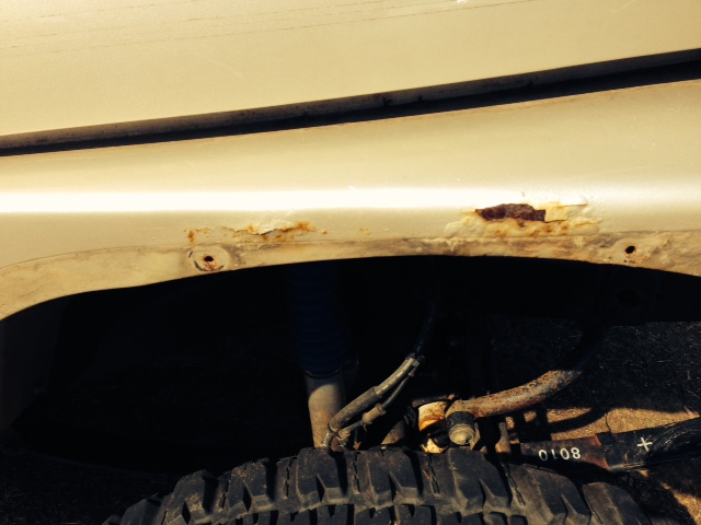

Took the fender flares off to get read to start prepping for the paint. Front passenger fender is in worse shape than I was hoping. The other three just have surface rust at worst.
Driver front:
Rear fender (both of the rear fenders were in the same shape, this one worse than the other (just from the rust spot)
And the front passenger which will require me to most likely replace the entire thing.

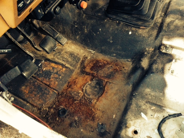

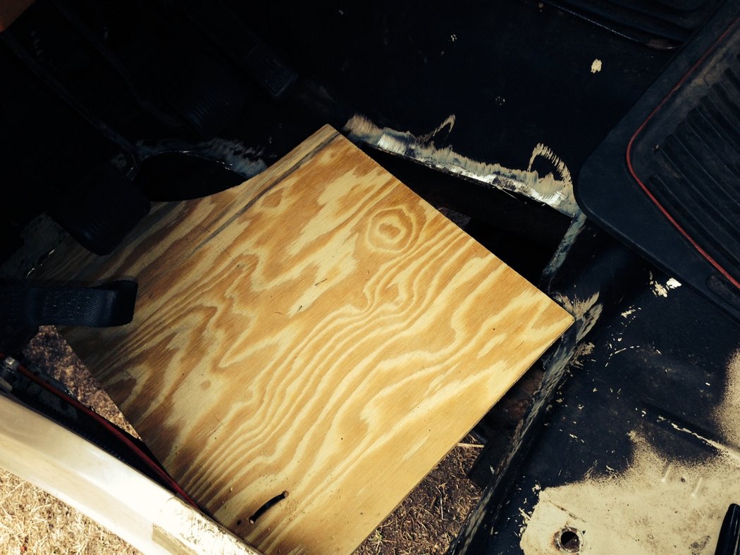

Floorboard was repaired this past weekend. I didn't grab any "after pics" but here's the "before" pic with a piece of wood placed over it to keep myself from being sucked under the vehicle while I drove it to my buddy's.

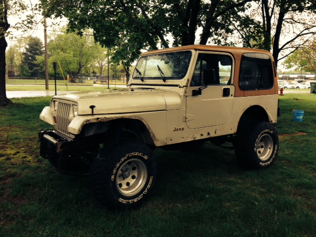

Also a pic of how it currently sits. I'm going to put the drivers seat back in on Sunday and then drive it over to my in law's so we can start prepping the body for paint!

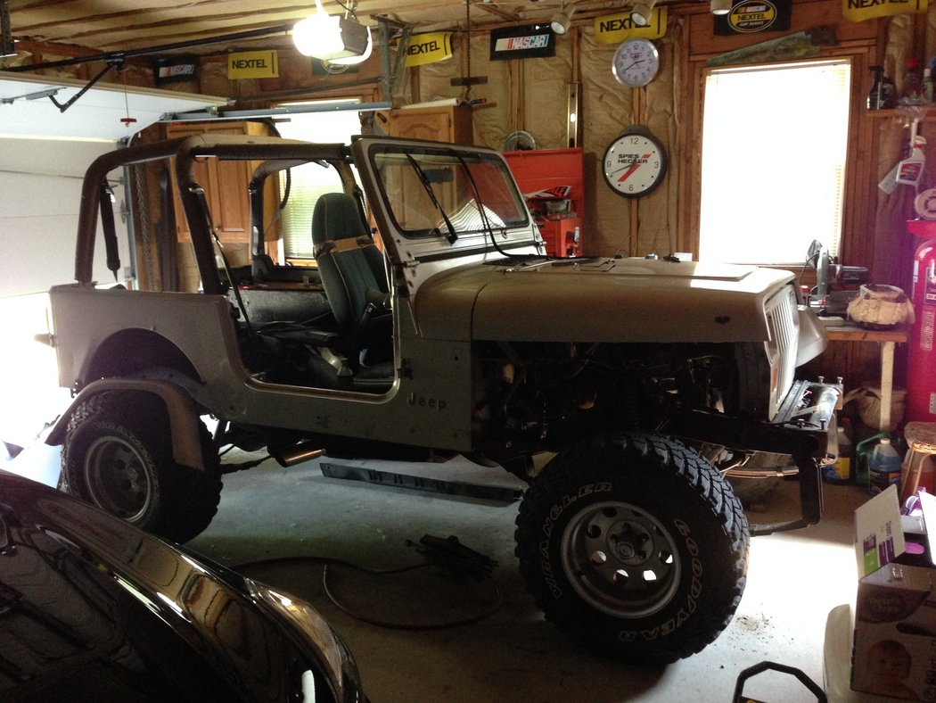

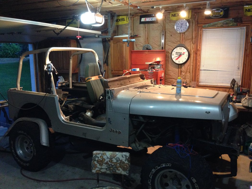

Brought the Jeep over to my father in law's this past weekend. Spent the last two afternoons working on it. First afternoon we removed the front passenger fender, tailgate, and dropped the windshield. Tonight we removed the windshield, glass from the windshield, tail lights, front section of the roll bar (to take off all the padding to protect from prepping), and I started taking apart the dash for the front speaker replacement. I also started to run the wires for the audio, CB antenna, and lights. I need to map out exactly which wires I'm running where for the highest efficiency. Weather permitting, this will probably be done by July 1st.
After the first day:
After the Second day:
