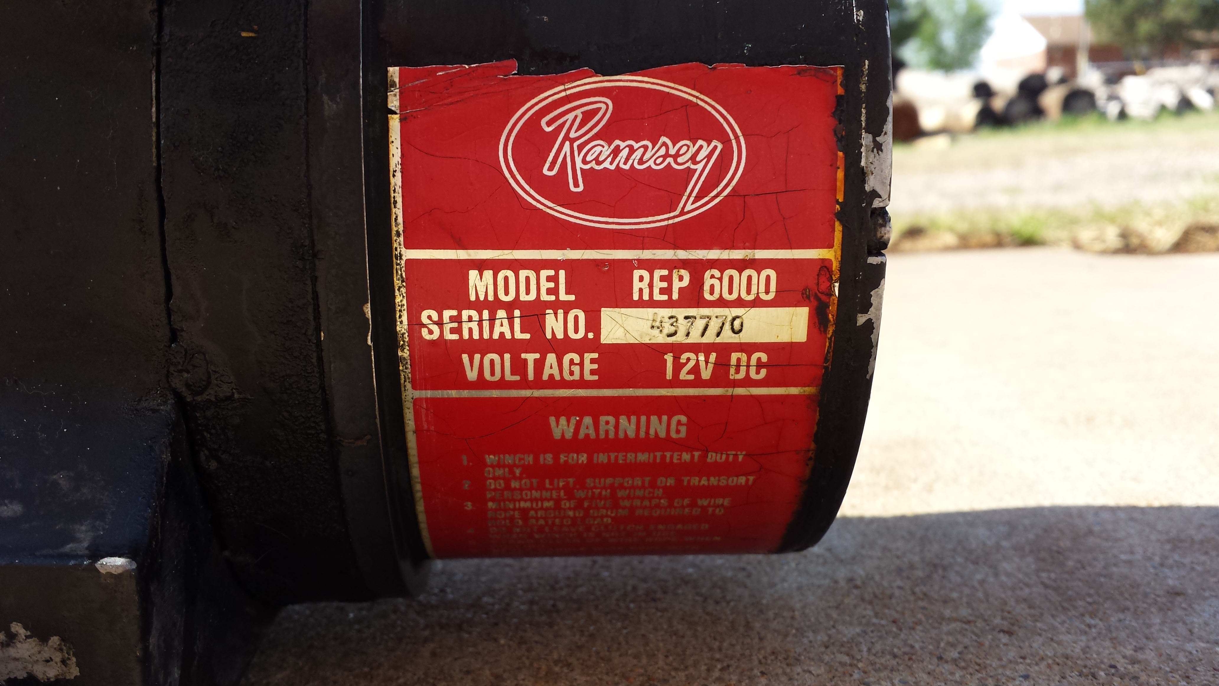

The Ramsey REP 6000 does have the old style identification sticker.

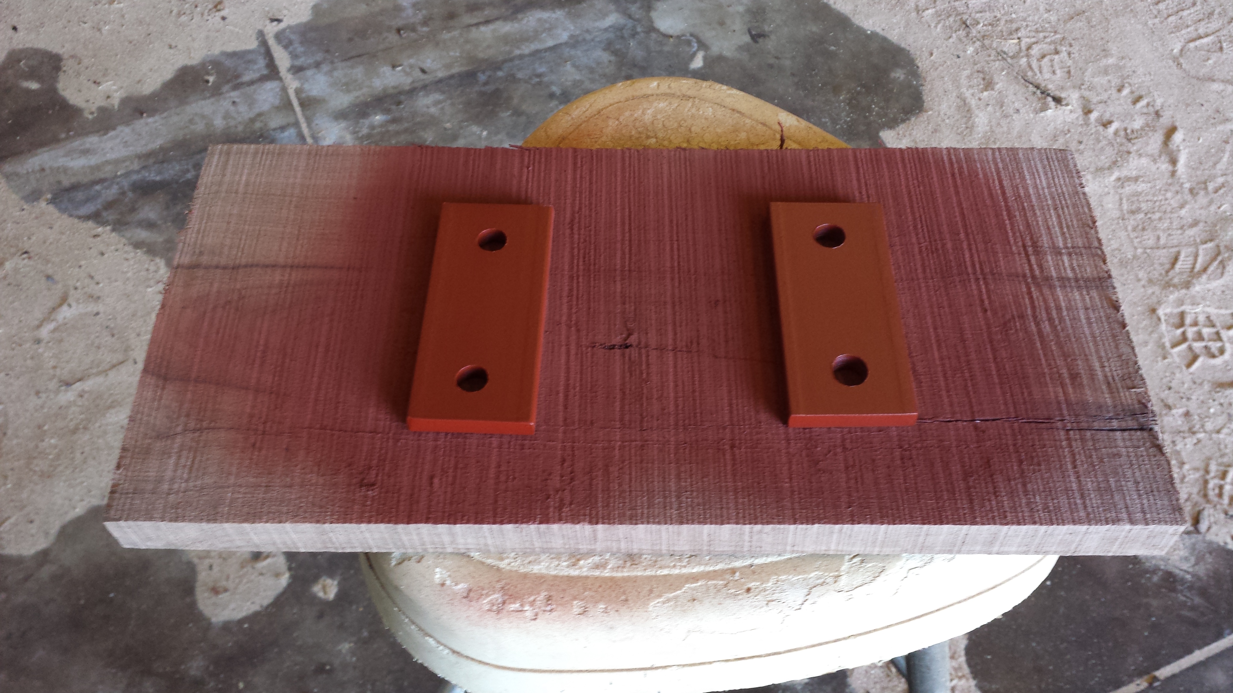

After I drilled the holes I went to mount it with the winch on and found my second problem. The bolts attaching the winch to the plate were hitting the bumper and not allowing me to tighten the plate down. So I went back to the original PDF of the Ramsey Jeep YJ installation instructions and found out I was missing some spacer blocks. I then looked on this forum at the islands of adventure Jeep and sure enough, there they are. So I decided I would make mine looks as close to the originals as possible. So I found some rolled steel that looked like it was the same size, cut some pieces to length, drilled, and then painted them. They ended up looking and working out great.

Flat rolled steel cut to length for spacing blocks.
Primer painted spacing blocks.
Finished and painted spacing blocks.

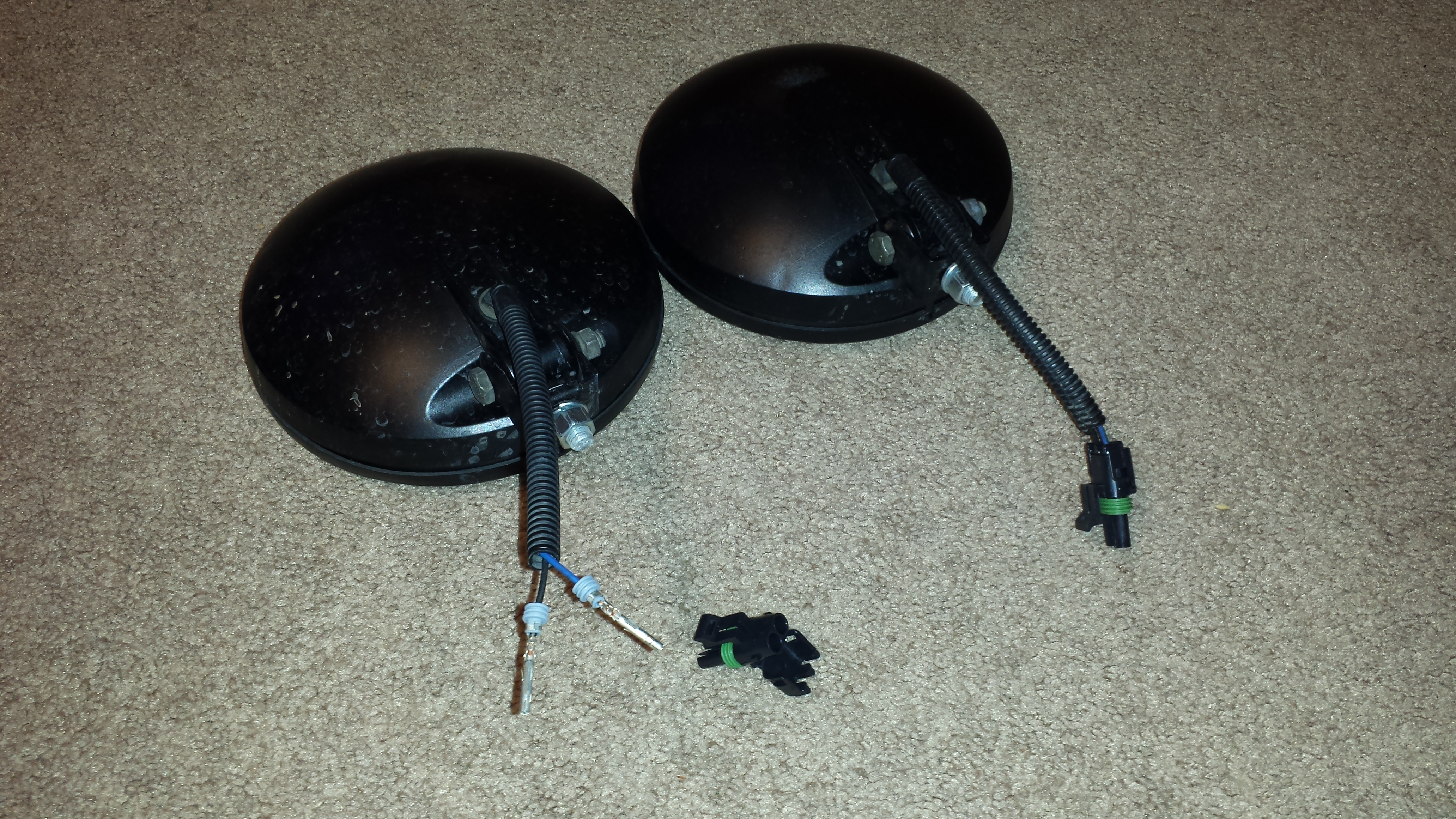

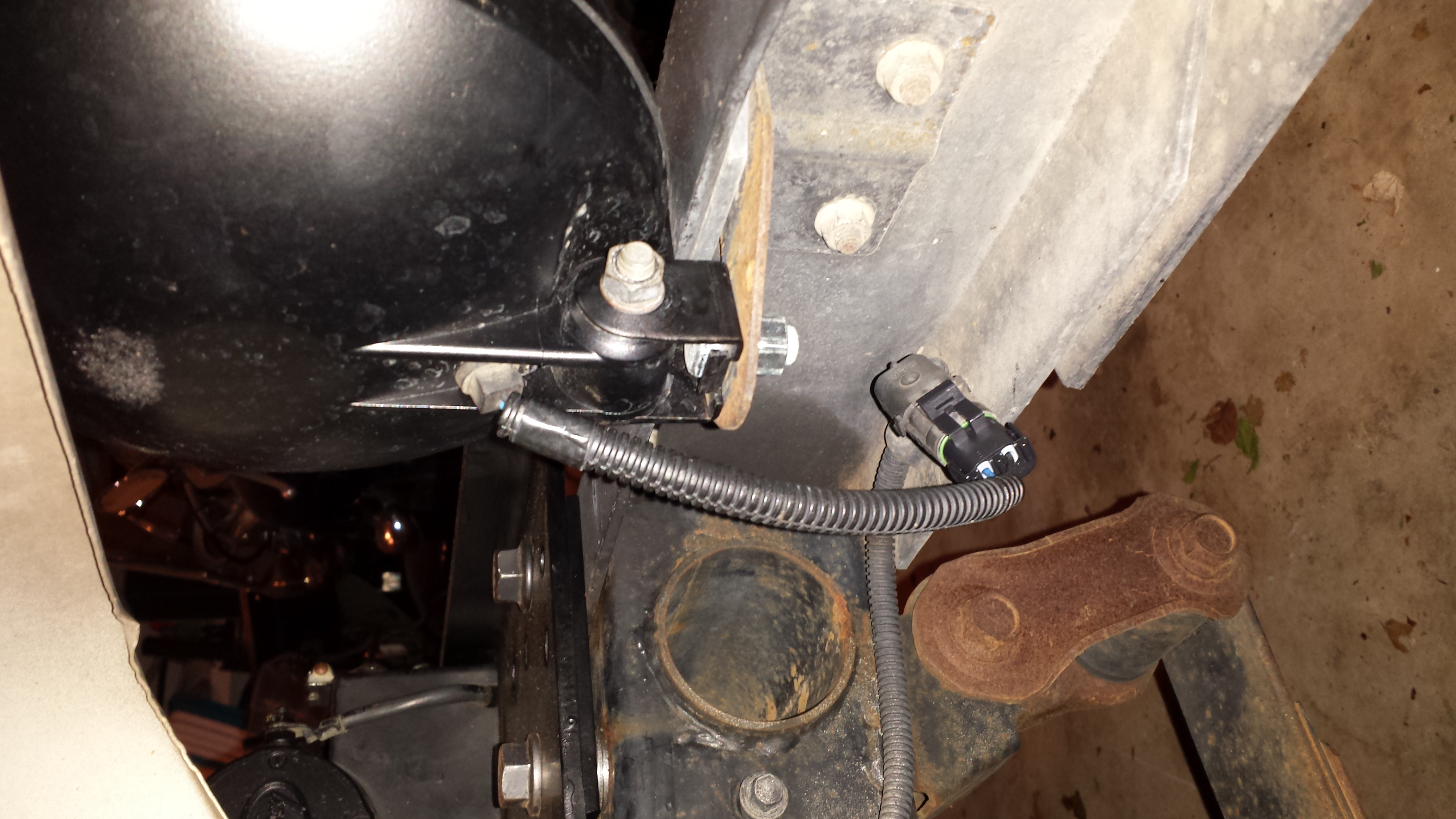

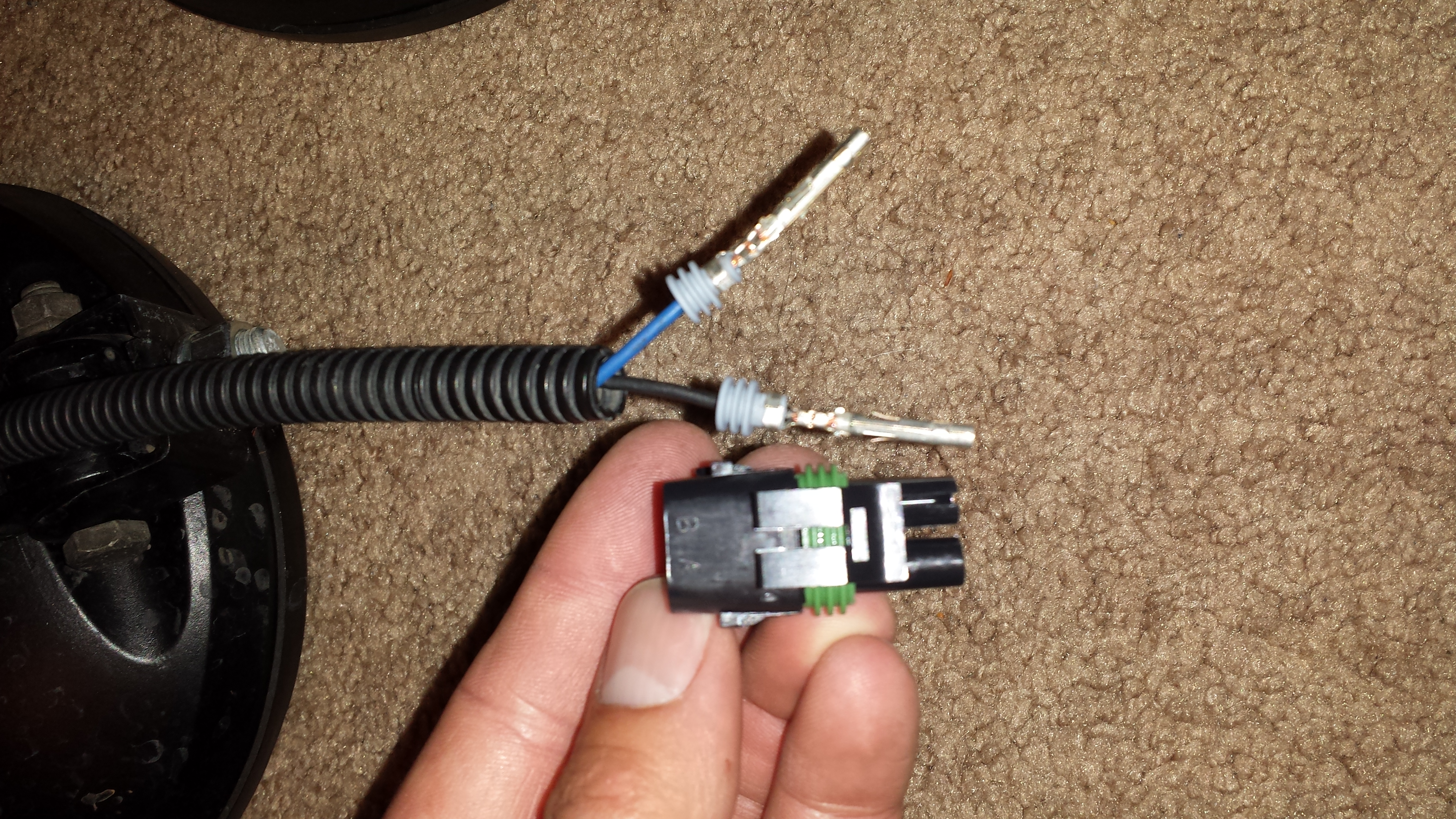

I almost forgot to post this. When I refurbished my YJ fog lamps I used the TJ fog lamp wiring. The grommet was the perfect size, the wires were the perfect length, and the wire colors matched the wiring on the YJ. I bought some weatherpack terminals off of eBay to replace the TJ plugs. I didn't have and didn't use a weatherpack crimping tool. I didn't want to spend the money on it. I just took my time and rolled the crimps around one by one and it worked out just fine. You can see in the pictures how good they look and how it looks like it came from the factory.
Left side
Left side
Right side
Right side
